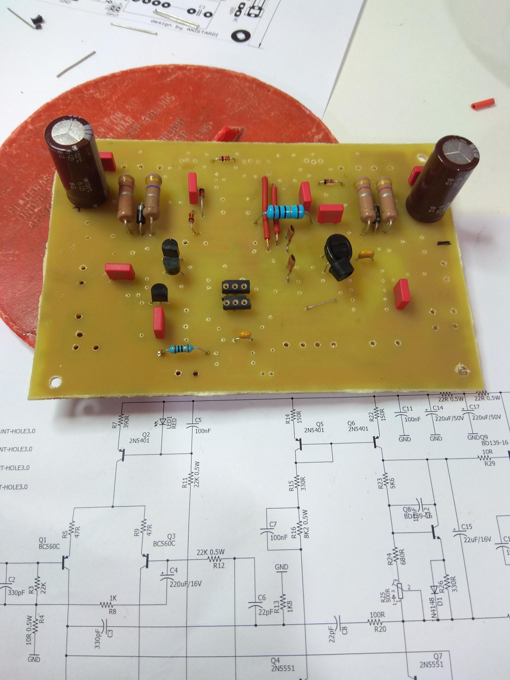

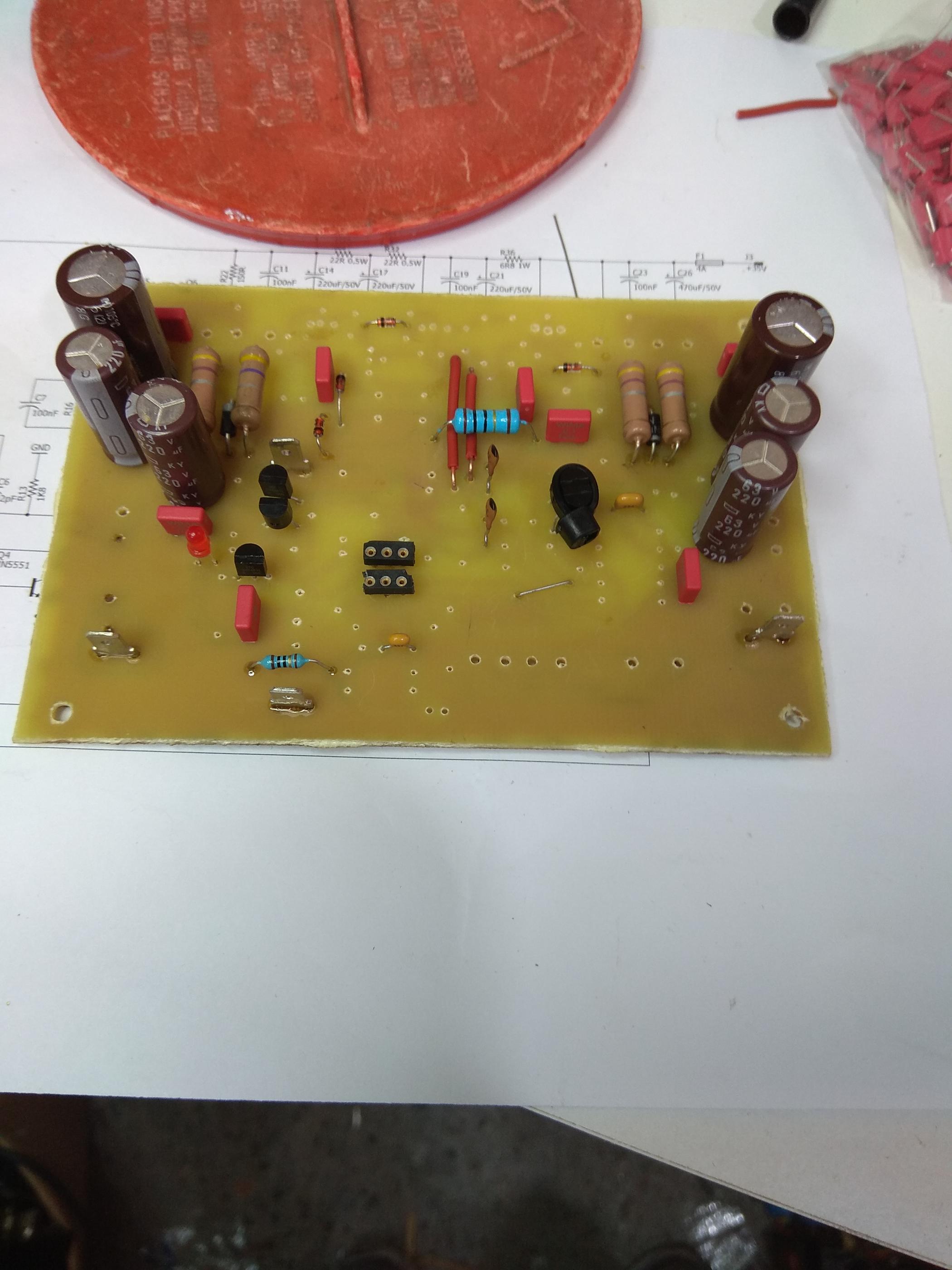

Anistardi Pelatuk Amplifier
I have promise to bimo this test. 🙂

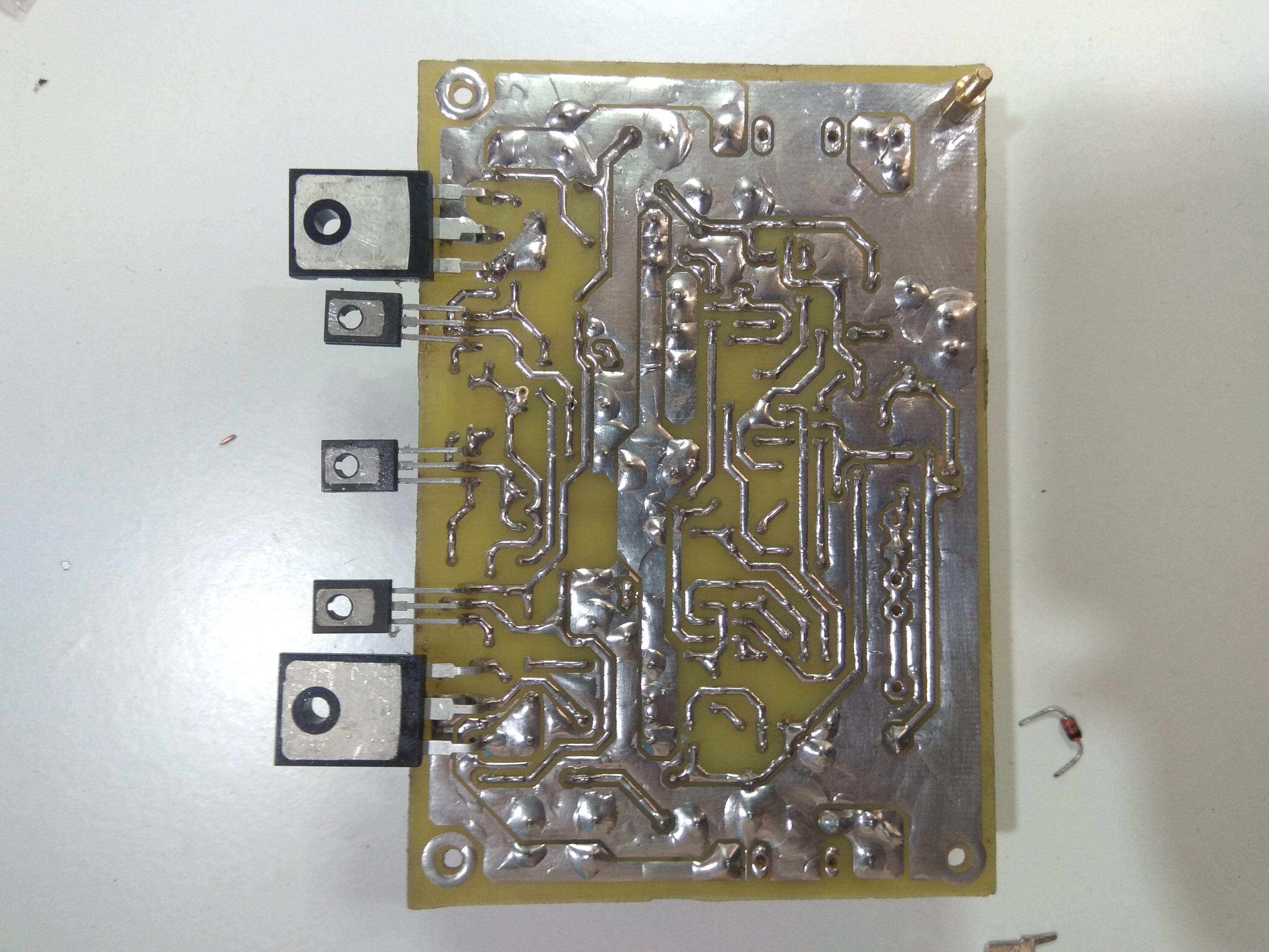

Diy pcb of course...
Photoresist method.

Is tis your first job done with PCB ?

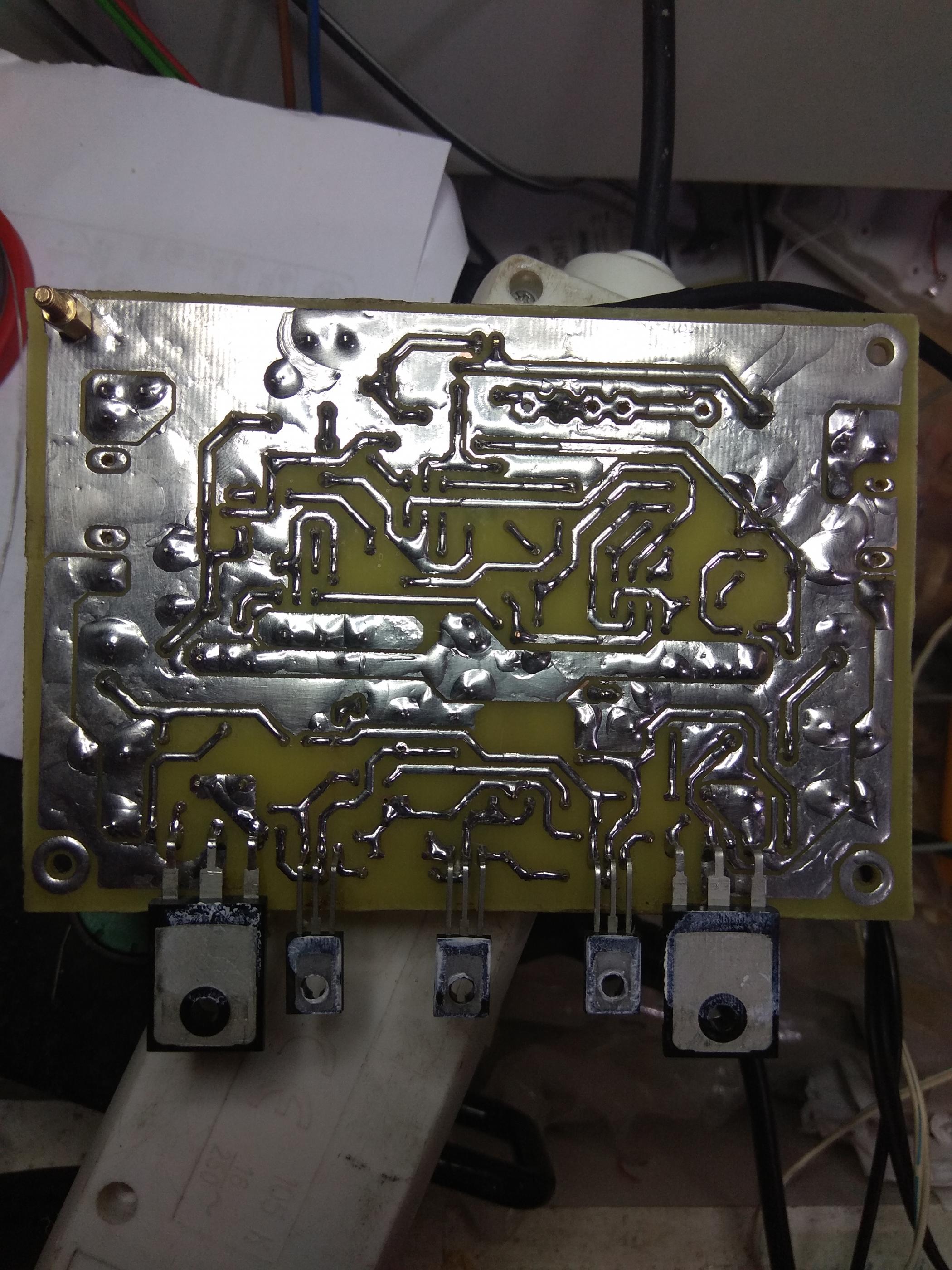

I did a lot of work with PCB yours is great ... but try to reduce the diameter of the holes in the copper foil .... as small as you can only to give a center to start the drill bit, then you will keep as much copper as possible ... soldering will be easier and stronger.

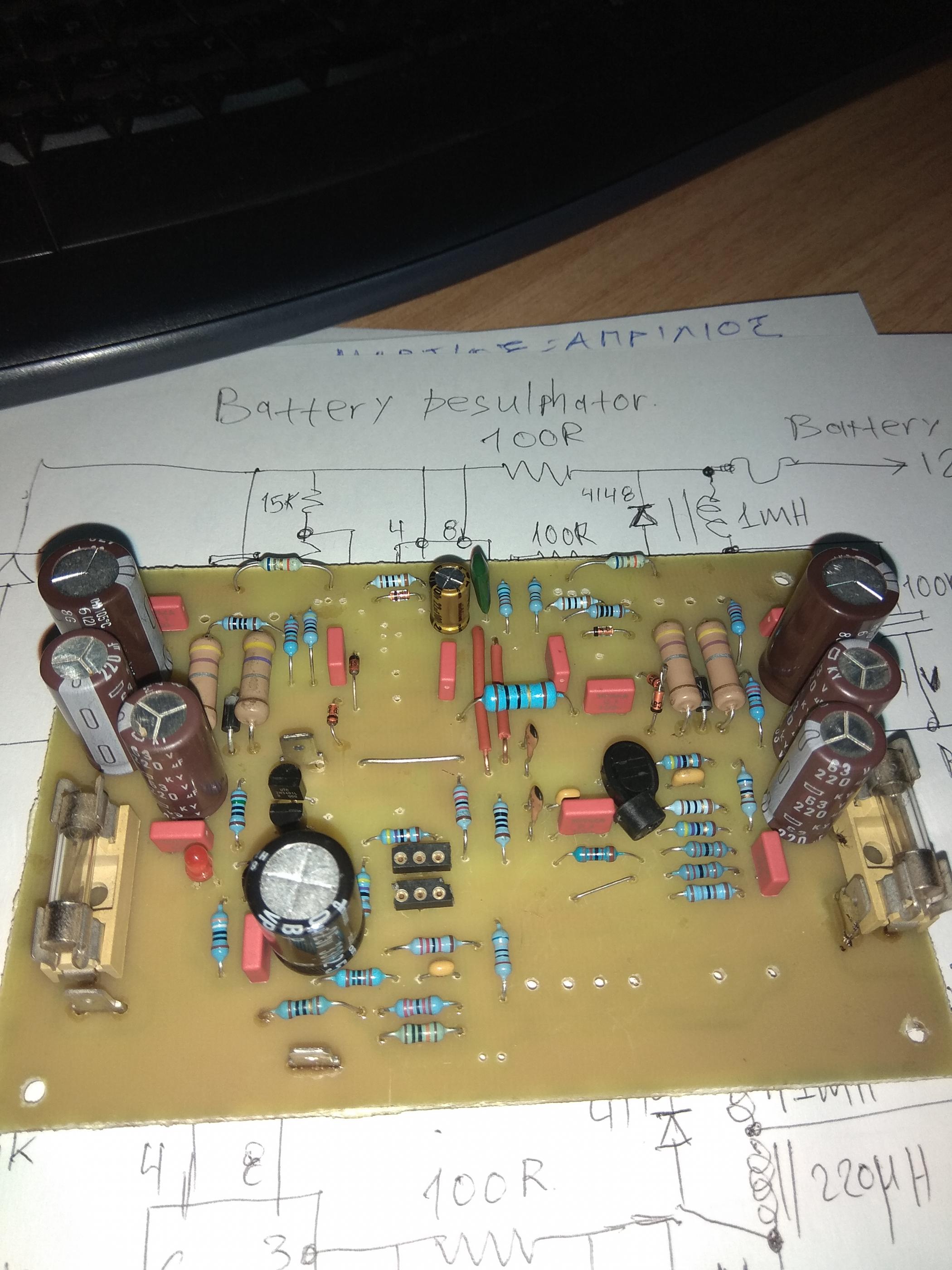

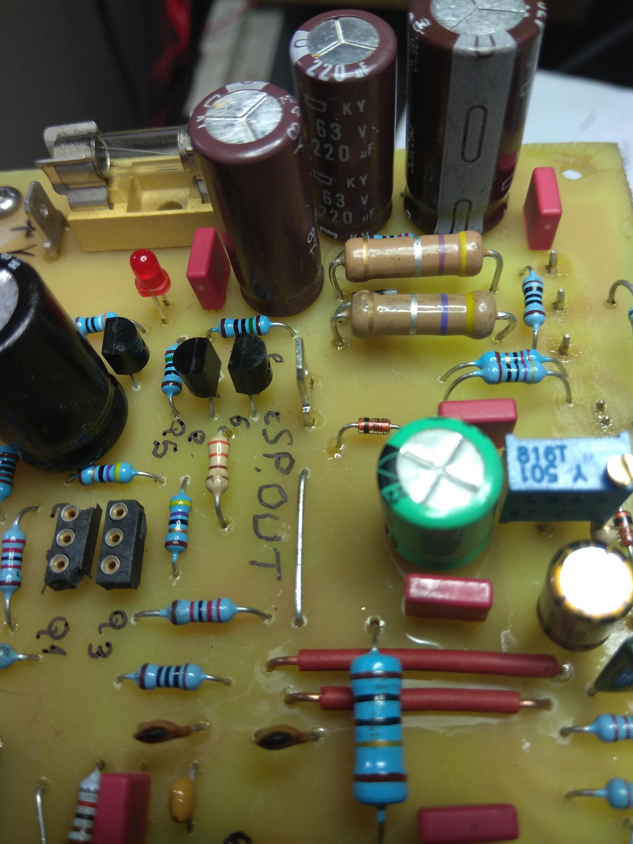

Just checked Anistardi´s site to check the schematic.
I find it weird and counterintuitive that the thermal sensor is a mid power transistor (BD139) but power transistor drivers are flimsy TO92 low current transistors such as 2N5401/5551 , quite unsuitable for the task.
JMF,
The TO92s are rated to 625mW and should do reasonably as drivers IFF the rail voltage is no more than 42V. I agree, they are pushed, but I have found they last OK at low power and particularly if the outputs have high beta.
Can answer for Bimo but the BD139 makes a great temp sensor because it can be bolted to a TO3P, a convenient thermal connection and quicker than on the heatsink.
HD

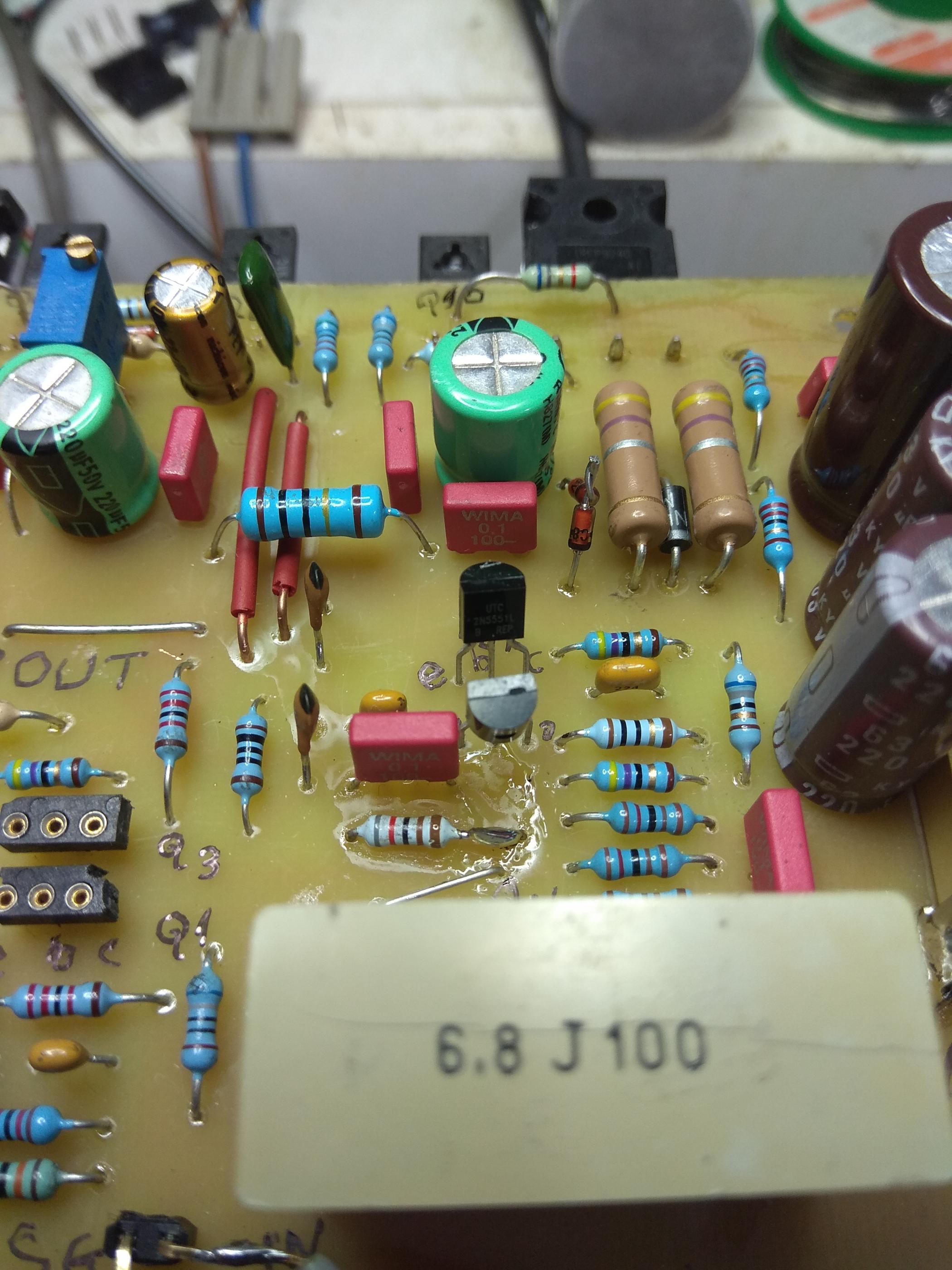

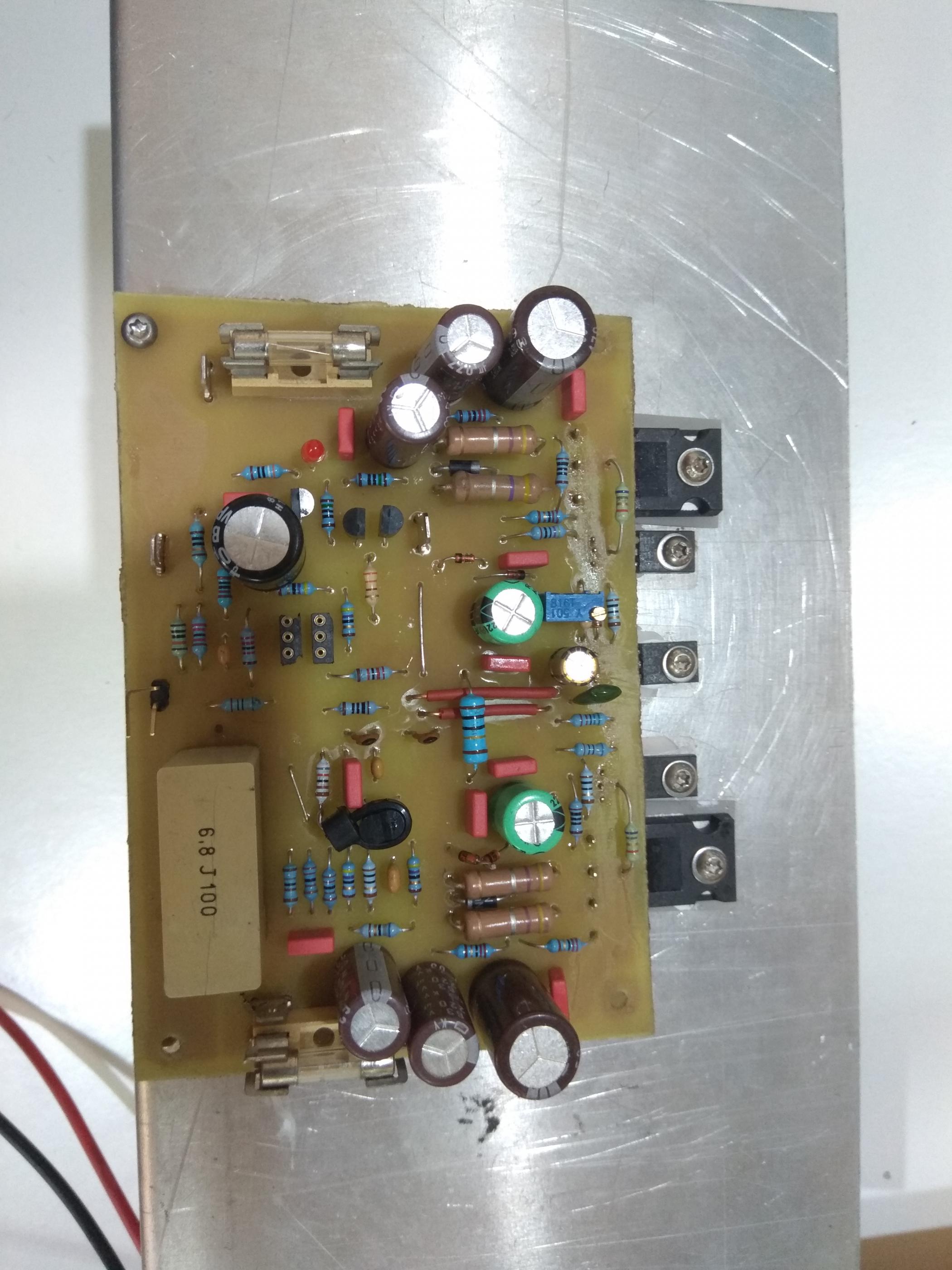

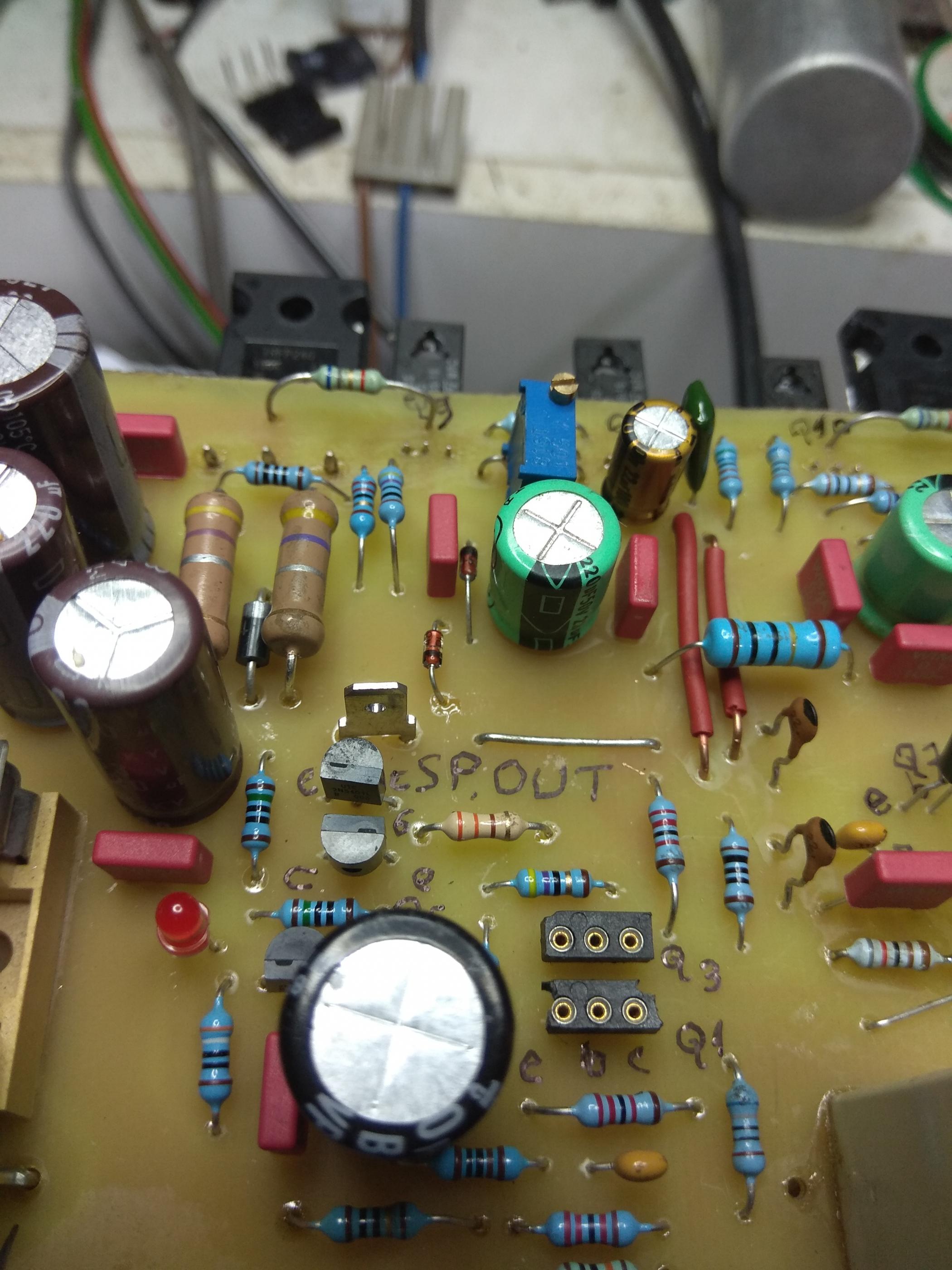

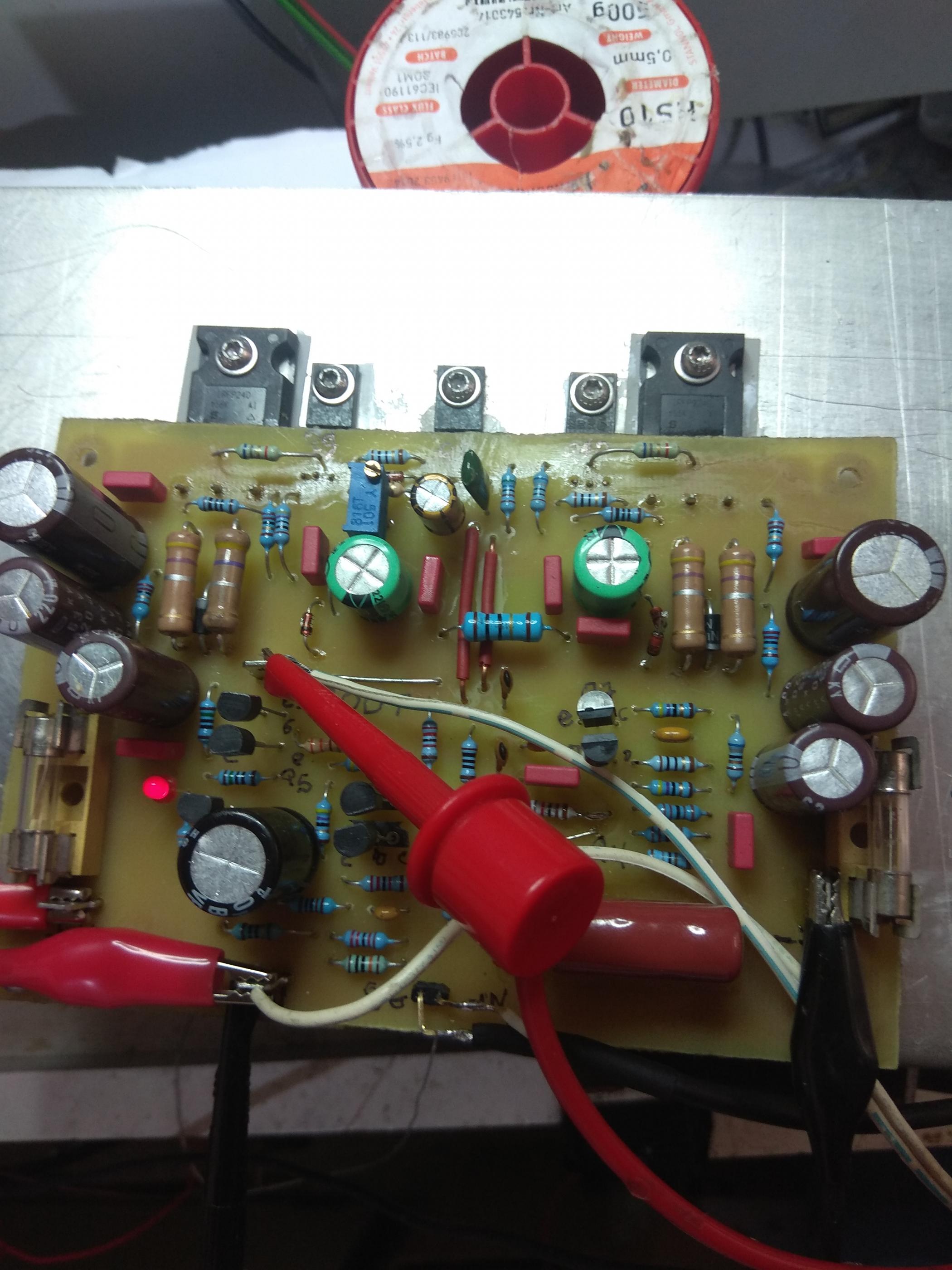

More photos.
Where is bimo?
Is it a tested pcb or i must check for errors?
I see 0.5v across R22.
