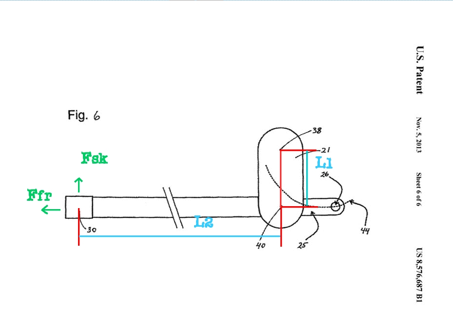

As you can see on the photos, the Schroeder arm does not differ from conventional pivoting arms in respect of the effective mass.
Concerning the skating force the following equation applies:
L1 x Ffr = L2 x -Fsk
Where Ffr is the friction force pulling the tonearm, and Fsk is the skating force.
L1 and L2 are on the drawing (the original was taken from the patent application).
When the lever and the tonearm are not perpendicular (as in reality), then the equation is more complicated, with some trigonometry.

Only some unipivot arms come close to equal eff. mass lateral plane vs. the vertical plane.
Even cardanic bearing(i.e. Triplanar, Alphason, Dual ULM, etc...) arms display a (minute and inconsequential) difference in this department.
"I think I would like to see some proper independent measurements of its behaviour, static and dynamic.... "
And why is that?
If you meant, "skating force varies with groove modulation"... this would be correct.
@ alighiszem: the drawing above just shows the elements from above. You must draw the previously voiced conclusions, I understand. But the drawing leaves out other factors(not elements)...
If I find the time(after x-mas), I will fabricate a little video and you can then tell me how it's done.
Btw, this isn't about teasing or playing hide and seek, but about keeping commercial copycats from exploiting the principle.

Hi Again,
I'm finally ready to begin a clone of this amazing design,Contrats Frank on your patent approval, it is this idea below that I am currently struggling with.
So there is a varying stiffness with respect to the magnetic force applied over the arms movement? Hmmm. Guess I'll have to experiment. Does it get weaker or stronger?

Hi MC,
Just envision pulling a magnet along a guide rail(parallel) vs. pulling it at a 90° angle...
