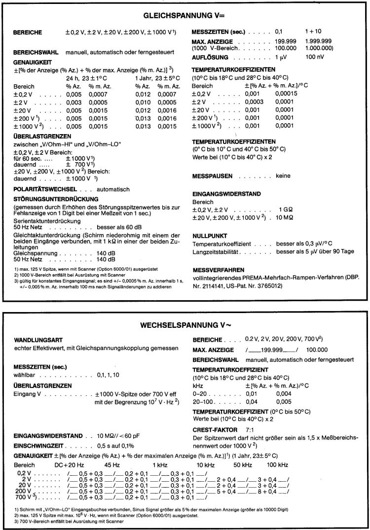

Thanks Chris, yes I'm not sure if it's in spec still, calibration can be done either by gpib or flip a internal switch, I believe I have to change the backup battery.
Anyways a nice meter, they also made 8.5 digit back in the day, with their own adc chip.
Spec sheet is promising, low drift, bet it's full of nice parts

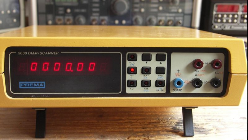

Hi amplidude,
Great deal!!! For that money I'd get a pair if they were available. That way you can monitor bias current on two channels (that's what I do often). Anyway, they look like a great, funky, low production numbers DVM. A very good value. Now, how well did they hold their calibration? Right now you don't know if you can trust it long term to stay in cal, or if its out to lunch. I hope it is still in tolerance or close for you.
-Chris
-Chris

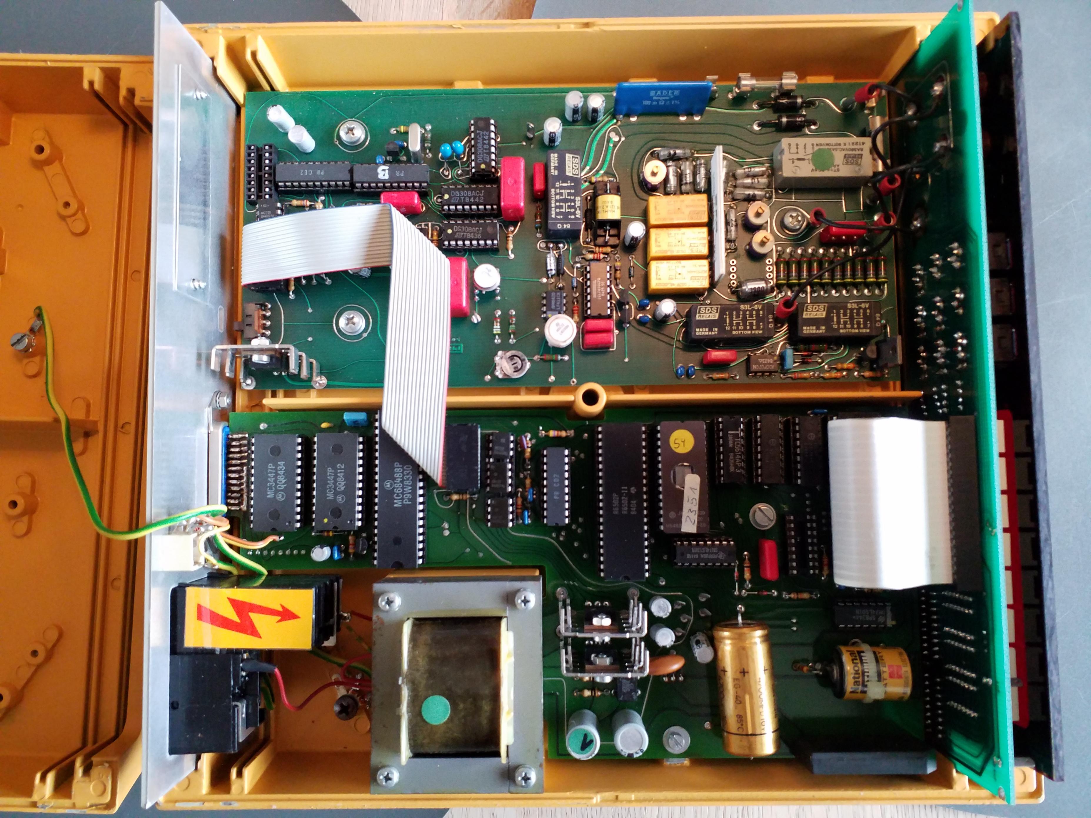

You're right , it's not something I ever seen done this way, the traces are pulled far of from chassis screws, as you said I don't think many units were made.
Anatech I own 5 other meters, none are calibrated, a fluke 867b, a protek 608 , a carlo gavazzi pan5050 a gossen mavo meter, a meterman, I would like at least one calibrated, should I choose the prema 5000? Or one of the newer ones?

Hi amplidude,
Well, the Fluke will hold its calibration really well. I bet it is still in tolerance. But I would calibrate your new meter, the prema 5000 6.5 digit one you just got. First do the power supply capacitors in case there is a problem, then send it for calibration. Check it against the Fluke before and after (just for chuckles and grins). That is called a cross-check. Problems in the power supply will cause an unstable reading when they are calibrating it and may cause them to fail it when in fact it is basically okay.
If you can afford it, get the more expensive calibration that gives you all the before and after data readings. Those numbers can then be used to compare to your Fluke and the other meters. They also can tell you about drift later on if you calibrate it again. Getting just a certification really doesn't tell you much, especially if it is right on the edge. Normally the cert with values also has them "guard band" it. That means that if the readings are outside of 80%, they will adjust it to be correct. The equipment used to calibrate your meter would be at least 4x more accurate (4:1 TUR). That's worst case and they have to list it if the accuracy is less than that.
Anyway, calibration with data actually buys you a lot.
-Chris
Sound like a plan?
