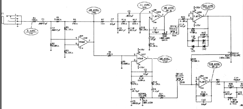

I think the pedals are the way to go here. That amp will never sound decent if pushed into distortion. This is a case of the amp staying clean while something else does the heavy lifting for your "sound".
-Chris
> harsh when put into drive mode.
https://www.thetubestore.com/lib/thetubestore/schematics/Fender/Fender-Frontman-15G-Schematic.pdf
Normal channel is pretty normal. Drive channel is some filtering then a diode clipper with no top-cut, which may well be "harsh". But hey, it's gotta "bite" on the showroom floor. And it may be good when you play against a drummer.
It's got plenty of bite 😉 It certainly satisfies the owner, just not so much the owners dad!! 😉
