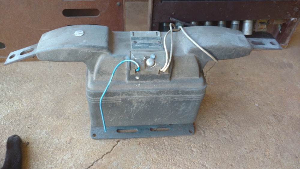

I also picked up the pictured 35 pound, 20A door stop because I thought it was cool.

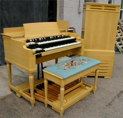

I'm not sure, but I saw Colin James a few weeks ago, and I think the keyboardist had a big Hammond tone cabinet in the corner; it looked bigger than those, but I was sitting far away.
Was it a Leslie- more square with long horizontal slots top and bottom?
Look-up Hammond Solovox. It is not a church/stage instrument. It is a 2-octave organ miniaturized to clip to a piano. It is obviously Hammond's "gateway drug", a low-cost taste so players could graduate to a Big Organ habit. Home-size. I didn't look-up the tubes but I think "6V6" (on Loctal base) and 8-inch speaker. A Good Home Radio, not a Ballroom or Church Organ sound system.

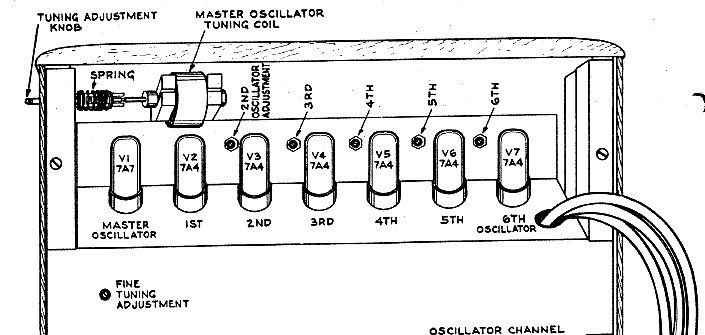

> what the motor is for (top left on the taller cabinet)
Appears to be the master tune inductor. It should have a spring to a knob on the outside, maybe lost over time.

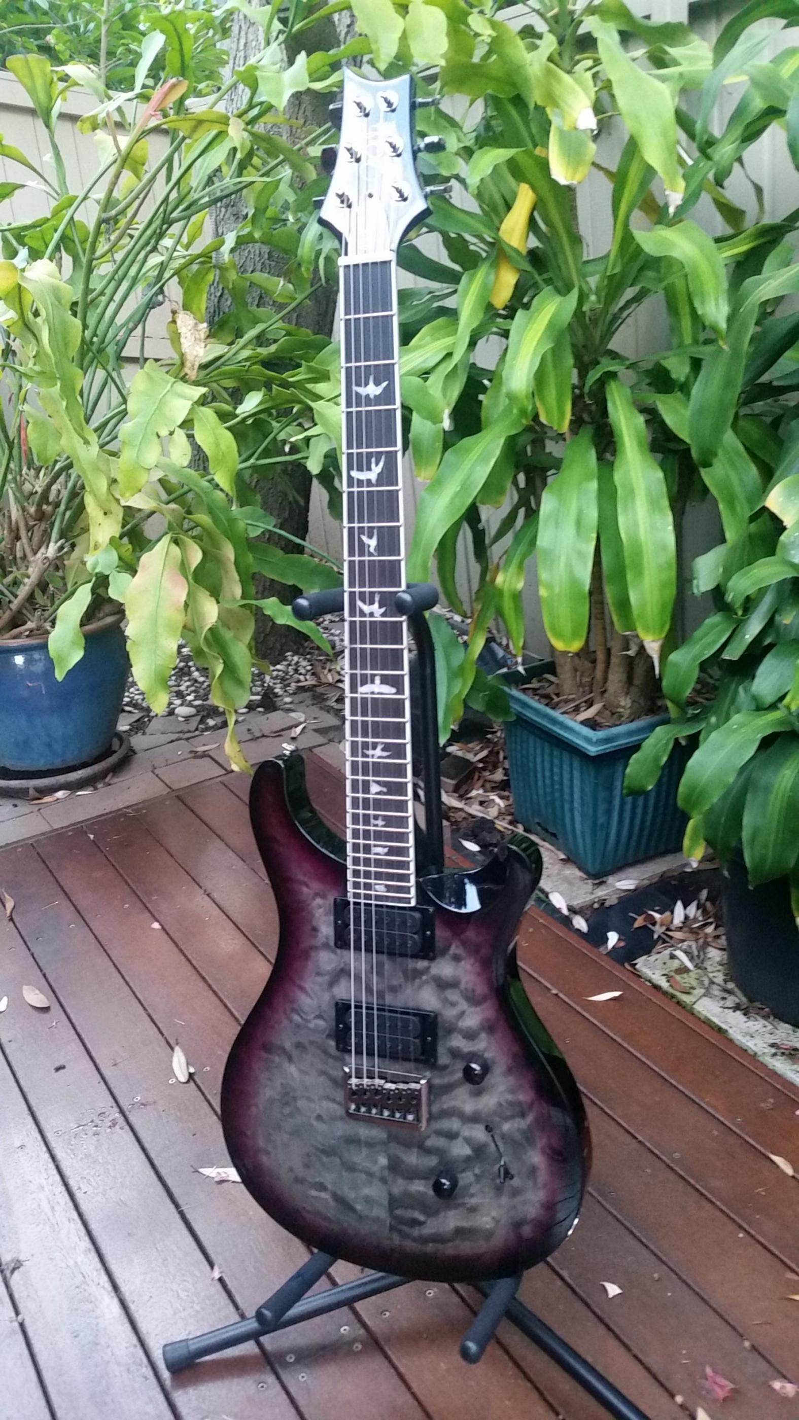

A PRS Mark Holcomb SE.
My daughter twisted my arm at todays guitar lesson!

It was a bit of an impulsive buy. I would normally do three weeks (or more) of research before buying something expensive like this! It seems very well made, sounds great. Definitely a step up from her fender squire.
Now the next thing is to do a guitar amp... oh like I need another project! ;)
edit: truth be told I pointed it out to her before the lesson, I had my eye on it. She said do you think they will let me play it in the lesson? I said ask, and of course they did. She really wanted it then! I asked her to try another three guitars, but this was the one. She kept saying It's got birds on it!! :D of course it felt right too.
