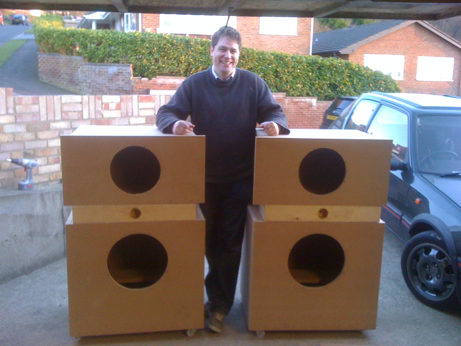

This is an love affair that produced a dream. That dream is motivating this exercise. This exercise will lead to a pair of monsters in my living room 😀
I've built LARGE before btw (see below for 3cuft for 12lta & 7.5cuft for Beta15) . Larger in fact that this project will be!
