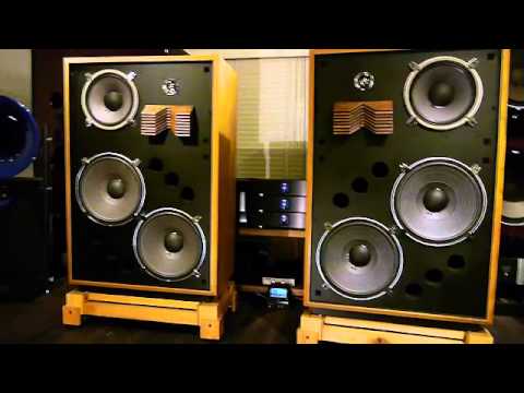

plans please
Hello, I'm very interested in building these, any input would be greatly appreciated. Thanks in advance
The driver is Faital HF104, an annular ring driver, memebrane manufactured in in Ketone, Faitals propriety polymer, reputedly made out of equal parts green cryptonite, catshair and turkish yoghurt, flare is also Faital, their smallest tractrix, STH 100.
Measurements are somewhere around here, i´ll look and post.
Aim, thou, was to walk a bit further, 2x8" is about the same area as one 12" which i originally designed the RLK horn for, driver in designprocess was Beyma 12P80Nd but has since changed to Beyma Liberty8, the magical recreation of JBL L120, just better in all respects but one, higher build quality, lower Fs, lower Qts, lower sensitivity thou, only102dB.
This driver in the RLK horn is the speaker most true to music i´ve ever heard, dynamics, low or high level is utterly stupefying, mind You, i´m partial here, i designed it, but it´s not a comercial design, drawings are free for anyone who wants them.
