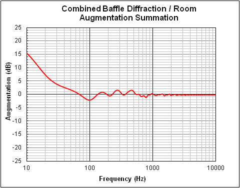

1) Use a LARGE solid state amp plus digital crossovers with digital room equalization to BEAT THE BRUTE TO YOUR WILL.
2) Simulate your room gain effects and shove the cabinet against the back wall, or into a corner, with a custom equalized crossover to obtain good quality low bass.
3) Build a LARGE rear bass horn.
GO'ing large allows a cabinet width of 26"-32" which allows the bass-midbass crossover to also cover the baffle step compensation. This both simplifies the Xover and allows the midbass to push its maximum SPL/watt efficiency.

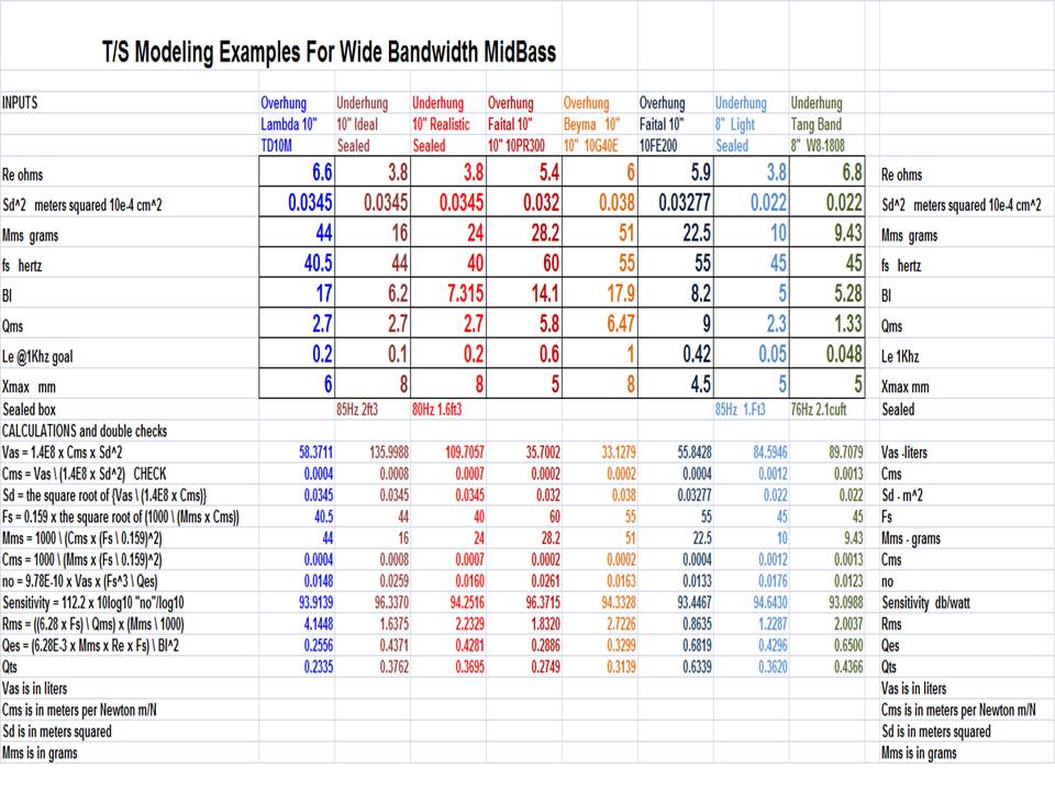

Can't quite stretch to the Lambda's at the moment. But I notice it is low mms, very low qts and high dB/w/m, meaning Bruce Lee speed and control but not enough weight & power for the 'one inch punch'?
What sound difference would this have to a heavier cone with a middling qts of say 0.35? And as for polar response - theres another hat in the ring 😕 Will look it up but any explanations welcome 😀
Bruce Lee's light weight did not stop him from delivering a killer one-inch punch. 🙂 The 10 inches with very strong motor, Qts<0.25 and Fs>60Hz will really start to get a higher f3 in the small sealed cavity, so it's a matter of modelling what fits your need. But I do believe that the higher sensitivity, low Qts and low Mms will deliver the most dynamic performance and plenty of punch.

IMO, a light Mms can be punchier. The heavy cones are often used to get Fs down and produce more bass, at the expense of upper-bass and midrange sensitivity. There are upsides and downsides to this, as everything in audio is a tradeoff, I just think the ups outweight the downs, for my preferences.

So i think I'll chose a 10" for the mid. Where abouts to cross it over depends on the driver but 2k is my goal.
A 10" with say 9" diameter radiating surface will start to beam over ~1500Hz. Well, it's not like a brickwall thing, it's gradual, but you might get away with 2kHz Xover if the HF unit above this has a controlled directivity that matches that of the 10" at this point.
