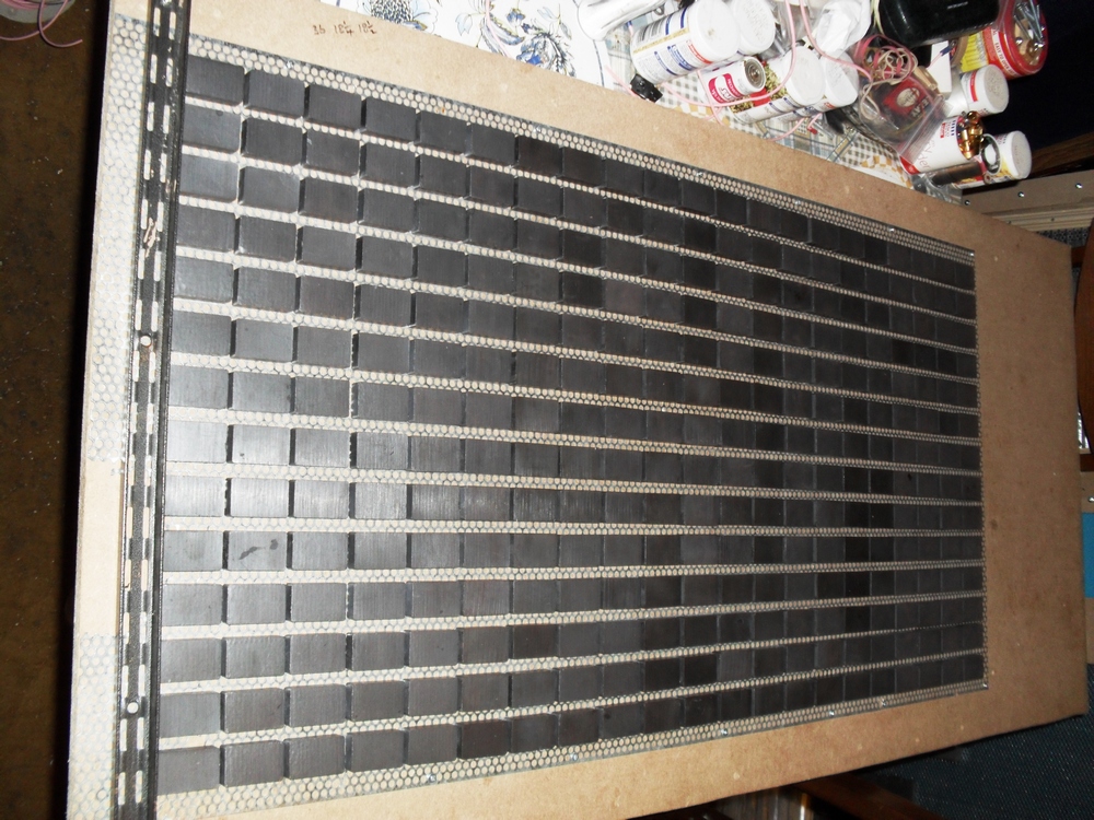

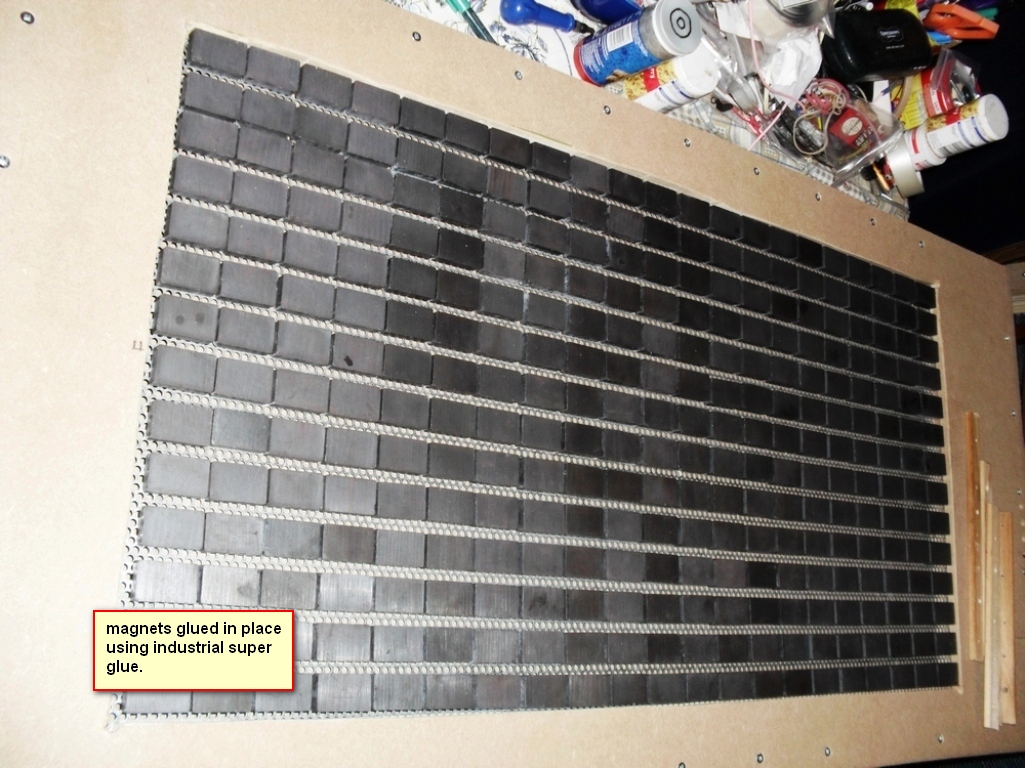

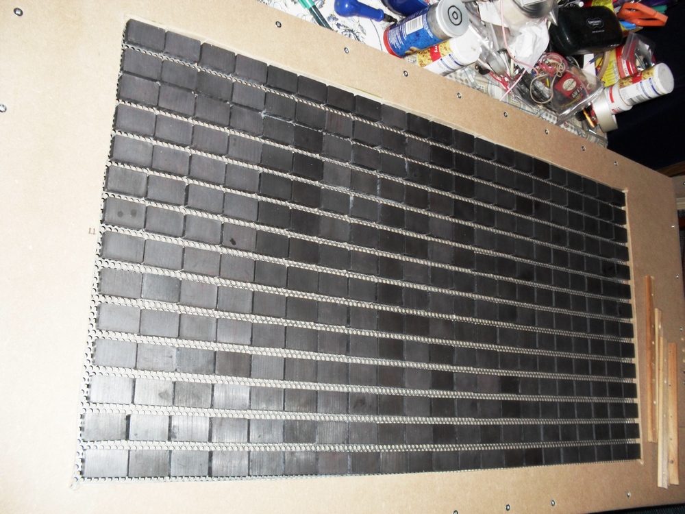

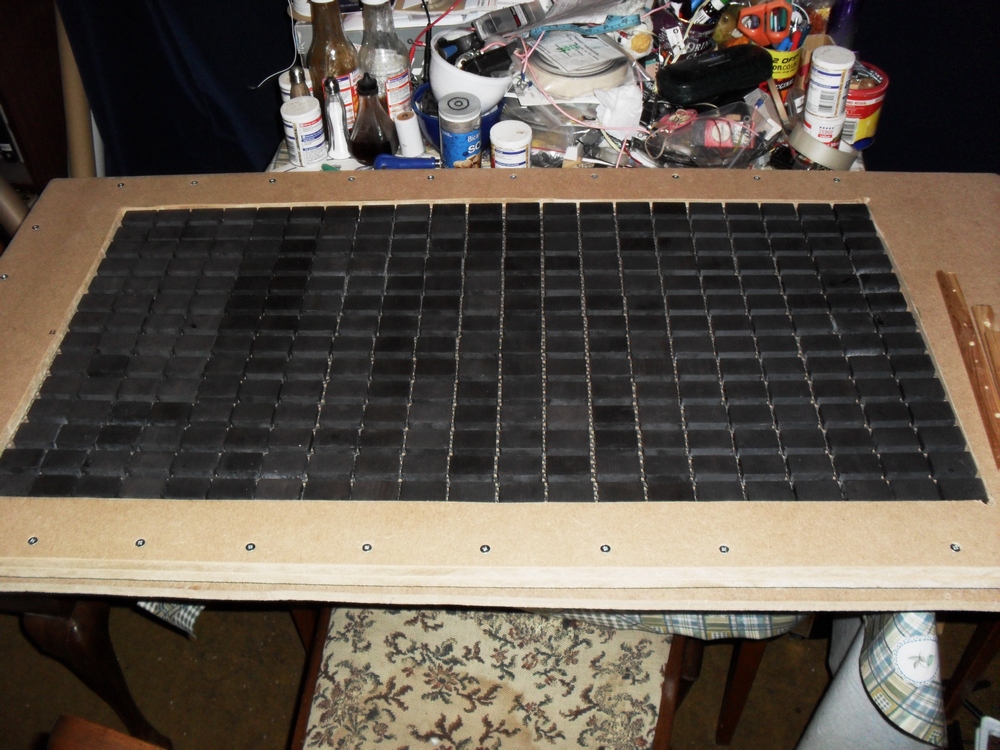

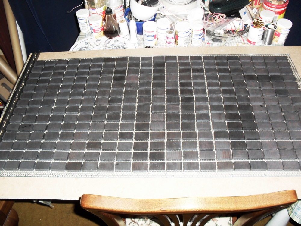

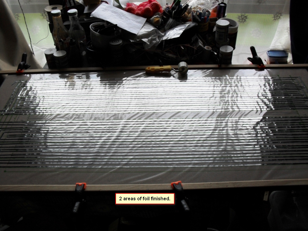

Finished gluing at last, hope they don't fall off. Have cut the mdf to shape needs de-burring. Putting the foil on should be interesting. Have used 294 magnets. Won't bother corrugating the foil. Not had to up to now! can't wait to see how it compares to my many designs.🙂 Hopefully. Will fix the membrane in my usual way with wood and screws, no rattling etc.
The magnets cover an area of 36" x 18.25" and the size of the speaker will be 4' x 2'. It is a full range speaker and does not require a crossover. Depending on the impedance of the double sized membrane, I just use resistors to get 4, 8 and 16 Ohms, so you can use it with various amps,so no problems driving these speakers!! Hope to have it up and running by the weekend. If the magnets don't fall off, first time I have glued the magnets on. Didn't need to before.
An you do know.... that the Apogees Bass skin it self is biger than the mag....So your speakers will be biger than you mag layout...is this right ?...thanks
The magnets are in position in speaker frame Frame size 4' x 2'. Magnet area 36" x 18.25".Will mark out the diaphragm tomorrow, should be fun!! I had trouble with the magnets when I moved the MDF frame, but only 21 magnets came unglued could have been a lot worse. You have to be very careful moving the frame.🙁

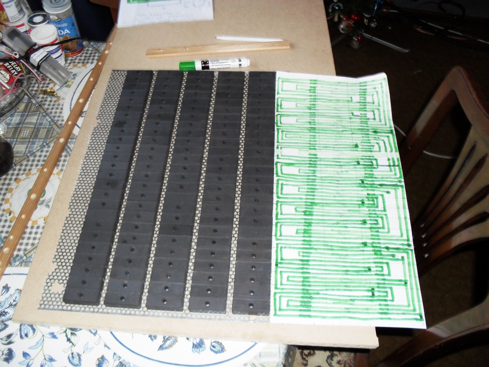

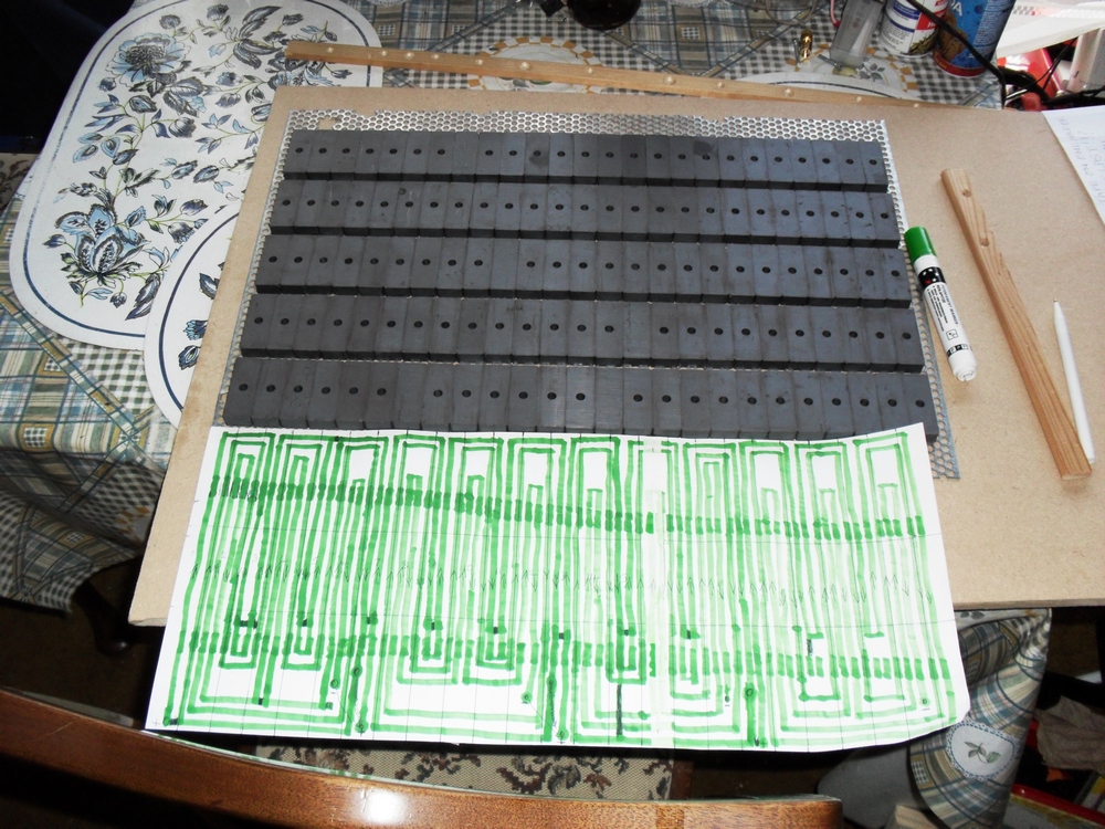

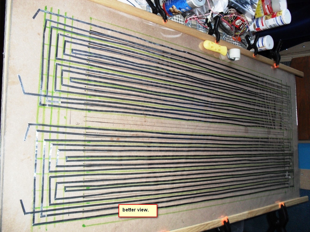

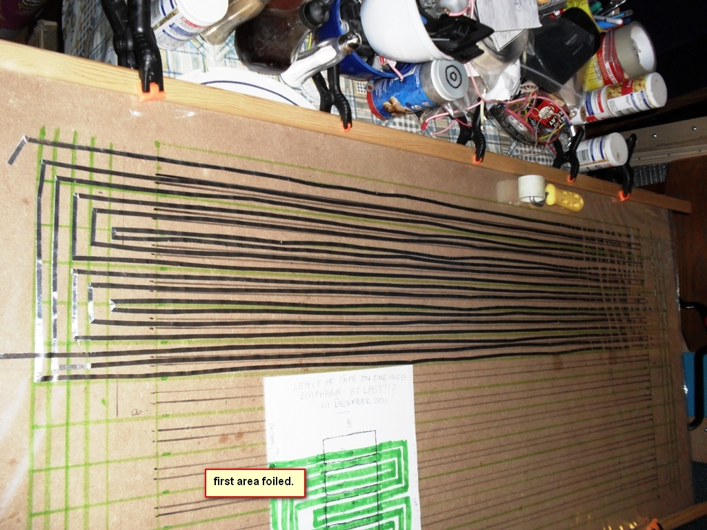

Made a foopha marking out the diaphragm, will have to do it again. I must be going senile! Lost a day.I usually buy my magnets from china and I usually buy at least 1000.Even tho' the postal cost is high, they are still cheaper than anywhere else! Although first4magnets sell40 x 25 x 10 mm ones- the price 50 for £20.63. Although you could probably get them cheaper if you buy more, hopefully.

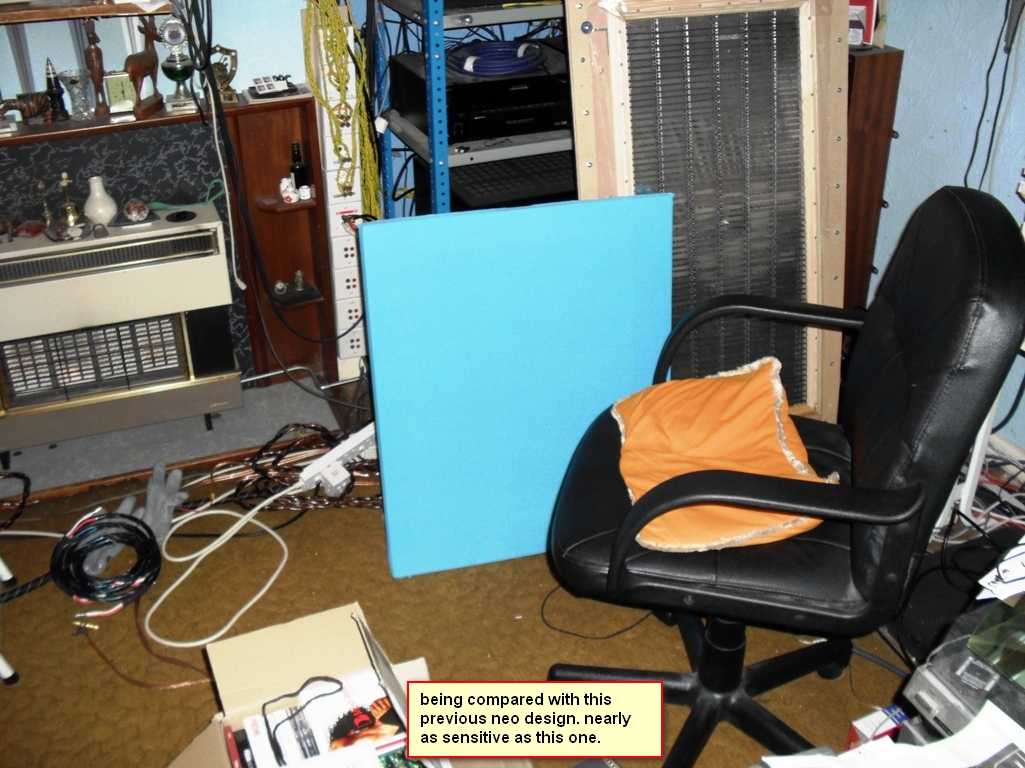

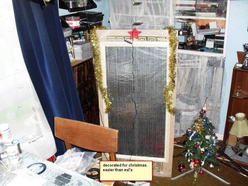

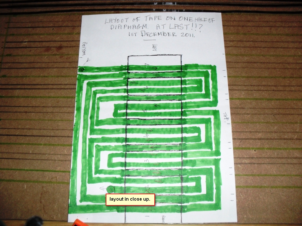

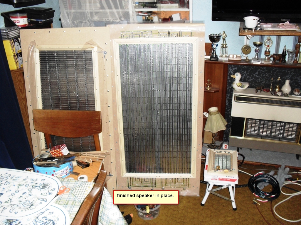

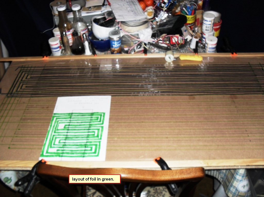

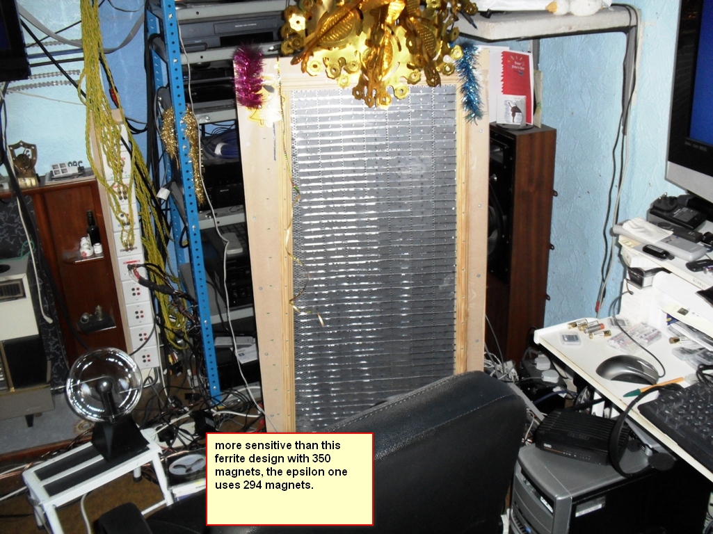

Have finished my double diaphragm based on your photos on this site, and I am very pleased with the result sounds great. Am running it in will send photos later today. I was without my computer for a few days. So have a lot of catching up to do.The two membranes are in series and the total impedance is 9.6 ohms. So I didn't need any resistors. I have only used one input instead of my usual 3. As I said it sounds terrific. I joined the two alu tapes up out of phase, and it didn't sound great and I nearly called it a day with the design. But when I wired it up in phase it sounded wonderful. It was nearly as sensitive as my neo design of the same size.
built 2 of the epsilon diaphragms on the same diaphragm and have wired them in series making it 9.6 ohms total impedance as the only size mdf was 4' x 2', and I had a perforated sheet which I had removed from a previous design so I fitted 2 epsilon diaphragms on it. Will be sending photos later today!!

double epsilon clone
Here is my pics as promised. Will be building partner when I get more MDF and perforated sheet. Will also be building same design with smaller magnets, well not so wide 19 mm as against 25 mm., may build 3 epsilon diaphragms on my next but one build. Will see how things go.
