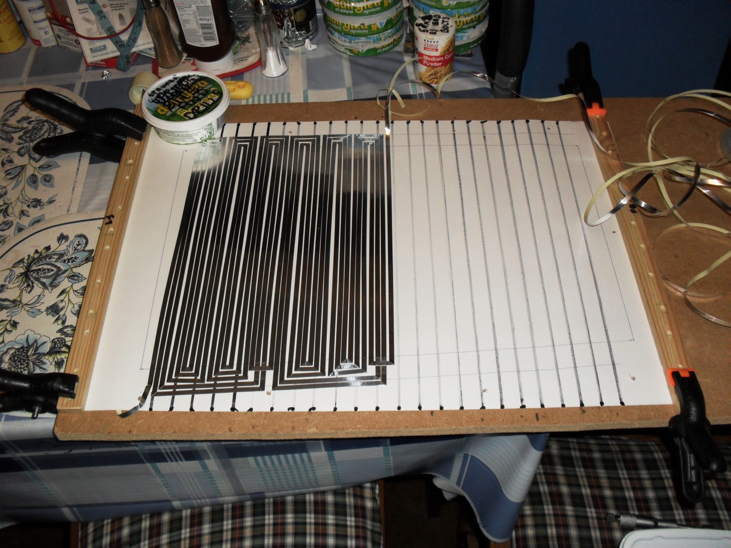

When I use ferrites the distance is 2 mm, and when I use neos the distance is 3 mm. When placing the magnets it is always NSNSNS etc. I have built the magnets both vertically and horizontally. I prefer the horizontal method overall, this gives better bass, I have found. I will probably experiment with tuning the diaphragm using springs. Should be interesting. I will have to experiment more as there are so many different parameters involved in building FRP I have found. Almost too many to get my head around. I only hope I am up to the task. Still we shall see, wish me luck.😀

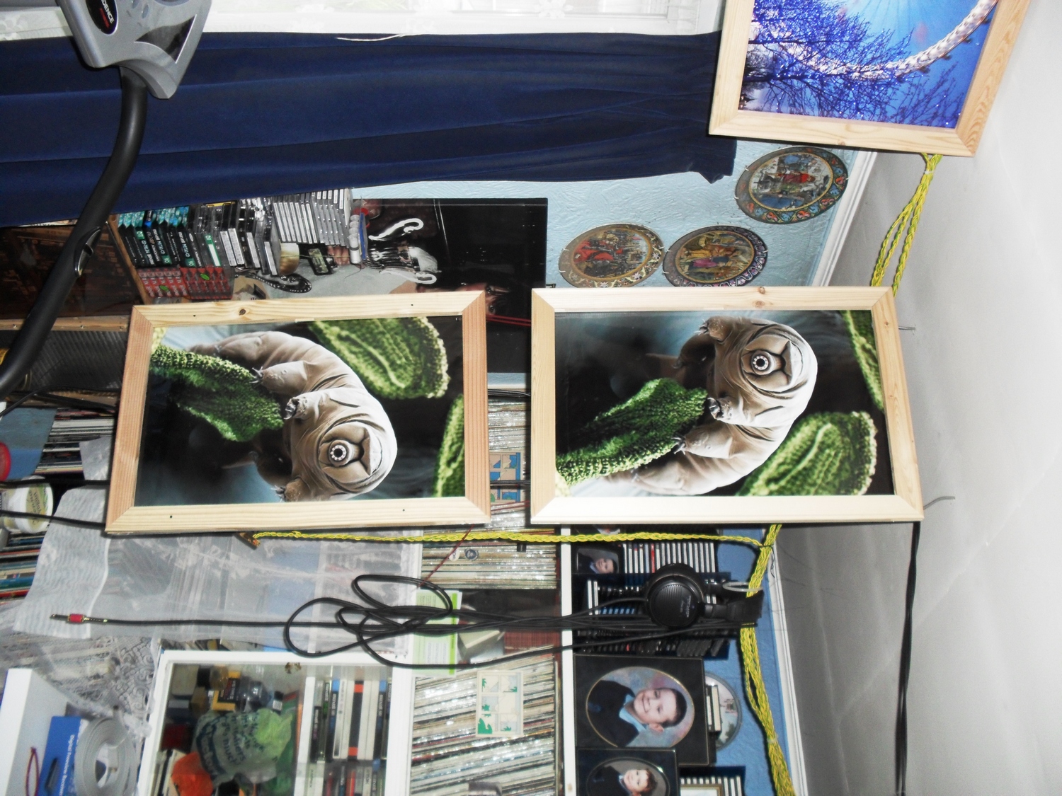

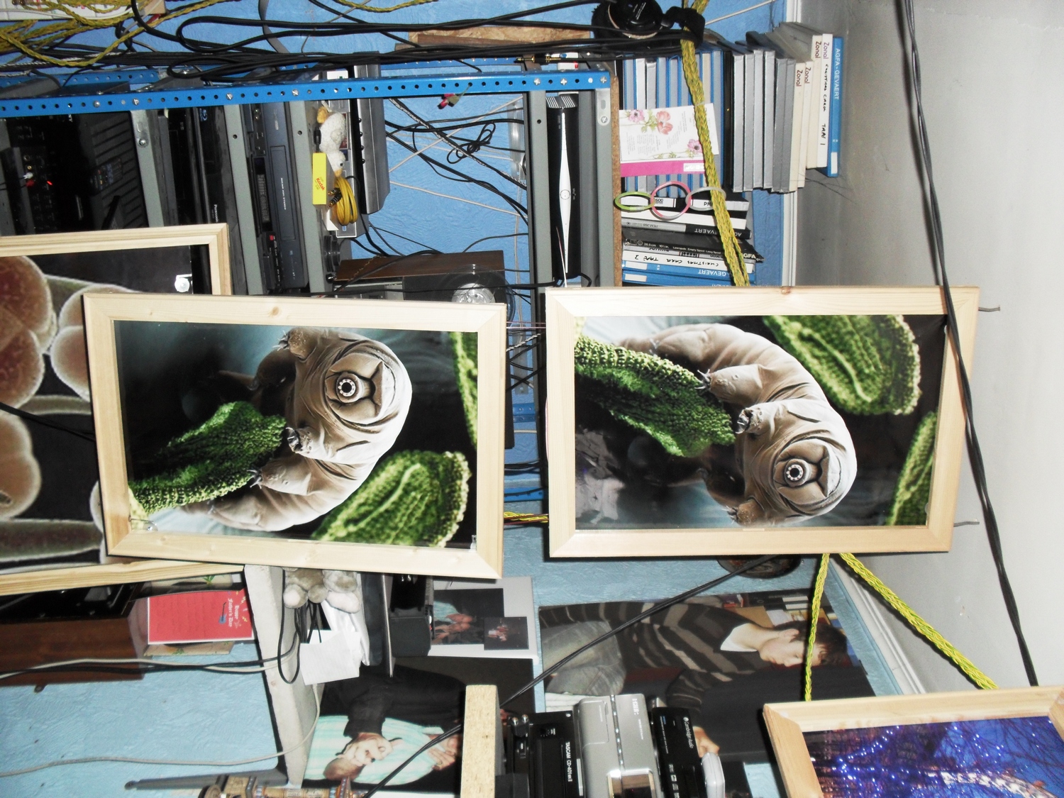

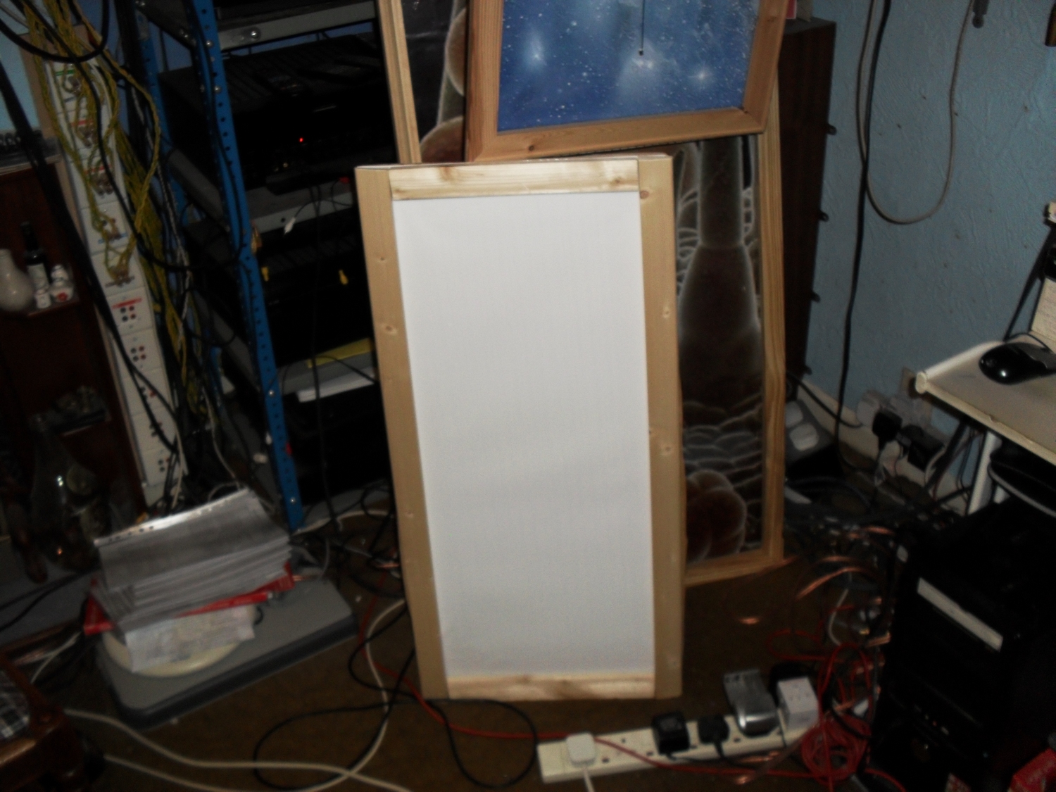

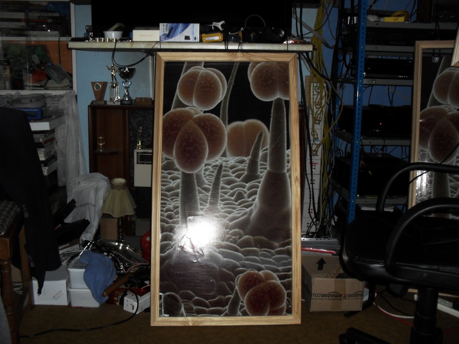

MY LAST DESIGN AT LAST
As I said I no longer use mylar for my diaphragms and use a different method of fixing the diaphragm. No problem with stretching as I don't use mylar any longer . Very happy with final results.
