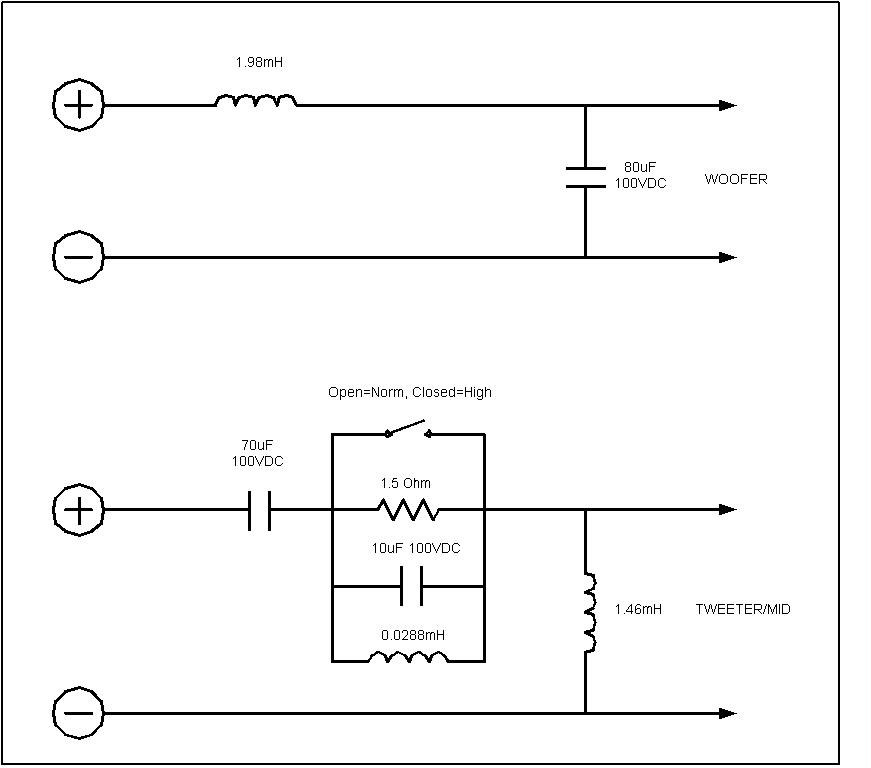

yep will do i have not traced out the xover circuit yet but i presume its 3rd order this is one area that needs experimenting with as the newer analysis models are first order ones.
Looks great...Wow i thought that all there crossovers were 6db ??....if yours is 3oder.... if this is the case you can chang yours to the 6db crossover..What amp...were you using with the stages??...an what amp is this....speaker wire looks good.....i have found with the ribbons... any changes made to the crossover ..wire... caps..even if you take a small peace of tape an put it on the coil wire well lower the base output....an can make the topend sweeter...any thing makes a big diff in the sound....thanks for your time
Tyu, my epsilons are an early example i think thats why they are 3rd order i suppose its swings and rounds abouts steeper roll off takes the load off the ribbon a bit more, 1st order its more efficient easier load more transparancy? we shall see when i experiment as i find simple xovers are normally better but not always. The amp in the picture is a tripath 300w stereo amp i made with a switch mode psu x 2 i still have my krell FBP200 but the auto bias adjustment on one channel is faulty causing it to shut down on overheat after a short time even the good channel gets too hot for my likeing i think krell should have fitted bigger heatsinks.
stage..........crossover same as yours...well the res. may be diff...an no switch...for high an nom...yous is set to nom....an cap size are diff... all 6db gos to 12db...so thay say

Will have to trace out the circuit and see what it is,the ribbon is supported in the middle and yes it does move quite a bit as it does down to 650hz

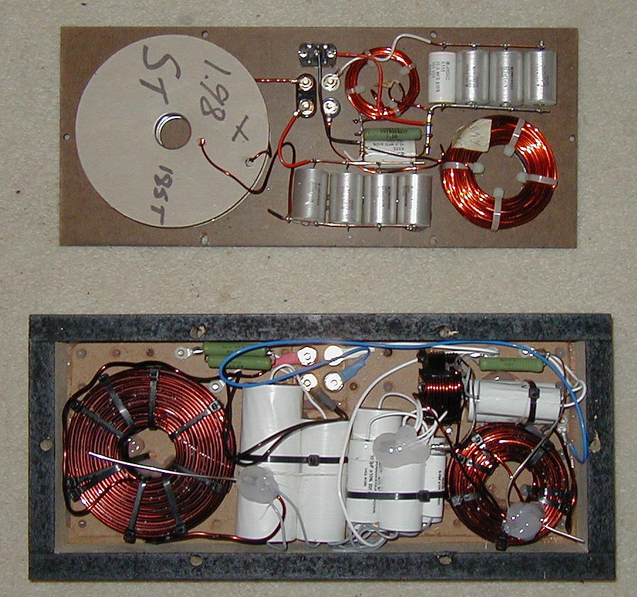

I found the prom.....with the over movement of the mid tweeter....the stage has a crossover board...Stock it has no pading you can see in the pic it the top......i found this pic of a North creek $1200.US...up gread crossover.for the stage....i saw the stock stage crossover...an saw thay added a pading...so i did the same....i lost 90% of the movement...can play the stages an get more out put out of them with this mod....My stages were made in 1992...20years old so...i was worred...
Now i have Magnepan with the so called true ribbons an thay have a LOT of move ment ......there cross over is like yours ....glued to the wood...i well be moving the crossover off too see if it well help as much....there tweer is all foil...no backing...i have never like all the movement....so i well let you know how it works...
my stage crossover is low 500-600hz.. like yours....so may help you to out board your crossover...sound is much better....Wow...sweeter top end
