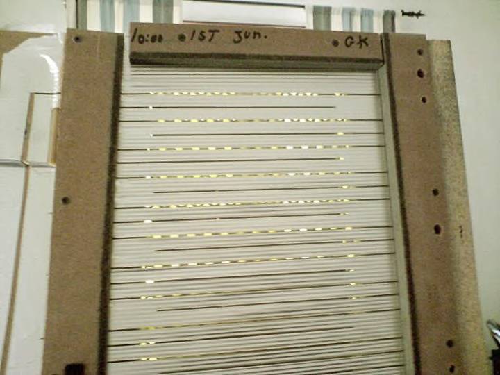

Here the deal.... the resion i got out of the Apogees was the bass ringing...after hearing the ringing, i heard it every time so i move on back to the ESLs...An have used A ribbions out of the Magnepans with the Acoustats....but after seeing the bass set up in these... thay have dealt with the ringing....with the rubber???
The more i look the more i wont....If you have not seen the Apogees....
The bass metel went under the wood....this made them ring....Now we no what thay did ....it all about the LOOK....well that was then $$ 5k for this look.

the thinner cpc tape would increase the sensitivity as the total weight of the diaphragm is important the lower the better! I have just started using 6um mylar with my 4.5 mm aluminium tape on my latest rebuilds. Although the thinner mylar makes it a bit more delicate to work with. I notice that the magnets are spaced, I have my magnets touching each other. This gives a stronger field and louder sound. All my speakers have 4,8, and 16 ohm inputs so you can drive them with any amp. I don't use any crossovers, which only waste power. I have built speakers ranging in size from 60 x 40 mm to 7' 2' in size, using ferrite and neo magnets, and I am still learning. I have many ferrite magnets left, so I will be busy for a while yet. I may even rebuild all my rebuilds as I learn more, wish me luck.!!!

Magnets, Can you see in the pix of the bass, how miney an what cost....Can you just gess....????
63 magnets of that size, you could use more of a smaller size about a pound each? Cheaper than buying a new one and very easy to replace the tape although I would do it as a continuous length myself. and would get rid of the gap between the magnets!They look even more primitive than my designs underneath!!If you place the magnets touching you can use tape of half the width. This would increase the sensitivity.
I think the Apogees were even spacet more a part....what up with that...magnepan also has a gap.....US i gess $2.ea...thanks for your input...

hi, yep the double tape is only temporary as all the rubber suspension is rotting away even in its present condition its the best sound i have ever had and i am afraid to say i have had more speakers over the years than i care to remember,once i get a suitable type of rubber i can effect a repair i only have to cut out the rubber from the diaphram as the panel itself is fine,none of this is rocket science just needs time and a bit of research. £3K to get a factory repair is beyond my budget and i believe i can repair them to a satisfactory level,the general layout and soldering of components leaves a lot to be desired so i will sort that out as well .time and a bit of lateral thinking and i believe these can be improved over the factory build as it looks like they were built in a hurry something i am not constrained by, i hope the current analysis speakers are built better my ones may have been early ones so they may have inproved quality control by now its quite amazing they sound so good in there present condition

Bryan t, Just out of curiosity how thick is the mylar diaphragm? I have started using 6um but is very awkward to work with, too easy to tear. The panels look very simple to replace on the epsilons. So why it should cost that much, I can't understand. I could build 5 pairs for that money. I hope all goes well for the repairs etc.

There's a different option:
Remove the bass panel and design a configuration of multiple conventional
woofers and appropriate XO. Maybe invest 1/3 of £3k and a bit of time for
development.
Crossover frequency is around 600Hz ?
Which are the specific properties of the bass panel that could
outperform conventional woofers ?
Horizontal dispersion matching that of the ribbon at XO ? Hm ...
Absence of breakup modes ? Hm ...
Efficiency ? Hm ...
Level of nonlinear distorsion ? Hm ...
Maximum volume displacement ? Hm ...
Low resonant frequency and rather high Qt ? Hm ...
This is DiyAudio isn't it ? Why don't take the damage and difficulty (cost)
in repairing as a start for something different.
Or maybe Jamesbos can develop a replacement kit ... seem's closer to you
than Athens.
