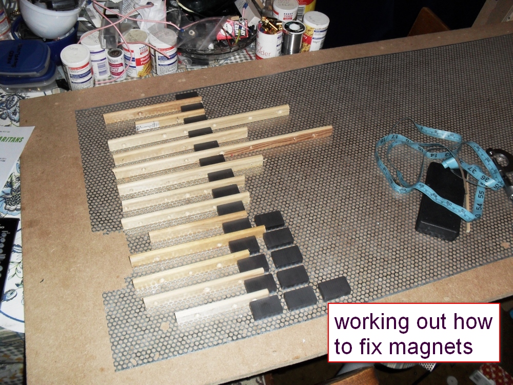

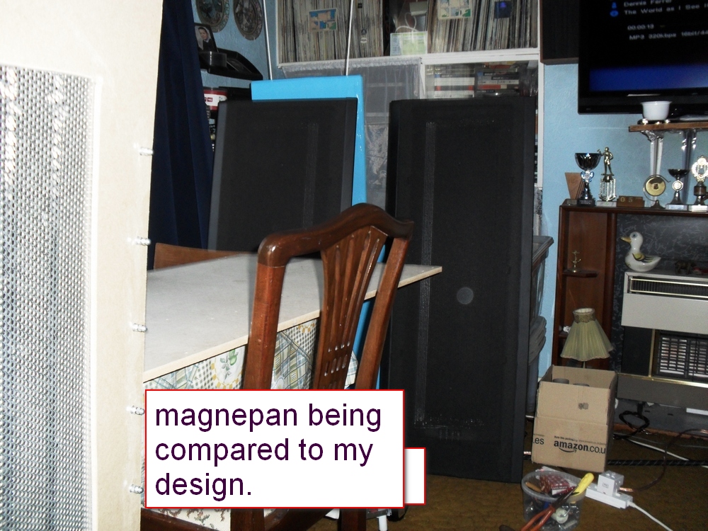

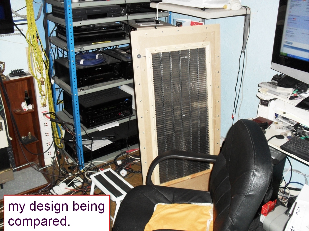

Am in the process of building a 4' x 2' FRP using the layout of the epsilon diaphragm. Using 40 x 25 x 10 mm magnets and 9 mm wide aluminium tape, and I will have to glue the magnets down because of the 9 mm gap between each one.This will save on magnets, compared with my designs which don't use gaps.Just to compare this design against my designs which use a lot more magnets. It is going to be a problem gluing down in the right position. If this method is more sensitive than my design. I will have to rebuild all my speakers. As I am using already glued foil I don't have do my own gluing on the mylar. Wish me luck.!!
henry my magnets cover an area of 240mm x 920 if thats any help.am still prototyping rubber samples at the moment am getting close to finding some with the right durometer . this is the main advantage with the analysis speakers having a proper suspension allows the panel to move more and you get a fuller bass compared to clamping the edges and they are more sensitive as a result just food for thought.

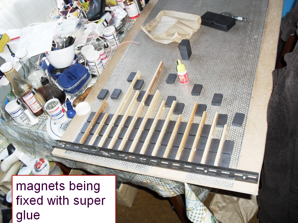

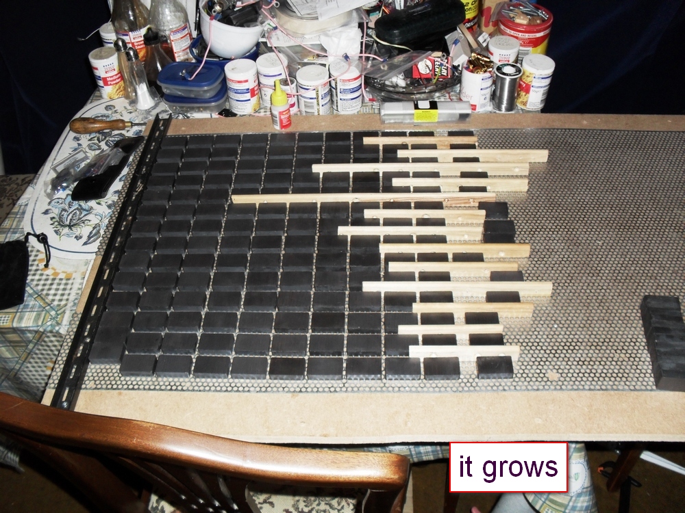

As promised my latest design is under way, sticking the magnets is a tedious job. A lot harder than just plonking them on. The perforated sheet was from one of my heavier designs, so has a few missing pieces. I had to unbuild one of my latest rebuilds for the magnets, to make a pair I may have to buy some more of the 40 x 25 x 10 mm magnets. I have quite a few 40 x 19 x 10 mm sizes, so may have to change future lay out of foil.😕
