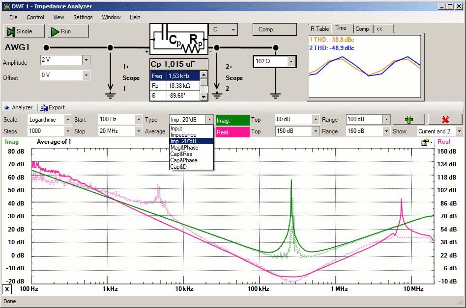

There is a test instrument, not fully working, of Impedance Analyzer. Having WaveForms main window in front type "nolimits", the window title will change and under More instruments you will have Impedance Analyzer.
Follow the connection schematic shown in the instrument: AWG 1 connected to Scope channel 1; Scope channel 2 connected to ground with a reference resistor and its value specified in the interface; insert the L/C component to measure between the scope channels. This test setup can be made on a breadboard.
In the dropdown after the L/R/C symbol you can choose between series/parallel approximation, L/C.
This is valid for WaveForms2.Follow the connection schematic shown in the instrument: AWG 1 connected to Scope channel 1; Scope channel 2 connected to ground with a reference resistor and its value specified in the interface; insert the L/C component to measure between the scope channels. This test setup can be made on a breadboard.
"nolimits" is reached by pressing ALT+F11
- allows to store some measurements and to pick one for comparision with the actual one
enjoy
