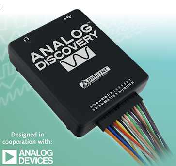

Has anyone ever tried this? A 14 bit/100 MSPS AD/DA module (built upon ADI stuff) which works as a 5MHz - 0.5 mV/div digital oscilloscope, arbitrary waveform generator, bode plotter, true RMS voltmeter and so on. I've tried the application in demo mode and it loks fine and quite usable - at 199$ (or about 160 euros) it seems well worth a try.

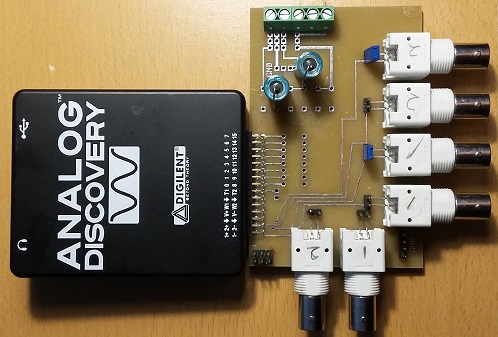

This breakout card made life much easier. It's not fully populated but the idea was to bring everything out to standard header pins and the inputs and outputs to BNC's with the inputs fully differential. Everything is standard digikey stuff. I have PCBExpress layout if anyone is interested.

Scott does it have more flexibility than the standard Digilent breakout box?
