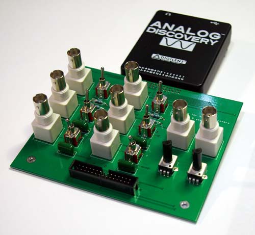

Scott does it have more flexibility than the standard Digilent breakout box?
Jan
Yes, it does full differential on the inputs if you want. All pins are brought out to standard .1 spaced headers, but I have never used all the digital pins.
I am using mine a lot as a network analyzer to check open loop as well as closed loop response, magnitude and phase. It is a great tool to check phase- and gain margin for stability. It shows for instance that 10dB hump at 1MHz that causes all the hf noise ;-)

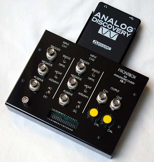

That is a very nice box! I wonder what it costs; is it also from Digilent?
Jan
You can click the link to go to the product page. From Softone in Japan, not Digilent. Seems to be discontinued now. I paid $80 as a kit. Quality is very high! The steel case is very nicely done and superbly finished - I wonder if Softone could still make PCBs only available?

Hmmm. Works for me on multiple devices. Here is the full link:
FrontBox for AnalogDiscovery
The project is thoroughly documented there.

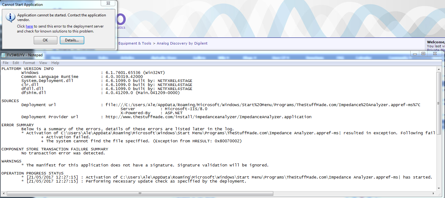

Hi Frex
I tried installing the latest version available from the Stuffmade website, but can't get it working in Win7. There is like an activation error, see screenshot attached
Can you please share your latest working binary? There are no previous versions in the website unfortunately.
thank you
Ale
got this message yesterday, too... 😀 😕 😱
Setting date back by one month did make it work again - annoying.
Ulli
Ulli
Hi Ulli,
Very curious, changing the date to March works for me (on win7).
What version of the software do you use ?
Frex
Frex
Hi Frex,
WaveForms 2015 (3.3.7) 64-bit
Impedance Analyz Version 1.0.0.36 - needs ADv1 ,-(
hth
Ulli
