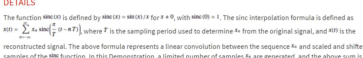

There are two sinc functions to distinguish. The first is the brick wall that used as low pass filter for anti-aliasing, described here Sinc filter - Wikipedia
And the second is sinc interpolation following the formula
If the first sinc filter is easy to implement, the interpolator is problematic.
attachment.php

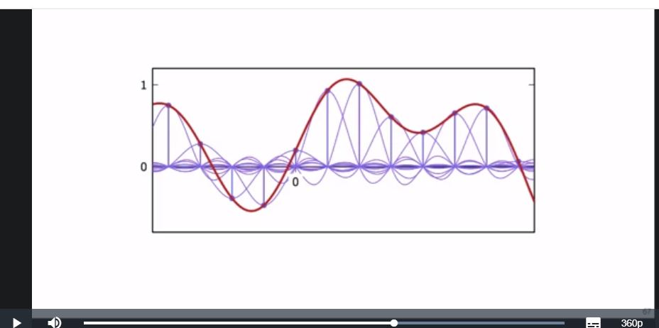

An example of few points is this. Each sampled point has its sinc calculated all added.
3.2.1.c Sinc interpolation - Module 3.1: Interpolation and Sampling | Coursera

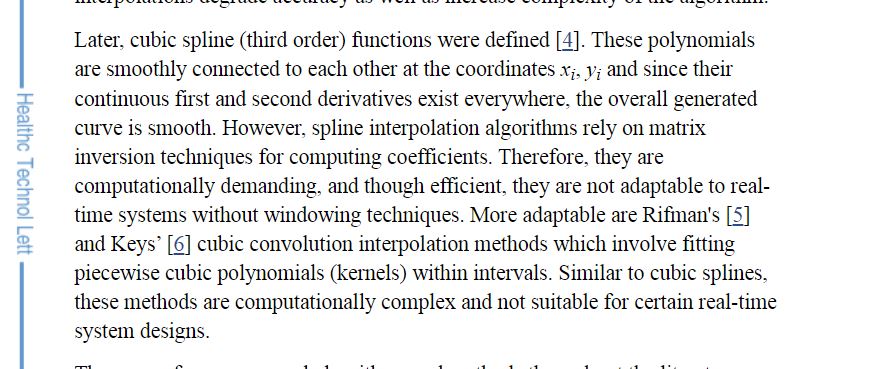

If the sinc interpolator needs many samples, the cubic spline is best whished for four samples only but too difficult to implement digitally.
One is not more or less problematic than the other: both can only be approximated because of their impulse response that extends infinitely far in both directions. You can approximate them quite well, though.
I don't know much about cubic splines, but if you can't describe them in terms of a convolution with an impulse response, they are probably non-linear and cause distortion.

Interpolation is to decrease the harmonics of step character. With cubic spline they are expelled above 3×fs. With interpolating the derivative and passing through an integrator, the harmonics are smashed even without any extra filtering. The FFT of simulation shows clearly.
For my understanding, what would be the result if you put this signal into your cubic spline interpolator:
..., 0, 0, 0, 0, 0, 1, 0, 0, 0, 0, 0, ...
where ... means that the zeros repeat indefinitely on both sides?
If the 1 were replaced with some constant x0, would the output signal just get x0 times larger?
If so, then would an input signal
..., 0, 0, 0, 0, 0, x0, x1, x2, x3, 0, 0, 0, 0,...
result in the sum of four time-shifted responses as calculated in the first step, scaled by factors x0, x1, x2, x3?
