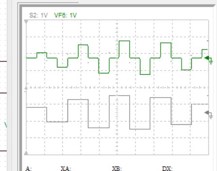

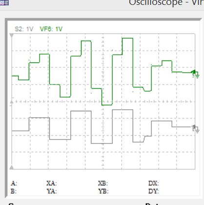

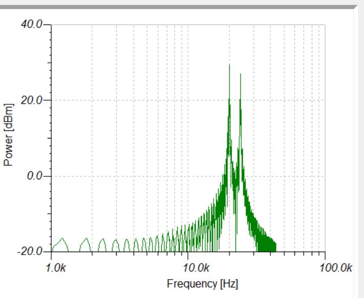

This is the result of oversampling by adding zeros.
The two types of oversampling proves the wrong information that oversampling pushes the image frequencies higher, even though there are lot of documents including from Analog Device that says so.
Should I consider the image treated on post 258 as hoax?
By adding two samples delayed 1fs gives the same image.
I don’t know what exactly you are doing, but didn’t I tell that after adding zero’s the digital spectrum is still the same because you added no information, but only the Sinc has widened after the dac !
So you first need a digital brickwall filter to remove the mirrors.
It seems you added only one zero. So your fir filter should go from 22.05 to 44.1Khz.

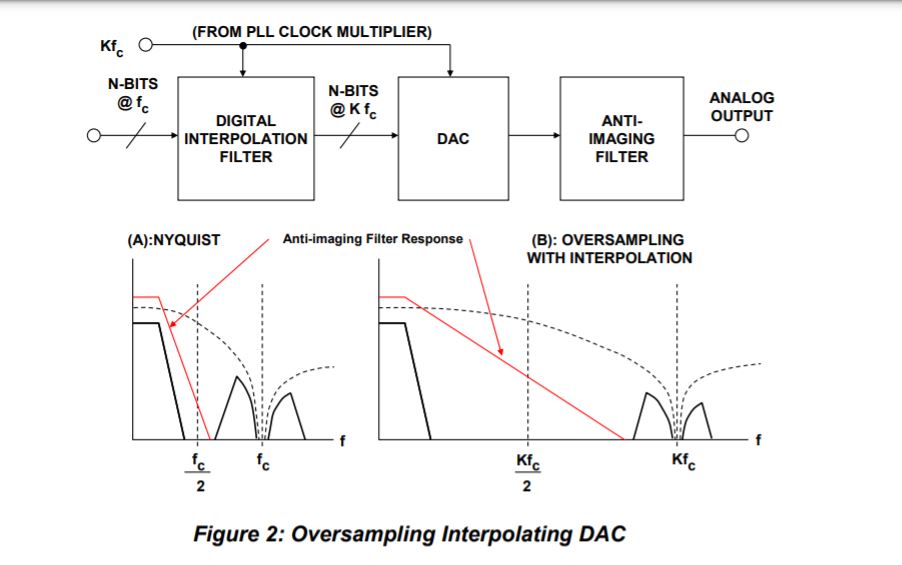

https://www.analog.com/media/cn/training-seminars/tutorials/MT-017.pdf
This is PCM1794 in oversampling and NOS mode without any kind of output analog filter. Sigma-Delta might be but it copes with theory. Although I can listen to both, I have to rewire each time so not exactly AB comparison. But I think it's safe to conclude that the treble roll off is audible and also that the NOS makes different -better for me- sound stage. Currently, I'm rebuilding it ...slowly. It will allow to select OS, NOS and some kind of output filter during playback. I'll report back.
That's exactly what I said, the spectrum stays the same until you have filtered the images with a brickwall filter.It is many documents online describe that by oversampling you chase the image frequencies higher and filtering them becomes simple. This what I show it is 99% wrong because only Sinc interpolation of at least a window of +/-10 samples can do, all others keep the image where it is.
Only upsampled AND digital brickwall filtered makes the analog filter simpler.

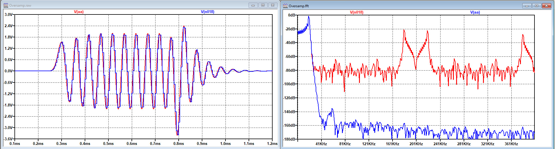

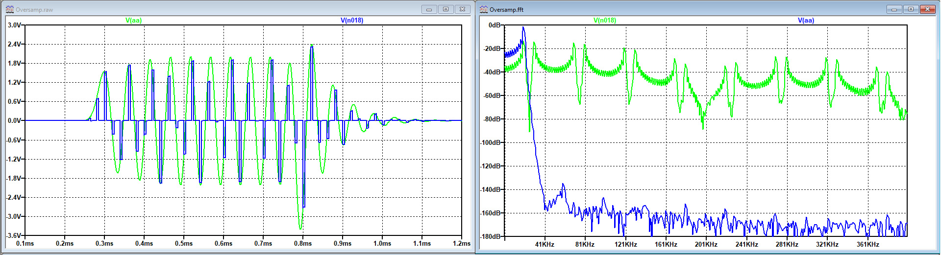

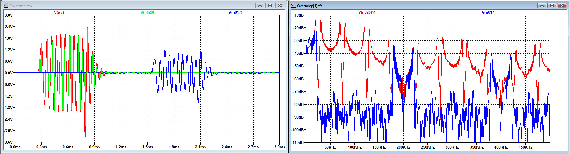

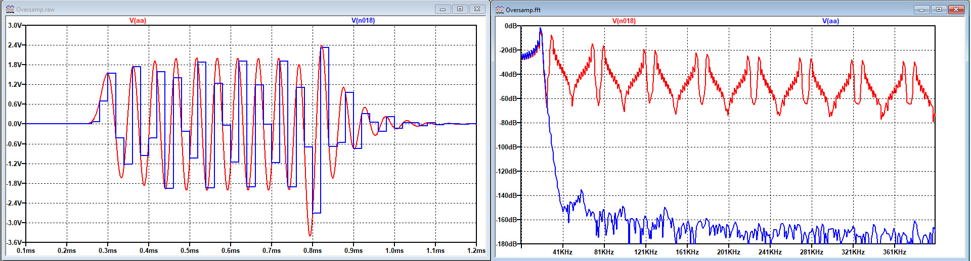

Here is what I promised to do.
I used 50Khz and 200Khz as Fs while that was a bit easier to handle.
I offered a 20Khz sine burst, anti aliased with a 20th order butterworth filter before sampling.
-First image shows signal + spectrum at Fs=50Khz.
-Second image the same but now at 200Khz.
-Third image shows the 50Khz version but now stuffed wit 3 zero's and clocking at 200Khz,
-Fourth image shows time and spectra before and after a 512 points LP brickwall Fir with a passband until 20Khz.
As you can see, Sim is not very much optimised, but good enough to get the message, and as you can see in the fourth image, the mirrors are now around 200K, 400K etc.
A simple analogue LP filter can now remove the the HF content.
Hans
P.S. So the Fir filter is not an upsampling or a reconstruction filter, it is just a LP Brickwall filter.

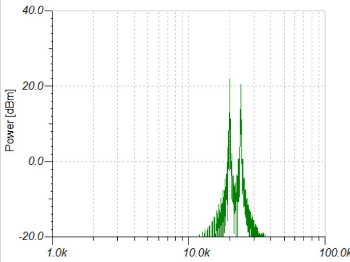

Why don't you show clearly the 30khz image with 50khz sampling, and after filling with 3zeros the 50khz image disappear, there it will be convincing.
Sorry, can you please explain in detail what you mean, because 30Khz is above nyquist ???
Why is not convincing in what I have sent, everything I mentioned before is there, zero padding, Fir Filter and D/A.
But my model is working and I can simulate whatever you want.
Hans
Hans
Excuse me, but I'm asking you again, what exactly do you want me to do ?
Offering a 30Khz signal without Anti Alias and sample it with 50Khz ??
That means that I get an alias at 20Khz.
That will never disappear after zero stuffing so ?????
Hans
