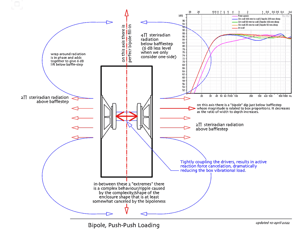

No i mean push-push. (90%?) of the energy that would normally be pumped into the enclosure.
Imagine 2 12s loading energy into the cabinet that is likely closer to what a single 3 or 4" driver would impart to the box.

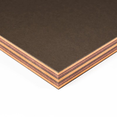

Interesting option for speaker building. Funny they don't include the Modulus of Elasticity (E) in the Properties sheet.
There is a download "Richlite Cantilever Spans" which gives tables of deflection for various cantilevers and simple spans, presumably for countertops. If we take a 12" wide by 1" thick material as an example, the second moment of inertia is I = b*h^3/12 = 1.0 in^4. Cantilever deflection is FL^3/3EI. The table shows .356" deflection with 150 lb weight on the end of a 24" cantilever, so the E should be (150*24^3)/(3*1*0.356) = 1.94 million psi (13.4 GPa).
That puts the elastic modulus close to high quality birch (per Eric Meier's reference) which is quite good. And presumably Richlite is anisotropic so don't have to worry about weakness across the grain.
With a half inch sheet weighing in at 104.5 lb it's quite heavy! Note the sound transmission test is only for 0.5" thickness. The 0.75" test is for plywood (for comparison?).

Thanks for your comments. I did an informal tap test on the 12 x 12 inch "partial sheet" of the Richlite-clad/PlyBoo-core Bamboo Stratum product I bought to make one BBC-Shoebox sized monitor front panel from. It seemed nice and high, but... it was also only one square foot.

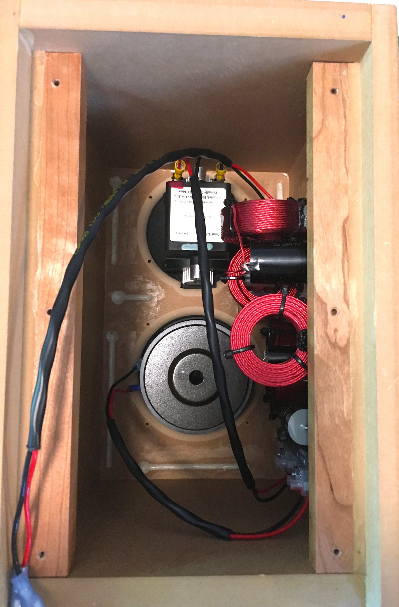

I should note that I asked my cabinet maker to get the Rockler router bit for cutting picture-hanging "key slots" in picture frames. I asked him to cut keys in the panel back and fill the voids with Saint-Gobain Green Glue. I can't find a photo that shows that in the Bamboo Stratum front panel but here is a photo that shows the same technique in a Stratum Birch Plywood front panel. I don't claim to have done rigorous scientific testing, but the "anecdotal results" are very good, and not just in my own opinion--I have a "Golden Ears" panel of friends who stop by to listen.

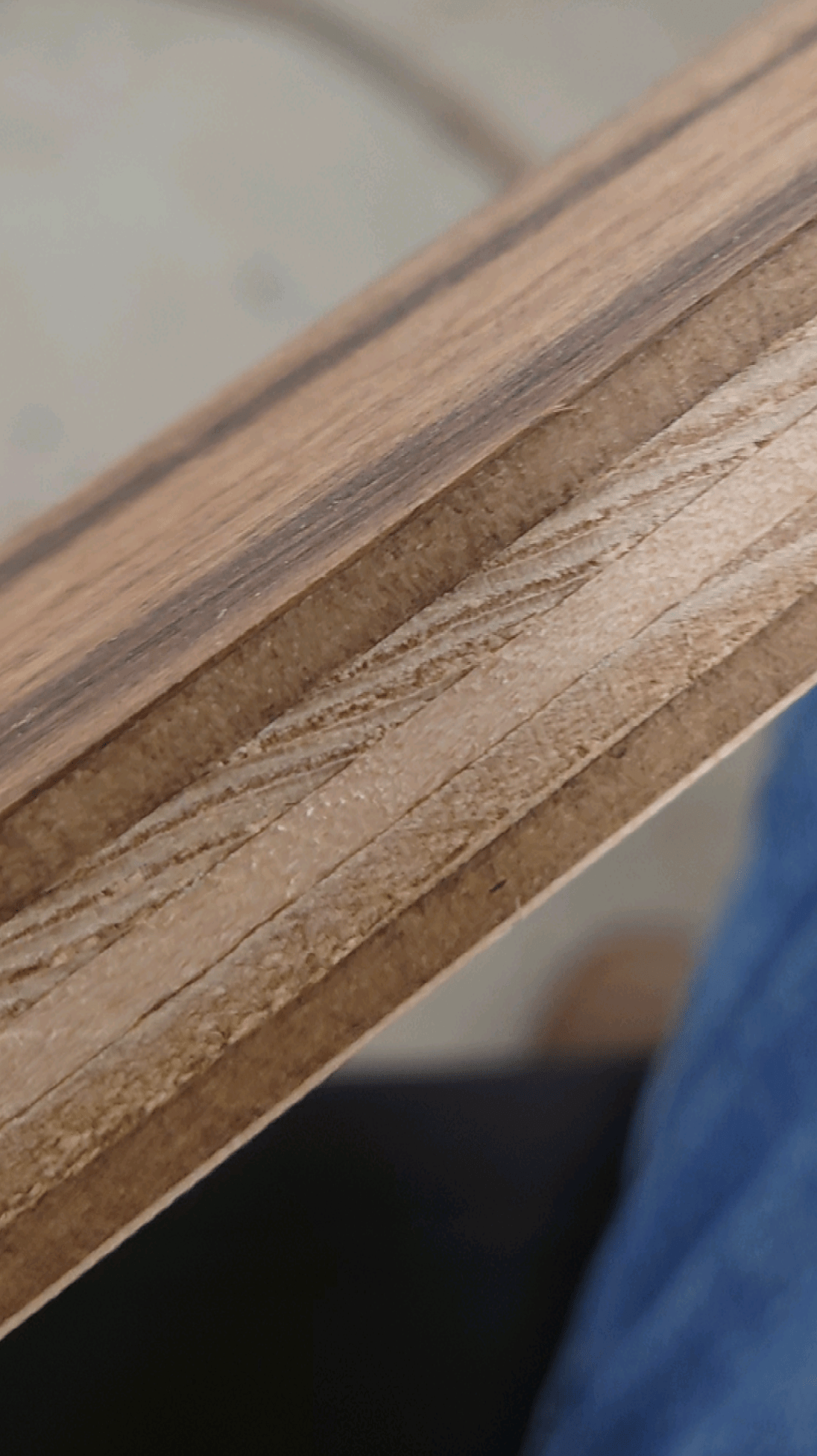

Interesting, I've never used western red cedar in a cabinet. I did use this ply, it's an MDF ply core sandwich and found it to be very dead. Not sure offhand what the ply core is but I could find out.
