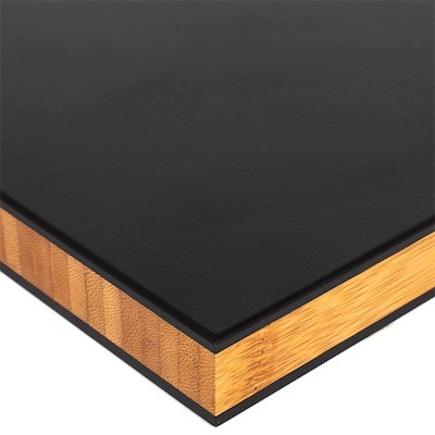

he PlyBoo bamboo plywood core, which is .75-in furniture quality vertical fillets with black Richlite 1/8ths cladding front and back
Is “vertical fillets” = “block core”? If so instead of a bamboo veneer, it uses Richlite. Be interesting to compare to the stranded bamboo, the difference then bein the outer veneer layers.
dave
I am not sure what "block core" is, but here's a photo. I have samples of PlyBoo, and the Richlite appears to be PlyBoo with Richlite "veneers."
I assume that there is some benevolent constrained-layer damping going on. Also, the Richlite machines beautifully with tight tolerances, and if you invest the work in it, you can have a suede or satin finish that is really nice.
But for me the biggest benefit is that is just SCREAMS, "This is not MDF!"
Here's a link to lots of instructional videos: https://www.ecosupplycenter.com/products/richlite/video-gallery/
ciao,
john

That looks like block core Plyboo. 👍 Dave and I have both used it for speaker cabs, it's great stuff. But I don't remember ever seeing it coated like that. Must be new?
Also, is the phenolic resin ply the same stuff used in the floor of shipping containers? That material seems very nice.

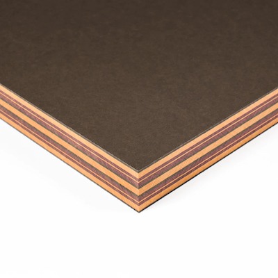

Plyboo Srand for comparison.

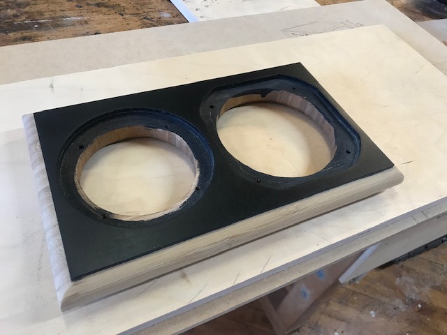

AFAIK, Richlite products are the real top end of that family of materials. They formerly had up a brag sheet of places where Richlite has been used in fabricating interior installations and partition walls and food-prep areas, and that list started with Yale. So, I assume that Richlite's birch plywood composite is way too expensive for shipping containers. Their bamboo composite is furniture-quantity. I dug up a shot of my Roxy Deluxe front panel before it got all the violin varnish. The short sides have the nice ply reveal that I think would look very cool on the front of a turntable.
ciao,
john

My next design will have a stacked-plywood cabinet shell (the front panel will show the striations), and with Richlite Birch Stratum sides, for more of a Mid-Century-Modern look.

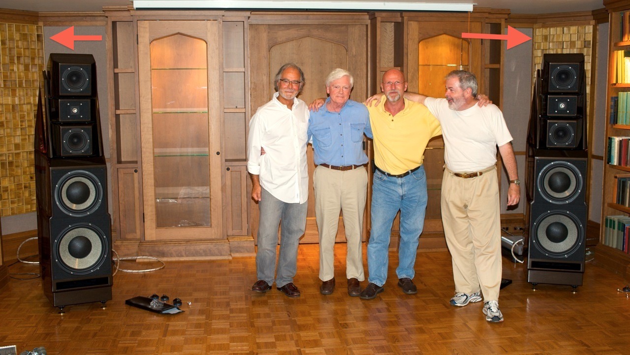

Could this actually be the basis for the much fabled Wilson Audio X material?
Comes with the same characteristics and X is also based on a phenolic and paper composite; often speculated with some Graphite added.
Hi. I am pretty close to Wilson Audio. The photo shows me on the far right, with my arm around Chris Huston, who was a close friend of John Lennon's in art college. Chris' band The Undertakers gave English "Blues Shouter" Jackie Lomax his first gig. Chris later won the Grammy for producing The World Is a Ghetto. The budget for that room was USD$1 million. That said, Wilson Audio keep their composites a secret, so I have never asked. BTW the arrows indicate the diffusion panels I insisted upon--24 such panels transformed the room.
Richlite was developed during WWII to make "drop boxes" to parachute-drop weapons to Partisans behind Nazi lines. It's a very tough material! That said, I think that as a practical matter, the plywood-core materials (bamboo ply or birch ply) with front and back Richlite laminations are easier to work with for loudspeaker boxes, in terms of cutting the material, and the weight of the finished project.
