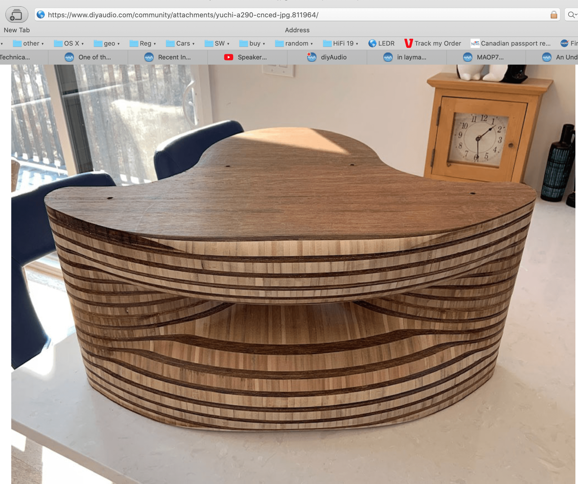

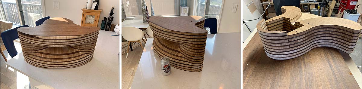

Had a closer look, there are 2 with block bamboo core, one with really smooth richlite, the other a bit less. The blocks are strips, not sure how such long ones ar emade, the plyboo we used had actual blocks, not quite cubes.

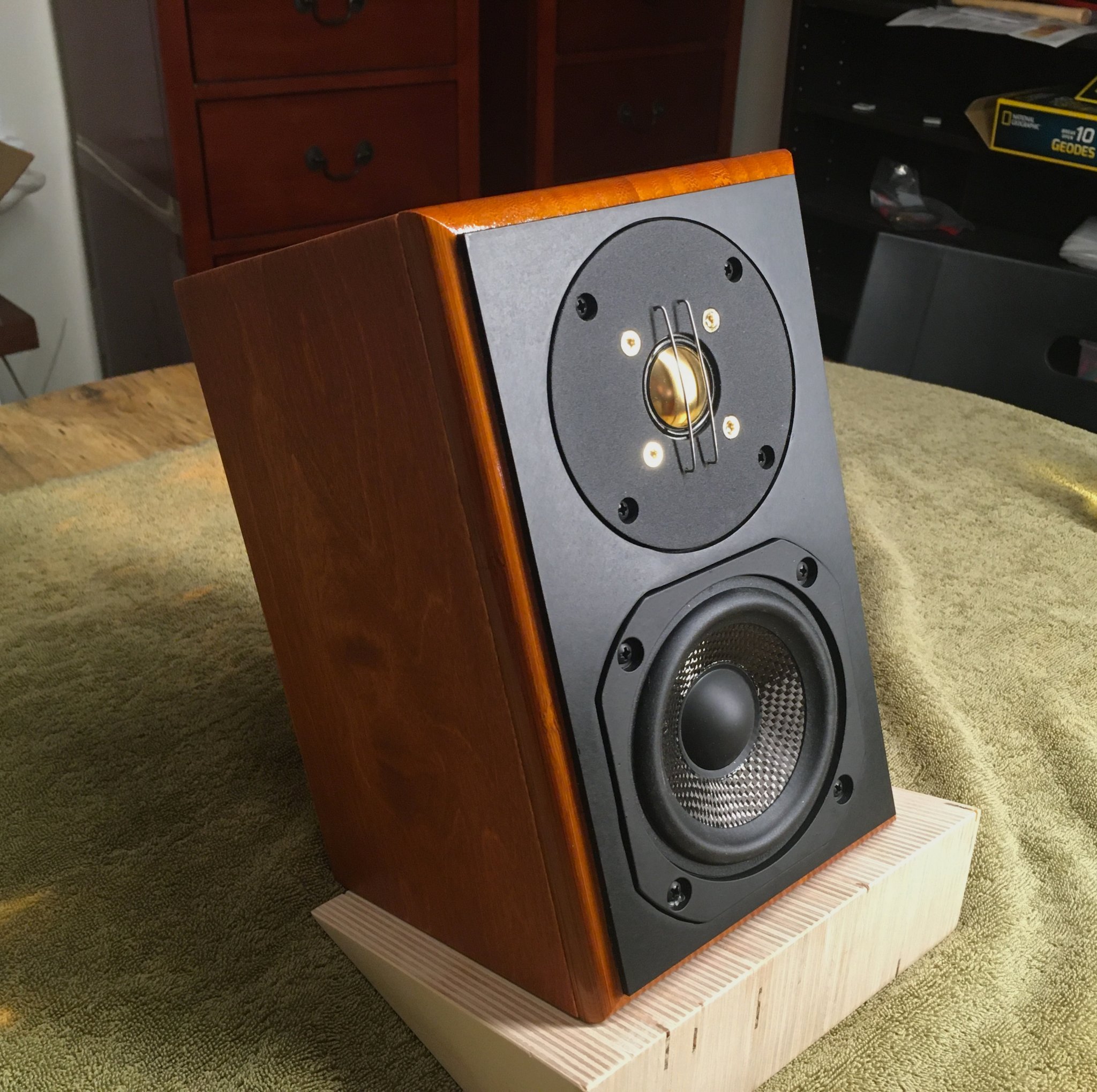

Over the years I’ve had access to some exotic composite panels, yet never considered them for speaker cabinets since more common materials can perform very well.
I had seen audiophile products that did just that, but figured it was to help justify a higher price, and appearance/bragging rights for the owners.
just an update from me,i have sent the guy on audio qualia a message to ask if he would test richlite,i'll report back when i hear something.
I think fern & roby's "raven" speakers (using a seas full range 8"), their front baffle is richlite.
