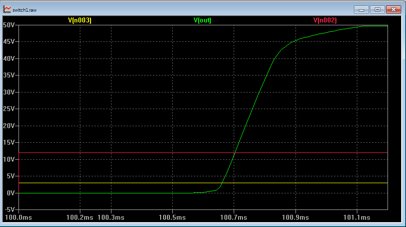

Well, with a simple photovoltaic ASSR-V621 and a mos: IRFP2907 (75V, 200A, 4.5mOhms)That's the point.
I am not concerned about the delay. I am concerned about transition time, when the switch turns from low impedance to high impedance
Off delay is 0.5µs, transition time near instant.
On delay is 1 ms, transition time: 0.55ms
Very satisfied ! No need for more.

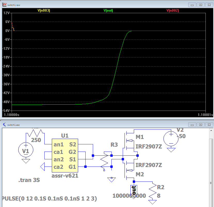

The integrated turn off circuit of the ASSR-V621 is exactly what I intended to solve with the PNP and diode. Great that they integrated this feature.
Looking like a pretty nice device. ...now I am starting to like this way.
BTW: From your sim for turning off I am reading about 5us delay and about 1us transition time - which still would be perfectly fine and trouble free.
Yes, sorry for the scale.about 5us delay and about 1us transition time - which still would be perfectly fine and trouble free.

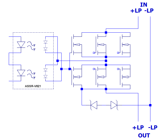

So the only solution i see for the moment is to add 2 zeners in serial, upside down across the Loudpeaker's outputs after the MOS to protect them a cutoff. It looks like it works fine.

We will try to set the printed circuit to allow 3 sets of traditional MOSFETs (3legs) to be mounted in parallel, reducing their influence by a factor of 10db, as well as one of those (7legs) Infineon ones.

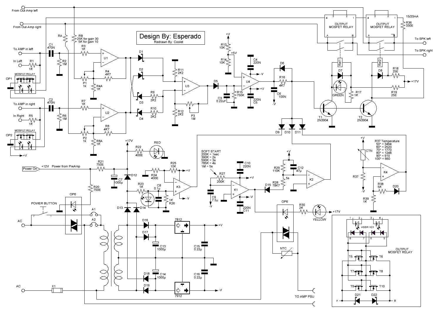

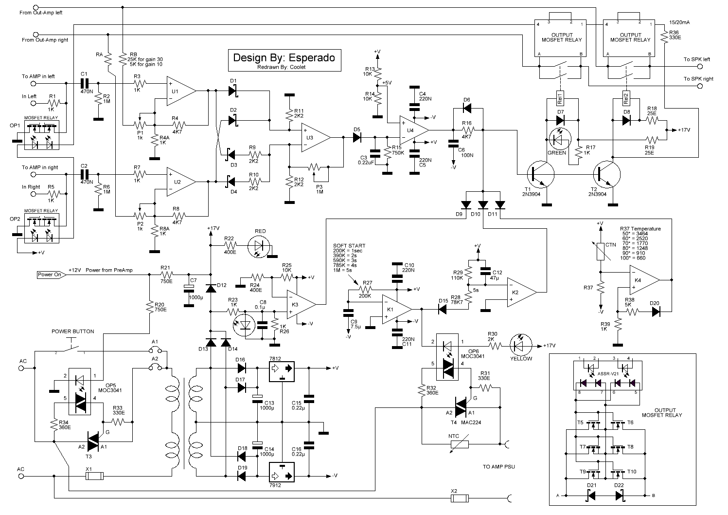

To Coolet, if you update your schematic, i will use-it as the default one in the first post of this topic. Now, i think everything is finisched on it. Changes of values can occur, but i think this can be used to design the printed board.
Nice.here it is😉
As 8 serial LEDs were too much for 12V, i have changed the way the static relay is powered. Please refer the original schematic. The value of the 330 ohm resistance had changed, accordingly.
Keep the way you have set the zeners protection, it looks to behave better during power-on.
I still do not understand why you have chosen the second version for static relays, they are numerous near all providers. So i will chose the first version, if you agree.
