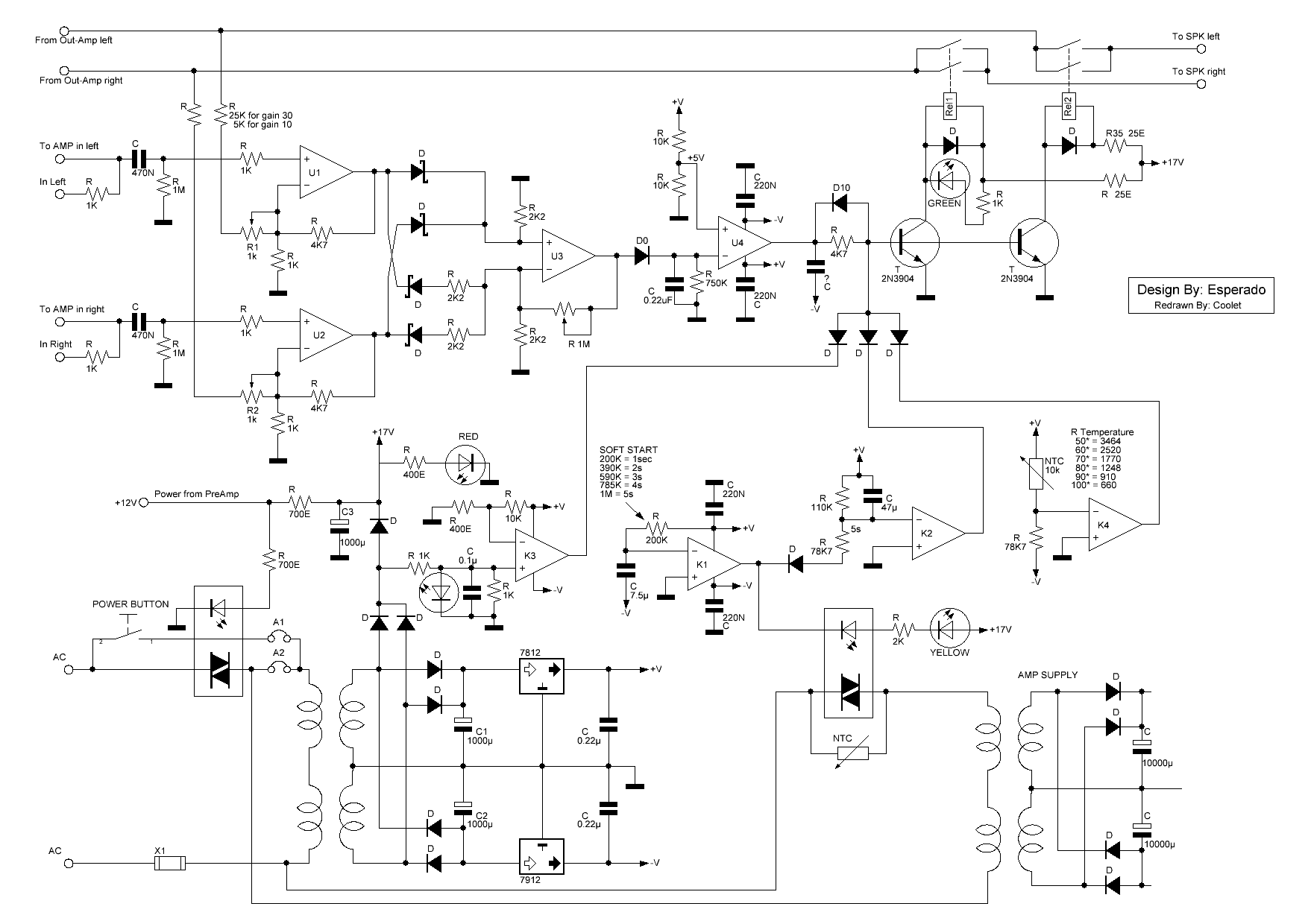

The R19 of soft start can be, or 4xCTNs of 2.5Ohms 5A in serial, (don't use them in parallel), depending of the capacitances and transfo you use, or 1x10 Ohms 50watts wired resistance or any combination.
If you prefer a resistance, it has to be wired outside of the board, and cooled on a raditator.
Different values of resistances for the delay before soft start is short-circuited are given. The following stage, with a delay of 5s add his own delay to the soft start one before music can play.
I hope some help to design the printed board. I think it will be better with discrete components than cms, for easy adaptation. I suggest for the ICs (must be high impedance= fets input) to use 4 in a package, like TL74 for the delays, ond a faster equivalent for the comparator.

Thoughts about your request:I guess this idea about temperature protection maybe can be added or not depending on the builder of the amplifier itself
Temperature sensing is builder dépendant anyway, as a captor has to be glued on the heat sink and accurate temperature triggering of any fan has may vary from one amp to an other.
Anyway, cause i have one opamp free, if we use quads packages. i will add a temp sensing stage to fulfill your request. Will try a choice, using the same components to fire a fan, or fire the protection, as preferred.

Added, using the last unused OPA, a temperature control, based on thermistor.
It can be used or to control a fan, or to fire-up the protection.

I believe it is complete. Just need a printed board design. An i have just to calculate a table of resistance values for temperature protection.
For values of the " R-température" to be tuned according your needs:
http://docs-europe.electrocomponents.com/webdocs/0a9d/0900766b80a9ddbc.pdf
Some values had been added on the schematic.

The input solid state static relay can be: G3VM PCB Omron. ( MOS FET Relays G3VM-351B/E | MOS FET Relays | Signal Relays | Relay | Products | OMRON Electronic Components Web). But you need-it only if want to remote the power on of you amp with a 12v signal.
Some other values had been given in this thread.
The operational amplifiers are quads. U need to be as fast as possible, K high impedance (fets) and both no latches at+-12v: Avoid TL074.
No problem for your class AB amp: Chose the static relay and R10 or NTC according your power.

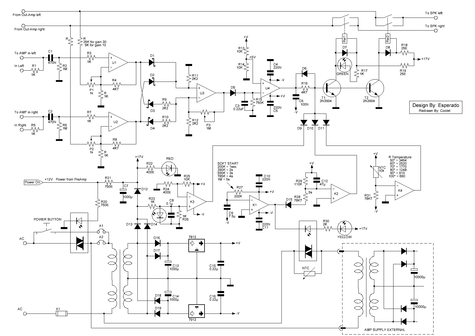

Looks very cool and much simpler ! Congratulations and thanks a lot.schematic redrawn... please double check for error![]()
The only difference is see is the 700E values instead of 750E, near power from preamp. don't think any effect. Value of C? can be 0.1µF.
You have changed the value of adjustable of Speakers levels: perfect. Easier to fine tune.
The 'amp supply' has no reason to be in the schematic, just AC connexions.
Green, yellow and red LEDs are out of the board, too (front of the amp) as we will see them fire during power-on sequence: red when power-on, yellow when end of soft start, green when Loudspeakers connected.

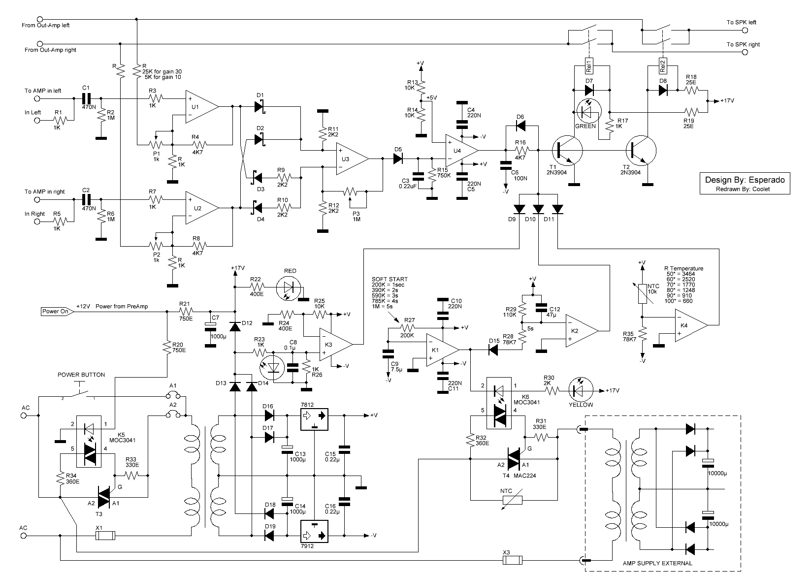

greetings any part no of opto triac used in schematic coolet you are a great proffessional pcb designer any chance for a pcb design if its possible
warm regards
andrew lebon
warm regards
andrew lebon
here is the original schematic from the author and modified schematic using moc3041.
Oh, it seem the you forgotten the speakers mosfet relays ?here is the original schematic
It optional, but offer some advantages as explained. Whatever people like to use them, or not, it would be nice to have them on the schematic and the future PCB.
