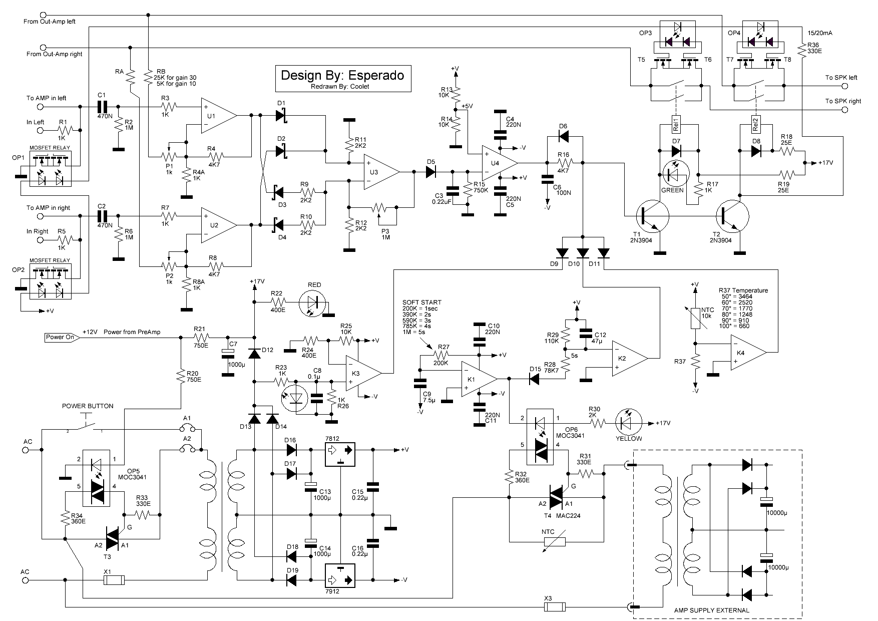

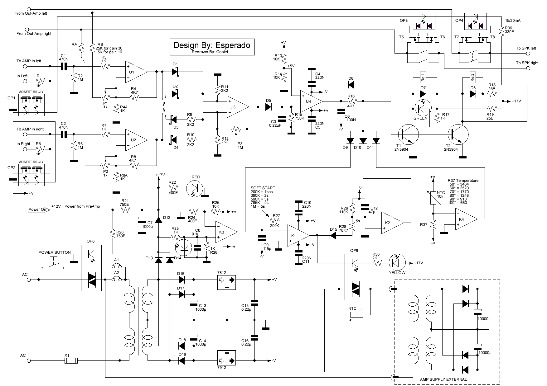

The R31 -> R37 value of 75.7K is not the good one. It has to be one of the values provided in the list, according temperature target.here is the original schematic from the author and modified schematic using moc3041.
WHat advantage did-you see, using moc3041 ? The original static relays wait for a 0 to allow switch of coils with no parasitic effects..

In fact, the components count are not so much for each feature: not only DC and soft start as some pretend. And expecteded to be cheap.its seems like the ultimate protection not worried about the component count

Here my proposal for hysteresis of the temperature. AT the start, as the temp is low, the CTN has a great value > than the Rtemp resistance: the out of the comparator is +12V.
When the CTN reach less than the value of Rtemp, the opamp will fire to -12V. Via the diode D, the + input, previously at 0V will go at ~ -2V. The OPA will stay in this state until the temp goes -10° under the temperature where it fired. Tuning the value of the 5K will change the ofset.

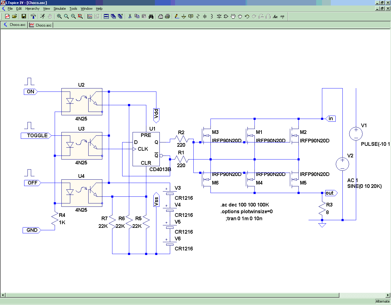

I build one last year based on an idea by Chocoholic, see attached.
I had a need for a fast ss relay for some test equipment so it uses a dedicated MOSFET driver.
IIRC it switches in just a few 100 nS.
The whole thing runs off 5V and is fully floating, can be used as a speaker relay, but also as power supply relay, up to several 100V (depending on specific MOSFET used).
The Rdson is just 10mohms or so and is quite linear with current so it does not introduce any distortion.

Direct drive from simple photovoltaic couplers cannot deliver much current and this leads to slow gate drive. Only for low power applications this solution will ensure switching inside the SOA of the MosFets.
Despite this there seem to be people who ignore SOA and did not report defects.
Jans approach is already close to the simplest solution, which provides proper gate drive. I think it could be simplified by reducing the pos/neg supply to a single positive supply only, but this will save just one e-cap.
Hm, with photovoltaic couplers, there are two improvements possible.
a) Speeding up the turn OFF needs just an additional PNP, while the turn ON could be kept slow through a diode. So additional one diode and one PNP will already give a reasonable turn OFF.
b) Ensuring proper gate drive for turn ON would need to charge a floating supply cap first and after the cap has be charged then turning on the MosFet with a NPN. Unfortunately the complexity including a uP-comparator would by far exceed the complexity of Jans approach.
==> With respect to the fact that turning OFF in case the amp is defect and the speaker has to be protected is the most important and demanding situation - chosing a photovoltaic coupler and enhance it according a) could be reasonable trade off.

Judging by both the manufacturers data sheet for the photovoltaic coupler that I used and the fact that my own implementation works just fine I believe these photovoltaic couplers can provide plenty of drive for this application. Turn-on time is a non-issue of course because a small delay in turning on is of no consequence to anybody. The turn-off time is of consequence and it is normal to add a resistor in parallel with the output of the photovoltaic coupler to provide a path for the FET gate capacitors to discharge. This is the recommendation of the photovoltaic manufacturer. The resistor has to be properly sized, too big and the turn-off is slower than it could be otherwise, too small and there won't be enough voltage to turn-on. It wasn't too hard to calculate the right value. In my view this approach is sufficient for a dc-protection device because the time for the FETs to turn-off is still short compared with the time it takes the dc-detection circuit to integrate the signal and 'determine' that a dc-error is present. So the time from dc-error condition to turn-off is dominated by the dc-error detection circuit and not the solid state relay.
I didn't want to introduce any more components than necessary as the fewest number of parts often means the most reliable.
I tested mine with a real speaker (not my most expensive one mind) and it works fine. There is no impact on sound quality. And of most importance - I trust it.
The one thing I forgot to include in my design was an ac-detect to shut off the speakers when the power to the amplifier is turned off - this would avoid any turn-off thumps. The problem with my amplifier is that the output does drift quite a bit when the amplifier is turned off, but it does so slowly so you'd never hear it. But with my dc-error detection circuit in place the output hits the dc-error threshold and my protection circuit cuts off the speaker and this makes it thump. So, ironically the dc-protect circuit is causing a turn-off thump which the amplifier doesn't generate on it's own. My advice - install additional circuity to cut off the speakers when you power down the amplifier.
