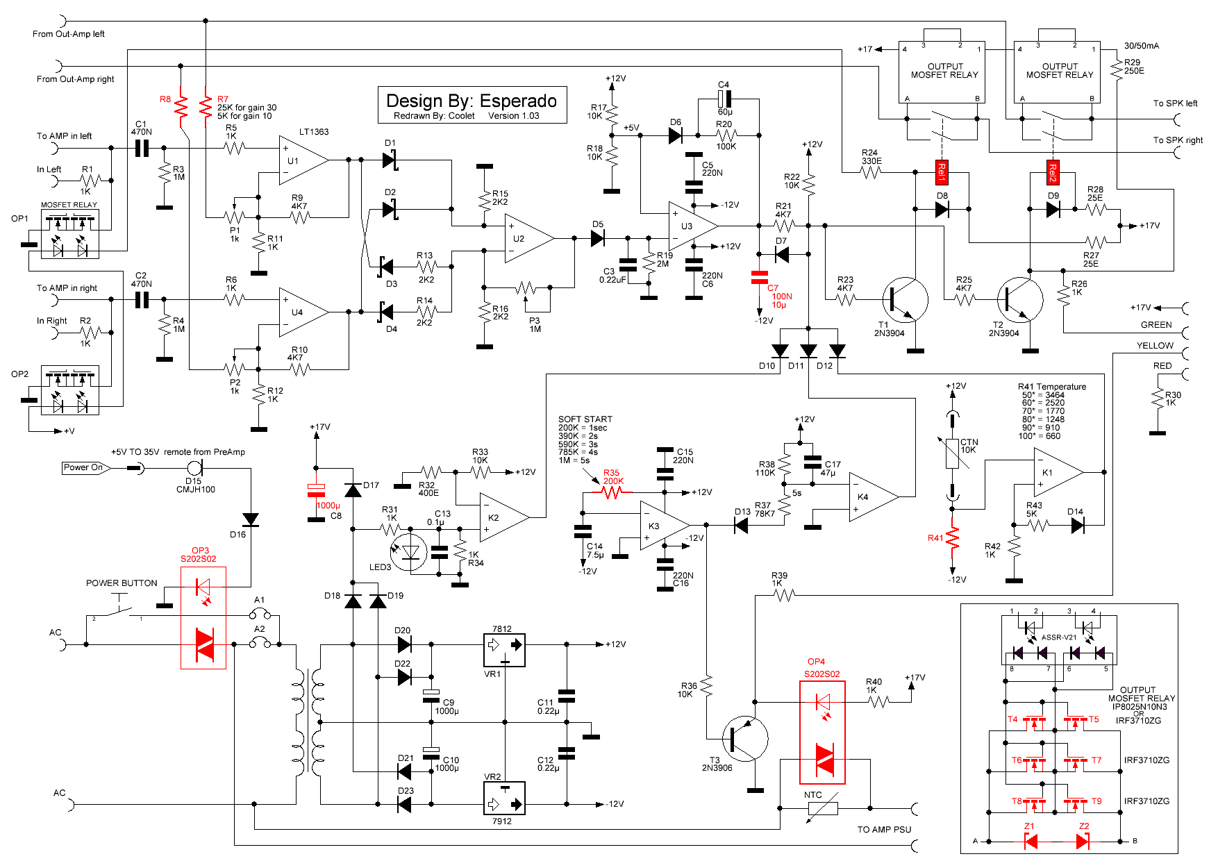

Some little errors and a little improvement, i will post later. (An indicator for over temp).VERSION 1.03 parts renumbered
Thanks a lot, it is very nice, you make nice drawings.

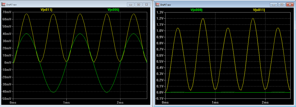

Now, about + & - protection: there is the signal (yellow) after rectification of the original error signal from the amp (green).
I still have a little problem with it as the symmetry is perfect with 28.7K in feedback of U3 (left image), but vary a little with it. Still searching for the solution for it. Can be solved adding an other OPA for varying the gain, that i don't want.
This is due because the - input of U3 has an impedance with vary a little with gain (P3 value).
Not a real issue, it plays on <0.2 v of offset.

OK so we are dealing with error signals (as I come late to the thread) for two distinct amp channels? Pardon my ignorance.Now, about + & - protection: there is the signal (yellow) after rectification of the original error signal from the amp (green).

The Hafler protection circuit I use in my amp works very nicely. Yesterday, I was testing a new preamp construct and one of the input lead came off. I just pushed it with the finger which led to a ringing sound in the speaker. Immediately, the protection relay kicked in.

Problem solved, bcarso (nice to see-you here). I had changed my mind for comparators: no way to get something clean with diodes, i wanted to save parts, it was stupid.
Now everything is rock solid.

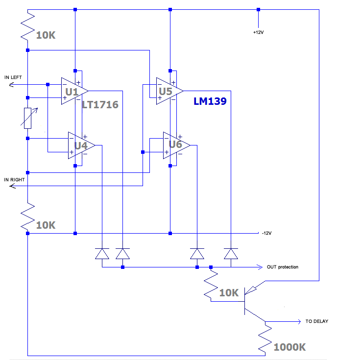

here is the principle of the last version. As rectifier diodes where not linear with various signal levels, there was a small inaccuracy that left me unsatisfied.

With open-collector comparators like the 139 you don't need the diodes.here is the principle of the last version. As rectifier diodes where not linear with various signal levels, there was a small inaccuracy that left me unsatisfied.

You are right. I take too many precautions. I remove them.With open-collector comparators like the 139 you don't need the diodes.

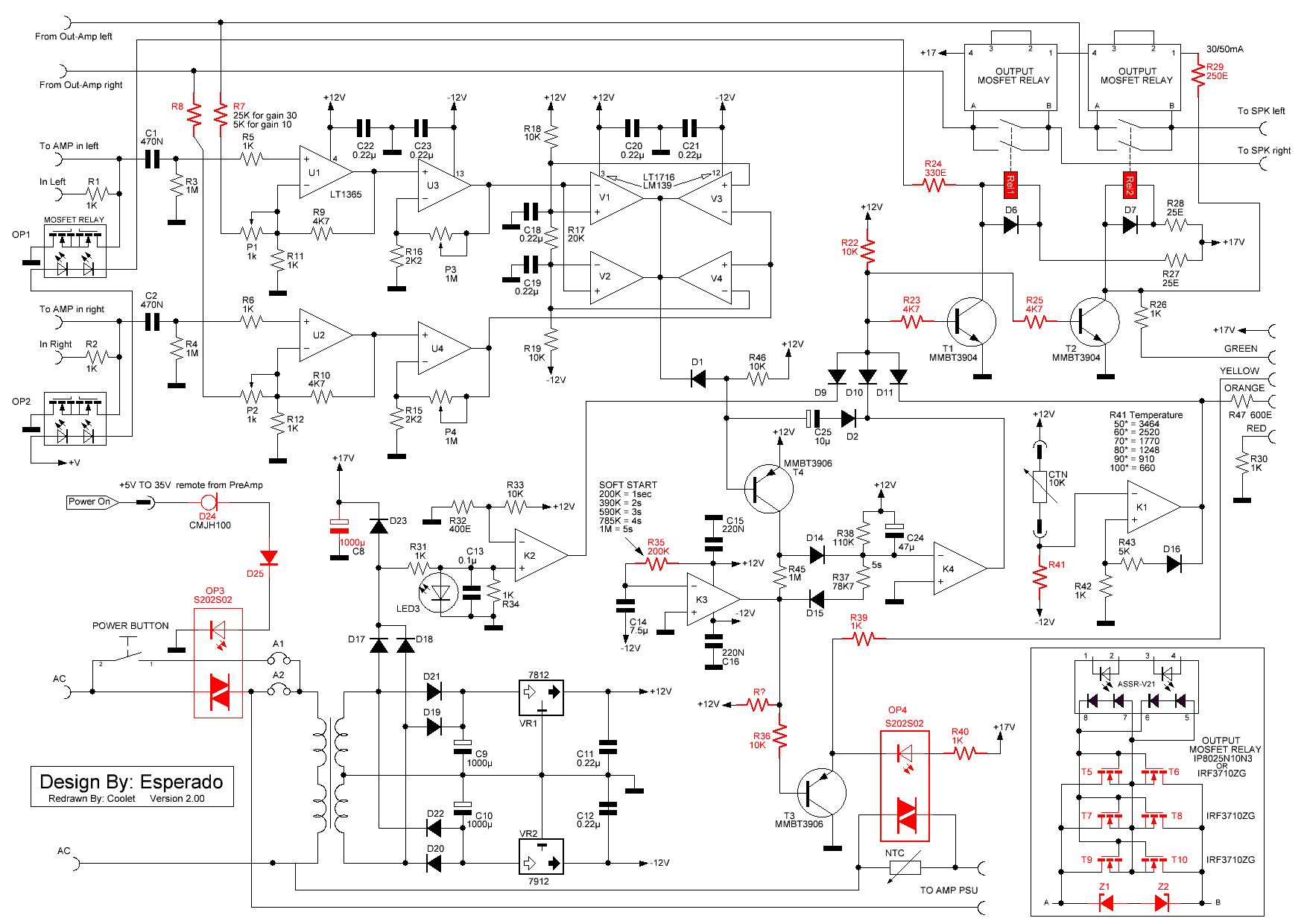

UAPC version 2
As explained, the OPAs U1 & U2 makes the difference between input and ouput of the amp.
The two error signals are amplified by U3 & U4.
Then peaks are compared to two symmetrical + & - references set by the 10K-20K-10K bridge.
The outputs of this comparators (open collector) turn low when fired. This turn on the transistor T4. +12v iss sended in the - input of K3 via a diode. K3 turn low, this fired the protection via D10. In the same time, it force the base to stay low via the blue diode, during the time the capacitor is charged: this make an hysteresis to ensure the protection stay low during enough time even if the pulse was very short.
When the error cease, C12 discharge slowly (5 seconds) via R29+R28, assuming K2 (end of soft start) is low.
The same K3 assure the 5 second delay to connect loudspeakers during the starting session.
Too, an indicator for overload temp has been added. It can be a 5V 20ma blinking diode (paralleled with a 5V zener) .
That's all, folks.

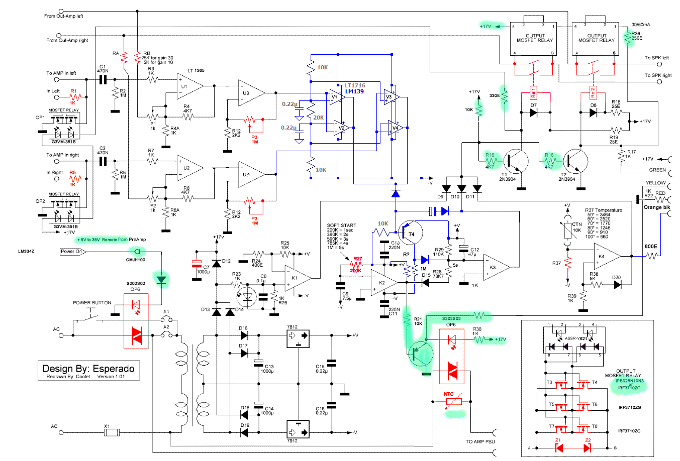

For coolet, a resistance R? has been added. This is to can use an other quad comparators for the delays instead of the original OPA, chosen to simplify the BOM. It will save money by the same time.

No, i have copy your *nice* schematic. I will make a last change, to use comparators for the timers instead of OPA, and it will be finished. (may-be i will suppress one transistor)
