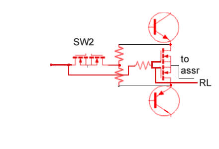

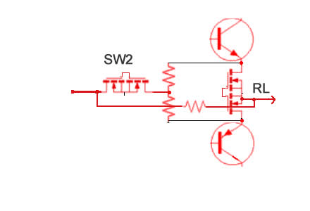

Oh, i realize i have not the slighest idea of the RDS & RDS changes of those MOS in reverse.you get a net 4 milliohms for the two in series.
Clever idea, as habit.It might be interesting if it were a problem in some other context to actively vary the gate-source voltages to stabilize the resistance. But certainly I'm not suggesting that it is needed here..

I would like to add that nothing seems to stops the DIYers to set the mosfets directly inside theirr amp, right at the side of the power transistors. ...
I was wondering when this would turn up. I simulated this last year.
What I was looking at was having the FETs on resistance provide the emitter degeneration for the output devices.
There's more - I was considering if I could modulate the on resistance of the FETs so that the emitter degeneration of the power devices was dynamic. Think about compression of the signal at high current. Think about manipulating the cross-over in a Class B pair.
I never did take the simulations to a conclusion though - but I think it is a very interesting area to explore. 😉

Along somewhat similar lines one could use them to introduce a small variable loss with the effect of removing residual distortions from the amplifier. I considered this as a technique in particular for switchmode amps, in analogy to but in contrast with active "class A" stages embedded in switchmode amps, like Devialet and various other approaches.
The devices could be in parallel rather than in series, and in the "ground" leg, i.e. the speaker return conductor, which would make the manipulation of the gate voltages somewhat easier. If the circuit breaker function were to be included then they would have to be in series.
The problem, them, will be power dissipation of the protection mosfet, when we want it to deal with as less power we can, for safety.IWhat I was looking at was having the FETs on resistance provide the emitter degeneration for the output devices.

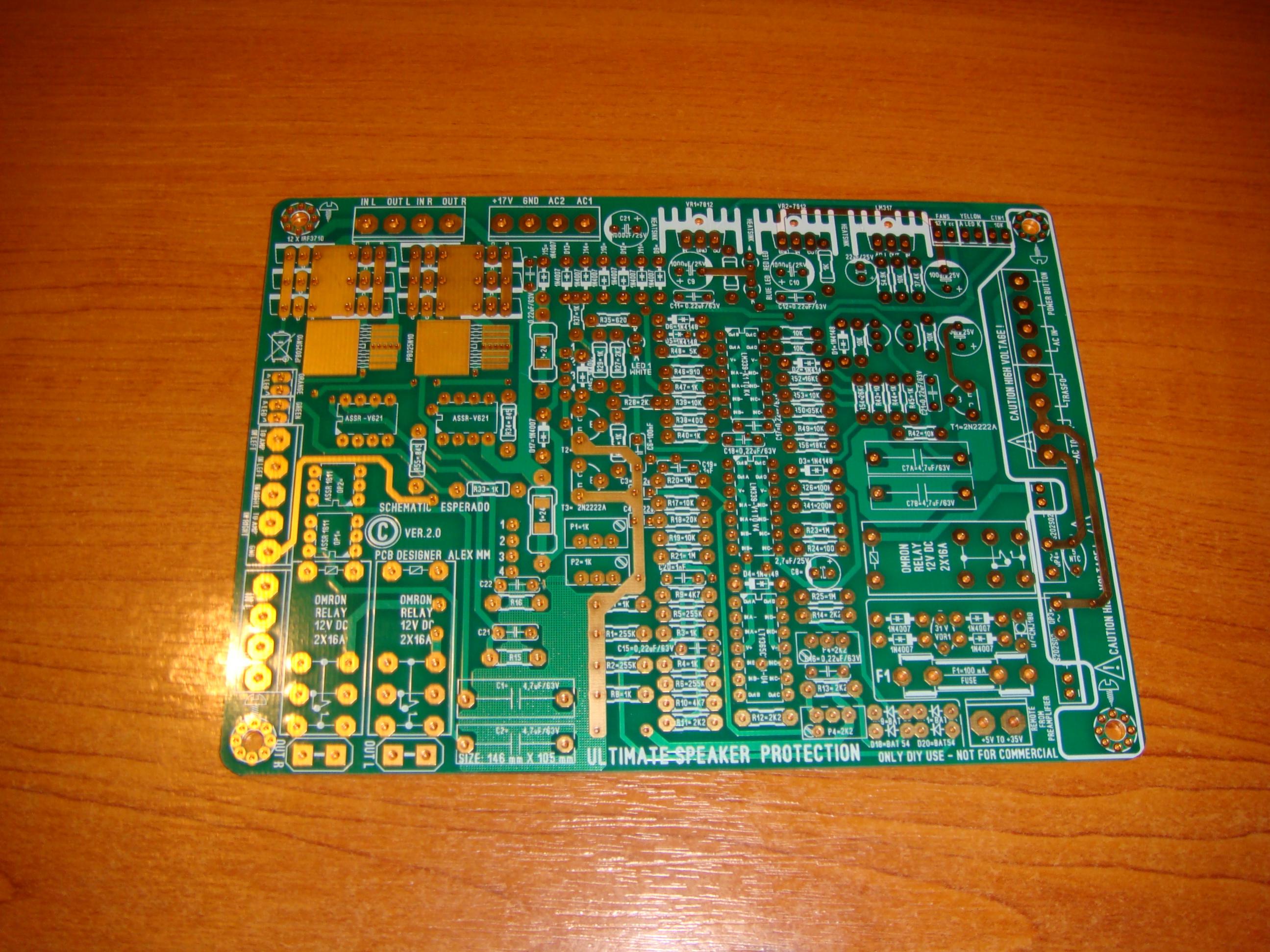

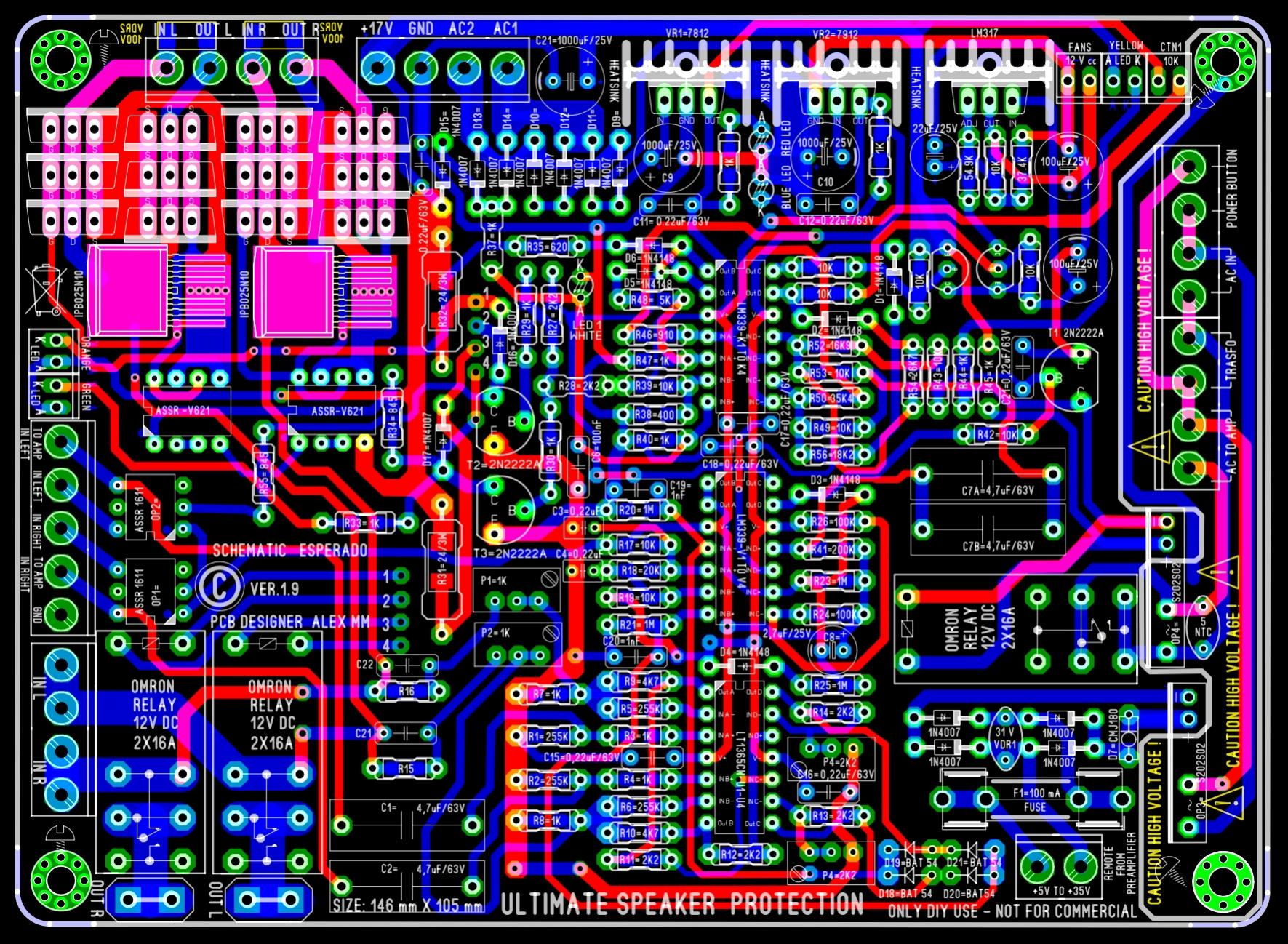

Nice idea to had added an optional mechanical relay for remote power on.rev 1.9 born today late in night 🙂
More and more beautiful., Alex !
Definitively more harmonious on some details, like the AC remote plugs position and less acrobatic here or here 🙂
I know it is boring to repeat, but your work is amazing, and the time you offered to all of us is a priceless gift.
Just, at first sight, i'm afraid by the little tracks between Loudspeakers lines of solid state mos relays and the mechanical ones. If some one think it is enough and use them in serial instead of big diameter cables, it is risky in case of short circuit on the speaker lines and will introduce unwanted serial resistance ? I know that the protection will fire-up fast, but, who knows ?
Nice idea, but better do not use this option.
Or redesign the PCB with proper distances for mains voltage and double check also the suitability of the isolation of the chosen relay.
Ensure double/reinforced isolation.
EN60065, Chapter 13.4: Creepages, Table 11
==> Design creepages of at least 5mm
(Creepage = shortest path along surfaces)
EN60065, Chapter 13.3: Clearances, Table 8 & 9
==> Design clearances of at least 4.4mm
(Clearance = shortest distance through the air)
EN60065, Chapter 8.8: (Simplified with my own words and not at all complete...)
In case of single layer isolations ensure at least 0.4mm material thickness and withstand a high pot test of 4kV.
If thinner than 0.4mm then ensure at least 3 layers, whereof already two layers withstand a high pot test of 4kV.

Thanks for your contribution. I'm sure you're right on an industrial point of view. Need to be confirmed by an international expert in safety rules.The concerned isolation above is the isolation between mains and the low voltage signal area.
Notice that the AC parts in the board are protected with a ground track from the rest of the circuit. And have to be isolated with an external isolating protection, to take fingers away, for sure. Can be done with some plastic sheet.
It would be definitely great to get the corresponding info from an US guy regarding UL/ANSI.Need to be confirmed by an international expert in safety rules.
For CCC in China we can expect very close similarities to European standards.
This GND track is not in place at the relay itself.Notice that the AC parts in the board are protected with a ground track from the rest of the circuit.
Furtheron this method also is more complicated. It does not need just some GND, it must be a valid PE (Protective Earth), which provides low impedances and high current capabilities. And then you still have to provide basic isolation vs the hot tracks. Demanded creepages then would be 2.5mm.
In any case I do not recommend to expect that people have proper PE in place. Better design for double/reinforced isoaltion, this will also allow to use the board in a stereo set of protection class 2.
