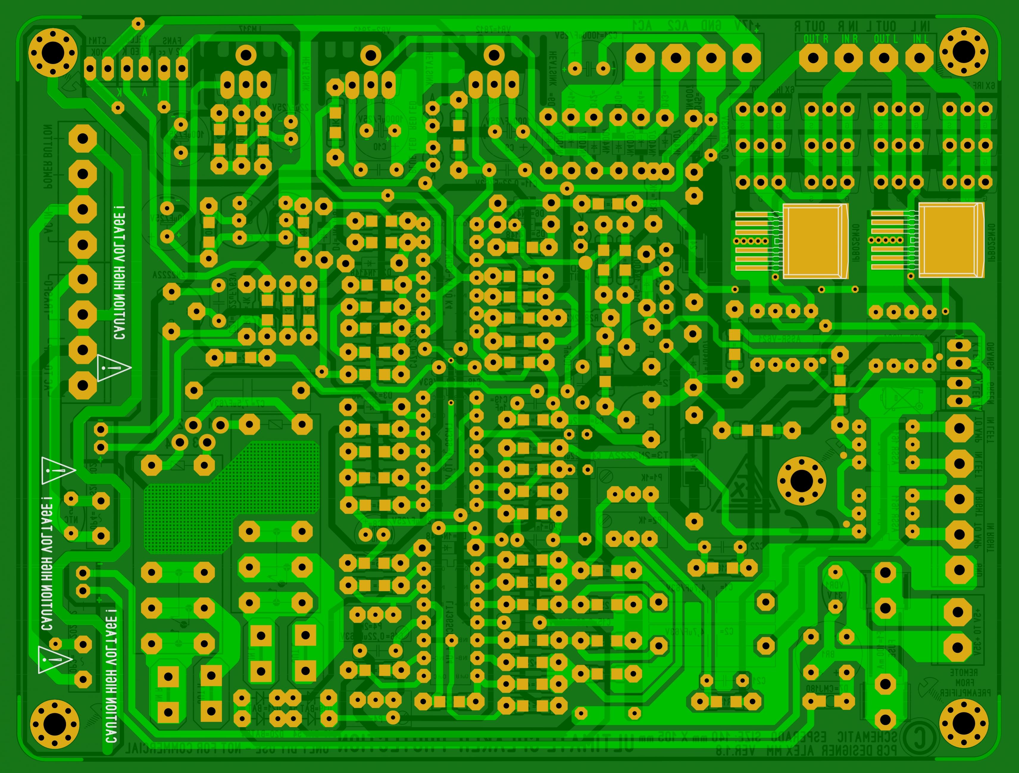

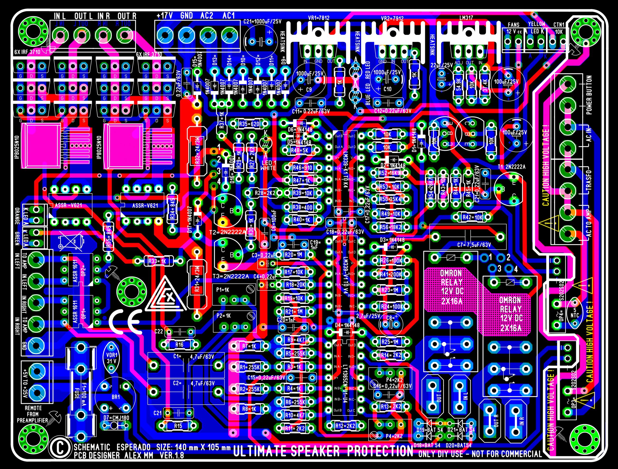

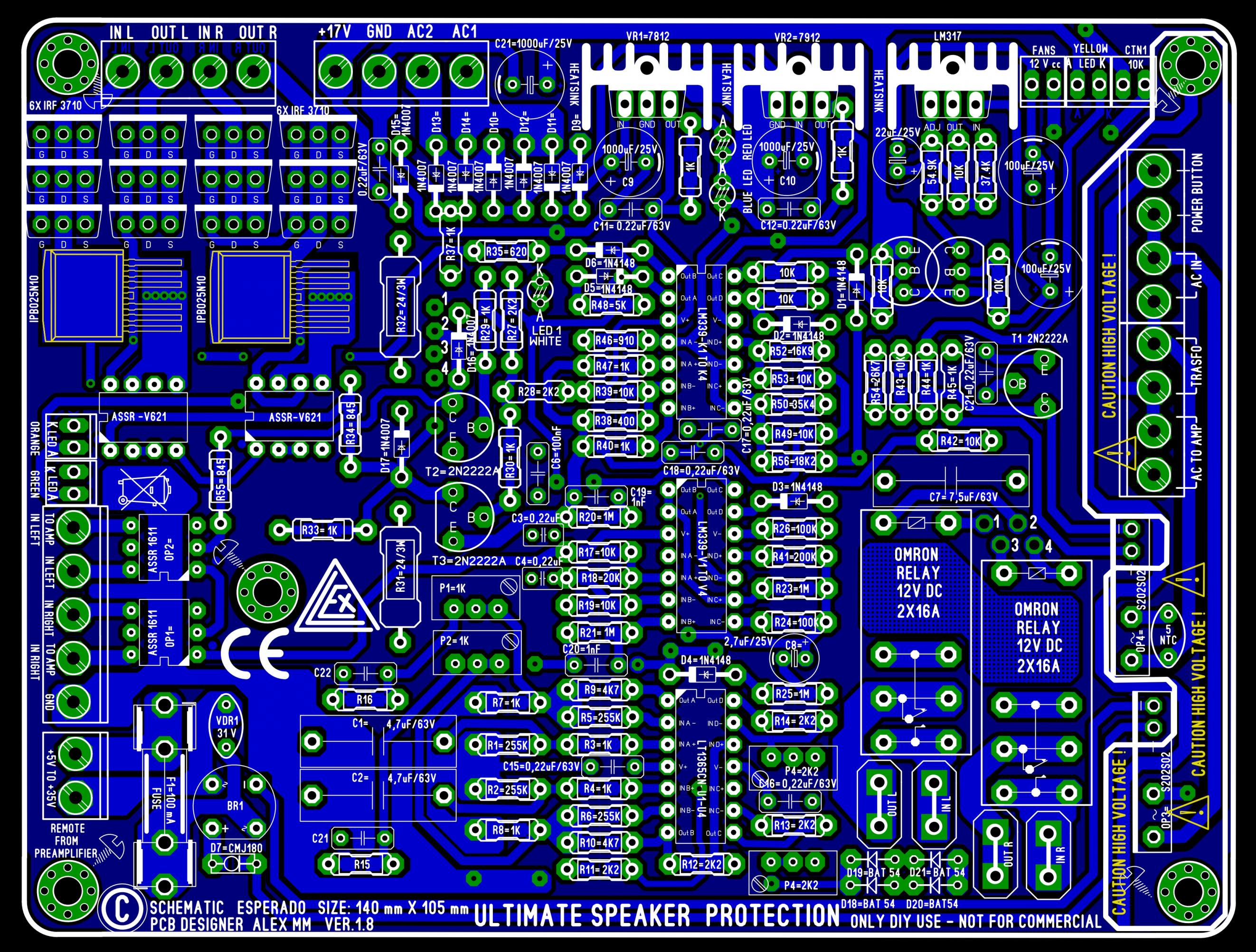

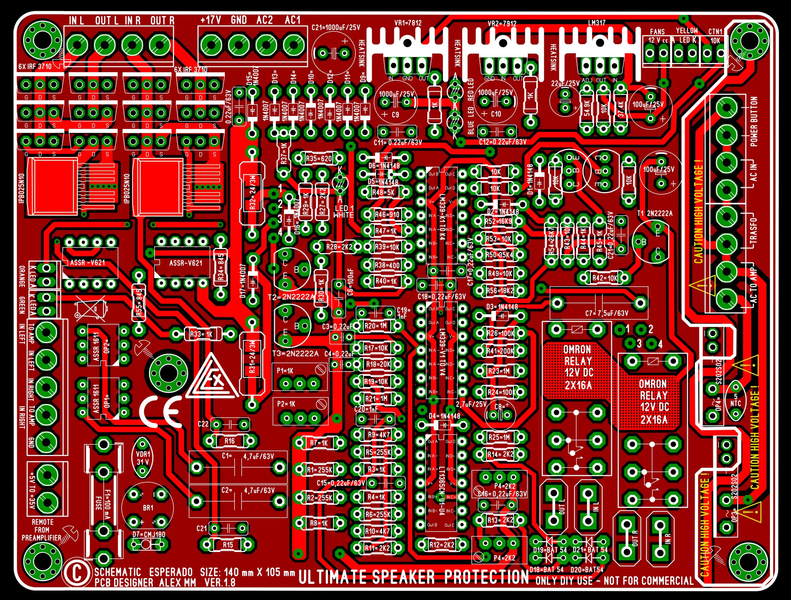

PCB REV 1.8
No problem at all , so rev 1.8 ready like you ask ......😀
Regards ,
Alex

Just one word: fantastic.
I think you got-it !!!!! All problems solved, routing done 😀😀😀😀😀 in a brilliant way.
Once more, Sir Alex had challenged his reputation.😎
Just i feel confused by all the work you had done for us.
Having-you on our side is like to have both Steve Gadd and Abe Laboriel on your back, while you plug in your guitar 🙂

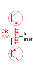

I would like to add that nothing seems to stops the DIYers to set the mosfets directly inside theirr amp, right at the side of the power transistors. With the benefit that they will be included in the feedback loop, reducing further the (very) little distortion due to the Mosfet non linearities with currents. No more reason, for ghosts hunters, to think about mechanical relays. Well, if your amp is able to suffer open loop operation with no charge, that i doubt 🙂

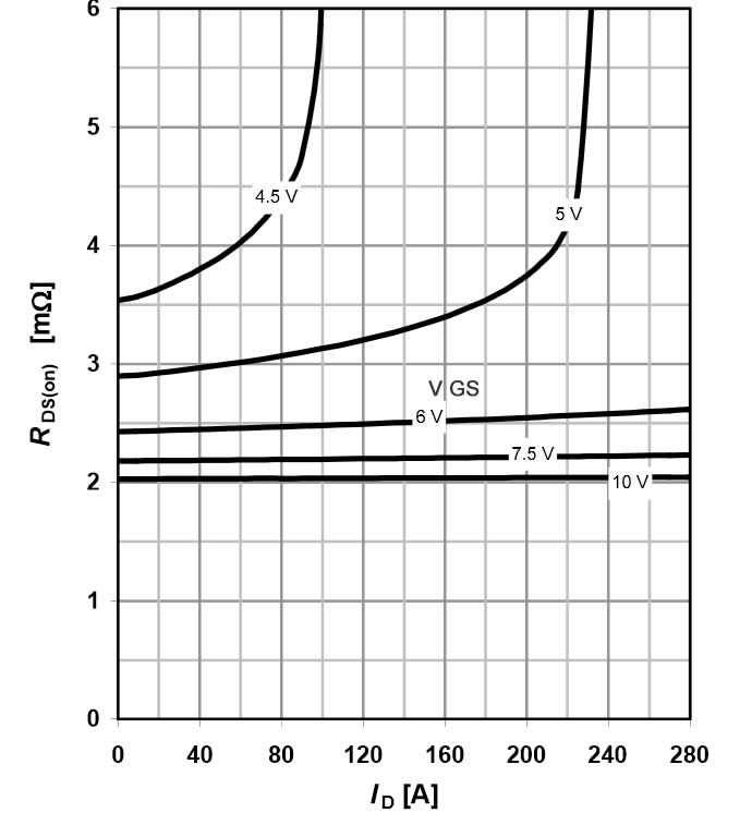

Christophe, sorry if I missed it as I came to this thread late and may not have reviewed all the posts, but have you evaluated the maximum distortion that might be contributed by the DMOS switches? Note that besides the intrinsic variation of resistance with current there are also self-heating effects that may cause that resistance to change, possibly with time constants in the audio range depending on the devices.

Well, with the typical 2 mOhms of RDS for IPB025N10N3, flat from 0 to 240 Amps with 10V GS, comparing to the 6 ohm speaker, go figure !
And, about thermal effects, in normal operation (10 Watts ?) and 6 ohm speaker, dissipation in the MOS will be: 0.003Watts, i worry more about my moving coils temperature changes 🙂

Attrached RDSon of the IPB, (VGS is 8V from the opto-driver)

OK so those really are very large FETs, and you get a net 4 milliohms for the two in series. If that changes as a function of current and temperature even 10 percent that couldn't be a lot compared to a nominal 6 ohms.
It might be interesting if it were a problem in some other context to actively vary the gate-source voltages to stabilize the resistance. But certainly I'm not suggesting that it is needed here.
EDIT: And that is an astonishingly flat Ron at 10V Vgs.
