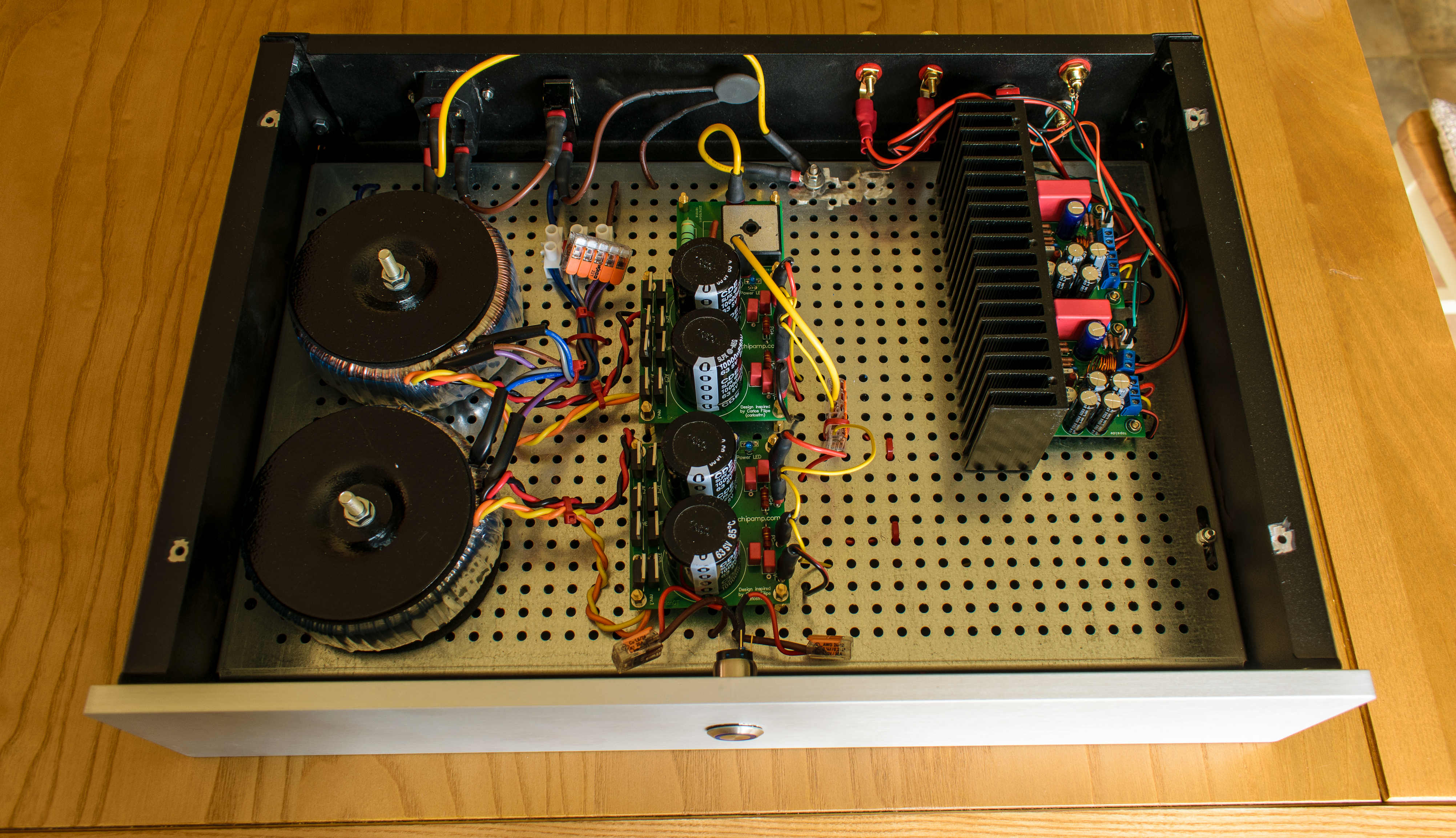

Finally completed my build of this today.
I used the old chipamp.com power supplies, the transformers are +/- 18V 160VA (they were cheaper than the 120VA from the same supplier).
The sound is excellent, really happy with it, and it is extremely quiet, bearing in mind I am 52 years old with some tinnitus.
I have built it for a friend and it will be off to them this week, but I intend to have it playing until then.
I think the only thing I would add is that if you intend to get boards made, edit the gerbers to include text/symbols for the input and output.
My thanks to 00940 and contributors for designing this and making it available, it is much appreciated.

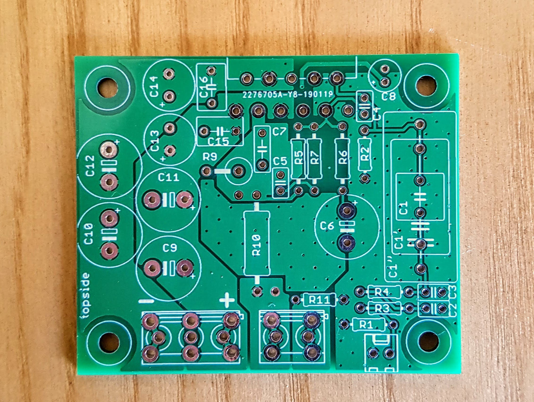

I have decided to get 20 from JLCPCB they have been delivered for a total of 15 euros shipping included so now I will play around with this and see what I can get done. The pcbs seem to be good well done quality. A big cheers and thanks to everyone who contributed to develop them. It may take some time but I will report back on this .

Thanks to 00940 for this clean and userfriendly design. Thumbs up ! Also many thanks to Neil being so kind to share the PCBs.

I realize i was a bit too rushed in writing my previous questions, as at least one other user in this same thread had already reported using similar transformers (though 160VA, but same secondary voltage). Sorry!
I've decided to go dual mono instead of monoblocks and have ordered a nice mini dissipante from Modushop for it. It will be paired with a kuartlotron Preamp. I have also ordered boards for the 15.000 caps i had left over. I managed to keep them below the 10x10 cm max for JLCPCBs discount. As to how much capacitance, max i could fit per board was 4, so 2 per rail it is. I also decided to go with monolithic bridges (35A, 800V) that i will mount to the heatsinks or chassis base plate.

Hi, here is my personal oppinion, which I have formed in many years of hifi amp building.
If you can use different power supplies for each amp, do it. It is always better, the worst that can happen, is no improvement.
Usually the sound gets clearer (please, don´t expect it to be a huge difference, just a sublime difference if you listen A-B.) this not 2x 15.000 uF is a good value for a mono amp, as it is well in a teritory, where more capacitance does not give any audible difference.
These amps have a high rejection of noise from the PS, so ripple is not the primary problem.
In most cases more uF improve the bass and make the sound more solid. Using for example 4x 4700 would be just as good as 2x15000, because the resistance gets lower (ESR), but this depends of the individual capacitors used, of course.
I use allways some foil capacitors in the 1-2.2 uF range in parrallel to each electrolitic, as well as some small nF region. Sometimes you can watch on an oscilloscope how the small spikes that "dance" on the basic voltage disappear, when you add the small capacitors.
A good way to keep dirt away is to use a CLC configuration, better than CRC which is contraproductive with power amps imo.
