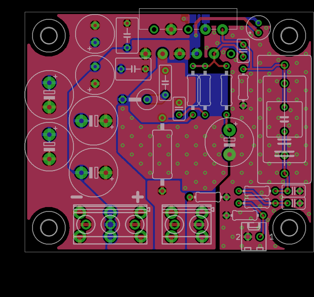

You're not going to have fun etching at home. But here are the top and bottom in pdf.
Some points of attention:
- I didn't include all the vias in the print. You will have to see where you want some (and you absolutely need some right at the top near the lone smd resistor). The pictures from post 58 will guide you for that.
- Depending on your process, you might have to mirror the bottom (it's as seen from the top in the pdf).
- The board dimensions are 60*50mm. So you can check if you print it out at the right size.
- If I were to do it, I would probably edit the pictures to remove the top ground planes (right at the middle and at the right of the board).
- As usual, the worst parts to deal with will be the electrolytic caps.
- Eagle puts pads even at the side to which the components aren't connected (they're tht pads). You might want to etch or scrap these out to get more clearance in a pcb without mask.
Can you mark the points which connect top layer to the bottom layer
Check the pic below. Anytime there is a small green circle, there's a via connecting top and bottom. Right in the middle of the lm3886, at the top of the board, you have two vias actually doing connections. All the others are there for stitching, connecting two groundplanes. You don't need that many probably.
For the rest, connections should be obvious from the layers.

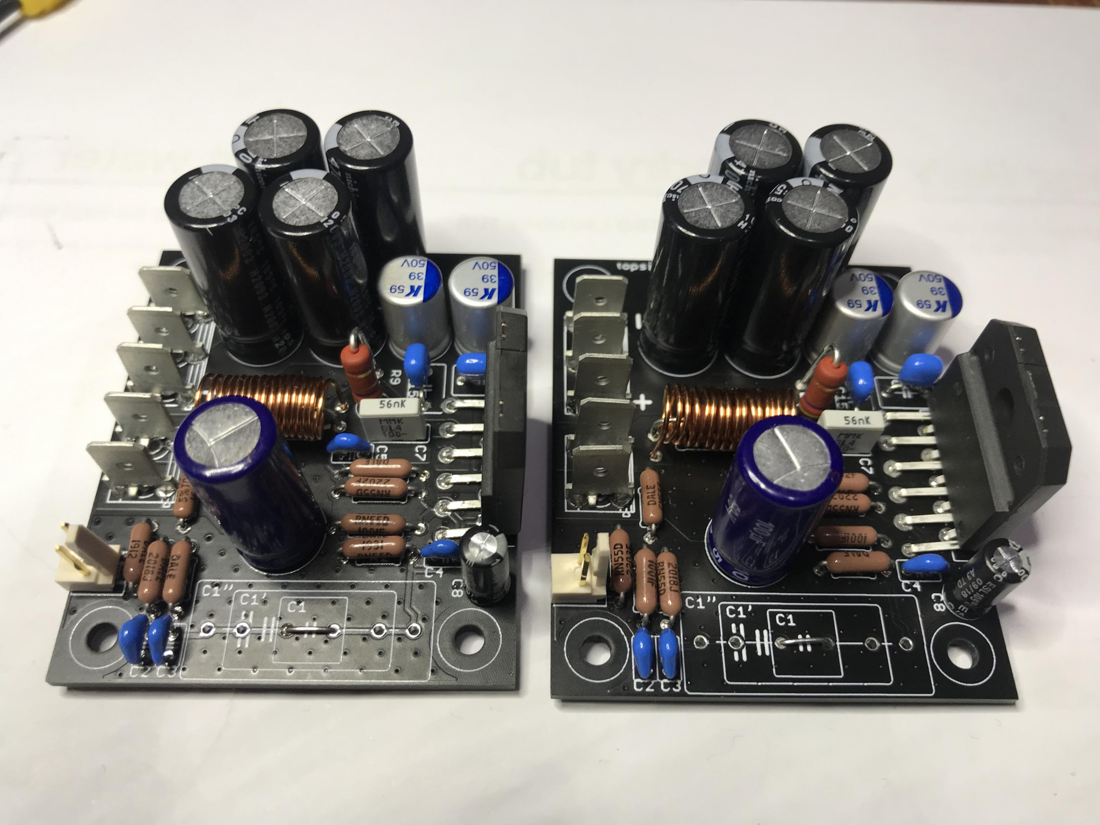

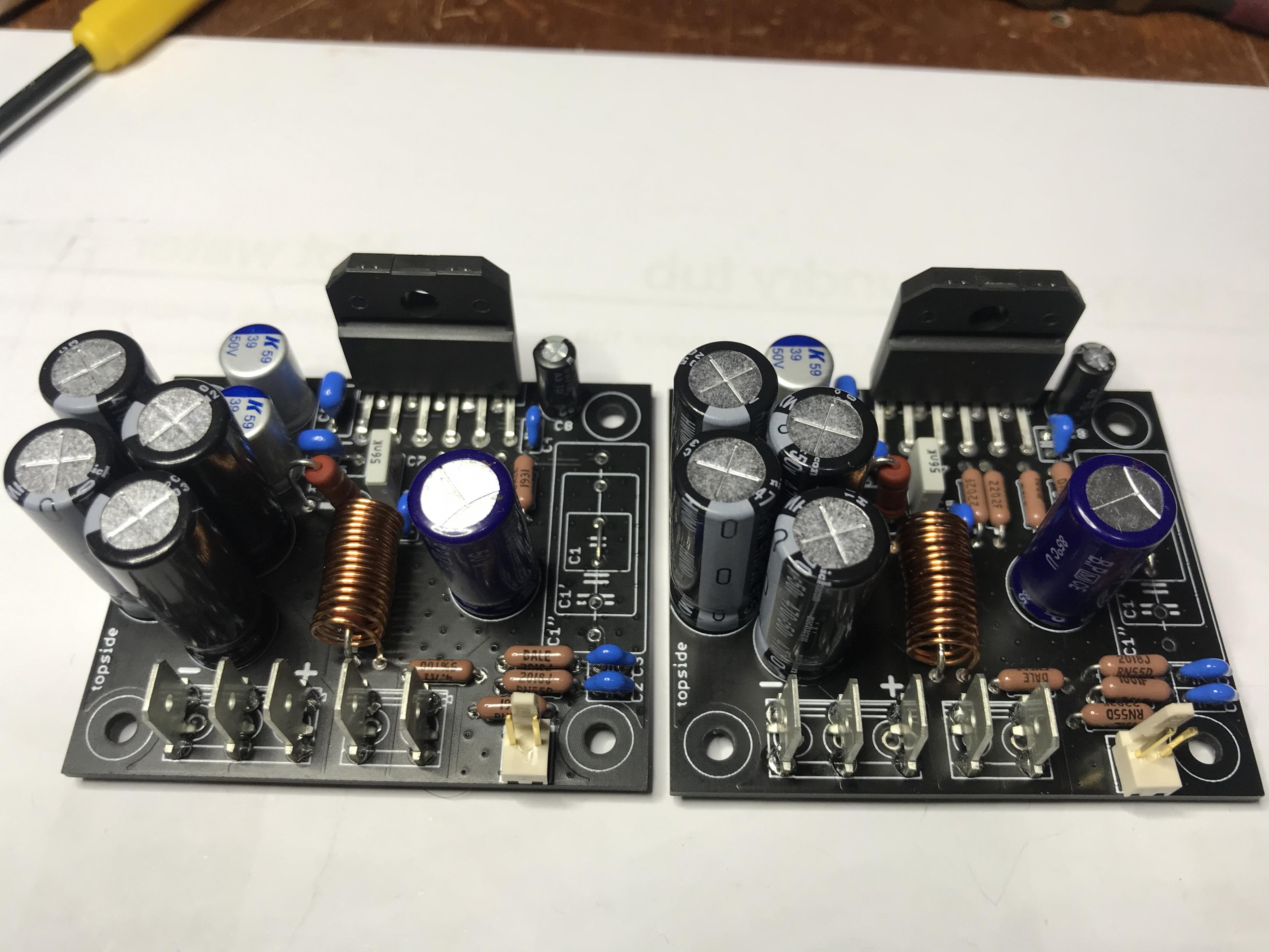

I wanted to share my build.
Using the open source Lm3886 boards, I have a great sounding amp.
Boards were stuffed as per 009400 posts, the earth stars work perfectly (separate for signal and power).
Note:
the transformer is a 300va 18v Toroidy audio model
the single power supply is from BrianGT chipamp (10,000uf per rail plus snubbers ala carlosfm)
dual speaker outlets make it easy to bi-wire the speakers
mains supply live, earth, neutral all suppressed with Y2 capacitors
No discernible speaker hum, or mechanical hum. No pops or clicks when from any home appliances.
I know the mind plays tricks, but I am sure that the sound has improved each day since switch on. It seems to me that component burn in is real, that our creations do need time to settle in.
