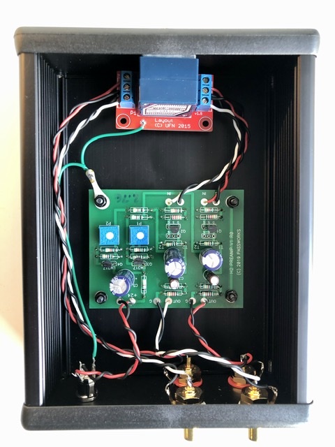

I opted to build one that might be good for a local tour ( and shipped it out this am to its first experimenter)
I installed the H2 into an old CD ROM case ( the same one I used to test the Korg B1 ) with an SMPS that is regulated to 24V, added an additional filter for good measure and a small pot to allow for volume adjustment ( so that it can be used as a preamp ).
I have added test points on the front and drilled holes aligned with the trim pots to allow the T2 voltage to be adjusted without opening the chassis. I couldn't find my nylon flat screwdriver so I shaped a tool out of a trusty bamboo chopstick which works very well.
Not pretty but functional and should be fool proof enough to allow most people to try this out.
and finally a picture of it at my desk ( the B1 Korg is below the stack )
It was a lot of fun to play with the amount of H2 and I do plan on doing more extended experimentation when I finally get it back again.

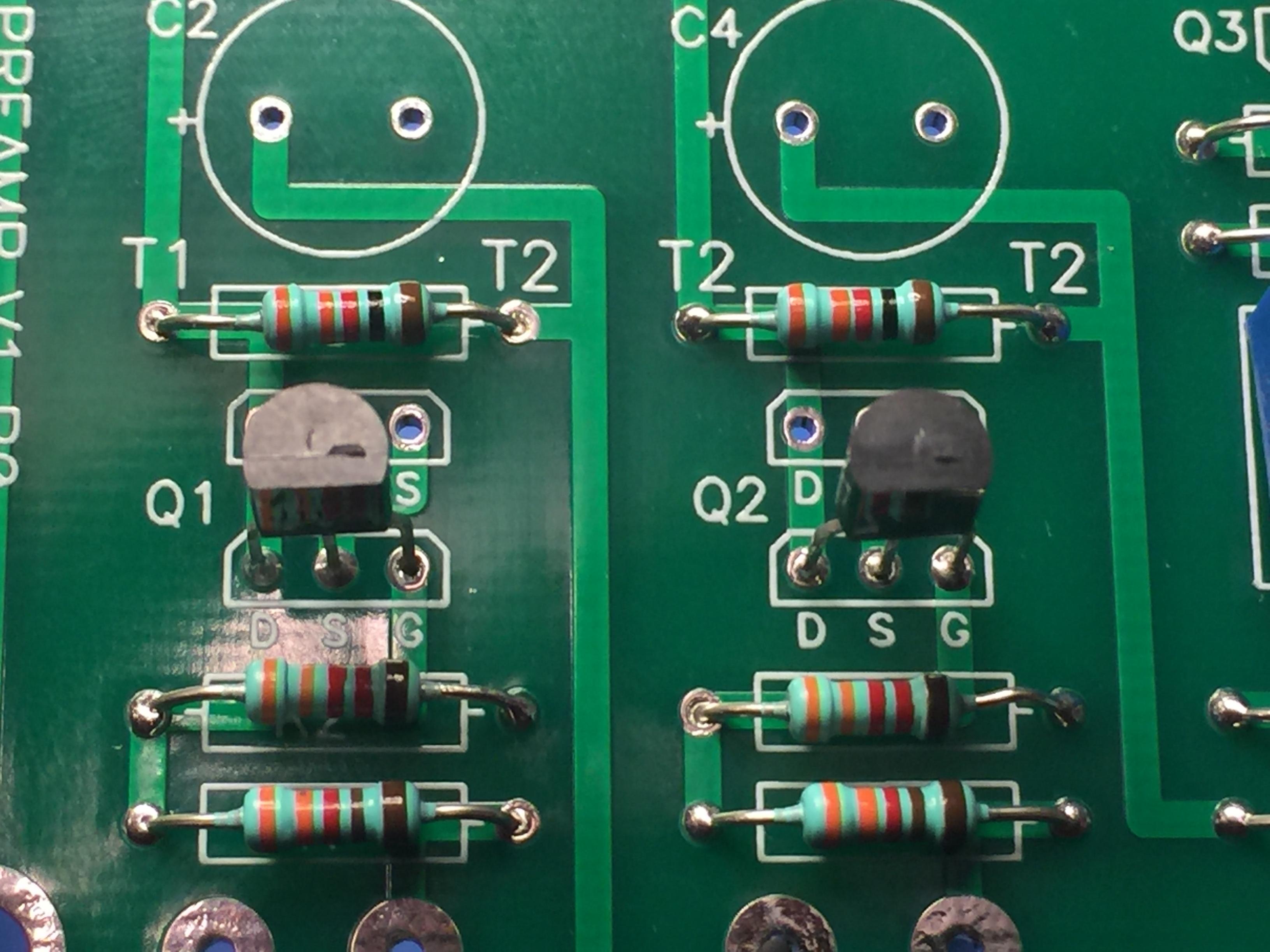

Make sure you orient the FETs the right way. These are the J112s. Check your parts. No, you can't just turn them around and put them on the other pads.

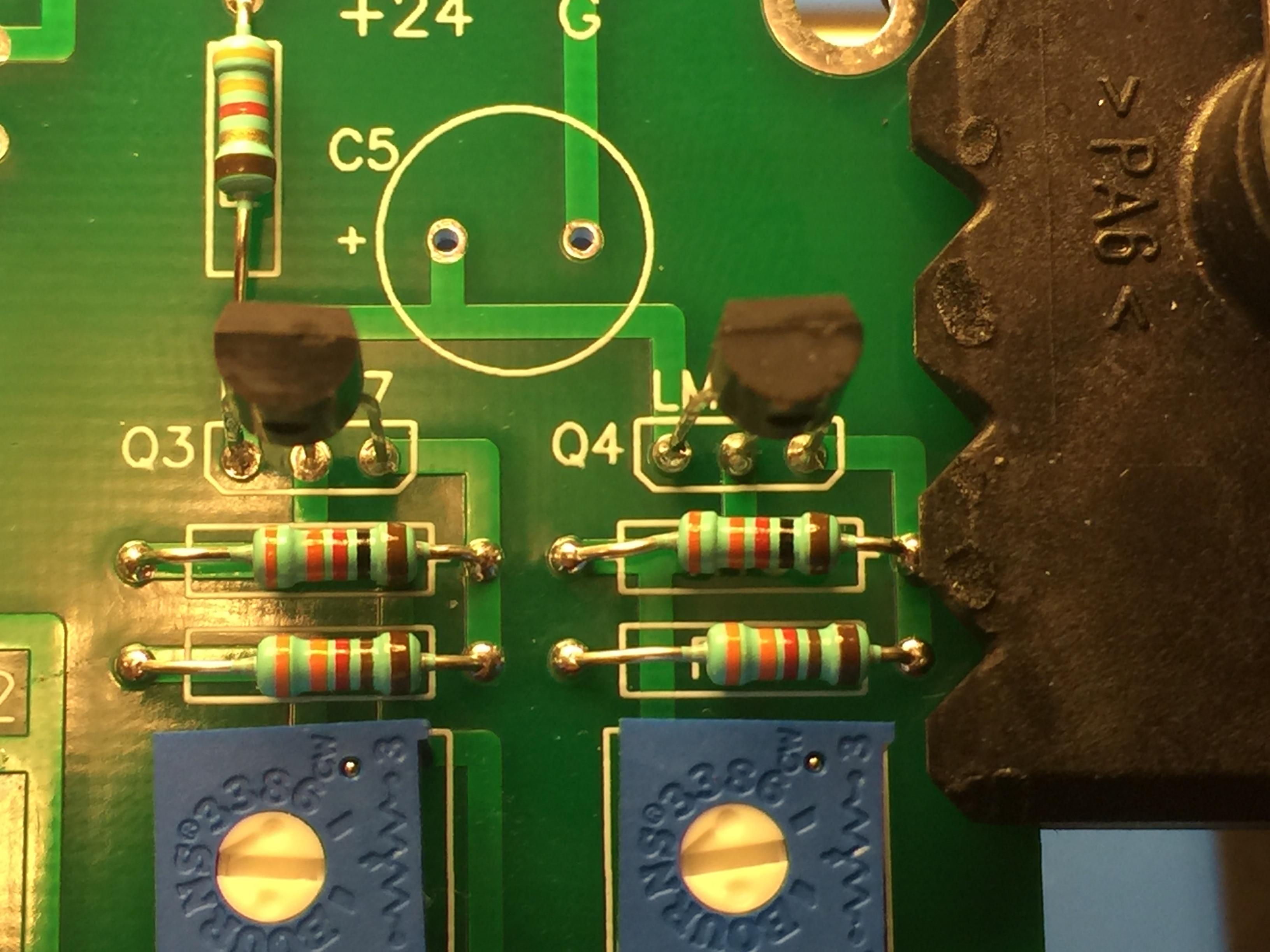

Make sure the regulators go in properly also. These are the LM317s. Check your parts.

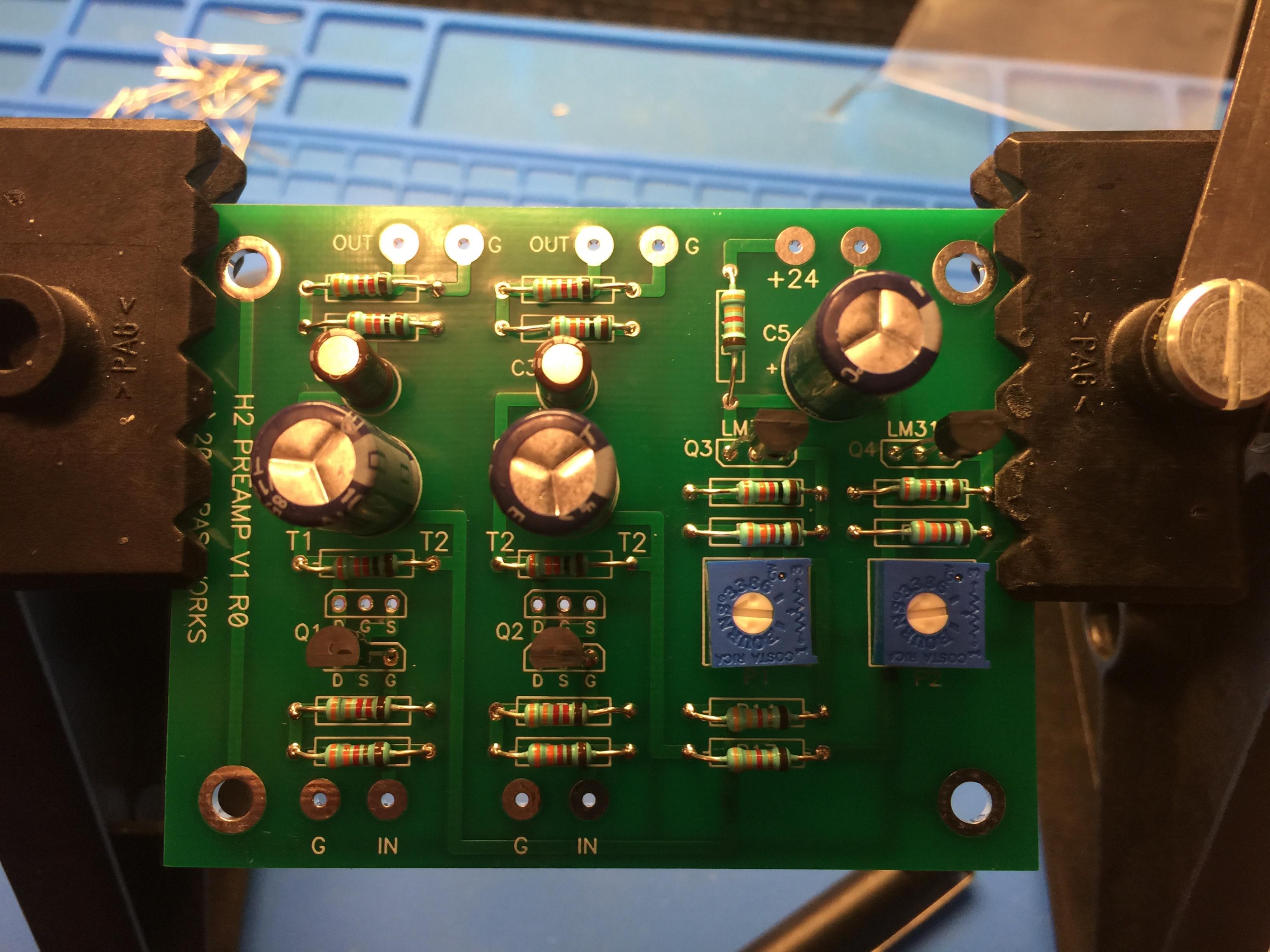

Fully stuffed board. Time to set the operating point. Make sure you have Papa's article.

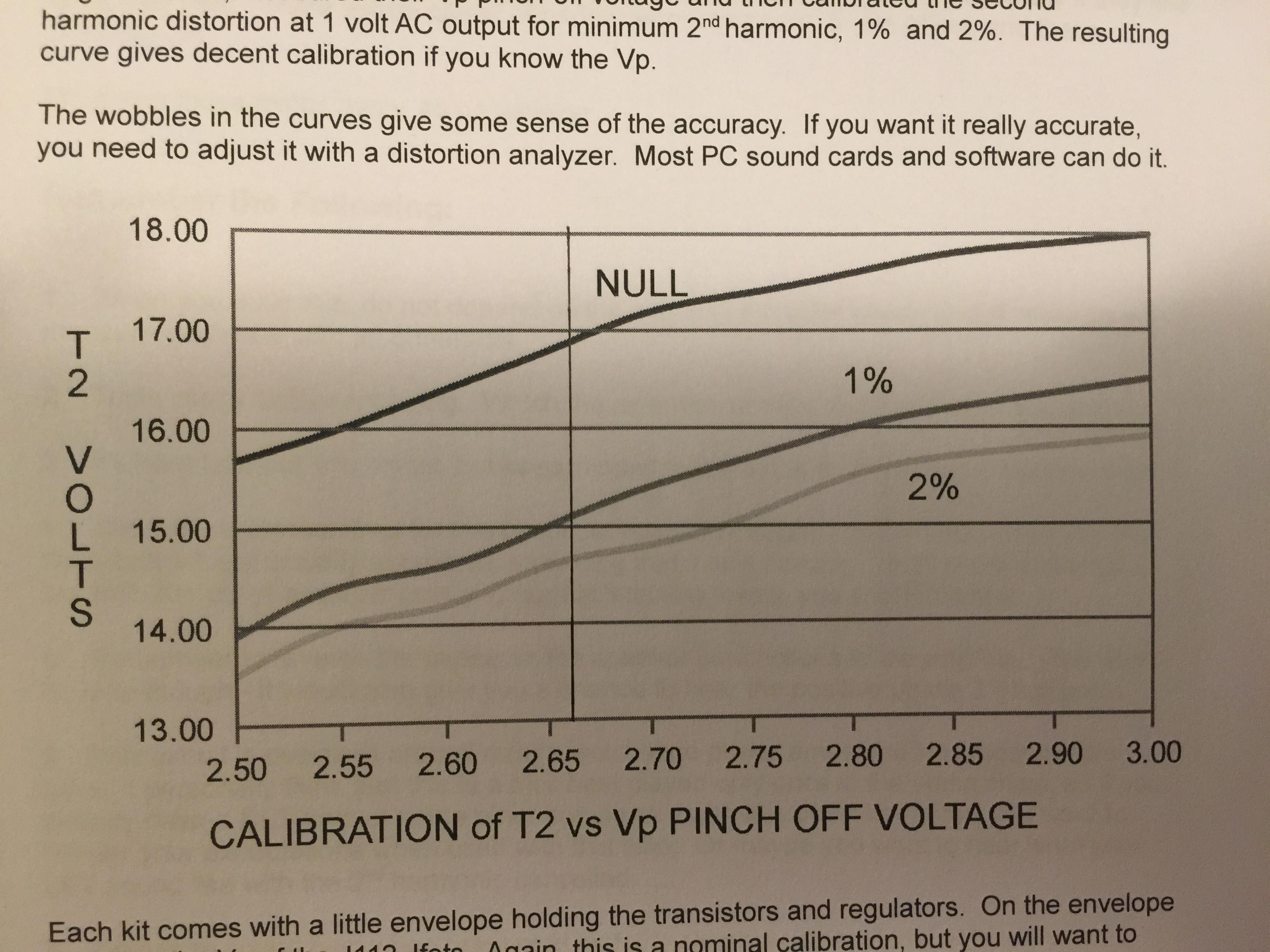

Draw a vertical line on the graph corresponding to the values on your bag. It will intersect the curves at the various distortion levels Papa was kind enough to provide. Measure the corresponding voltage at T2 for each channel as noted in the article. Turn the pots per the article to match your voltage. Mine for 2.66 was about 15V1 to start at 1%

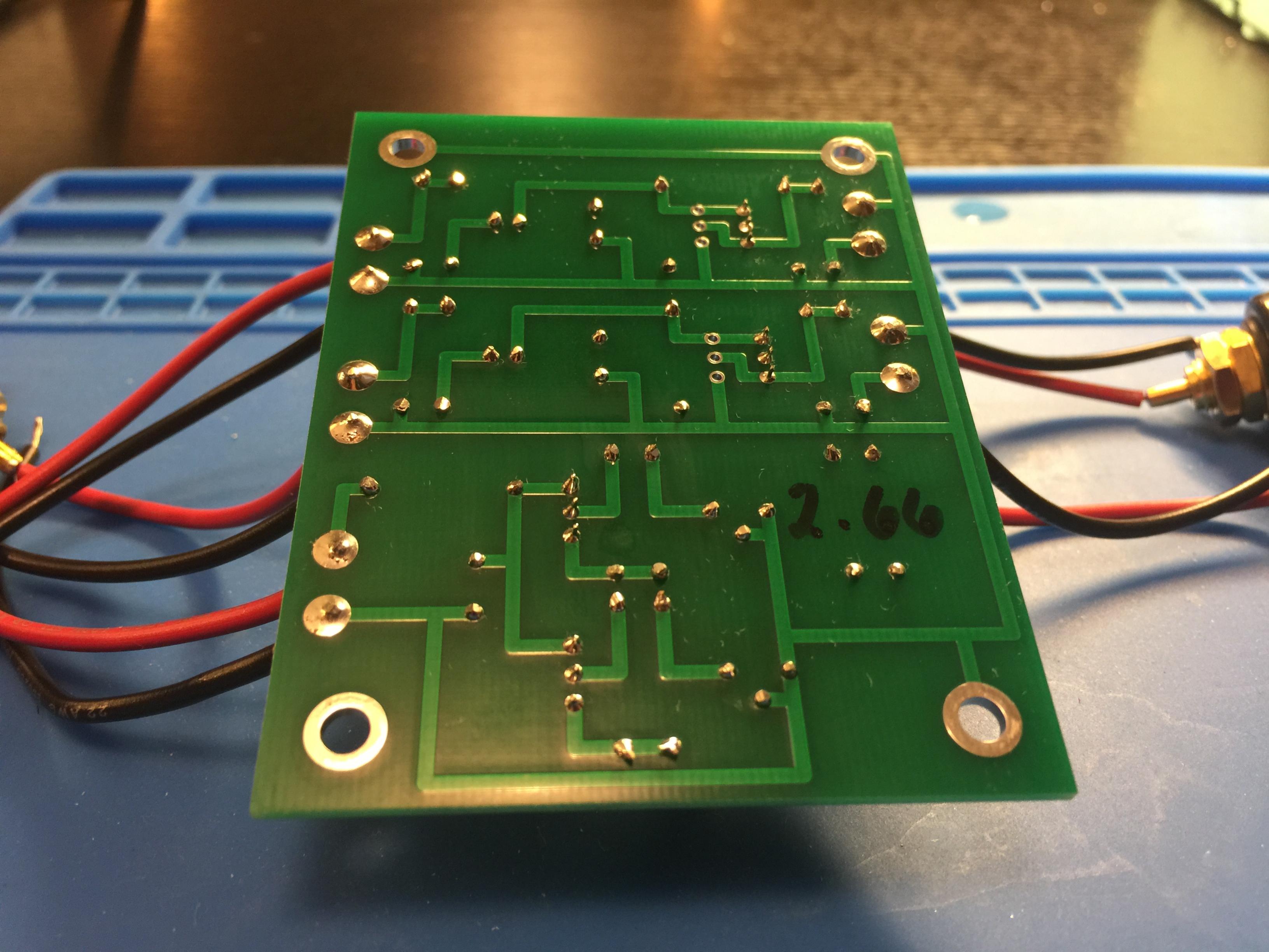

I wrote mine on the bottom for future reference.
