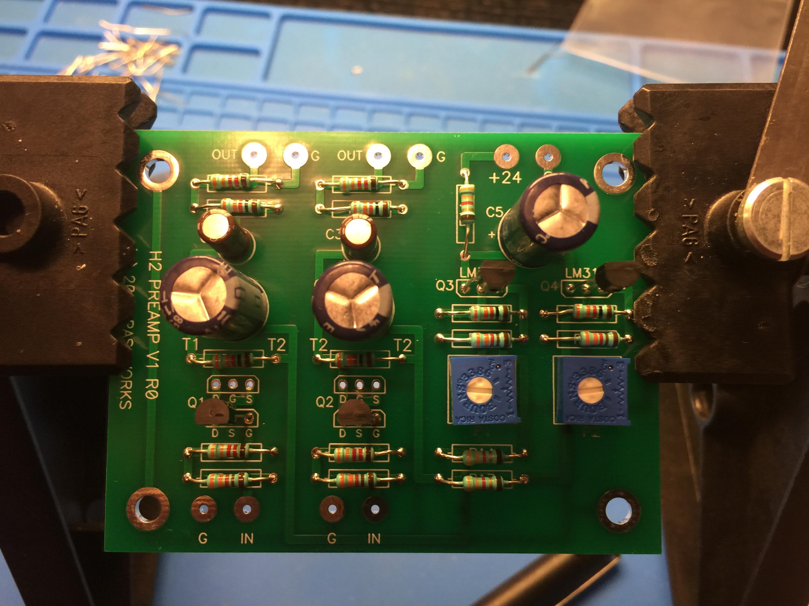

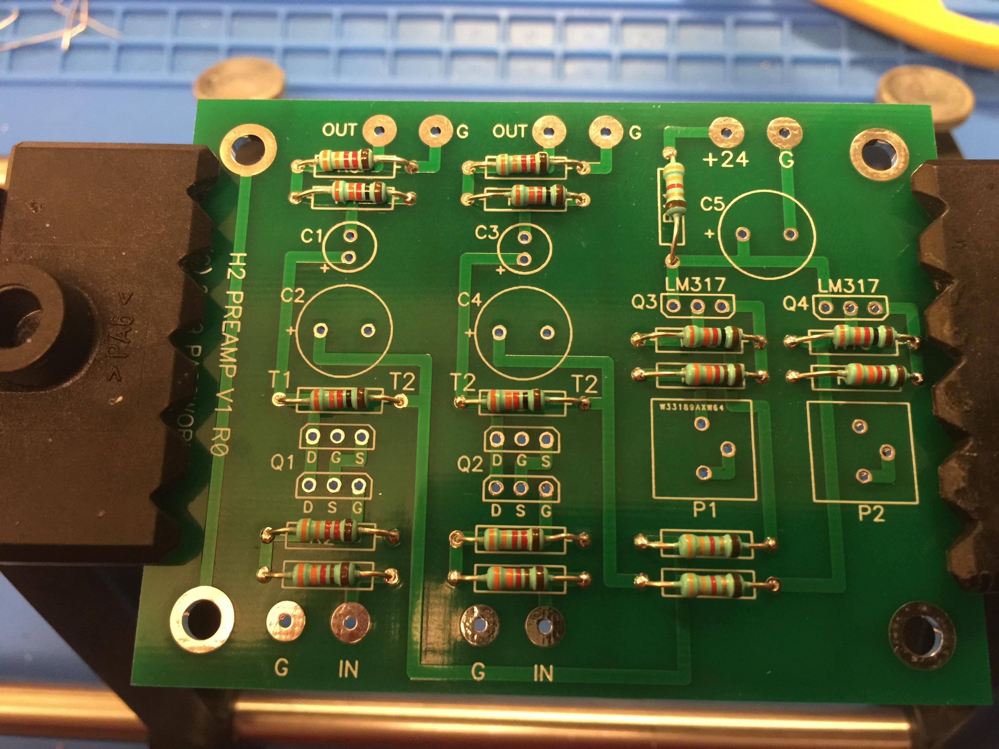

So many years have passed and now I'm starting to build the H2 V1. The first question concerns the mounting holes that are connected to the GND of the circuit. This probably excludes the connection to the steel chassis of the housing?

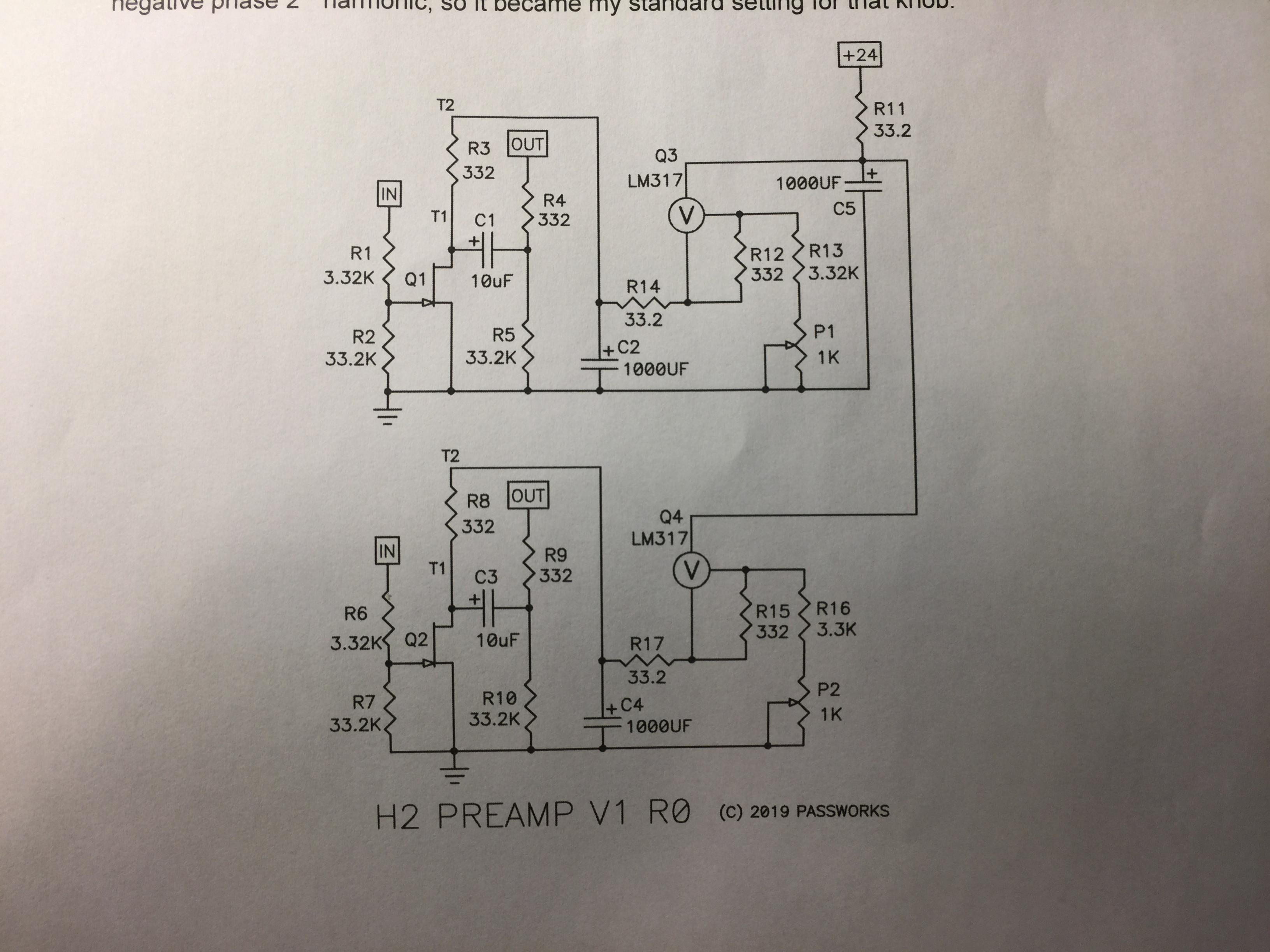

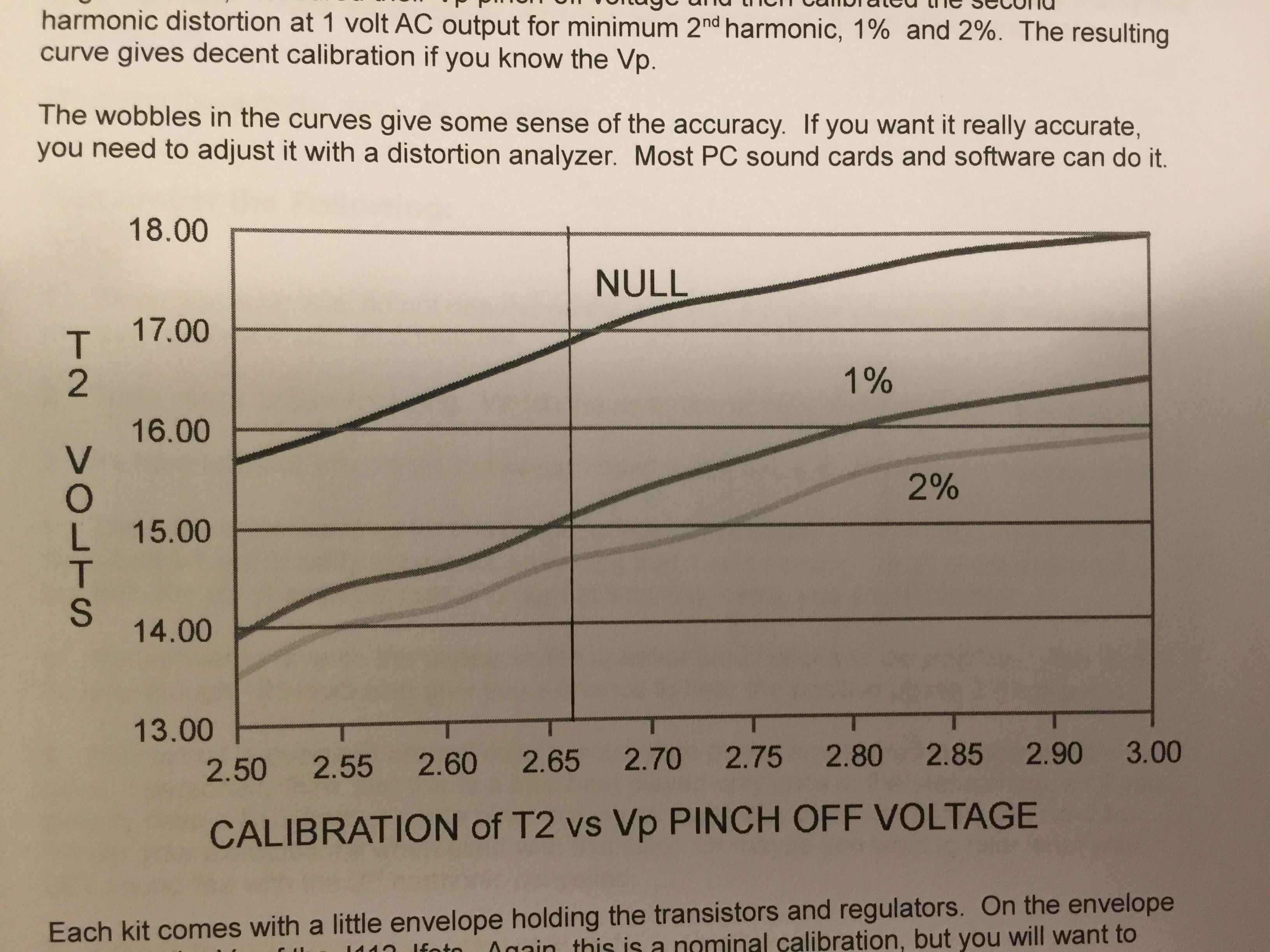

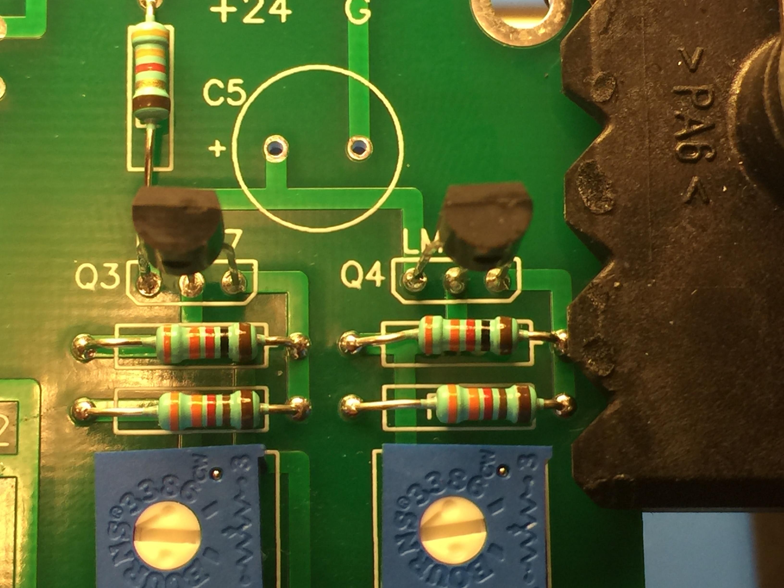

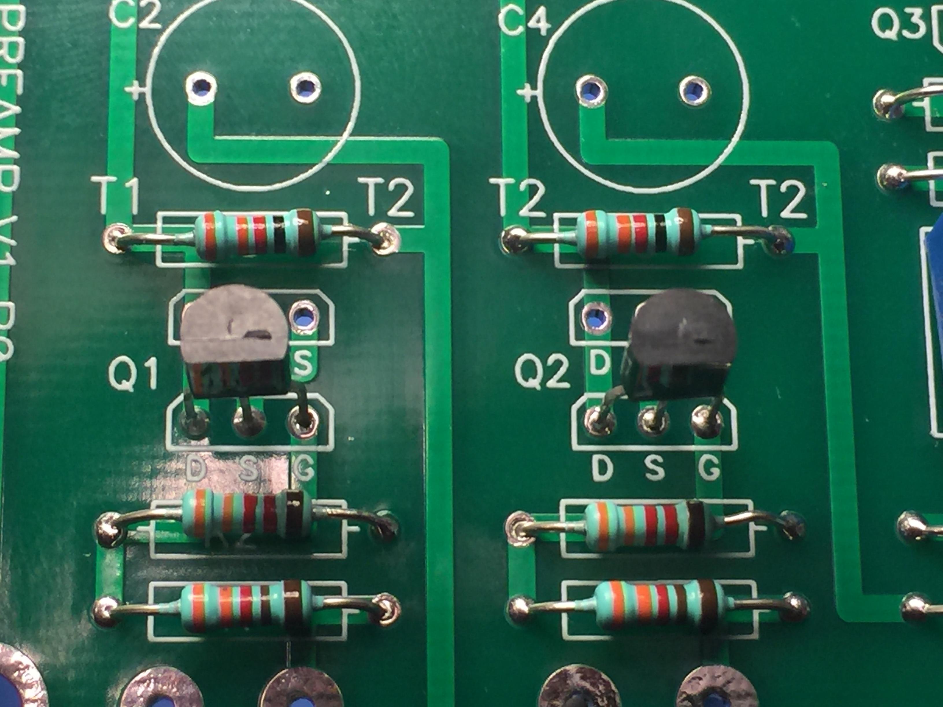

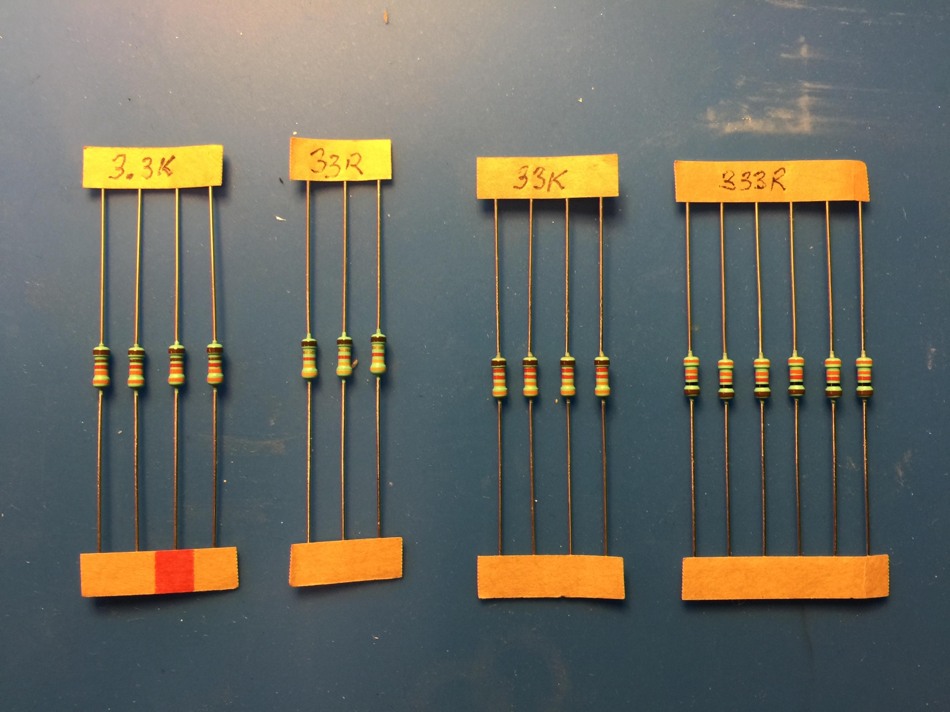

Thank you 🙂 According to the documentation, to achieve zero, I should have more than 17V in T2 points. Unfortunately, I can only get a maximum of 16.4V. The power supply provides 24V.
If you increase the value of R13 and R16, that will increase the voltage at T2. You can replace the existing 3.32k resistor with a higher value such as 3.6k. The exact value is not critical. Or if you have a couple of small value resistors (150R to 300R) handy, lift one leg of each of the R13 and R16 and series connect one resistor to each of R13 and R16.
But before you make any resistor changes are you measuring at the correct "T2"? There are two T2 at R8 and only the T2 on the right of R8 is the correct one.
