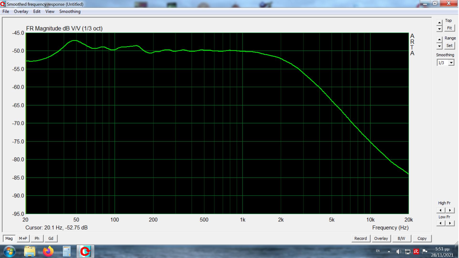

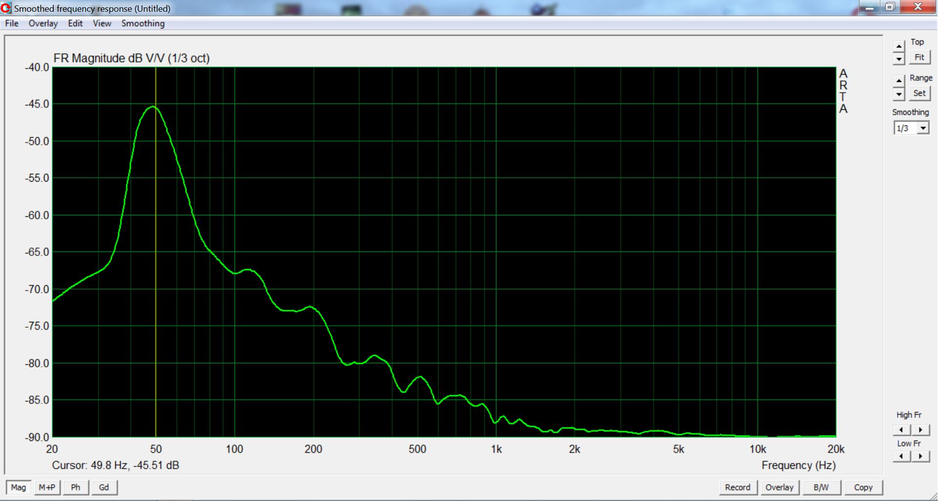

I now realize that I made another mistake, fortunately one that doesn't require schematic or PCB revisions: the frequency adjustments do not cover the intended range. I somewhat overlooked the fact that there are 4 frequency-defining components for each filter frequency, meaning that the variation of a single resistor with the trimmer only results in a square-root variation of the frequency.
Currently, the 1Meg + 100K variable only covers ~half of the intended variation range.
There are two possible solutions: use 2% capacitors for the filters or keep the 5% and increase the range by changing the 1Meg fixed to 910K and the trimmer for a 220K.
Even more radical, you could use 820K fixed + 470K variable, but I like to keep the trimmer as small as possible, as it is a weak point, especially being used in variable resistor mode.

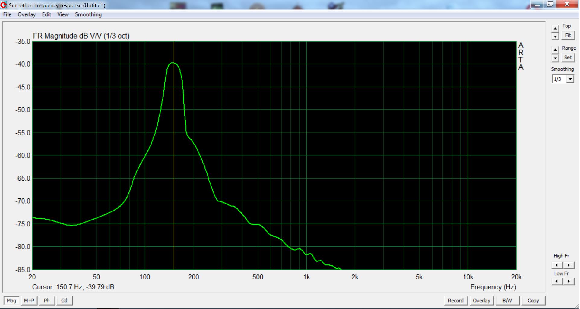

I note that your frequency graphs show a marginally low center frequency.
This could be corrected by reducing R56 and similar resistors. You should be able to gain 1 or 2dB and center your trimmers by reducing it by ~10% (next lower E24 value).

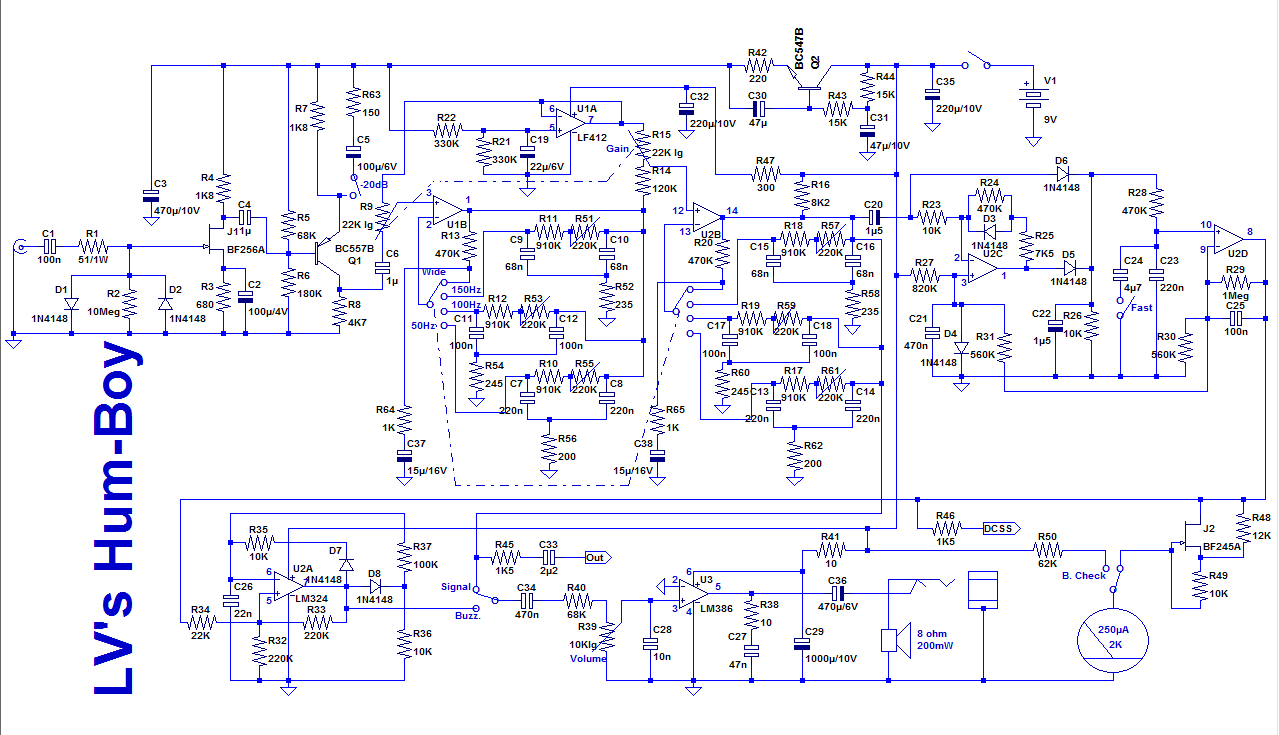

Regarding the pinout of the BF245 vs. 256, the original Philips datasheet shows identical pinouts.
Motorola and others seem to have departed from it, but in reality it does not matter: these FETs are symetrical, and the tiny differences, if present, would only affect the VHF/UHF performance. They are completely irrelevant for AF applications. Just orient the flat side according to the maker, much like when you replace a 2N3904 with a BC547.

Here is the (provisionally?) final version of the schematic:
Important note:
I also noticed that C5 had been drawn upside down. This update shows C5 correctly oriented

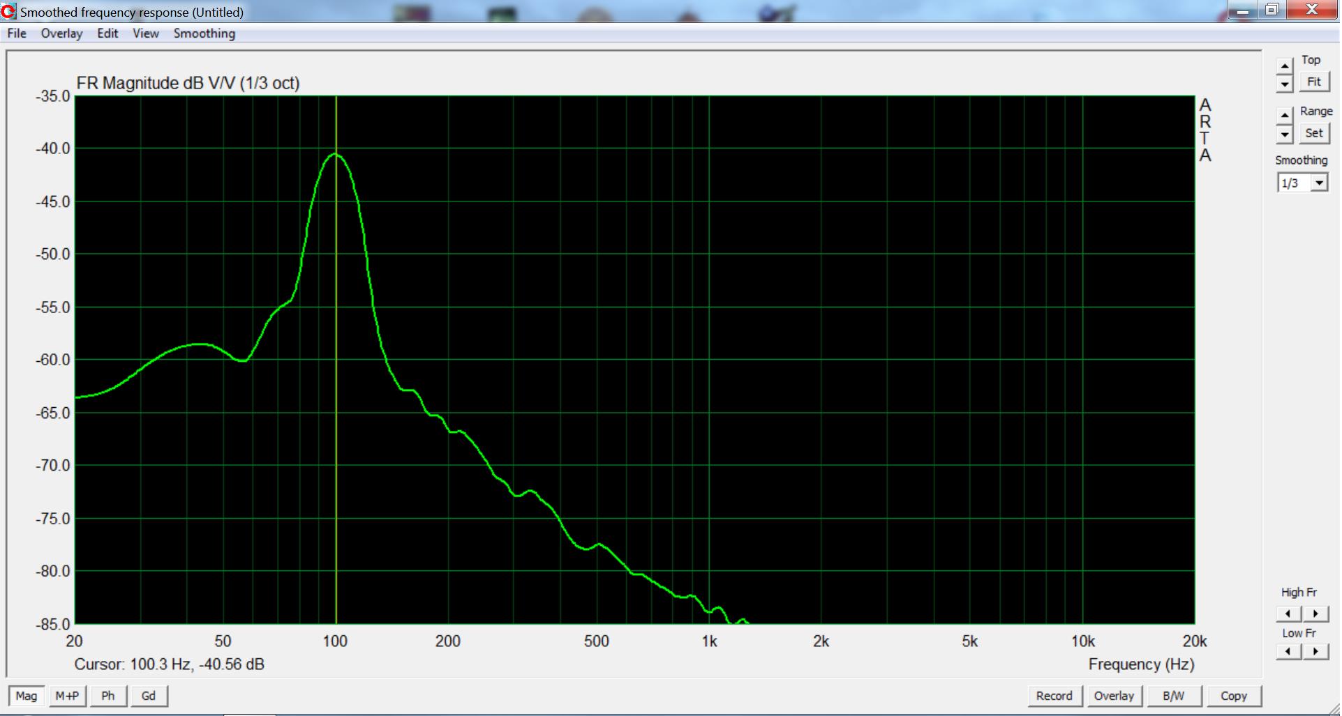

All done and very much worth it! It is now very easy to center the trimmers. I was able to calibrate it even using my sound card. 50Hz seems just a bit off but it works fine I think.
That looks good enough: I think your HumBoy is now operational, ready to track down the most elusive hum sources

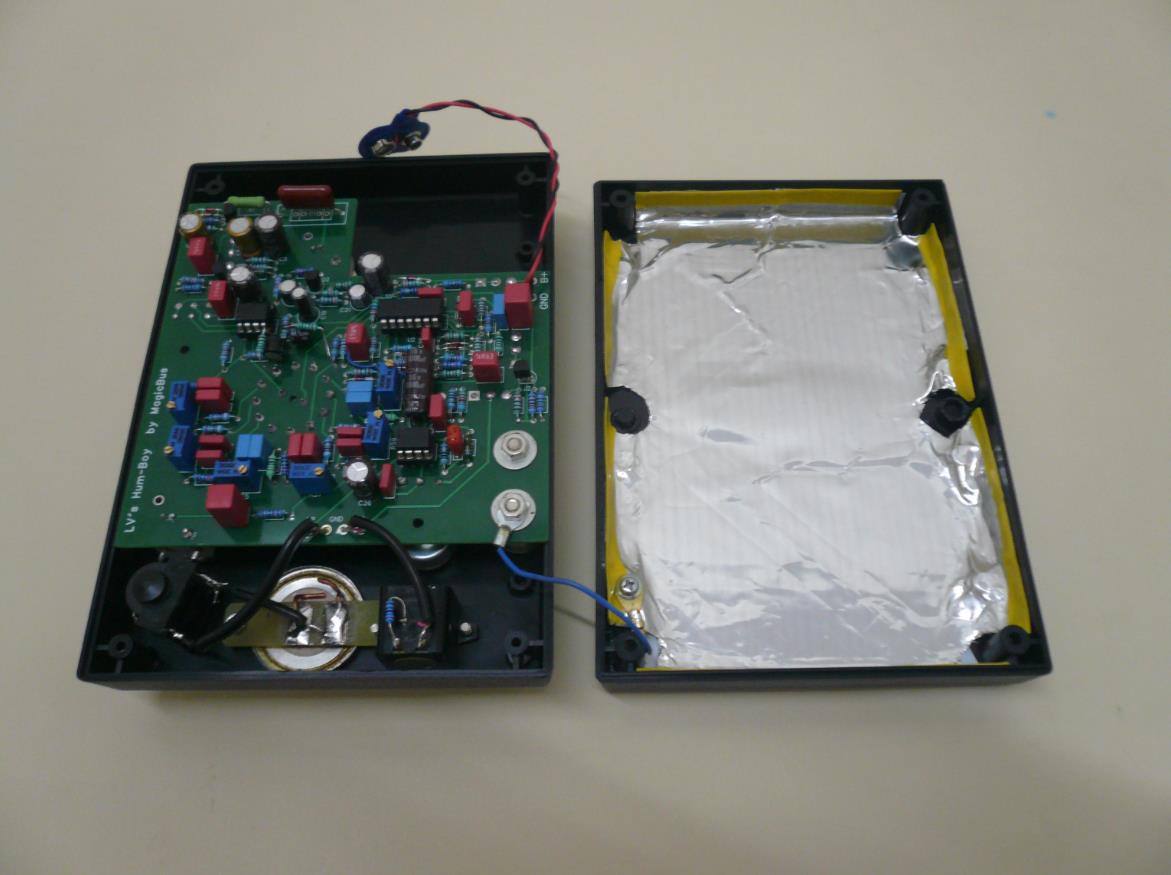

This is what I'm working on currently. It seems that an aluminum foil on the rear is all that it needs. I'll post results. Funny thing is that without shield it is sensitive at the top side and almost not at all at the components side bellow. But when a shield is added it helps a lot at the top.

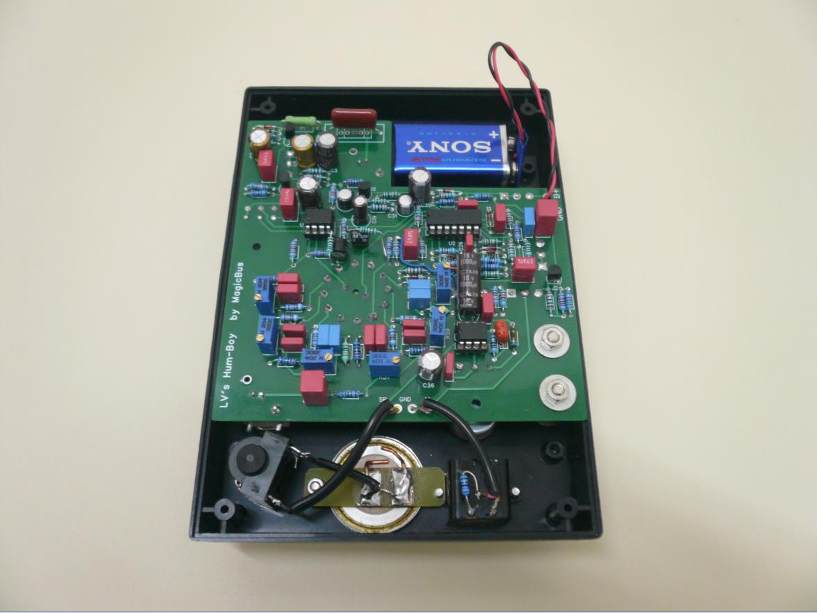

I settled to this. Although not a Faraday cage it works well together with the pcb. There will be some buzzing proportional to gain setting but it's not affected by hand proximity at all and allows plenty of headroom for the probes to sniff around noisy sources.
Good.
Be aware that the Humboy has a lot of excess gain built-in: even in a completely closed metallic case, with the input shorted, you will get a response if you push the gain near the max., due to internal noise
The excess gain is to make sure that you can always use the maximum sensitivity, even with ineffective probe types.

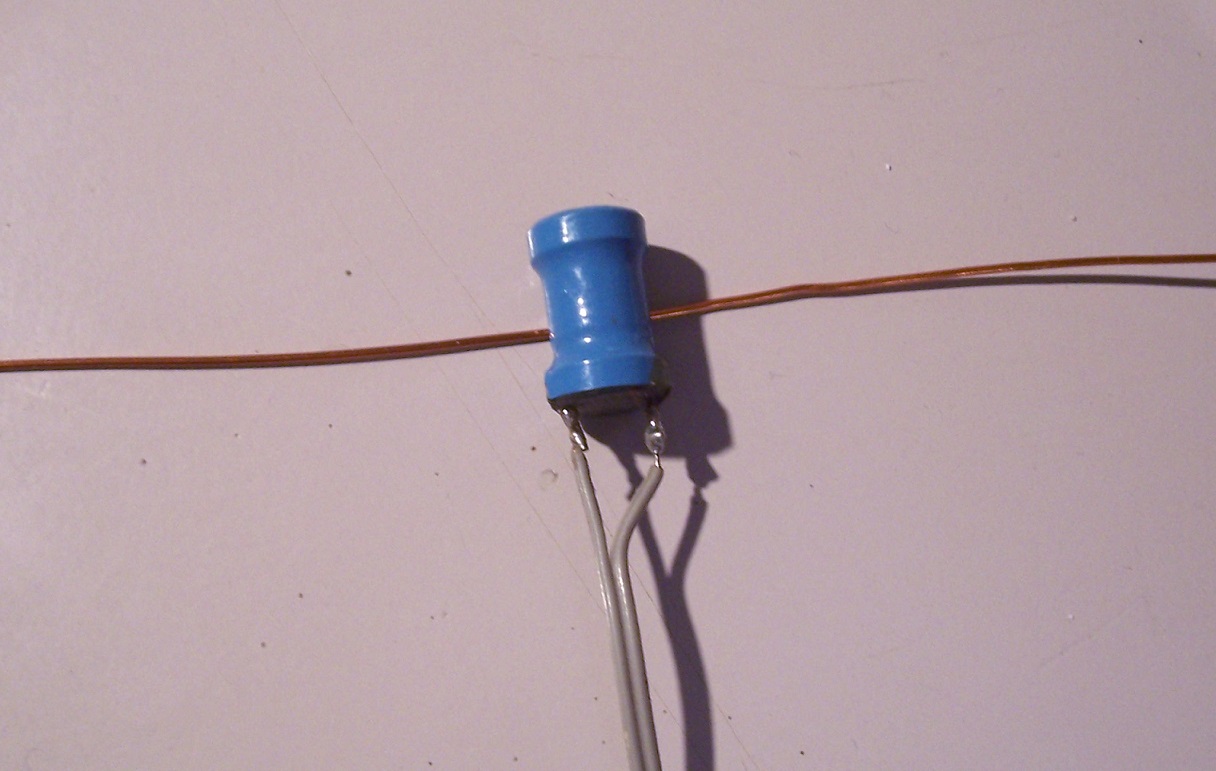

A word or two about using the Humboy:
When you use the inductive probe, which will normally be the case in most situations, you have to be aware that due to the laws of induction, the optimal orientation wrt. the current to detect can be counterintuitive.
This is illustrated in this pic, with the coil and wire naked, for more clarity:
This configuration will result in the highest sensitivity, in the case of a single, isolated current: the current direction is normal wrt. the axis of the coil; or in another words, the current needs to be tangential to the coil, and that remains valid at any distance.
That is the type of situation you will encounter if you want to detect the ground-loop current in the shield of a cable.
With a power cable, like a figure-of-8 type, the two currents cancel one another, and at a distance, you will detect nothing, but in close proximity of one of the conductor, the asymmetry will create a small, but detectable field
