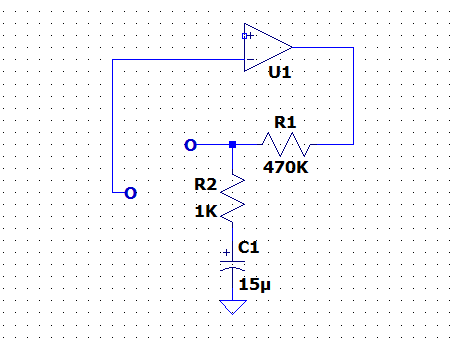

I just realized that I forgot to include the gain networks on the schematic.
This means that both stages work in unity-gain for the wide mode.
Sorry for that omission guys, I tripled-checked the schematics, but I missed that one.
Here is the correction:
C1 and R2 are the additions
Fortunately, it doesn't impair the usual operation modes of the tester. This signal-tracer function was among the various bells and whistles, but it is annoying anyway.
MagicBus, this shouldn't be too difficult to retrofit on your already built PCBs, if you want it.
I will update the schematic later

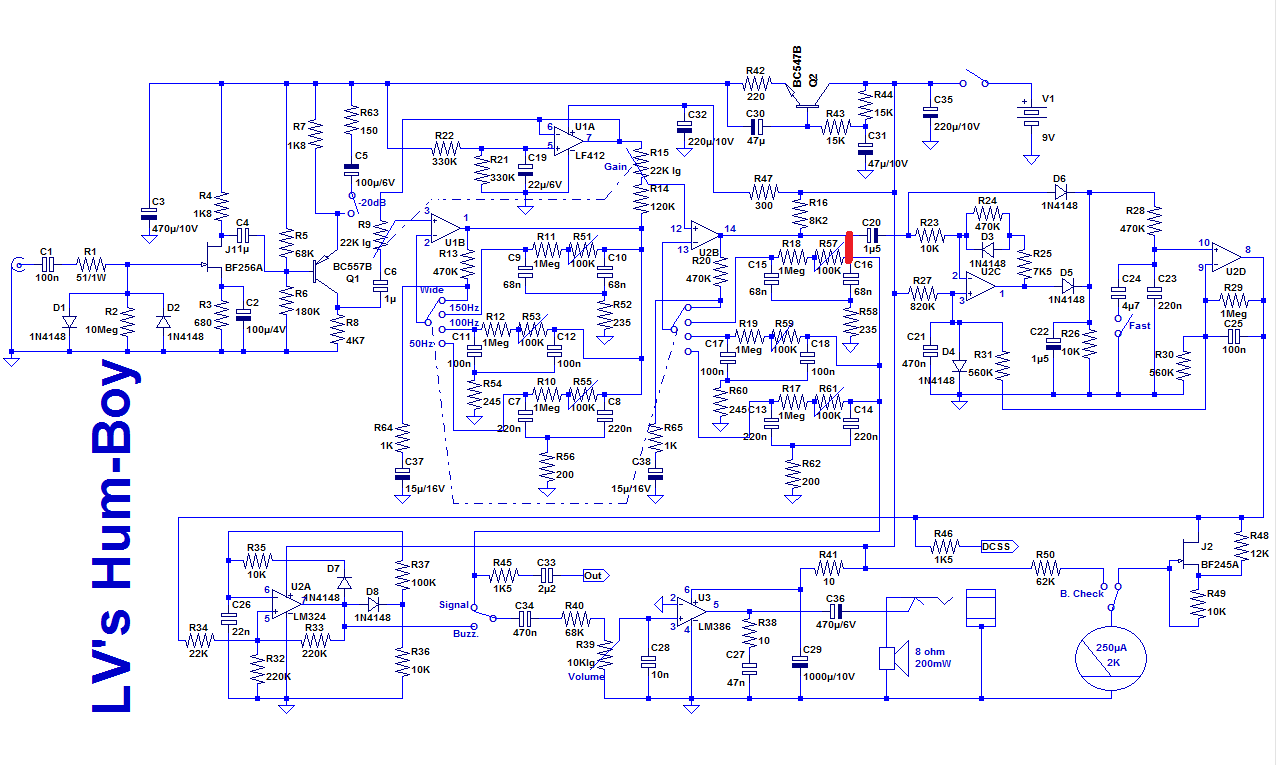

Yep, another omission .I think there is a missing link in the schematic to complete the feedback loop around U2B or is it?
Sorry about that, here is the schematic with the missing link in red:
Thanks, but prudently wait until poor MagicBus has weeded out all of the mistakes/omissions.Thanks @Elvee It is an upscale and improvement of Carlson labs Signal Sniffer !! I have to make one
This project was pen and paper only, meaning I had to transcribe the final schematic into an electronic form, which generated a number of errors.
Errare humanum est, and I am undoubtedly human....

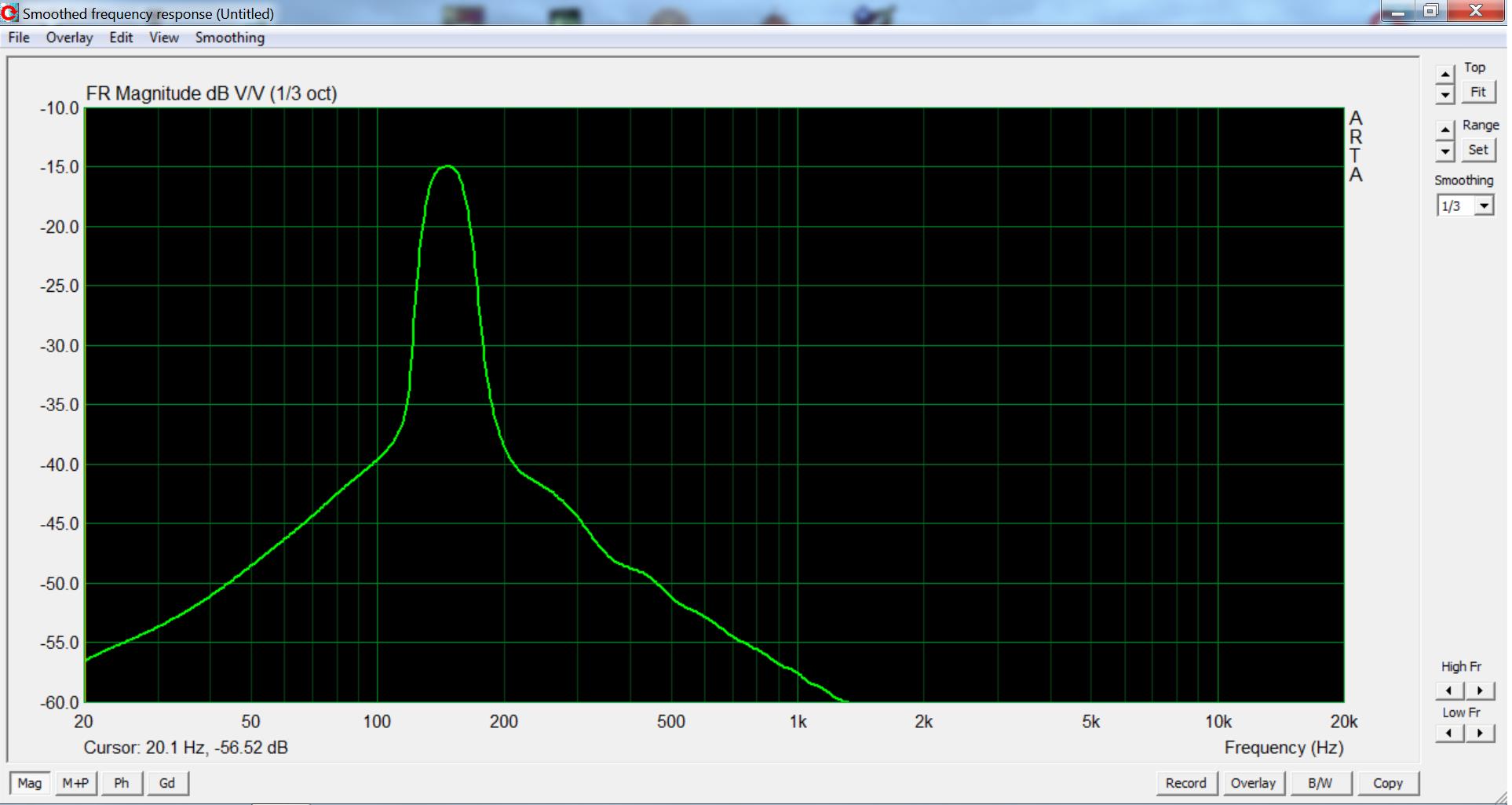

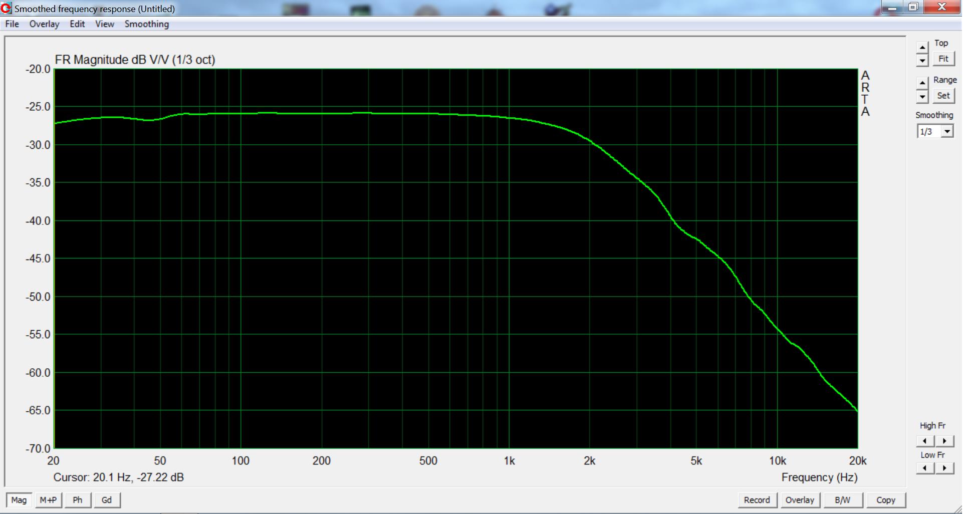

I spent more time with this in the weekend. I believe I have it fully functional now. Indeed it likes the trimmers close to the end of their range but not any further. Attached are frequency response graphs for each mode. Also tested on a linear psu and it was a matter of seconds to tell the transformer from the rectifiers! And it does not react to power cords now.

Here you are! According to schematic in post #52. I added an LED D10 with its limiting resistor R66 -could be omitted- and a diode D9 to protect for reverse battery connection -it can be replaced with a jumper wire. This diode will drop B+ by 0,7V which is convenient since I used BF245 for J1. Note that silk screen for J1 is for BF256. For BF245 it should be reversed. Finally, the blank PCB serves as a template to drill the holes on the chassis.
