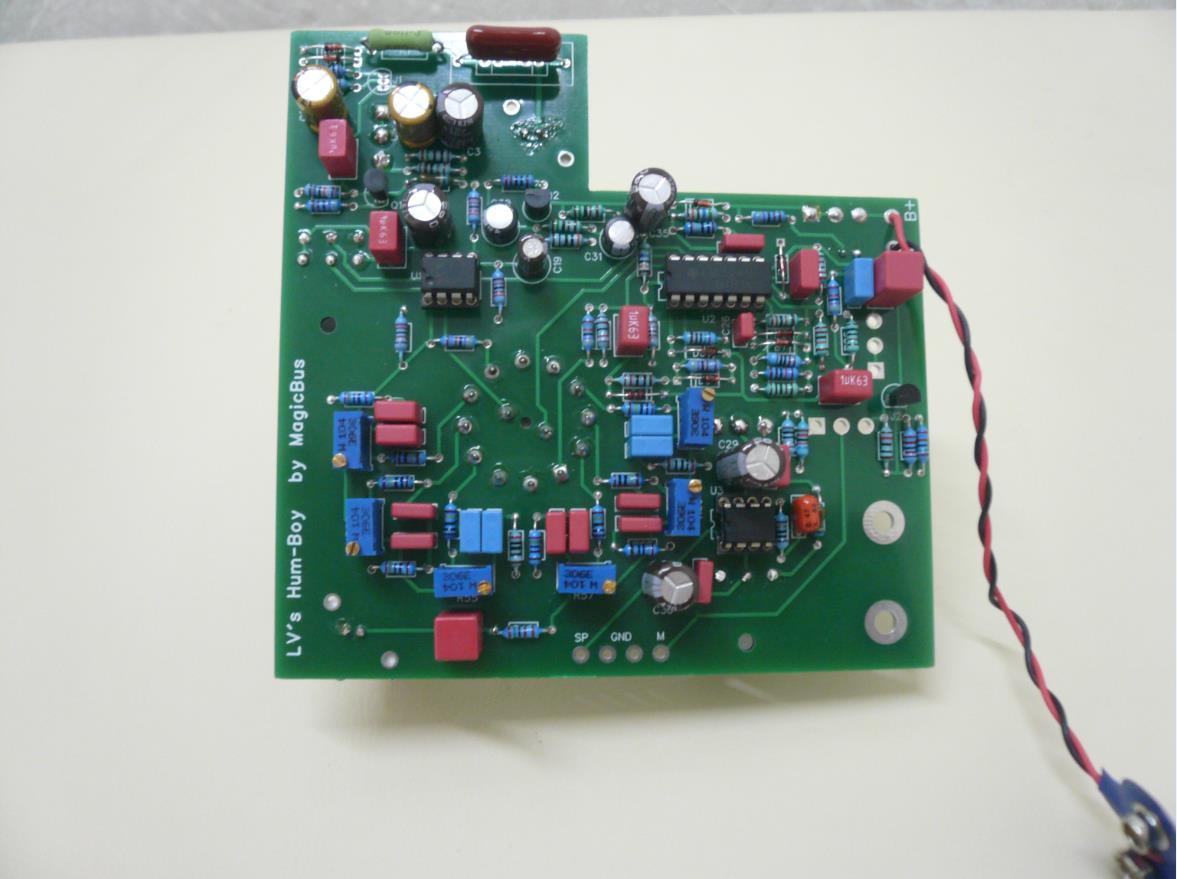

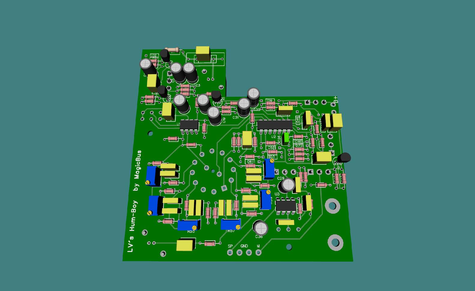

Here is a short description of the circuit:
Front-end
The first stage is a FET, to allow the connection of any type of probe, including the electrostatic, high impedance one with a minimal noise penalty.
The second stage is a plain-vanilla, common-emitter amplifier having a switchable gain.
The total gain is ~20dB/40dB.
The input is protected against moderate abuse by R1 and D1, D2.
As the PSRR of the preamp is not very high, the supply is made extra-clean thanks to the combined gyrator/cap-multiplier built around Q2, and the bypass cap C3.
Filters
After the first section of the gain potentiometer, the signal is sent to two cascaded bandpass filters U1B and U2B.
In addition to the 3 frequencies, the selector also allows a ~flat amplification with R13 and R20 as feedback resistors.
U1A generates a virtual GND from the clean preamp supply.
Some of the gain available is thrown away with R14 in series with the second section of the gain potentiometer: with the simplistic BPF topology used, the gain and Q are correlated, and to arrive at a high Q and a good selectivity, it is necessary to have a gain in excess of 2,000 for each stage.
That is more than 4,000,000 for the two stages, ~135dB.
Added to the 40dB of the front-end, It would result in a total of 175dB, which is vastly excessive.
U2B is a LM324, and because it is used well beyond its gain and bandwidth capabilities, it becomes unstable and tends to oscillate at the filter frequency, probably because of the awkward output characteristic of the 324.
R16 biases the output in class A, eliminating the instability.
Post-processing
The filtered signal is rectified by U2C and the associated components. The circuit looks convoluted, but it is quasi-fullwave, with a semi-log characteristic for very low levels, which is helpful in this tester.
The resulting level is further amplified by U2D and sent to the V-F converter U2A.
The VFC output consists of narrow pulses, to make a maximum of noise with a minimal current consumption.
The signal can also be sent directly to the audio amplifier, but this is useful mainly in flat mode: the filtered, low-frequency sinewaves aren't very audible, even with headphones, and they are completely inaudible on the small built-in speaker.
The audio amplifier U3 is a completely ordinary LM386.
The DC output is sent on a small galvanometer, using a FET circuit instead of a simple resistor, to magnify the low levels.
The DC voltage can also be connected to an external meter, to be able to make accurate comparisons between two situations for example.
It is also possible to increase the averaging time, to eliminate temporary fluctuations.
All of that is icing on the cake, and doesn't need to be implemented if you do not feel the necessity.
The total current consumption is comprised between 12 and 16mA

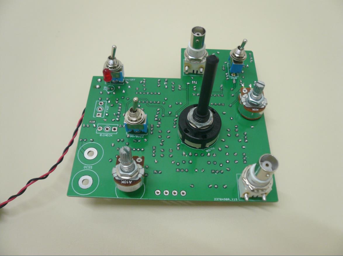

Rotary and toggle through hole switches checked. Only thing I can't find locally is the upright BNC so it has to be ordered. Final adjustments to the pcb and it's ready for order too. First time I'm doing this since the latest EU import policy changes. Let's hope for the best... My 3D library is incomplete but I think you get the picture.

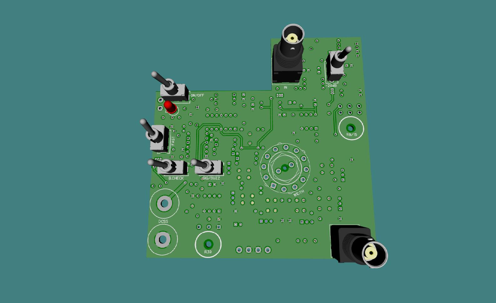

While waiting for the pcb to arrive, I thought to test the probes with my soundcard. To be honest, I don't know where to sniff with the electrostatic so a tutorial would be helpful. The magnetic seems to work but the FFT will always be full of harmonics no matter where I point. I guess the HumBoy will make the difference to this. For the pin point magnetic I tried an idea found in Rod Elliott's website i.e. a cassette player head. On first sight what seems to work better is a plastic erase head. But I don't know if it will be selective enough. What is your opinion?

An aluminum (or any metal) box is OK.
I opted for the more difficult choice of an internally shielded plastic box, because I wanted to avoid accidental contacts with various cables, other test instruments and conductive items on the bench. Not for safety reasons, but because of parasitic effects, ground loops, etc.
In general, it will be a non-issue since the tester is battery-powered, but I wanted a total freedom from such possible problems.

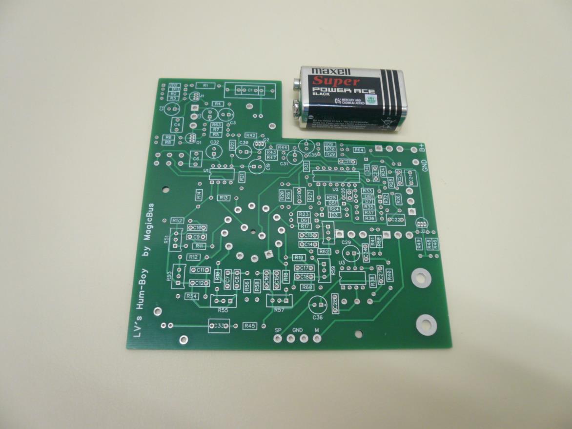

No particular problem with SMD. Since it will be easier to make compact circuit, be sure to keep the input preamp and the first filter bank well away from subsequent stages.
For the filter caps, the values would make ceramic of the X, Y, Z variety tempting, but resist the temptation. COG would be expensive, thus opt for good plastic films

Set the HumBoy to "buzz" mode, -20dB, 50Hz, zero gain, and adjust the volume control to obtain a comfortable buzz level.
Put the probe in the vicinity of an active 50Hz transformer (30cm for example), and increase the gain until the pitch of the buzz begins to increase.
Then, leaving the probe in place, adjust R61 to obtain the highest pitch.
If you reach saturation, reduce the gain to remain in the linear zone.
When it is done, do the same with R55.
For 150Hz, you can follow the same procedure (R57 R51): the 50Hz is naturally distorted enough, and the transformer will add to the distortion. A crappy, underdimensionned transformer will help though.
For the 100Hz adjustment, you need an operating full-wave supply.
Place the probe in the vicinity of the wire or track connecting the rectifier bridge to the filter cap, and proceed with the adjustments (R59 then R53).
Once all the adjustments are done, I recommend you experiment with known gear, to get acquainted with what is normal: explore the space around the PSU for all three frequencies, explore your lab environment, etc.
Then, if you have failed/shelved projects due to intractable hum issues, you can begin to revisit them, and try to diagnose the possible causes.
You can also investigate wiring issues: if the inductive probe detects a strong 50Hz common-field around a shielded cable connecting two pieces of equipment, you know you have a ground-loop issue.
Always start with the lowest gain giving a response, and increase/decrease it according to the results of your exploration.
Note that in "wide" mode, the startup time exceeds 10s, because of the large time-constants of the amplifiers (they are designed to pass 10Hz)
It is not complicated, but it depends on the test equipment you have available.
Let's start with the "ideal" situation, a well equipped lab.
You need a programmable signal generator and an oscilloscope.
The generator (or generator+ frequency-meter combo) must have a resolution/accuracy <0.1Hz.
Set the gain control (the ganged log pots) at ~30% of the maximum.
Select the 50Hz filter, 0dB gain on the HumBoy and inject a 0.1mV, 50.0Hz signal into the probe input.
Monitor the output of U1B with the scope.
You should see a 50Hz sinewave.
Adjust R55 to obtain the maximum amplitude. Note that it is important to make the adjustment very slowly, because the Q of the filter makes the response slow.
For the same reason, it is preferable to use an analogue or completely real time oscilloscope: on a digital scope, set the acquisition length, hold-off time and all other parameters influencing the latency to the minimum.
Be sure to inject the signal from the generator only: if you are not careful, and your test setup is not well shielded from the 50Hz ambient hum, the generator and mains frequency will create beat-frequency effects, resulting in a slowly varying output, at 0.1 Hz or less.
Once you are confident with the maximum amplitude, switch the gain to -20dB, move the scope to the output of U2B, and if necessary reduce the gain or the amplitude of the generator to obtain a non-clipped waveform, 2Vpp maximum.
Adjust R61 to get the maximum amplitude, using the same precautions as for the previous adjustment.
If you see some clipping, reduce the gain or the amplitude to remain in the linear zone.
Alternatively, you can connect a voltmeter to the DCSS output to detect the maximum, but this will not tell you if clipping occurs.
Once it is done, repeat the same procedure for 100Hz and 150Hz to adjust R51, 53, 57, 59.
If you have no equipment at all, it is still possible to make the adjustments, using only the internal circuitry of the HumBoy (assuming it is debugged and working properly).
Connect one of the probes to the input; preferably, the general-purpose inductive one, but the others can also be used.
