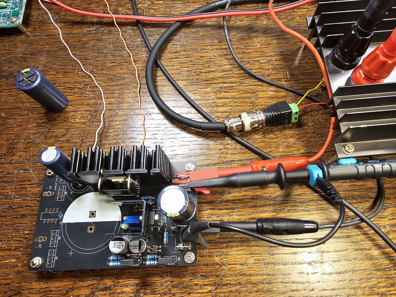

Some progress. On the bench under light load massage and measurements. 😀

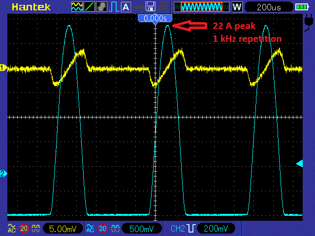

Test with 22 A peak load. Blue trace is voltage over 0.165 Ω inside active load and yellow is regulator output.
