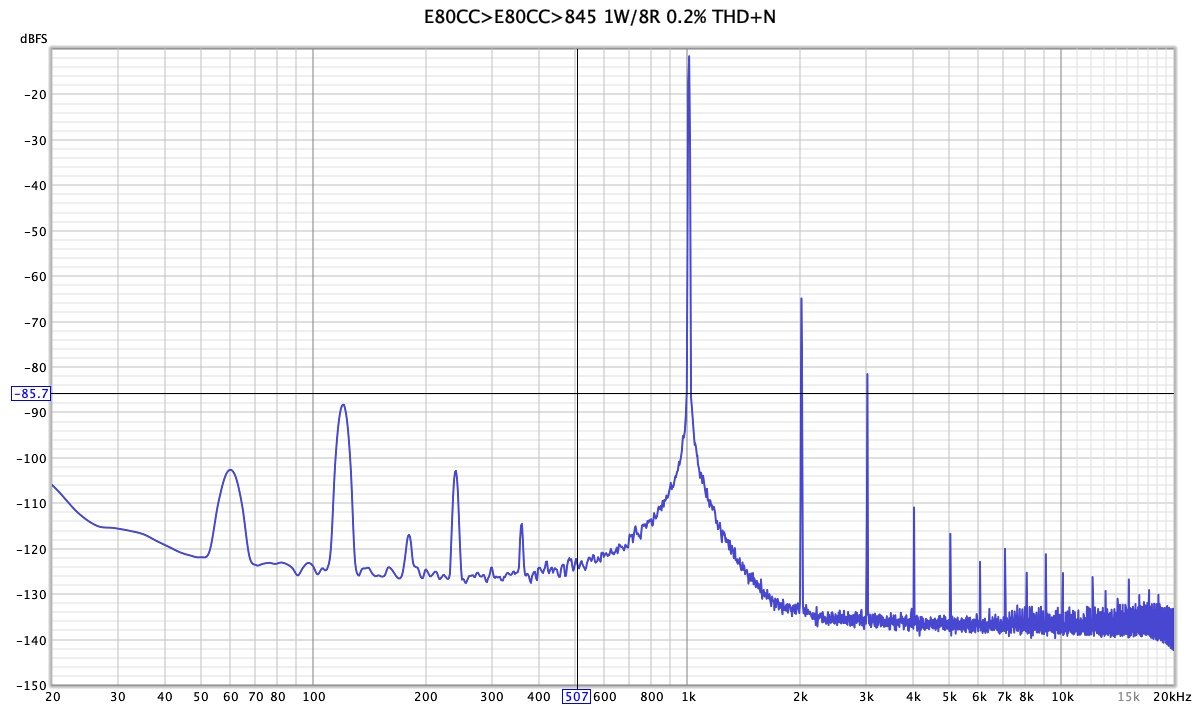

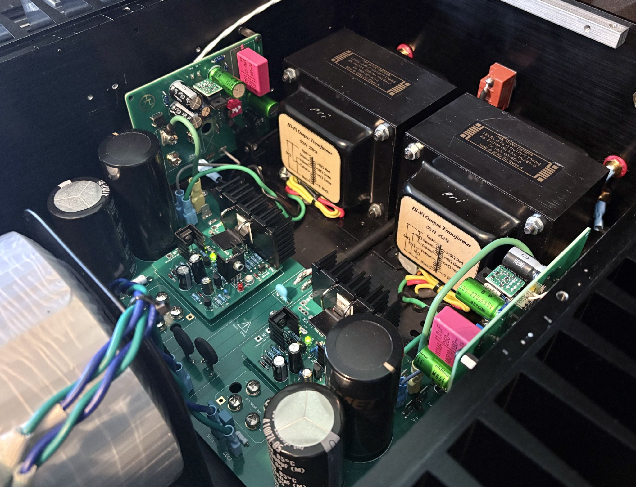

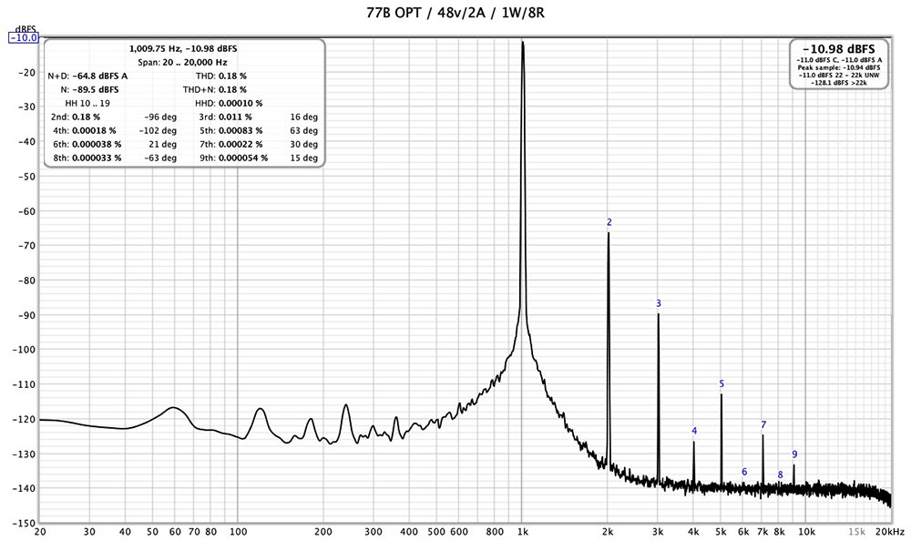

Finally wrapped up my amp project using the R21 motherboard. Its a 77B OPT-coupled common source amp – a Singing Bush style jfet buffer (thanks ZM) in front of a CS wired SIT and no feedback employed. Nothing new regarding the circuit itself, but its worth noting that the circuit has pretty poor PSRR. Still have a few more measurements to try, but the attached THD measurement hints at the quality of the R21 in action. Looking specifically at the 60hz harmonics, I can say with some certainty that these are due to magnetic coupling and the overall tight quarters of my initial test chassis. Even with those limitations, I'm impressed by the lack of noise. For comparison, see the attached image of an 845 SE amp that I built which uses a CLC filtering solution. Having built this proof of concept, I'm thinking that these channels ultimately deserve to be split-up and put in proper monoblock configuration.
You are right. It’s very hard to avoid some magnetic coupling, either directly to amplifier input or to measurement gear. There is only about 15 uV level at 120 Hz at your distortion measurement. Considering ripple before regulators, they pass only 1 uV ripple to their output or to amplifier rails. Rest is caused by induced noise. Peak at 60 Hz is directly induced from mains transformer and strong rectified current peaks, charging capacitors, cause 120 Hz radiated noise (+ some harmonics) that end in amplifier and measurement gear.
Still, incomparably better results than with an ordinary supply. 🙂
Yes, so much better than with an ordinary supply. This is not a great project to show the real possibilities of the R21, but it still shows how it turn a noisy circuit into something special. Can't imagine how this would perform with a complimentary circuit that already has some good cancellation. Super impressed with the impact it had on my project!

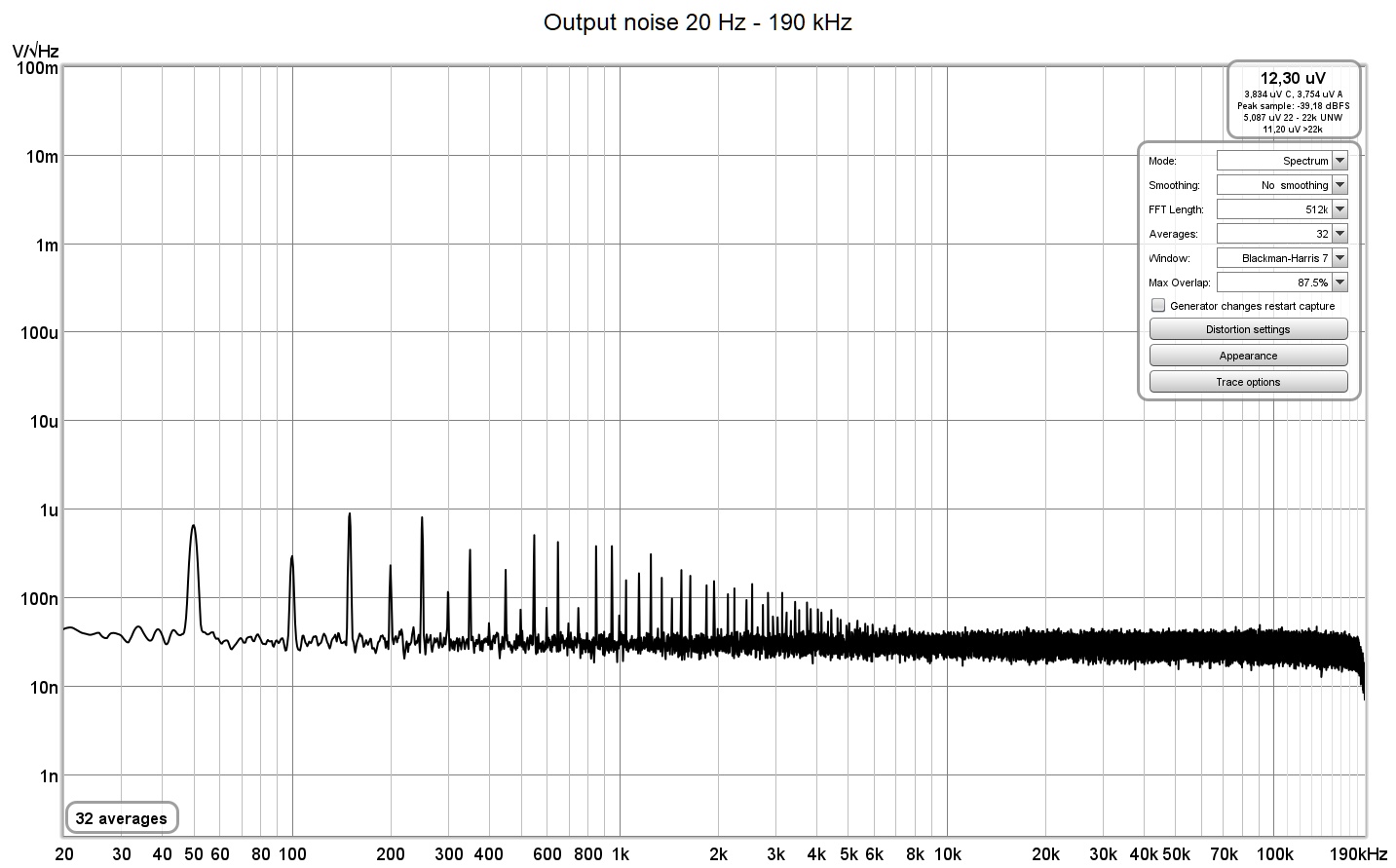

Regulators work in several amplifiers builds that have very good PSRR. That combination results with ultimate clean low noise output where mains artifacts are at below single uV. That is just nice bragging number unnecessary for excellent sound. Here is a wide band measurement of my amplifier output.
