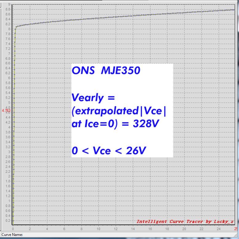

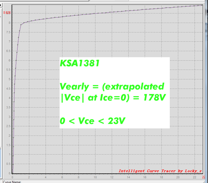

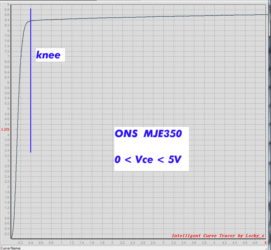

MJE350 is not suitable replacement [for KSA1381]. It’s not only about allowed Vce but how little Ic changes due Vce variation.
Here are curve tracer plots of KSA1381 and also of MJE350, measured on transistors I bought from Mouser, using the "LockyZ" instrument. The knee in the curve, where constant current behavior begins, is much better in the blue than in the green. Early voltage is better too.

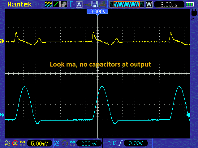

Regulators work with small output capacitors. Positive regulator works even without any output capacitor, on condition that constant load of >50 mA is present. Here is its response on 20 kHz, 5A peak transient load with no capacitor. Blue trace is current through 85 mΩ resistor and yellow is output voltage.
However, capacitors larger than 220 – 470 uF, show positive difference when regulator is tested with square wave 5 -10 A loads. Differences are still in the mV range, but are there. With several mF capacitor, actual load from amplifier will modulate regulator output in uV range.
