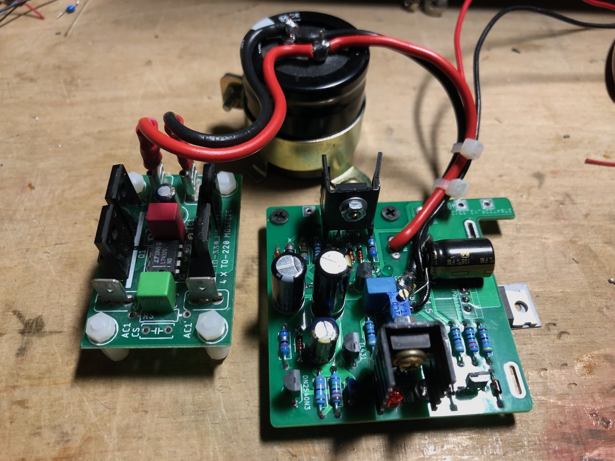

It would be way more usable/versatile with normal square/rectangular shape and as a complete stand alone PSU. Also it lacks mounting holes and one of the 2 existing mounting holes interferes with a heatsink. Opinion/taste/preference, nothing more. I really like the performance!

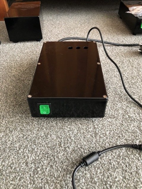

I just built it as exercise as I (like usual) just had finished an LDO 5A PSU for class D MA12070 amplifiers. Also functioning quite well but with higher dropout voltage. Case is heatsink.

You probably don’t need simulation but you do seem to need non virtual trouble shooting. An assembly error? Part value error?
Mine did not regulate either as I soldered in both power transistors in mirror. Oops.

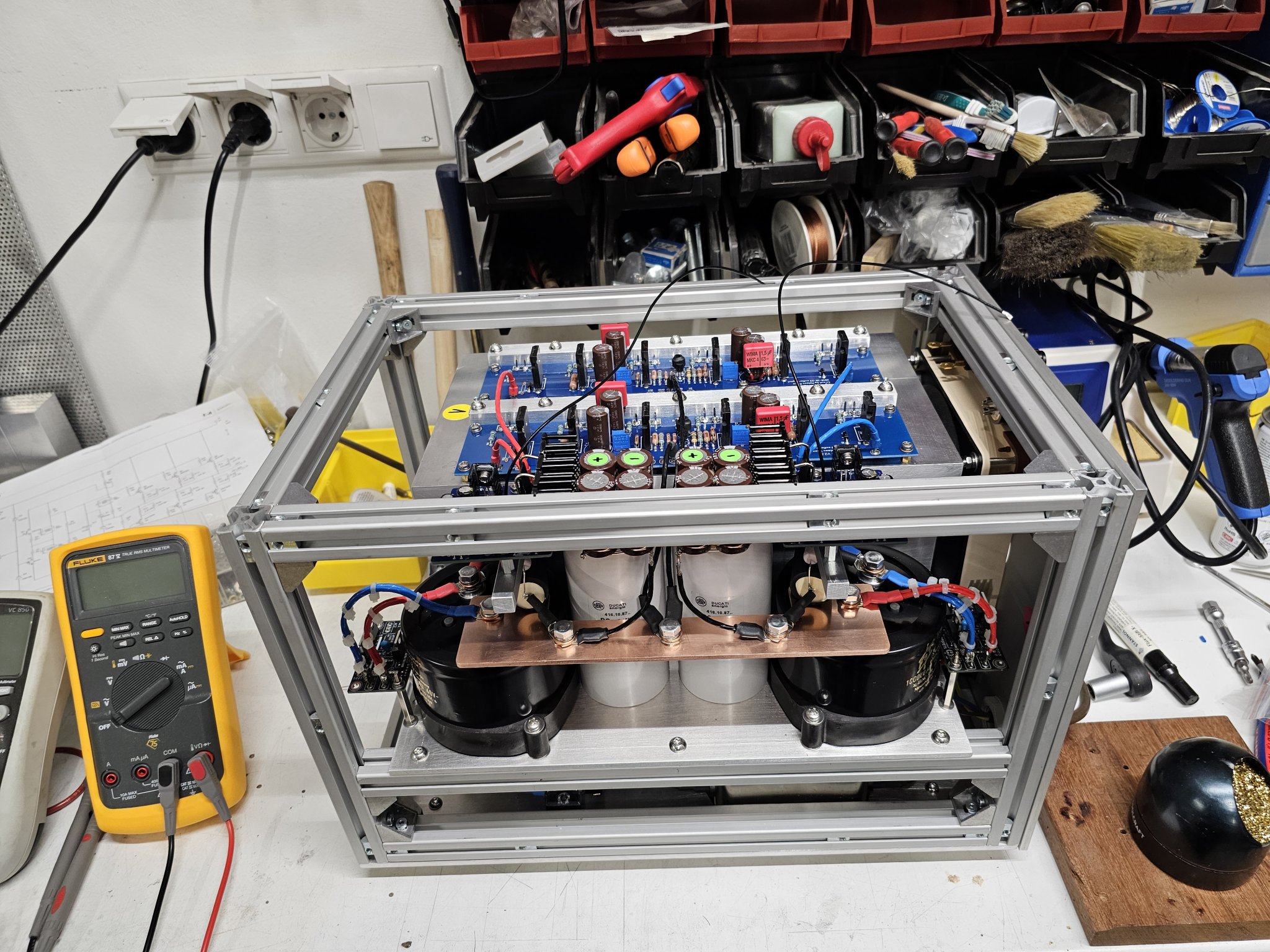

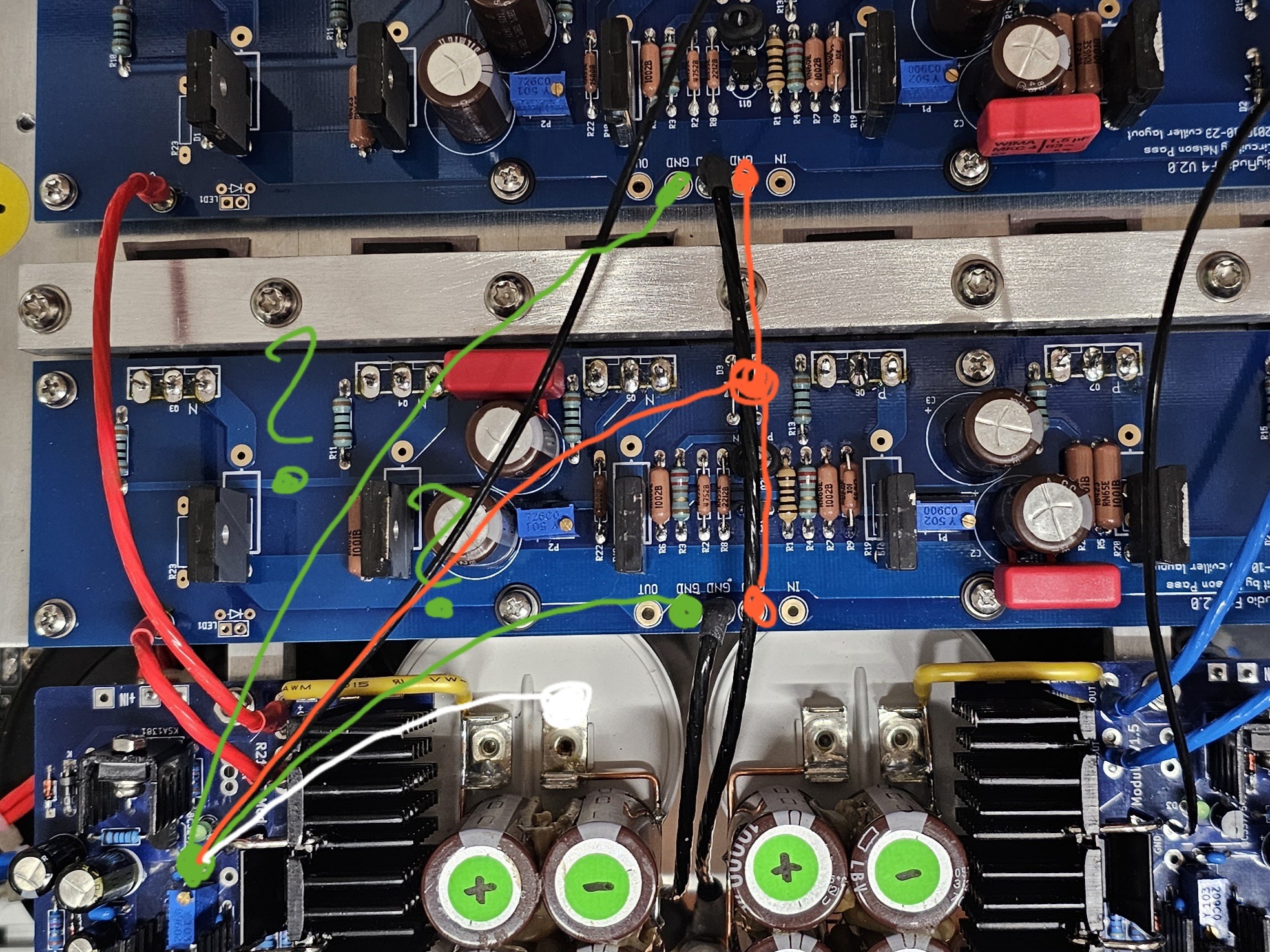

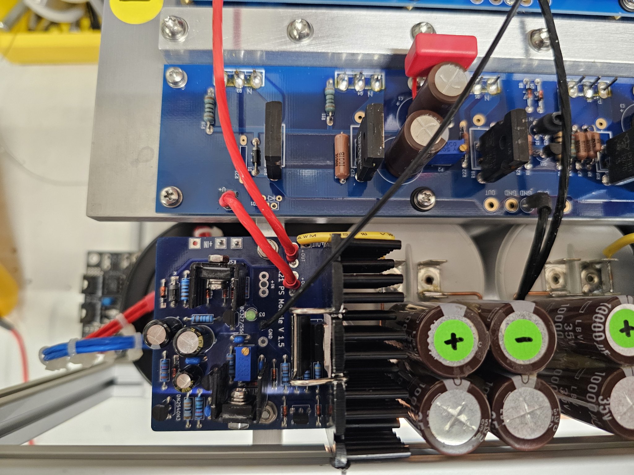

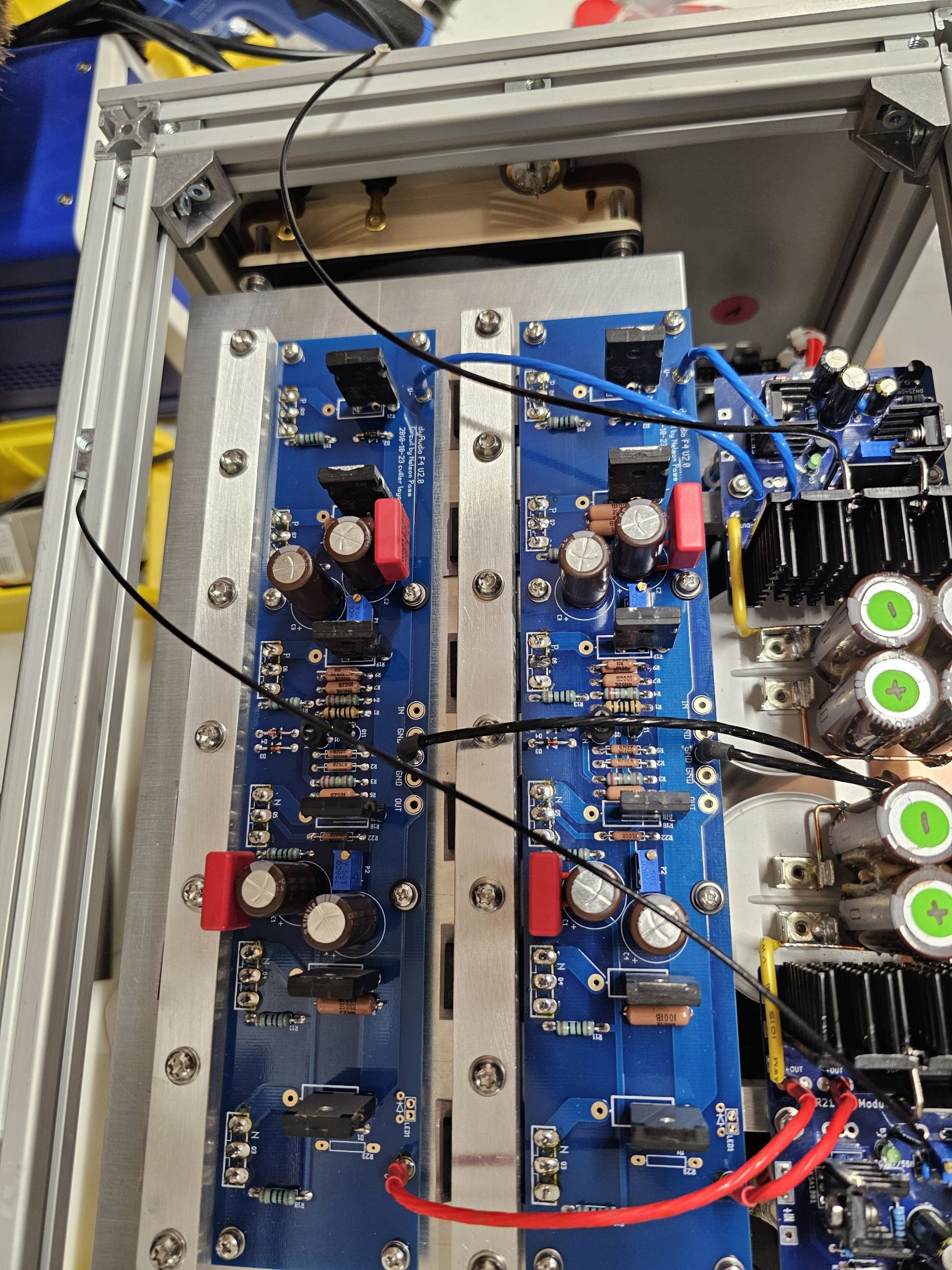

I have a question for @tombo56.
I use your R21 voltage regulator for the PSU of my FW F4 balanced mono blocks.
Thank you for this great design!
Everything went well during construction and commissioning, the regulators work without any problems.
Now I just have to decide on a final connection for the ground of the regulators.
Normally I would connect these directly to the amplifier boards.
But because I use two amplifier boards due to the balanced configuration, I'm not sure which one (green).
Or in the middle of an additional ground connection between the boards (red).
Or perhaps to the ground connection of the capacitors behind the regulator?
Or a different position?
Thank you in advance for your help!

Never thought to use 2020 extrusion for an amp case! Would make for a heavy, but solid build!
Would love to see more pics of your build when you're done
Have a look at the F4 Building thread:
https://www.diyaudio.com/community/...ing-the-pass-f4-amplifier.234355/post-7728683
Grounding wires from both regulators should be connected, with shortest path, to the common ground between two final PS output capacitors -> white line on the first pic.Now I just have to decide on a final connection for the ground of the regulators.
BTW, great amplifier build.

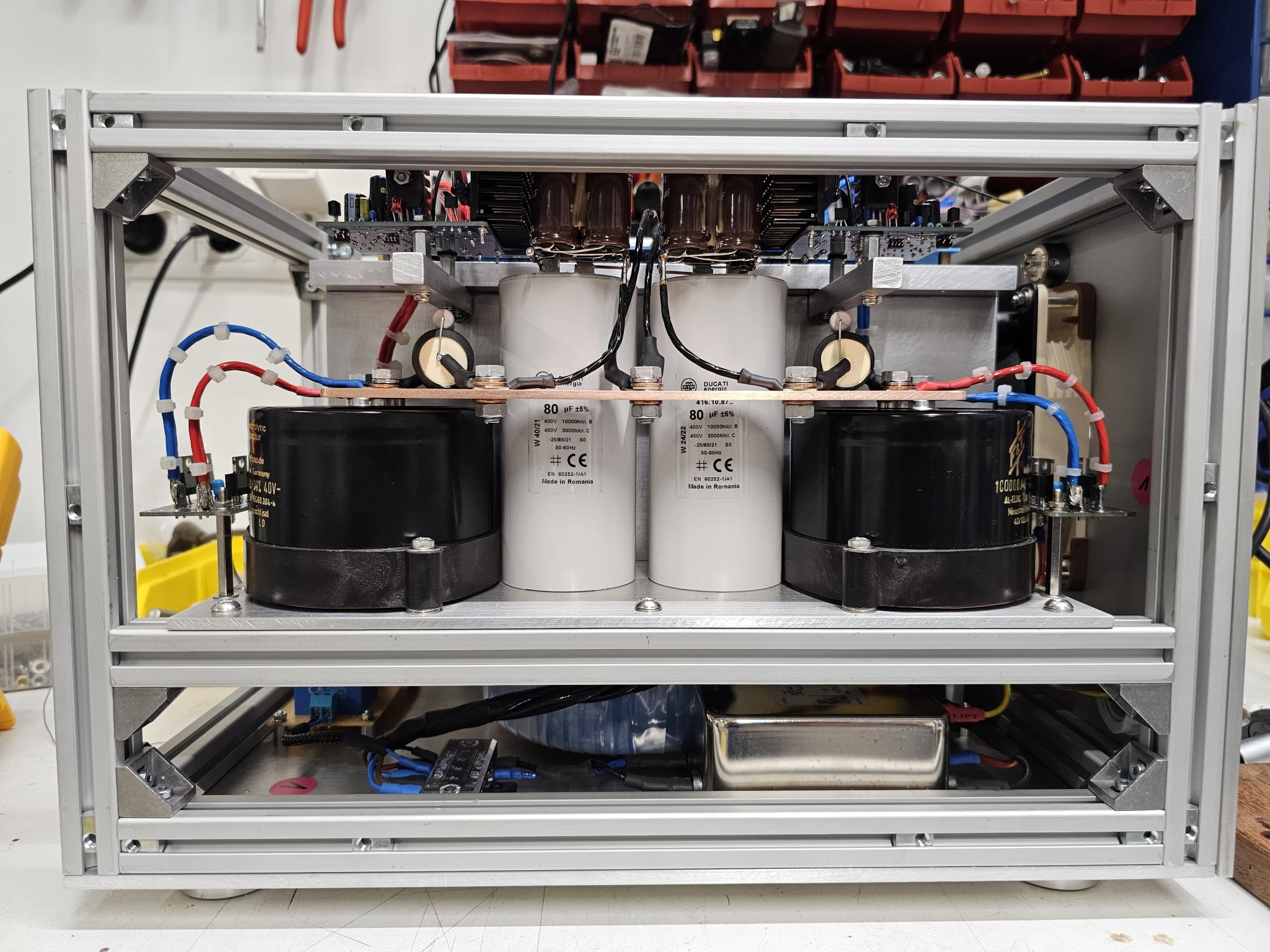

Hi, any pics of your setup? ThanksTime to bring this thread back to the right track, my experience with the R21 modules.
To start with, the setup:
Six fully separate power supplies, where 300VA transformers charge capacitors with 0.1F each via 0R1 resistors. The diodes have snubbers. The DC of +- 30V feed six P3A amplifiers (Rod Elliott) in its original versions except for the high frequency branch, where the VAS stage got a five-transistor current mirror and emitter degeneration for the differential pair. The drivers were selected for high efficiency, low mechanical loss, and low distortion (coming from 18Sound: 15" in a closed box, Accuton 173Nd and a large Mundorf AMT). The digital data from a PC go via a Dante network into a HD2, which provides FIR filtering with a linear phase down to 20Hz.
Up to now, the sound of this setup was pleasant to listen to, but at larger volumes many recordings, especially from the progressive rock genre, produce fatigue after a while. Vocals (e.g., the marvelous Dorothea Mields, whom we heard live in concert) had some kind of unnatural sharpness, therefore, room for improvements,
For fitting the four modules into the casing, one of the transformers and its capacitor bank had to leave and where replaced by four R21 modules. The output voltages were set to 26V (30V is the input from the remaining capacitor bank). For getting an AB comparison, one channel was changed and could be compared to the unmodified one:
The unmodified channel had a noticeable brightness in the mids and highs relative to the R21-channel. My wife confirmed this impression without knowing, what I have changed. Furthermore, the sound stage seemed to be a bit more flat with less separation into the stage. So a good incentive to modify the other channel as well.
Wow! The brightness at louder volumes has reduced significantly. Three, four dB louder than before, no problem! Since my wife and me are quite sensitive to distortion, this mod was not the cheapest one (this was removing the screen of the XLR cables from pin 1), but definitely worth it!
Fazit: A simple amplifier such as the P3A (which suffers obviously from a low PSRR) benefits a lot from a ripple-free DC, so go for it.
