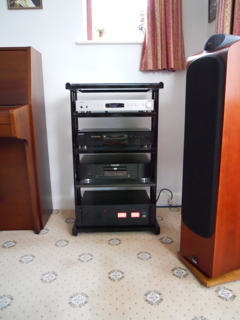

@Mooly: that is far too organised. I use my piano to hide the wires behind!
I can't be doing with wires everywhere (lol). I even considered having the speaker leads go under the floor and emerge at the destinations but they are not intrusively visible normally.
Soon will need to work out how to fit 2 pianos in the house!
A duet (or is it a duel).

One day maybe, but being in a rental and having against one wallI can't be doing with wires everywhere (lol). I even considered having the speaker leads go under the floor and emerge at the destinations but they are not intrusively visible normally.
PC (for communal stuff like netflix)
music server)
digital piano
Wii
TV
Bluray
Stereo
Sub
Heat gun
It's a bit full of wire 🙂
Oh and 12ft by 11ft and we need to be able to fit 6 in there. I really need somewhere bigger !
I do wonder. The daughters are better players than I am. They would probably love that.A duet (or is it a duel).
