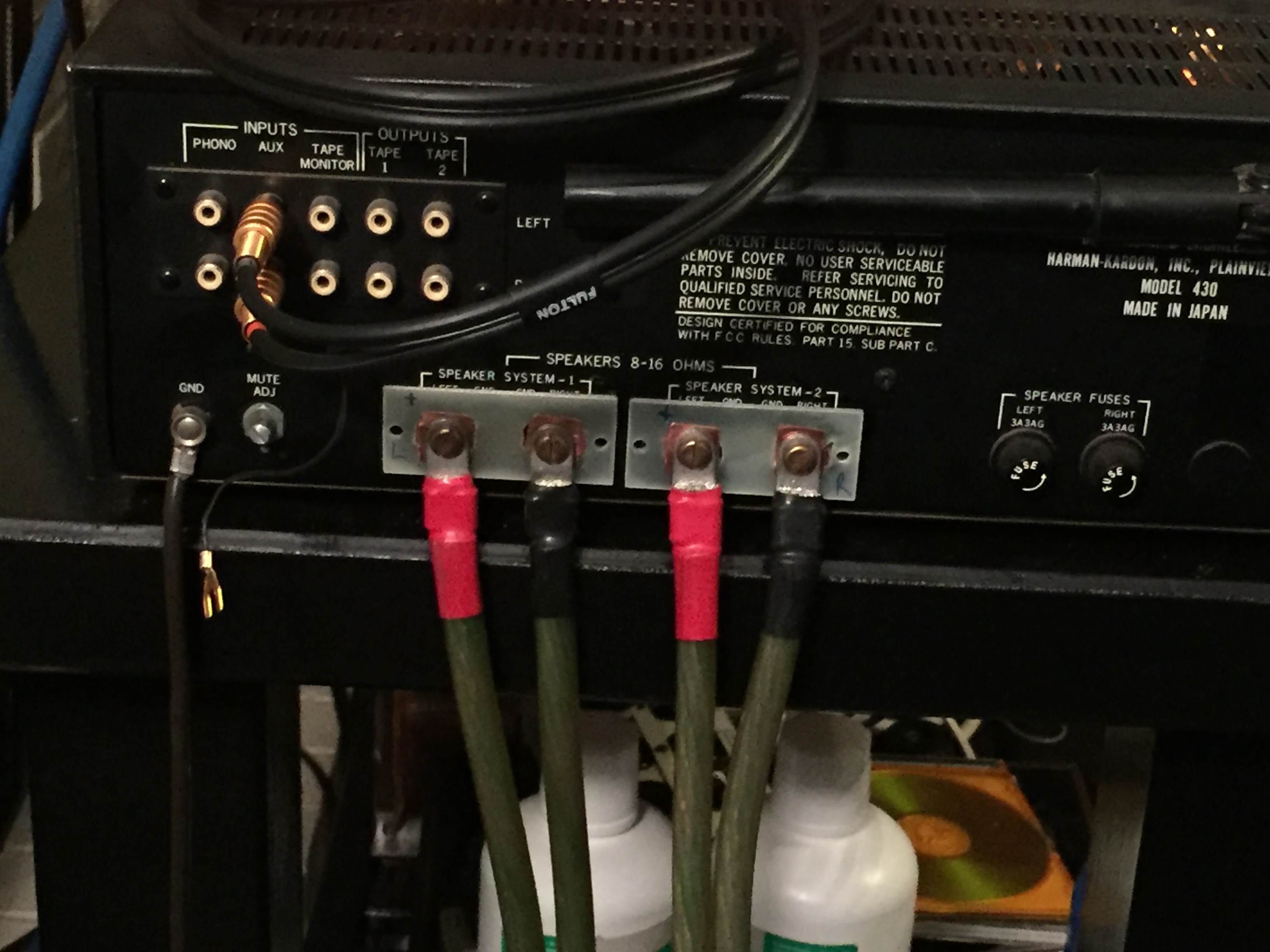

Tomorrow 😉 I was looking for a picture I posted some time ago that should give a good clue. And I can't find it.

Found it
http://www.diyaudio.com/forums/soli...tortion-increase-frequency-3.html#post1557089
All I can say about the amp is that after years of 'other amps', this is the one that does it for me. It has you exploring the music, and not looking for music that only sounds good on a certain system.

@Mooly: that is far too organised. I use my piano to hide the wires behind! Well actually wife's piano. My Kemble is at wife 1.0's house for the daughters to play. Soon will need to work out how to fit 2 pianos in the house!
