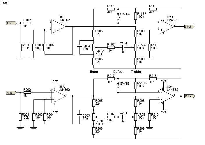

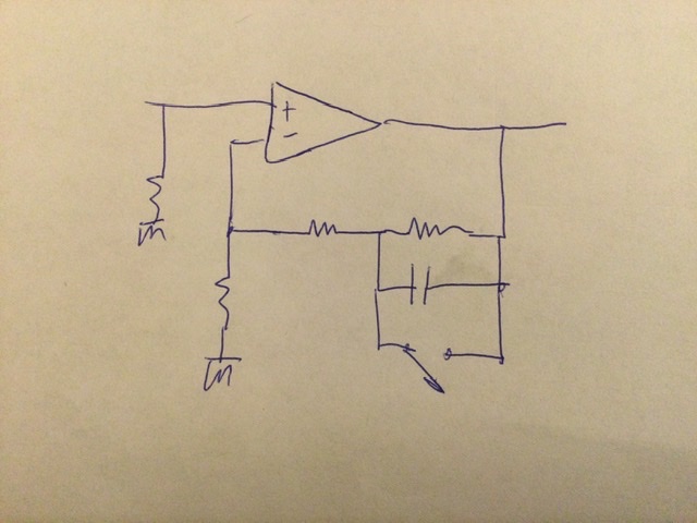

That digital filter looks like about a 4th order slope. Around 50 Hz is probably about right. A single time constant filter would be much shallower.
To remove the “excess” boost, remove the 47 nF that’s in series with the 1k. That by itself may upset the turnover frequencies of the existing tone controls, you’d have to run it through a simulator to be sure. (For linear circuits, a simulator is just a fast way to do 5 pages of algebra, and gives the same result. One can calculate the response by hand.) To sort of meet it half way, split the resistor, putting 2K in series and 2K in parallel with the cap.

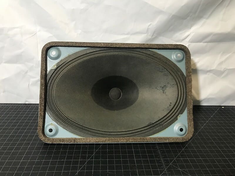

As far as response below 100, hell, even 200 or 300 - that’s what all the excess boost is supposed to fight. As you can see it DOES have its limitations. You want to retain the type of “tone” you are looking for? Find an old light stiff cone 8 or 10” full range (preferably with a whizzer, and a high Qts value), or a similar vintage 6x9. The kind used in vintage consoles and floor standing radios. Then you an get by with a modest 6 dB low end boost and still have it sound “natural”. Modern “full ranges” don’t have the right sound at all.

Your idea seems really good to me, but I can`t get 8 or 10". Internal height dimension in radio is 12.5cm (4.9 inch)... So I would need oval speaker, even 6x9 wont go :/. 5x8 would go with slight modification, but I can only find car speakers.

5x7 car speaker would fit... It is a good thing that it is also designed for use in semi-closed space, but I don`t know what to expect from the sound... It would be more accurate and clear, thats for sure...,

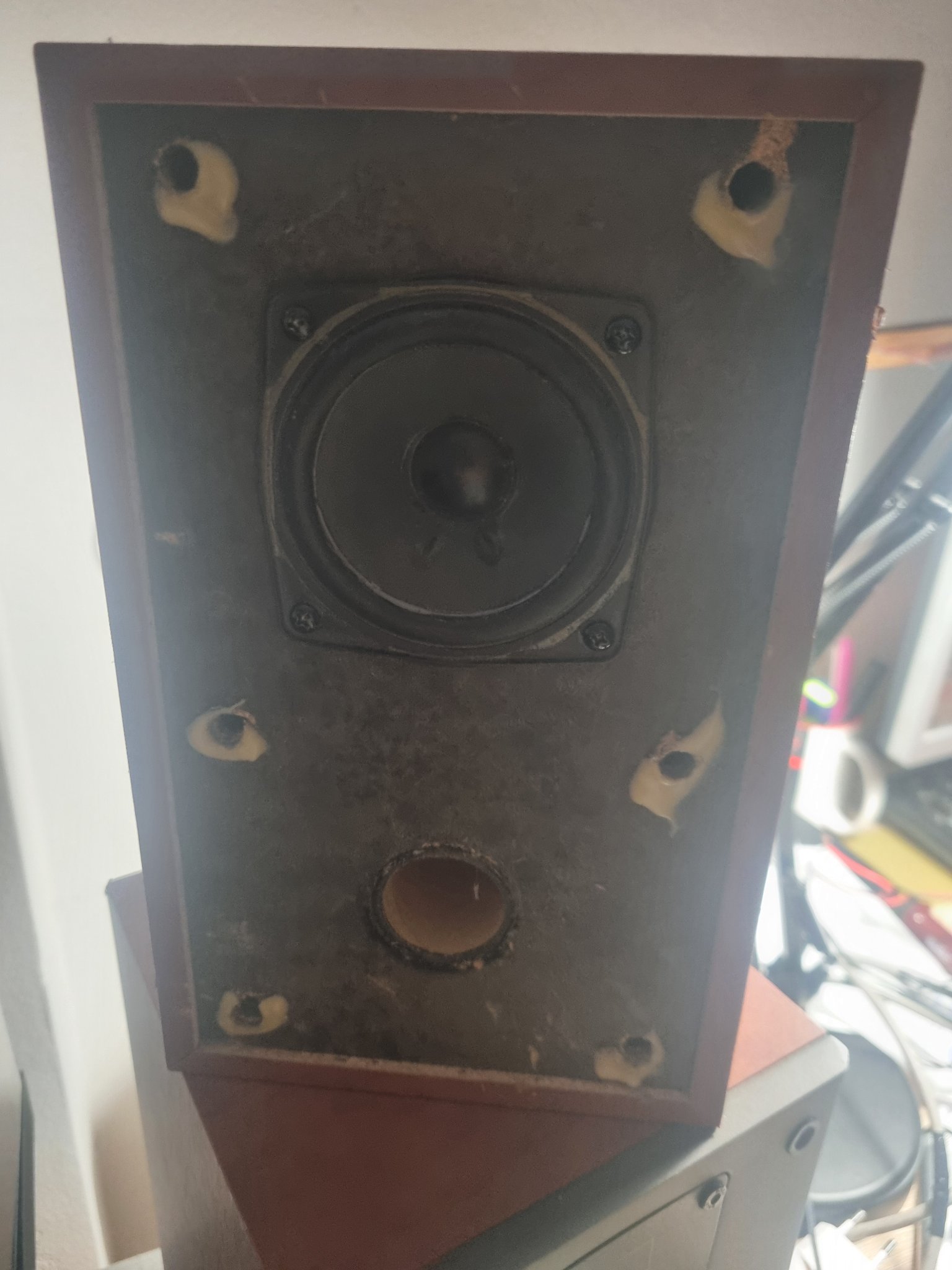

It's a 4ohm rated 30w, 3" full range speaker from Sony, circa 2007.
Ported enclosure takes care of low end lovely.
It will not fit in the radio as is, but it's volume does fit.
So it will be a small woodworking project.
It's not the same sound, but on the other hand it's clear and punchy. Replacements easily avaliable second hand and it will last for a long time.

More gradual tone control would be a standard Baxandall type control. They also use an inverting op amp, but take linear pots. I might also add a switchable shelving boost of 6 dB at about 600 Hz, which compensates half space (at high frequency) vs. free space (low frequency) radiation. Also known as “baffle step compensation”. Another reason small speakers sound small - when this isn’t taken into account.

The top diagram in 292 is a standard Baxandall tone control. To add the shelving boost, the first stage is converted to something like this. The cap value you want depends on the size of the box. You don’t want it to boost only the bass, since the fall off that you fight happens right in the middle of the lower midrange, making vocals and musical fundamentals sound thin. What I do about it is put the crossover frequency between a woofer and midrange right in the middle of the transition, and use a 3 to 6 dB LESS sensitive midrange. The bigger the box, the lower the crossover frequency is used. This does NOT work well with the typical 2 to 4 kHz crossover used in a 2 way since the action needs to happen at a lower frequency. Works perfect on single driver full ranges. It can be done with a parallel RL at speaker level, but it’s really best to do it in the preamp if you have the means, and especially if the system has no pretense of being “hi-fi” and is just being tuned to “sound good”.

I guess porting also should be taken into account with shelving boost?

Baffle step frequency does not really depend on being ported or sealed. But ported can often result in a bass boost that lifts enough of the low midrange to require a little less compensation (ie, not the full 6 dB). When speakers are large enough, you also get a little gain just from the woofer being in proximity to the floor. But this is a little bitty thing that sits on a table somewhere. Even if it’s a little too much I’d put in the 6 dB - one can always back off on the bass control a bit if need be. Hell, most of the time people want a little bass boost when just casually listening.
