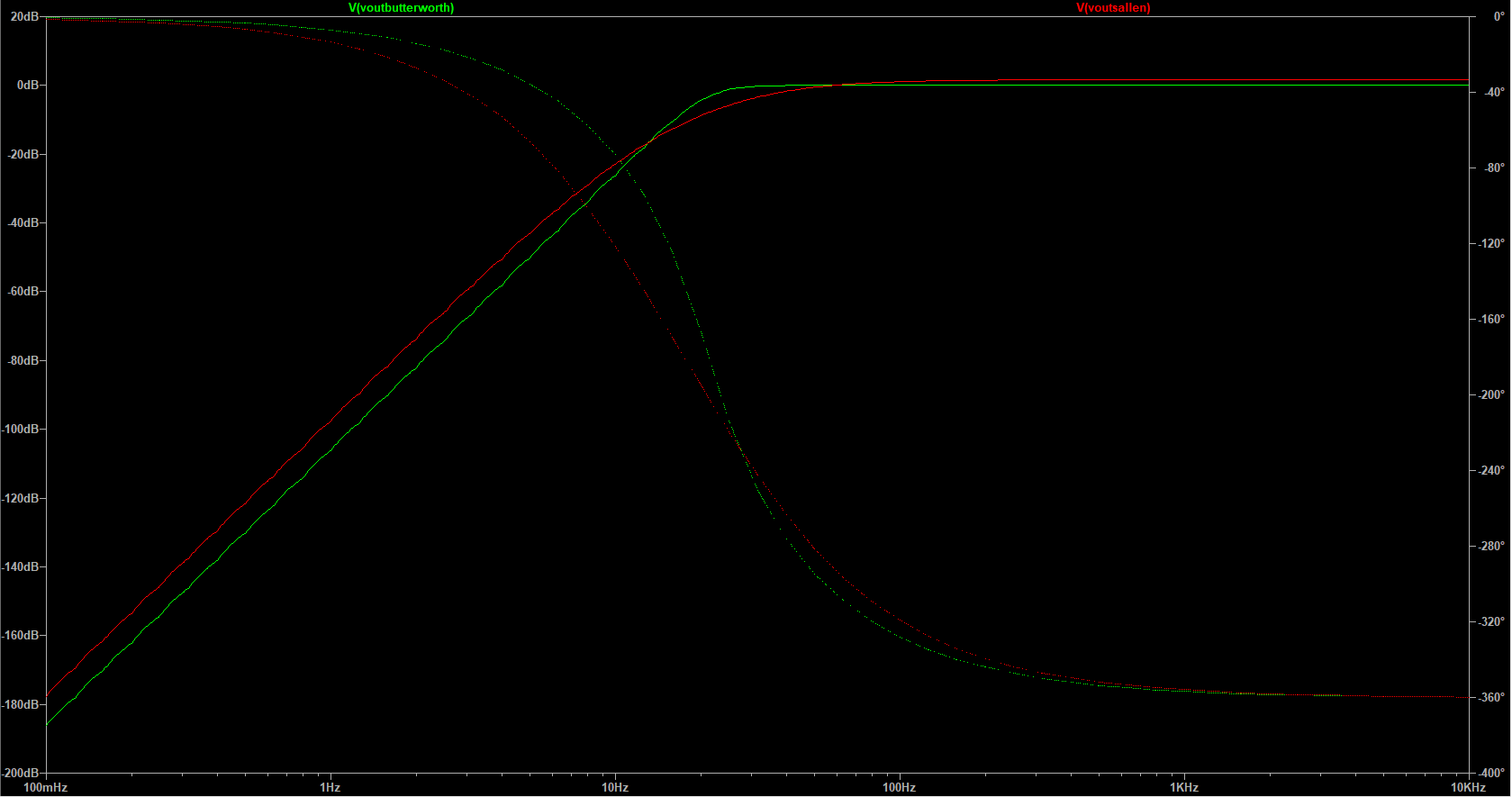

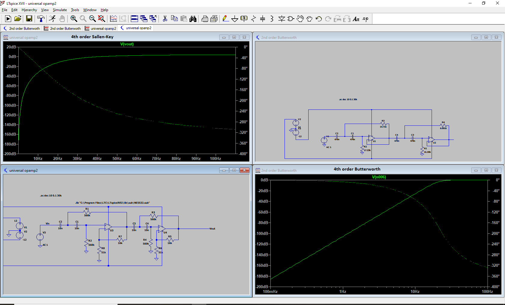

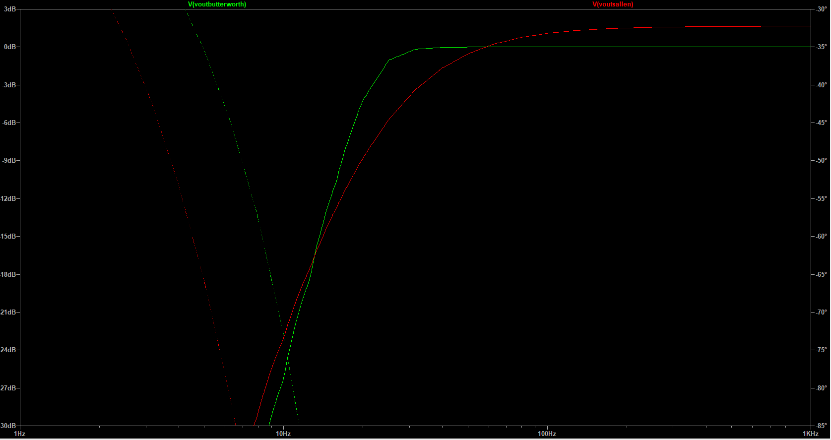

Log = decade. Decades are equally spaced. Then the plots look more familiar and they are easy to really compare.
The initial slope (before final roll off) depends on the Q values chosen for the filter. One was from a non audio application, where shallower may have been preferred. In that one, both Q’s are the same. You may or may not actually want this. One can also design it for peaking before final roll off - some receiver manufacturers did that, having it as an option for the use of small speakers.
Ok, thank you. When I get home, I will dive into theory and formulas and hopefuly I will be able to come up with modifications.
I was playing with different capacitors, but it didn't affect Q too much.
I think that slope of second filter is different, because I left it's output floating -no external impedance...

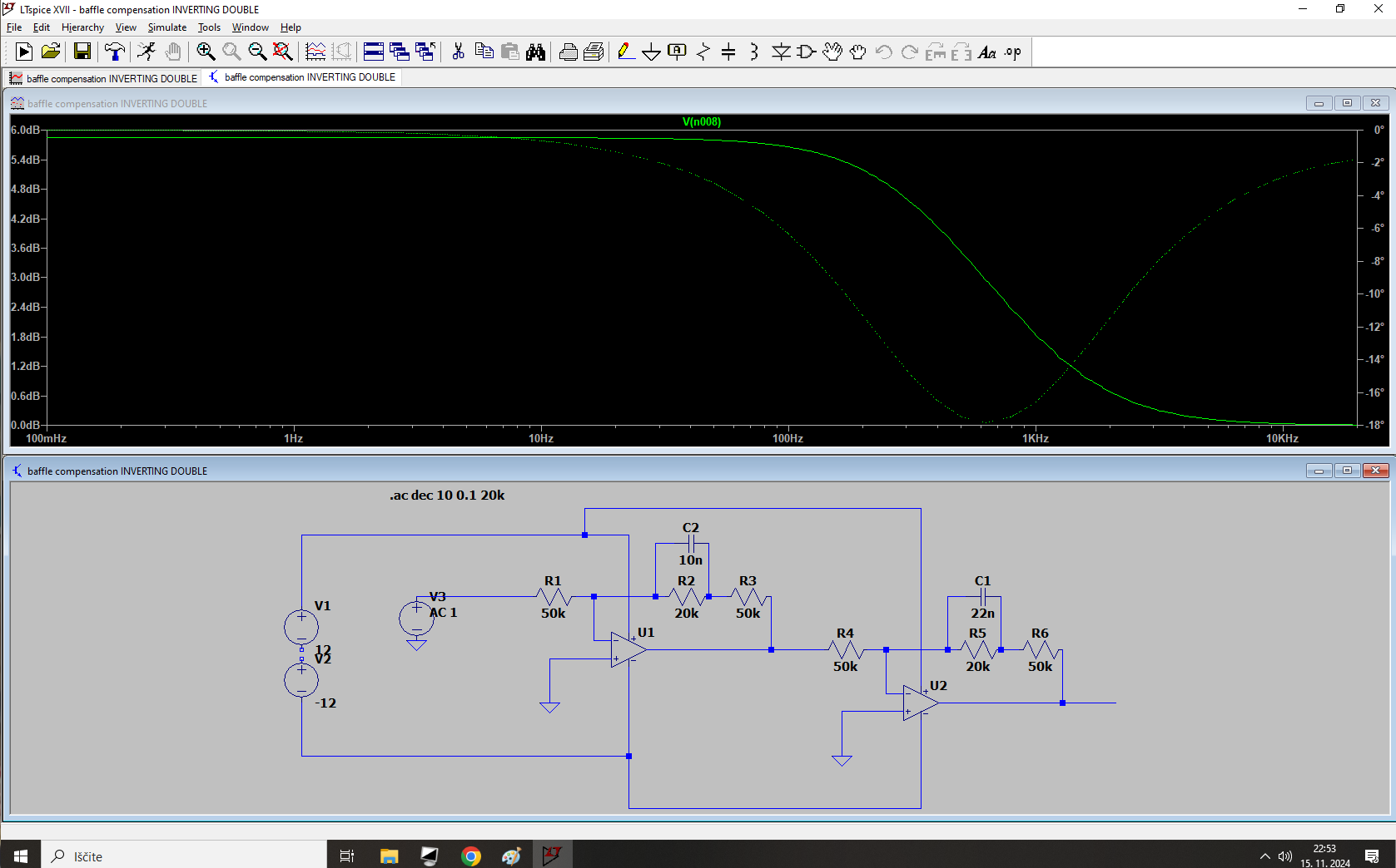

Higher Q’s require higher gain in the op amp. Strapped as a follower, the Q that can be achieved is limited, but the circuit is relatively insensitive. Set for a gain >3, and you sneeze on it and the response changes. When you want Q>2, this is not the circuit you want to use. But it never is in these applications.
Ok. But higher gain, more sensitivity also means more pickup of unwanted noise I suppose?

I`m reading a book... basics and so on and on page 44 here comes the "Differentiator with stop"... It finaly makes sense and I have needed formulas.

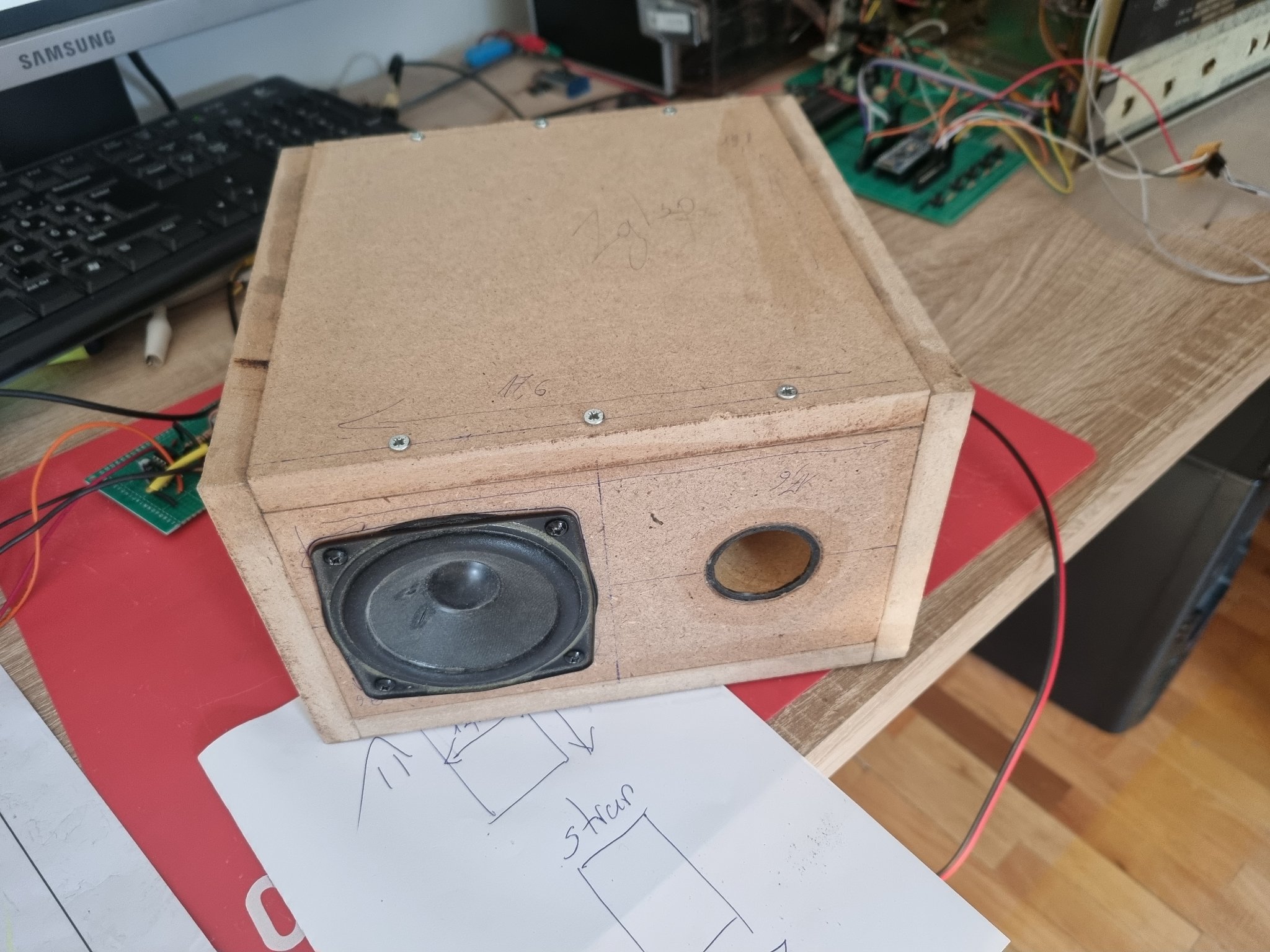

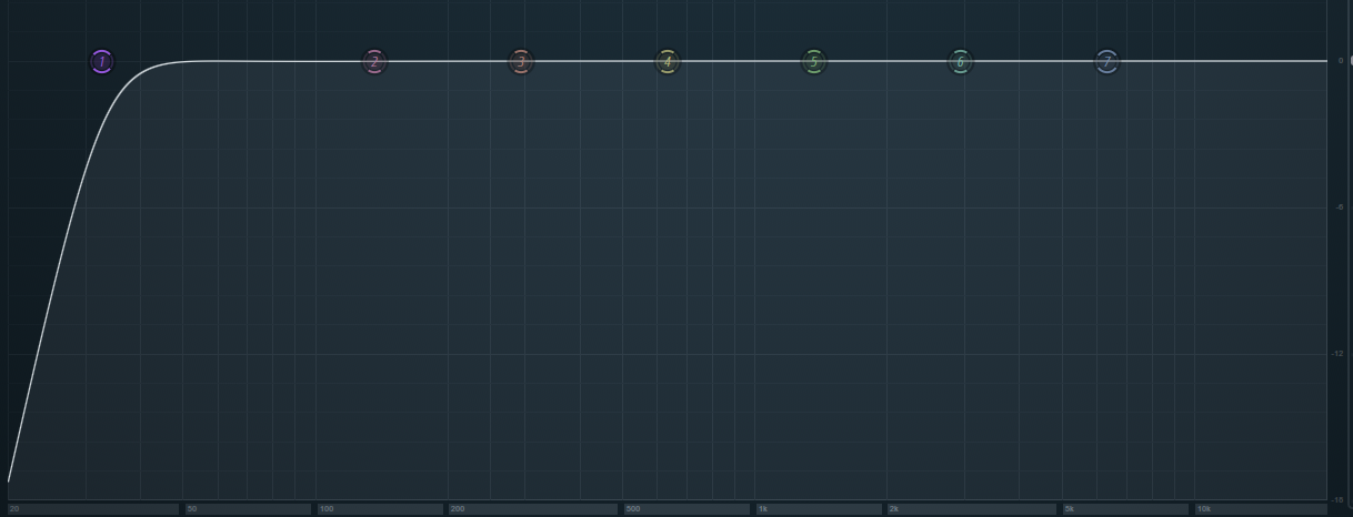

I had built the speaker box, my plan is to simulate various filters with pc EQ, listen & compare to decide what I will make.
But it has realy nice sound as is.
Probably I wont need 6db of baffle compensation, more like 3db... if any.
Once I put wooden mesh infront of it, I will be probably be boosting highs. Or if I'm lucky loss of highs will compensate for the baffle.

I'm doing decade-log on both simulations, but I don't know why it's scalling graph differently. Will sort it out and compare.Sallen-key isn’t a type of alignment, it is a type of active filter. Both are Sallen-key filters. One may be of unknown alignment…. Both need to be on log scales to compare anyway.

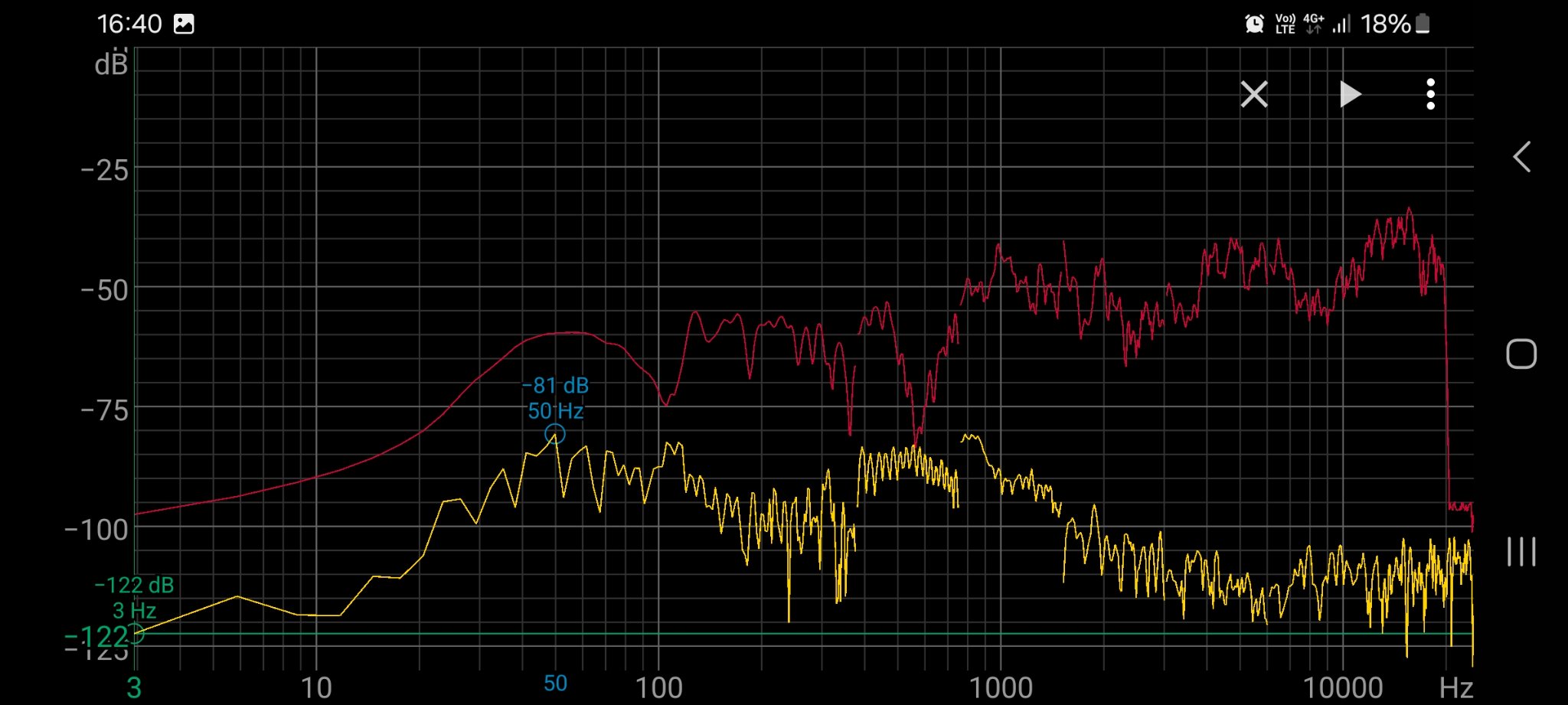

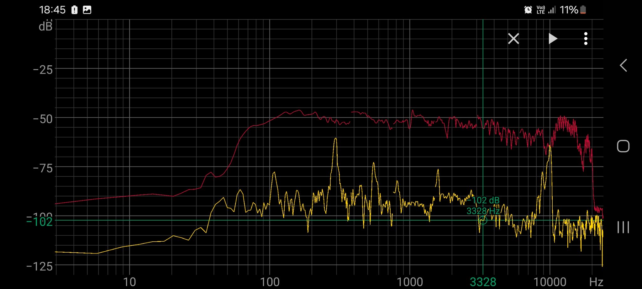

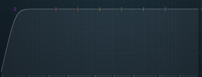

I measured frequency response with android phone (internal mic) for fun, lucky try...
I compared the result with other speakers and results appeared to be in range.

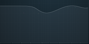

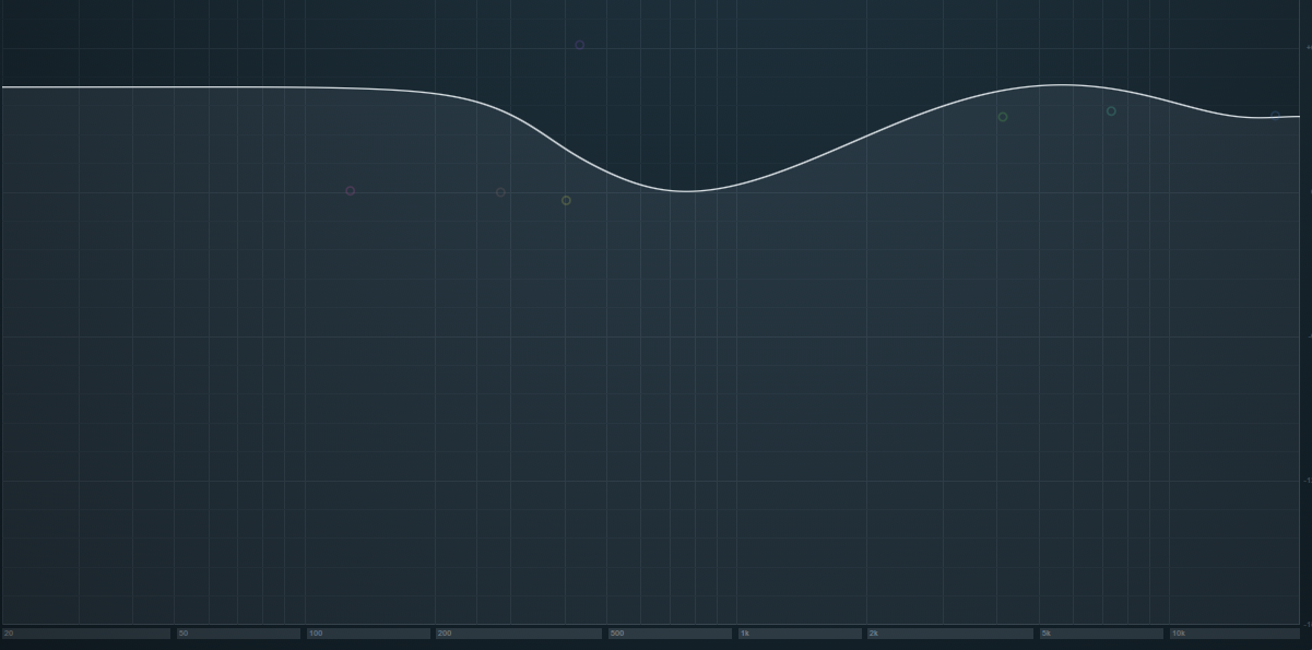

I designed eq curve on pc and did the measurement, second measurement shows improvement,
Also I tweaked everything a bit by ear and make things more subtile as speaker couldn˙t handle lower frequency range on some songs to well.
It sounds nice via pc eq.

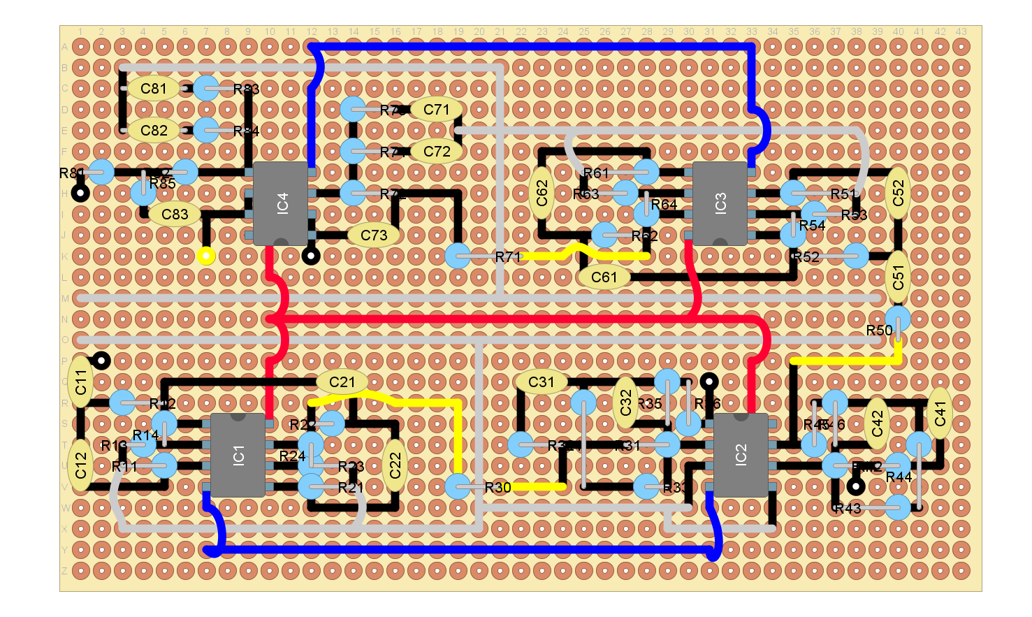

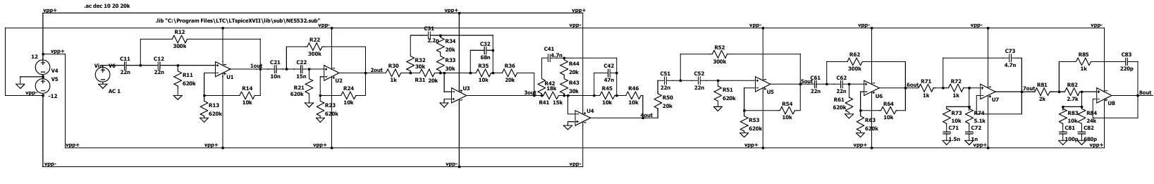

I must still check eveything once again just to be sure, but I`m building this... I hope that it will work.

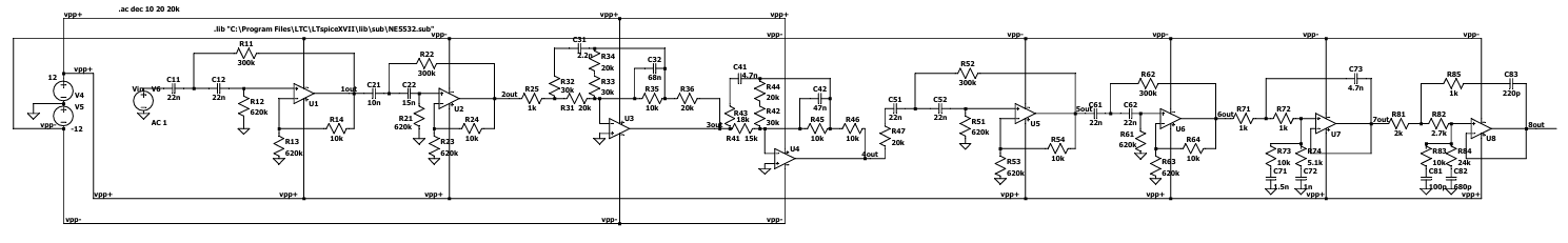

Almost done. Final stage is missing, because seller gave me wrong capacitors.
I had tryed it anyway, the last stage only lowers the highs (+13kHz) for around 1.5dB.
It sounds wonderful, using gradual slope at lows boost was the correct choice. Now it can play loud and still breath.
It sounds like much bigger speaker, even the whole size of the radio leaves you confused, because it still looks way smaller than it sounds.

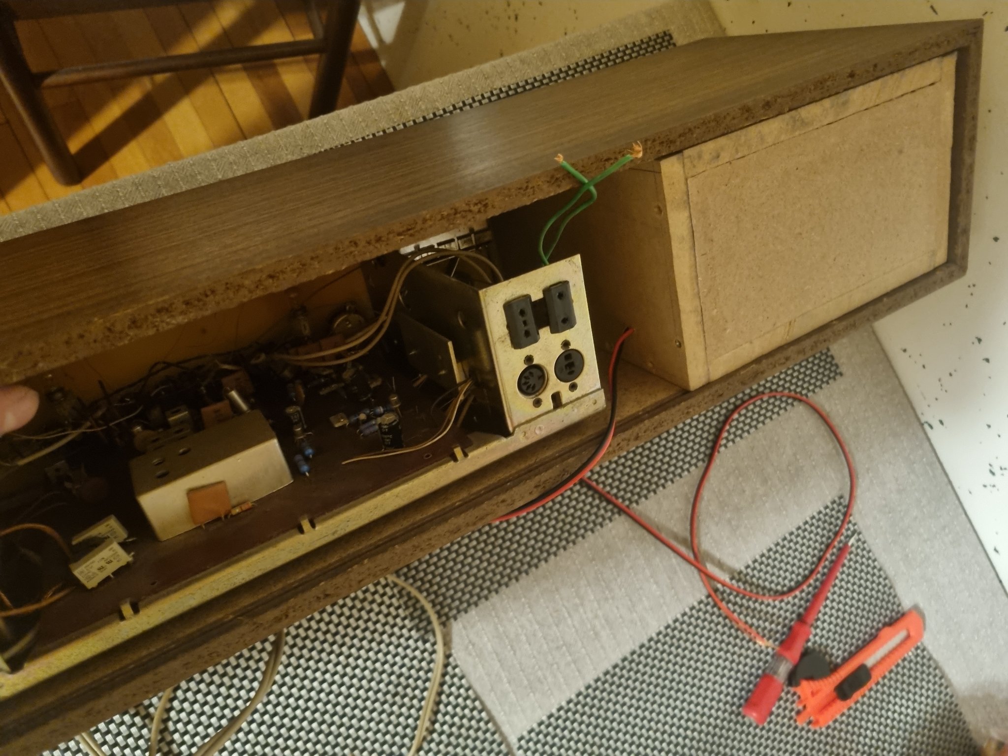

Well, the end result here bears very little resemblance to what you started to modify, but I bet you learned a lot. Now that you learned the basics about filtering and how to dial things in, you are about 110% further ahead of where most people who want to go “build a 3 way speaker, using a pre-built crossover” are. For when you go to build your next bigger, badder project. That red curve looks pretty nice for just a cheap full range speaker - which now does not have that blaring, screechy, “in your face” midrange thats’s pretty typical. Yeah, it would be “nice” to have a bass bump down around 60, but as you’ve seen that comes at the cost of everything else when the wattage is low and the driver can’t move a lot of air. A listenable system is a better compromise.
I had completed last stage.
Yes, project went completely the other way, but I like it. Now it sounds nice on various genres, modern & old.
Some of the sound character stayed, partly due to bass boost. I would have to do some testing & measurements, but I believe that original (found out it`s plastic and not wooden) speaker grill shapes the sound in some weird way.
Tuner has some bass boost -that typical late 90s sound... probably in the range bellow 100hz.
I had connected amplifier to the tuner for the first time earlier today and it matches nicely, it extends that low end a bit.

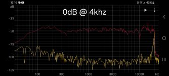

I had also tried to play with pc eq on top of preamp and it shows that this is the optimum eq curve -it needs no further corrections.

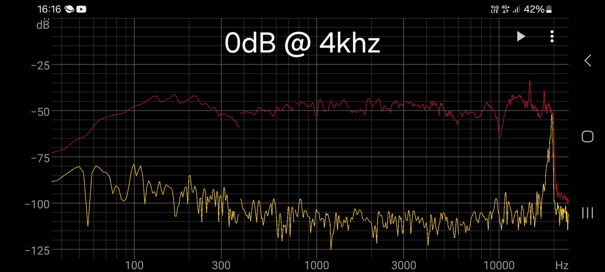

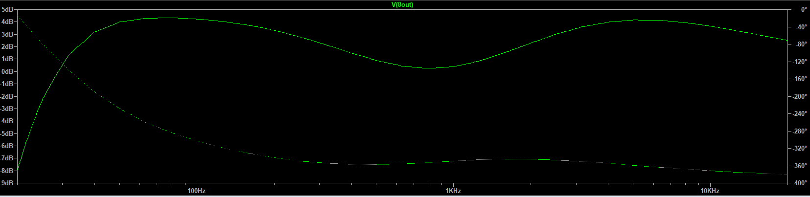

This is the response with the actual preamp:
I must do some simulations to see the outcome, but I will probably use stereo volume pot and tie ends of second half together -that way it will get low toward both ends and I will use that to lower the lows when playing at low volume for clarity and when playing at high volumes to avoid distortion.
I will either enable 16khz filter on tuner or drop highs a bit with a preamp, because radio static is realy audible.
