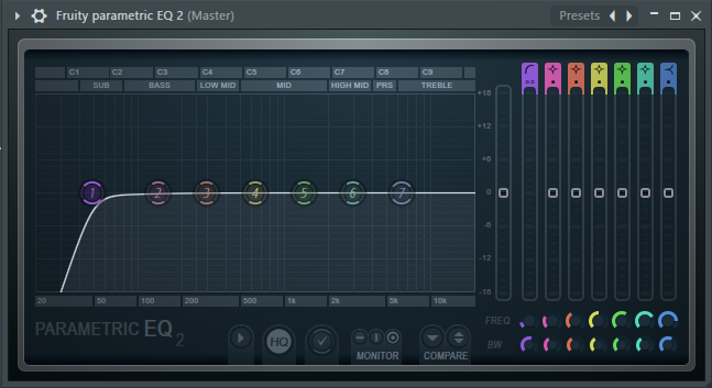

If you are up to the challenge, the high pass could be made far more effective by using a steeper filter at a strategically placed frequency. It’s the way they do things in pro audio to get the most out of a speaker possible. It’s relatively easy using technology you are already using. Look up “4th order Sallen-Key filter” to get an idea what I’m referring to. A steeper filter will take out more of the very low frequency the speaker can’t respond to, leaving even more power for those it can. It’s especially useful if you are boosting the entire bottom end, which normally adds more 30,40, 50 Hz content than a little 3x5 speaker is really happy with. And the amount of air moved by it is entirely inaudible anyway. You DO want the large boost centered between 80 and 150 just to make male vocals and musical fundamentals sound right on a little speaker. The little one cap one resistor passive filter does the same thing, just not to the same degree of effectiveness.
Yes, I would like that. I`m listening to it and I feel it could loose some low boost above 250hz. But I think that steep hp filter would help with that, as it would add more lower frequencies.
I`m also learning music production in DAW, so I have a bit of feel for EQ and know what to expect. (And a big difference with using steep slope)

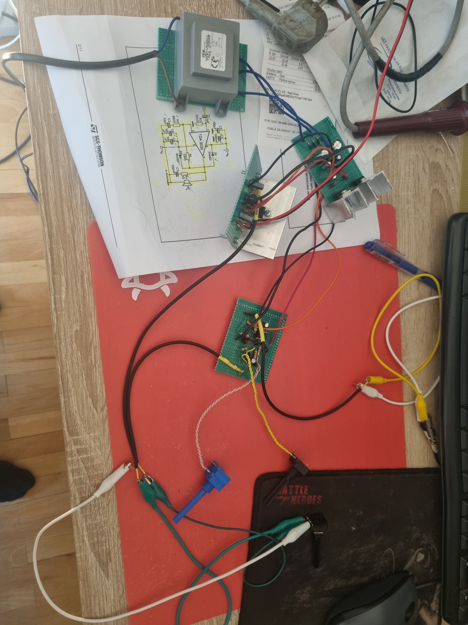

I changed gain resistor on preamp to 4.7k and it is alot better. I think that I will go even higher, because it is clipping at 50hz sine with low boost all the way up.
But will see later, also I will probably lower the gain on the amp itself.
10k volume pot is quite sensitive right now, so I will see how it will be once I set the gains and replace with higher resistance pot if needed.
PS: Grounds are now seperated, and I added that 10k sesistor to 1k -to get 900ohm to restore the band parametres.
Do you see any problem with mounting 1 preamp board above another, about 5cm apart? I will propably start to run short on space.

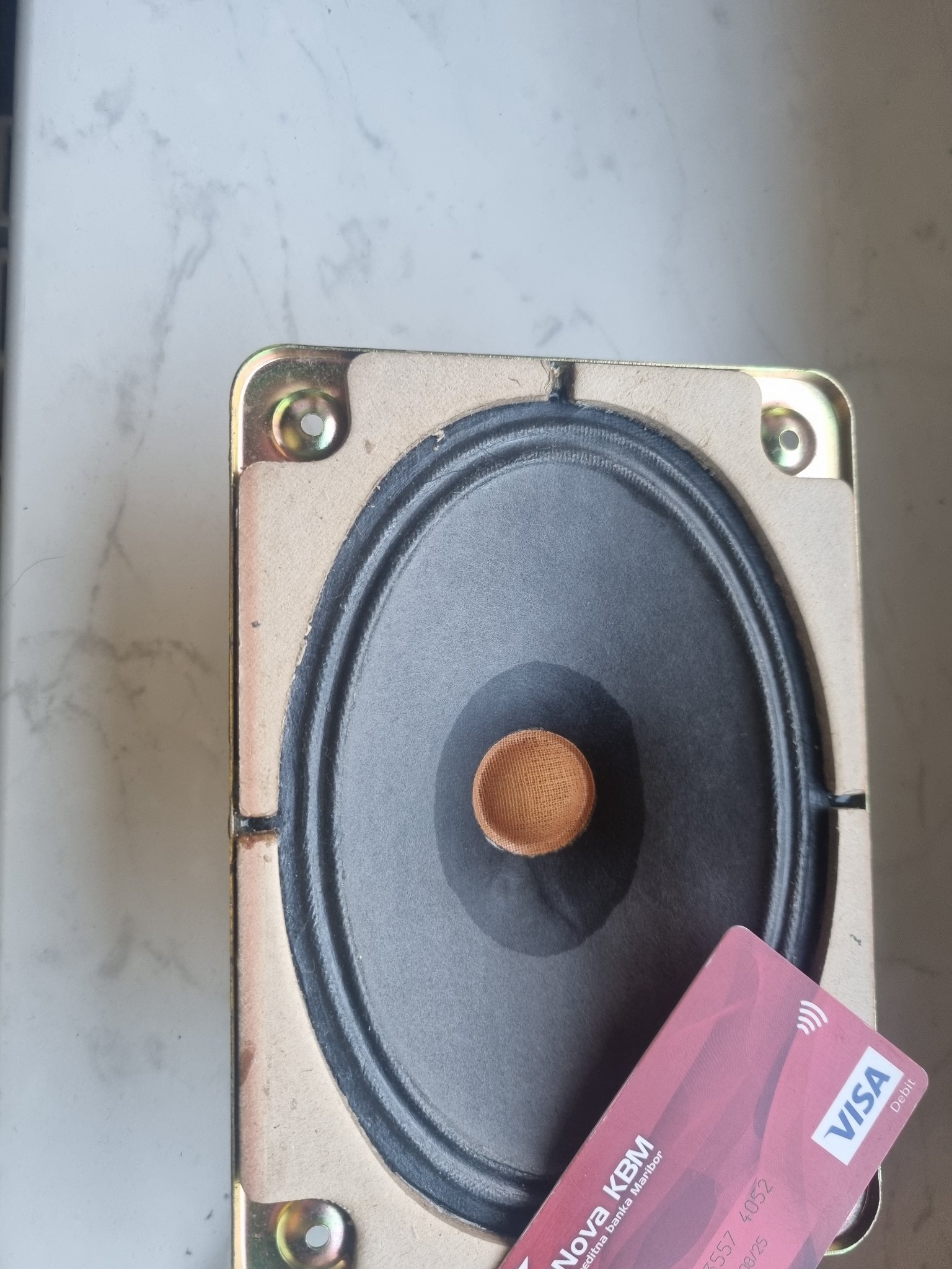

ANOTHER EDIT:
Wait a bit. Distortion is happening most at around 60hz and up to 200hz.
This speaker can actualy play 30hz.
Let me play a bit in my DAW, it has realy powerfull eq.
I will see that the speaker likes and what not, will figure how low speaker can go and where is too much boost.

It can probably move at30 Hz, but I’ll bet you $100 the amount of 30 Hz coming out is totally inaudible (ie, below about 40 dB). You will hear the 60, 90, 120, and 150 Hz distortion that is produced by the speaker itself because the threshold of audibility is much lower at these frequencies. And chances are you’ve got 30% distortion at 30 Hz.
You probably do have a lot (5 or 10%) distortion between 60 and 200 out of the speaker. Even with 3 watts it may very well be moving all the way to the limits of the motor. But the original radio would have had all this too, so the sound character isn’t really changed. The deeper into this you dig, the more of the limits of the original design you will find.

Music till late 80s is playing good, newer music ...the bass is just too much.
I think that reason could be the open box. Speaker not being baffled and reaching xmax to soon.

I will play with EQ in DAW to find what could be done, as I first intended, now at least I know that soundcard has flat response.

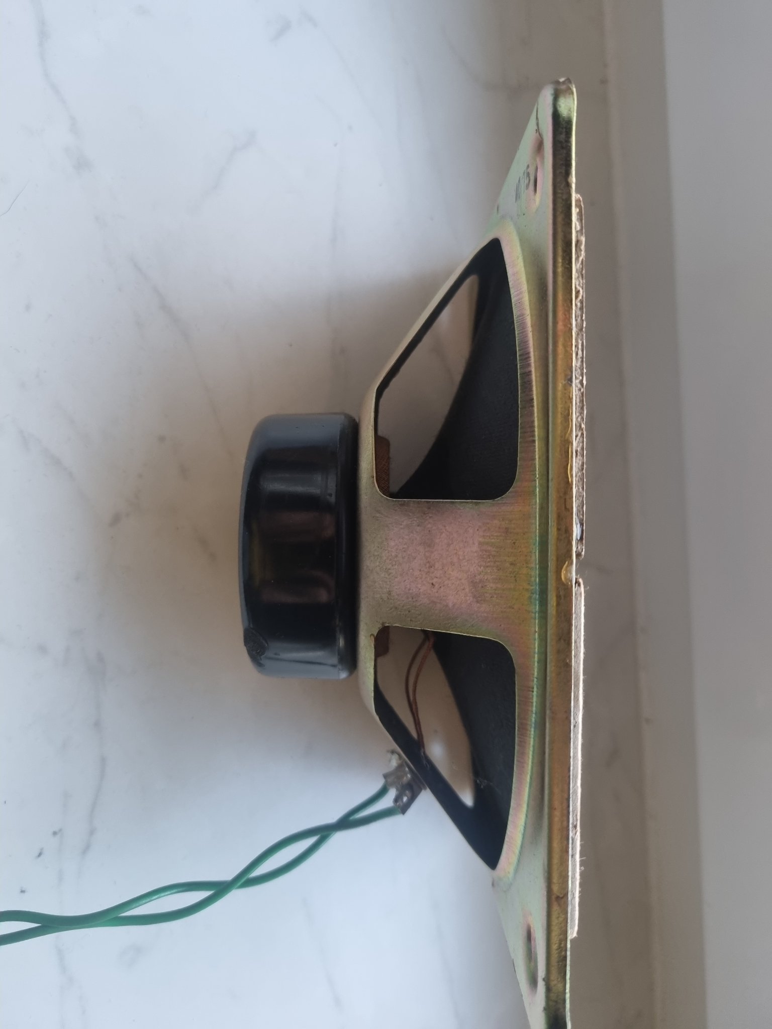

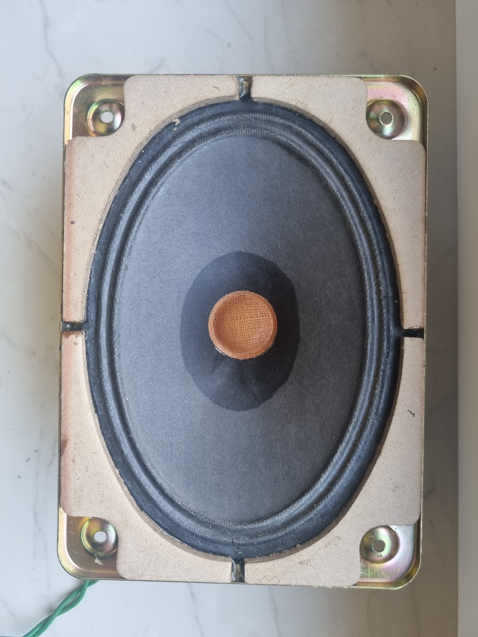

Now laugh all you want... It was the specific youtube megamix, that was boosted, so bass sounded really bad. I hate when people do this -if you want more bass, just get bigger / better system.
It is 80% better, than what I tought.
I had found out that the coil actualy starts to rub on the magnet, thats the reason for distortion.
Either it is reaching xmax, or cone is just old and soft.
I will experiment a bit, still with eq, probably this alone wont do. maybee I will build an enclosure inside the radio, maybee ported or passive radiator (probably not).
Will also try limiter.
Is there any way to "hold a cone a bit" without a box, maybee, like putting a foam behind the speaker or something like that?
@wg_ski : Can preamp with tone controls be modified, so it doesn`t boost as much if low frequencies on the input are strong already?
At this stage I would just like to know if it can be done and if it makes sense to do it?
@wg_ski
This would help alot. Like you suggested:
But it has to be that high. around 50hz.
Lower frequencies just make popping sounds, canceling higher lows... like cone would "loose itself", resonate.
I had tryed this with "Ice Mc- Think about the way"... because it has very specific bass, that I know sounds rather dirty on alot of systems.
Another thing I will try is moving HPF back to 30hz and just lower 30hz- 50hz a bit. This would require another stage in preamp I believe?
Also is this a slope I could expect with 4th order Sallen-Key filter, or would the slope be more gradual?

I took the speaker out to have a better look of what it is doing...
It`s mint, based on the size, this should give some bass... in enclosed cabinet...
Cone is not soft.
EDIT: Yeah, it`s the speaker, I can hear rattling coming out of it when bass boosted. Nothing seems loose, but will triple check carefuly.
Cone is not soft.
