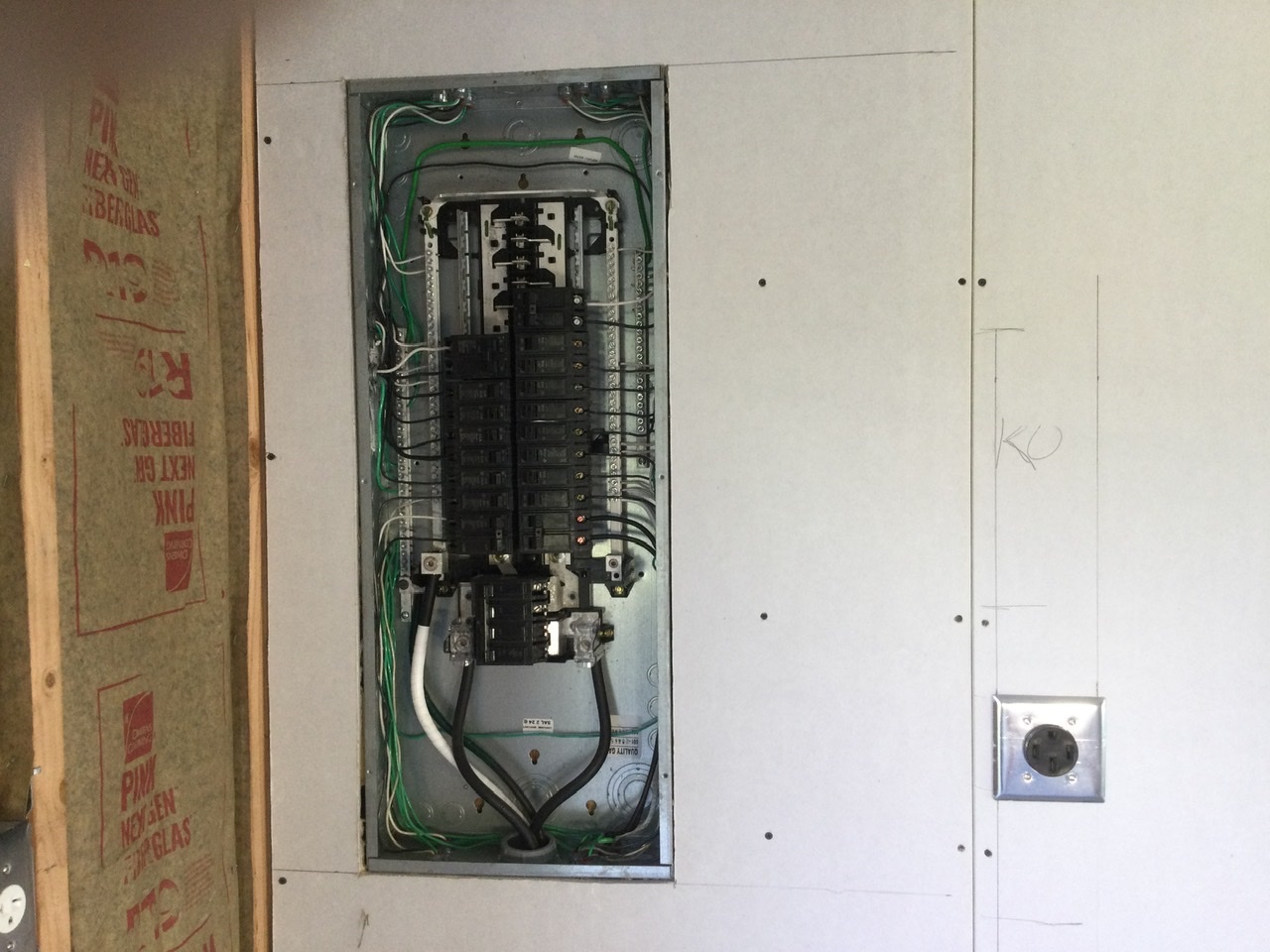

Nicely made fuse box. The secret to doing it is to spend the $25 to put in two separate ground bars, one for each side, as strap them together with a piece of #4 Cu (the big fat green wire running across the top.

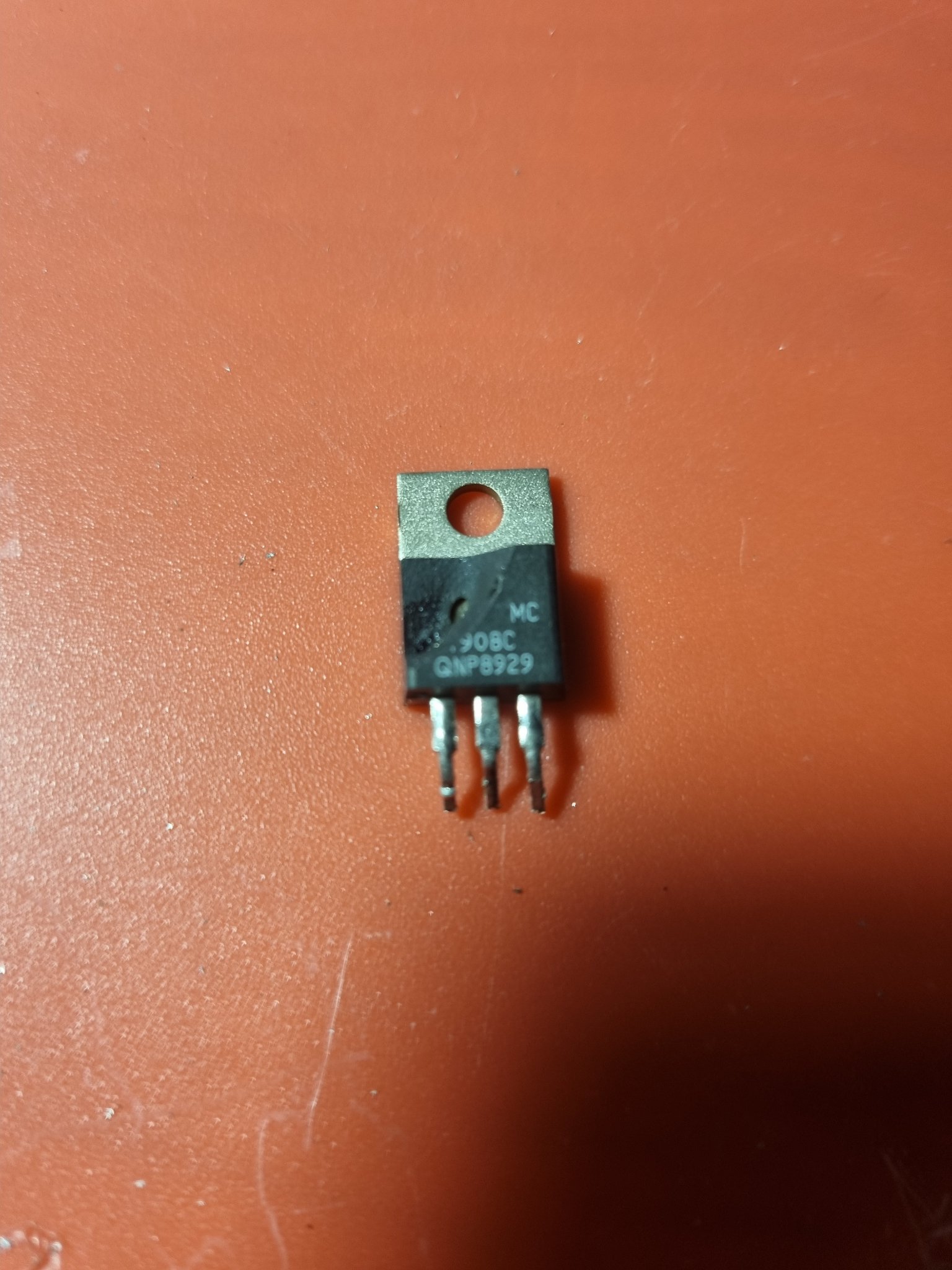

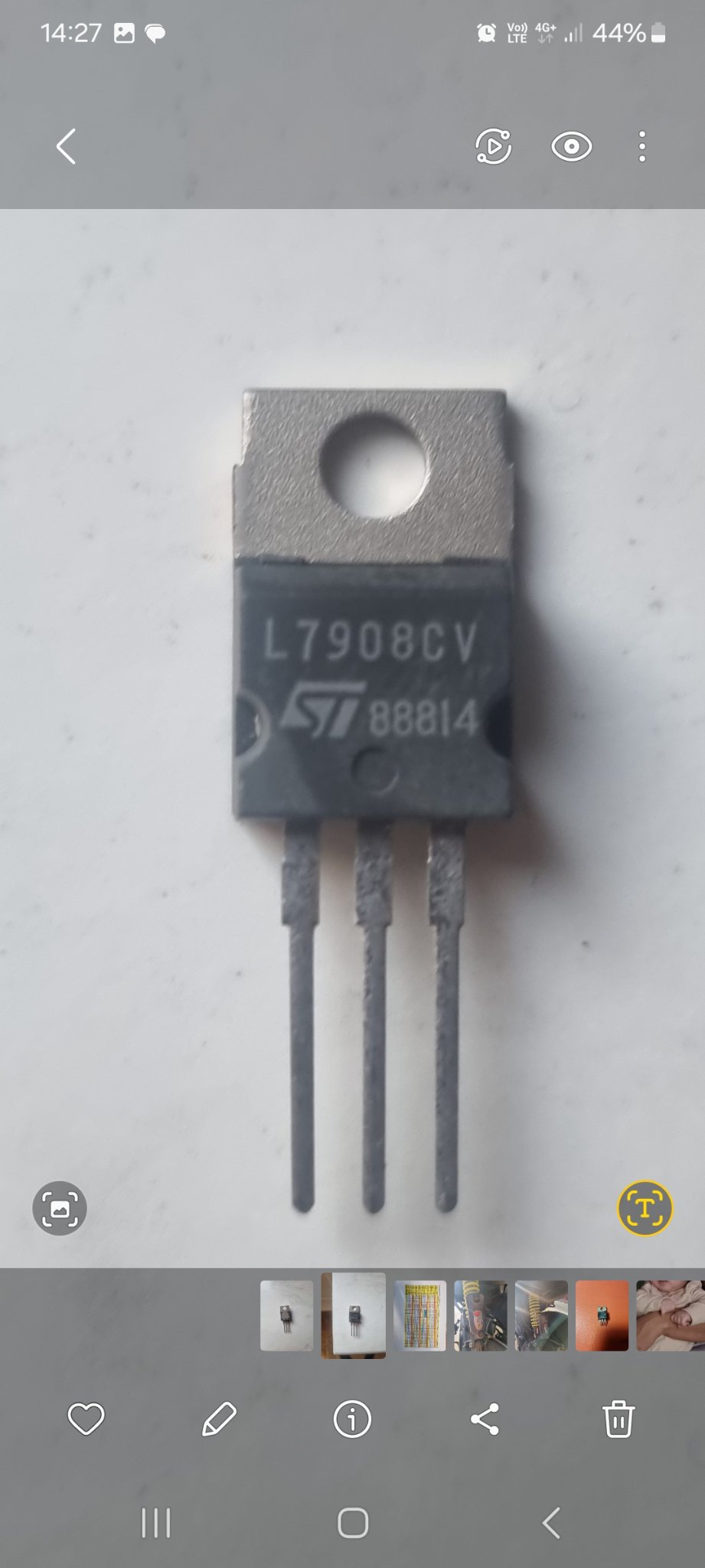

What’s hilarious about this, is that the polarity is the same. From left to right, highest potential, lowest potential, finally the one in between.
ICs are designed with the lowest potential (most negative) in the circuit connected to substrate, which soldered to the center pin of a TO-220 lead frame. Can’t really blame the designers…..
True true, thats what I missed.
