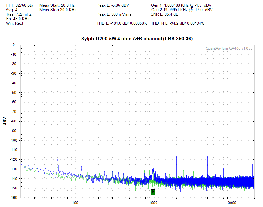

Sylph-D200 is more tolerant on power supply quality differences, it can get good THD+N just by using a genuine meanwell supply.

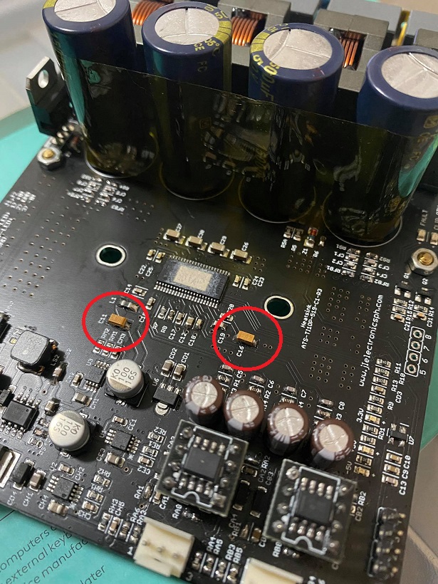

Sylph-D200 V1 TPA3255 Final Mods (This is my personal amp config and I like it better than TPA3251)
Change C11, C16 with 1uF 35V tantalum capacitors (beware of the polarity)
Change AVDD cap to 100uF 16V to 25V
Change o/p filter to VER2923-682KL and 680nF (requires disabling PFFB)
OPA1656 buffer opamps

Nice, you can also try replacing the AVDD cap under the PCB to 100uF.
(Latest Sylph-D200 has 100uF 25V as shipped)
