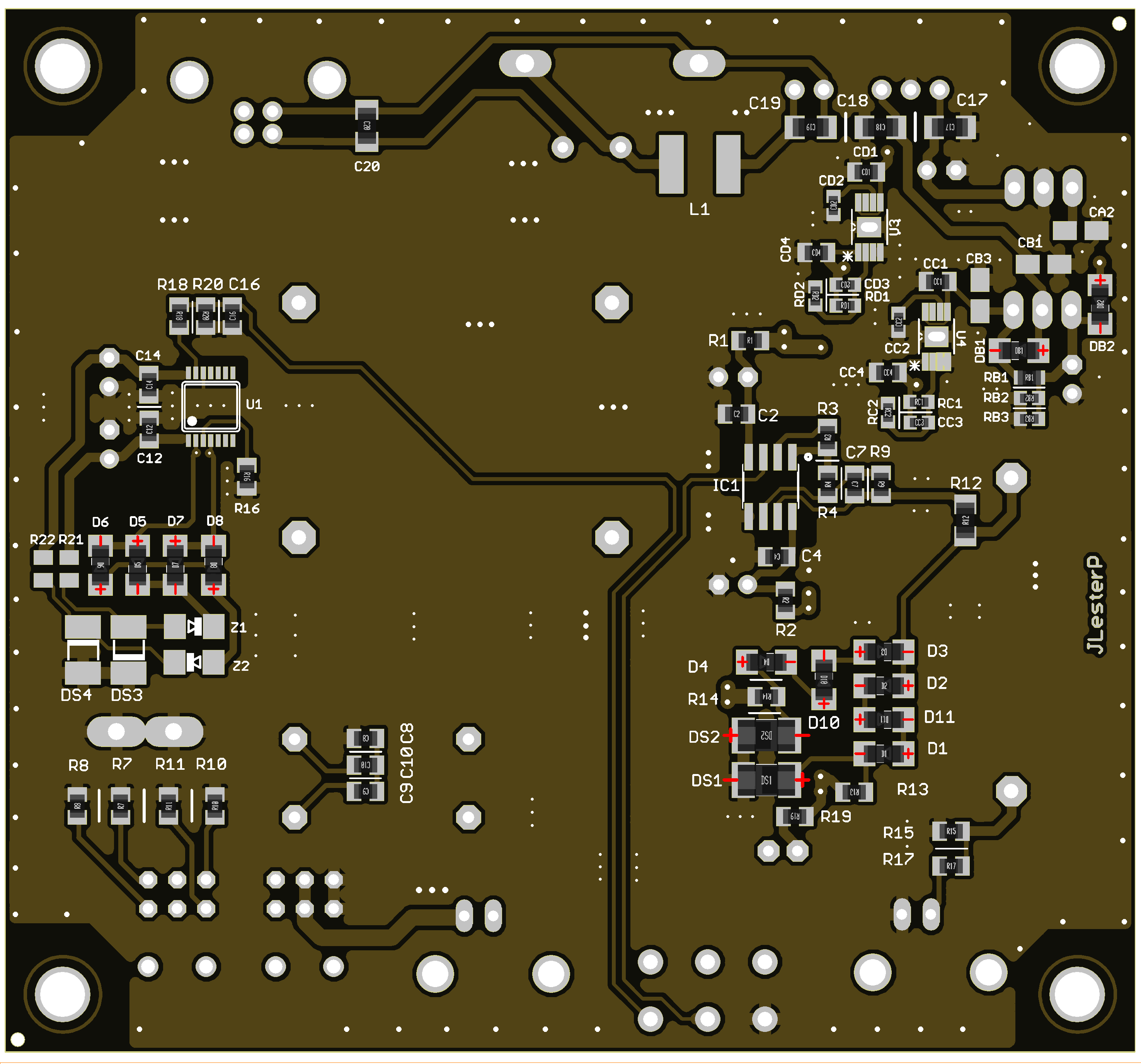

no PFFB on TPA3251 because there is no significant improvement on output?
We can't remove the pop/tick on TPA3251 modules. It is even present on voltage supervisor enable/disable event.
For your module, we will check if a 3.3uF input coupling cap will solve the issue.
If it solves the issue, then we will provide PFFB for Sylph-D200.
Dang it. Hopefully the measurements of the TPA3255 @ 48 V are good enough because I definitely do not want to get another power supply.
It is only for March 5 release. If we streamline the manufacturing of different configurations, we will offer PFFB @48V. (using different PFFB values require more setup for manufacturing which increases cost)

We can't remove the pop/tick on TPA3251 modules. It is even present on voltage supervisor enable/disable event.....
My Aiyima 04 with TPA3251 has NO pop during start up or turn shutdown. Normally a pop is due to DC offset voltage charging or discharging a capacitor in the signal chain.
It takes about 7 seconds before I hear sound, after I turn on the power to the amp (using always on wall wort brick). Maybe on the Aiyima 04 TPA3251 design they are delaying one of the power Vdd lines?
On the TPA3251EVM board there is a TPS3802 time delay reset IC with a 400mS delay tied to the reset pin.
D
Deleted member 148505
Yes we are also using supervisor IC 1100mS delay, the tick is present at the mute-unmute of the TPA3251 and we can replicate it by shorting out the mute pin when the amp is running normally (out of startup/shutdown sequence).
Using smaller value coupling capacitor or disabling PFFB fixes the problem. PFFB contributes to the pop/tick since 1/2 PVDD is being fed back to the summing junction.
