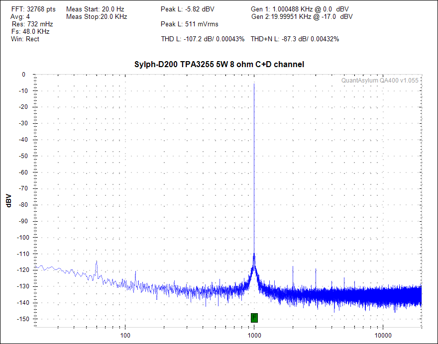

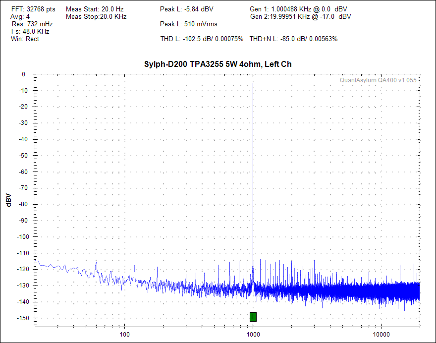

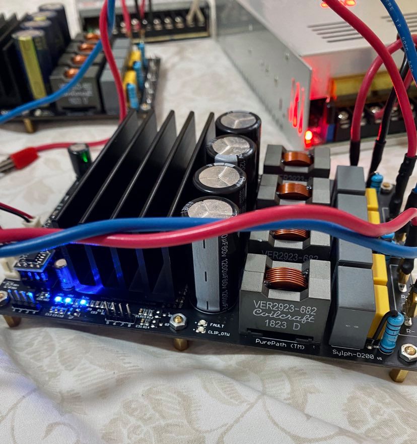

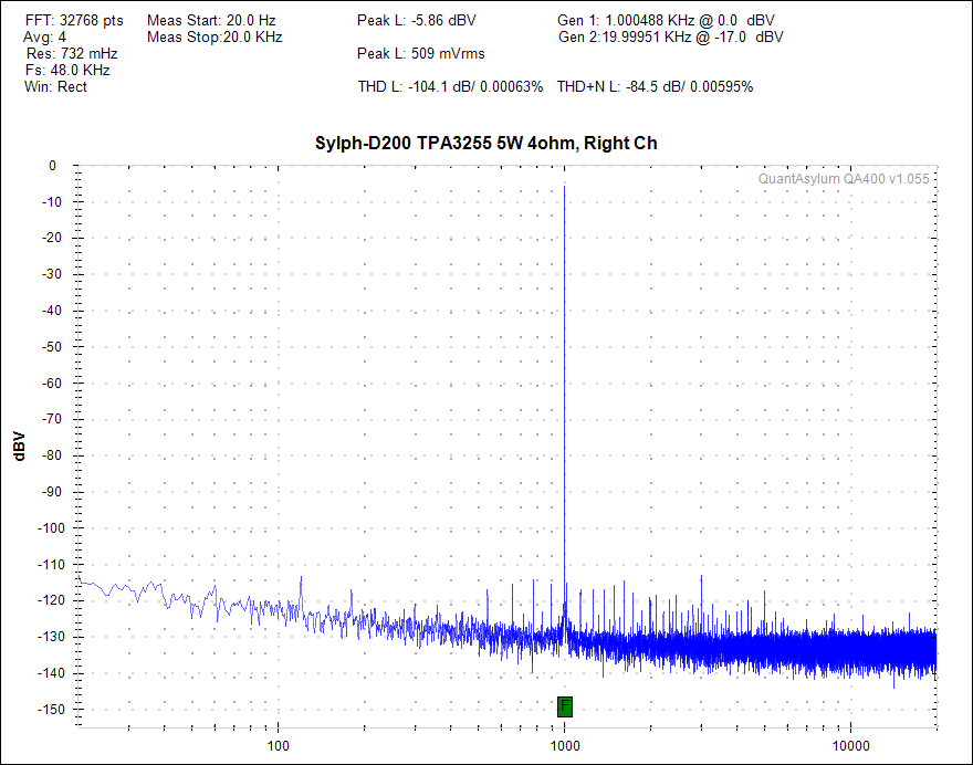

Here's Sylph-D200 with TPA3255 chip, PFFB (power supply is 38VDC)
Right channel is A+B, Left Channel is C+D
I need to upgrade my soundcard interface's power supply since the noise floor is high. After I upgrade it, then I will be confident to publish the result.
Early publishing of full measurements might contain inaccurate data.

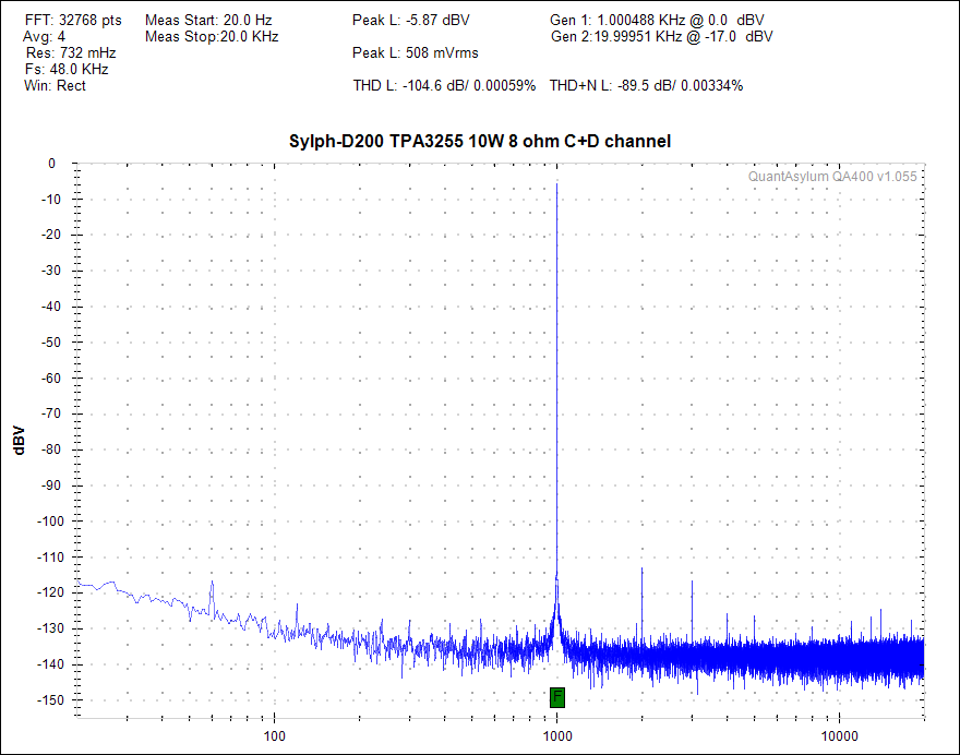

10W 8 ohm left and right channels
Notice that A+B channel has lower THD on higher current output.
Although it's also possible that the wiring/connections are the culprit.
It's SMPS. Using smps300rs and lrs-350-36 get the same thd result.
The sensitive part now is the wiring. Alligator clips to faston terminal produces worse result than using female faston tabs. That's why I also check the output current via clamp meter to verify if I'm getting solid connections to the dummy load.
TPA3255 8.9Vrms/1.1Amp output has lower THD than most cheap soundcards lol
If we measure it at 8 ohm 1W, or lower output current, the measured THD will get into 0.0003% territory.

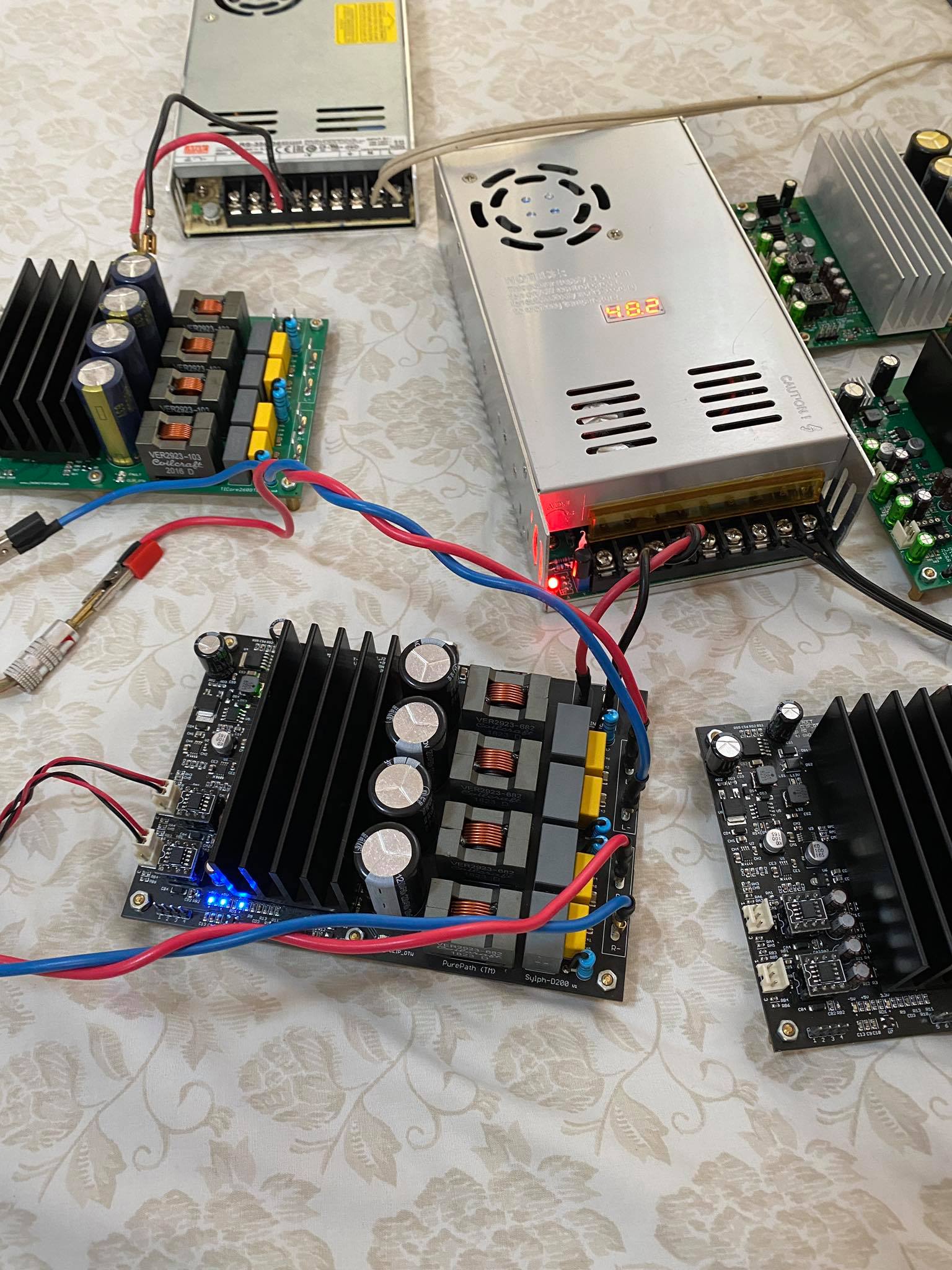

Still tuning and configuring the sound so I'm not asking her for review yet.
I'm rotating the modules so that I can compare their differences.
As expected, the removal of front caps made the Sylph-D200 sound more transparent, so the source player / DAC and song material should be of higher quality as it exposes minor details in sound.
TICore260BTL with single supply opamps is 'thicker' sounding, it adds some bloom and slight haze to the sound. Sylph-D200 is clearer and more hifi.
TPA3251 sounds more organic, but it might be just my bias lol.
Difference is not drastic, you will just notice it by A/B testing the two.
