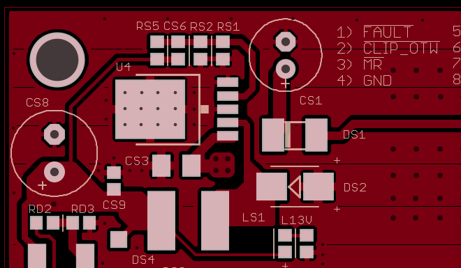

Power supplies with ramp up voltage of 0V to 16V in 200ms should work fine with Sylph-D200. If your linear power supply has a slow ramp up speed, you can provide a separate power supply for the housekeeping regulator (24V 1A is fine). Just remove DS1, then under CS1 you can place an external 24V DC supply.
Though you need to test it with your 36V smps first to verify if the ramp up voltage is really the culprit.

There's an SMT cap under the board, try to replace it with 1uF, 0805. It will delay the startup of inverting buck boost regulator further and might fix your problem. Don't put too much capacitance because it is for the turn-on delay of negative supply of the opamps. If the negative supply of the opamps turns on much later than the voltage supervisor (1100ms), there will be a huge turn-on plop. Limit the delay to 900ms or lower.
I see, just do it next time since we don't know the ramp up speed of your linear supply. Only one SMT is there for V1.
Also for V1, replacing C11 and C16 with 1uF 35V tantalum, amd 100uF 25V electro for AVDD will be a worthy mod.
Lester
Your board is Sylph-d200 V1, latest shipment version is V1P, it is the same except that the caps C11, and C16 are now electro caps and moved under the PCB. (so no modifications are needed for the latest shipments)

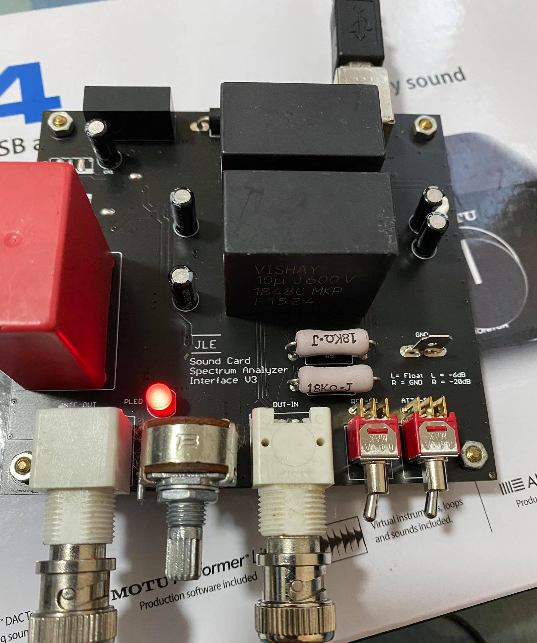

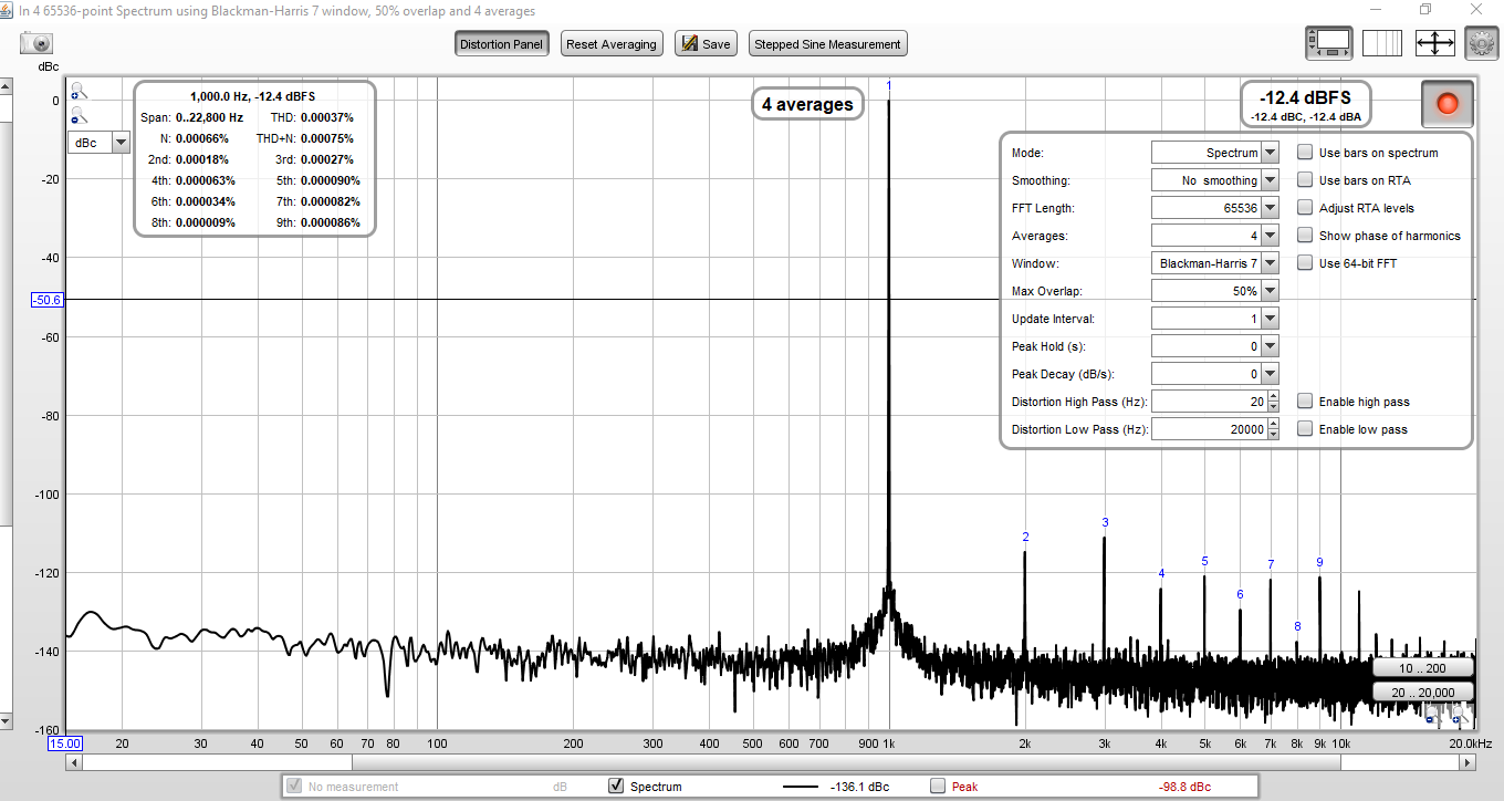

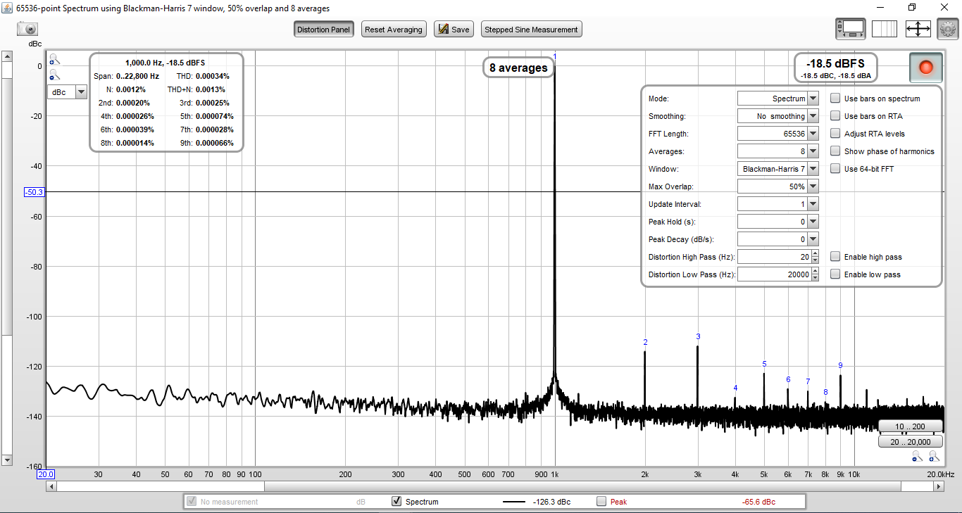

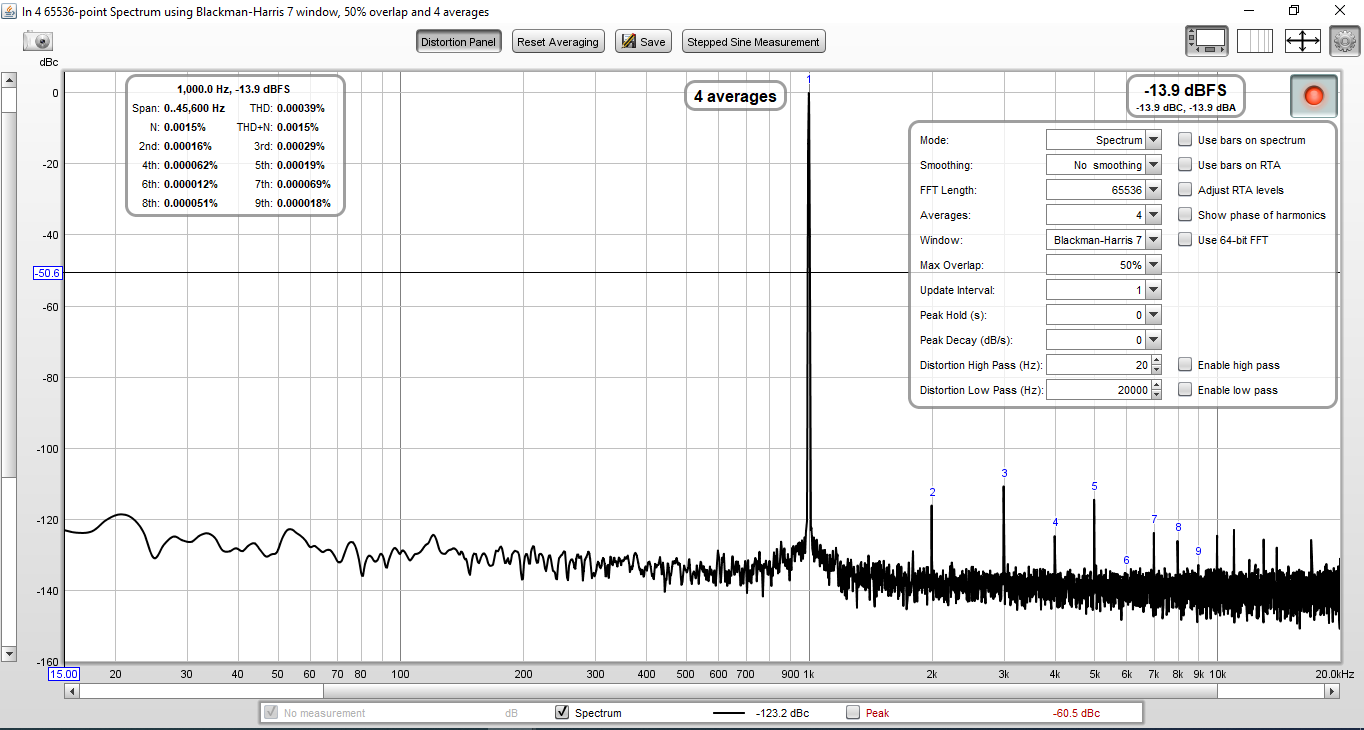

JLE Interface V3 Performance (OPA1656 + INA1651)
1st attachment = Motu M4 single ended loopback
2nd attachment = Motu M4 SE + JLE Interface
3rd attachment = Motu M4 + JLE Interface + Sylph-D200 (4.5Vrms at 4 ohms)

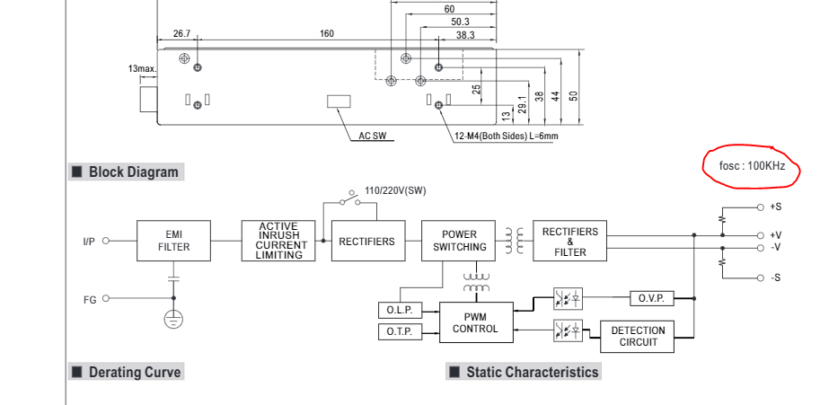

Can anyone recommend a suitable fanless power supply for it. A reputable brand, like Meanwell. I don't mind Open-frame.
If you have a suitable amplifier chassis, you can opt for SE-450-48. Just remove the fan and top casing cover.
https://www.mouser.ph/ProductDetail/MEAN-WELL/SE-450-48
Newer meanwell supplies (like RPS-500-48) with extremely low no load power consumption have a "burst mode operation" which sometimes become audible, so they are not suitable with audio applications. (It can be disabled but it requires disassembly / IC circuit tracing / modifications of the SMPS)
Also look for SMPS with fosc of 100kHz or higher.
