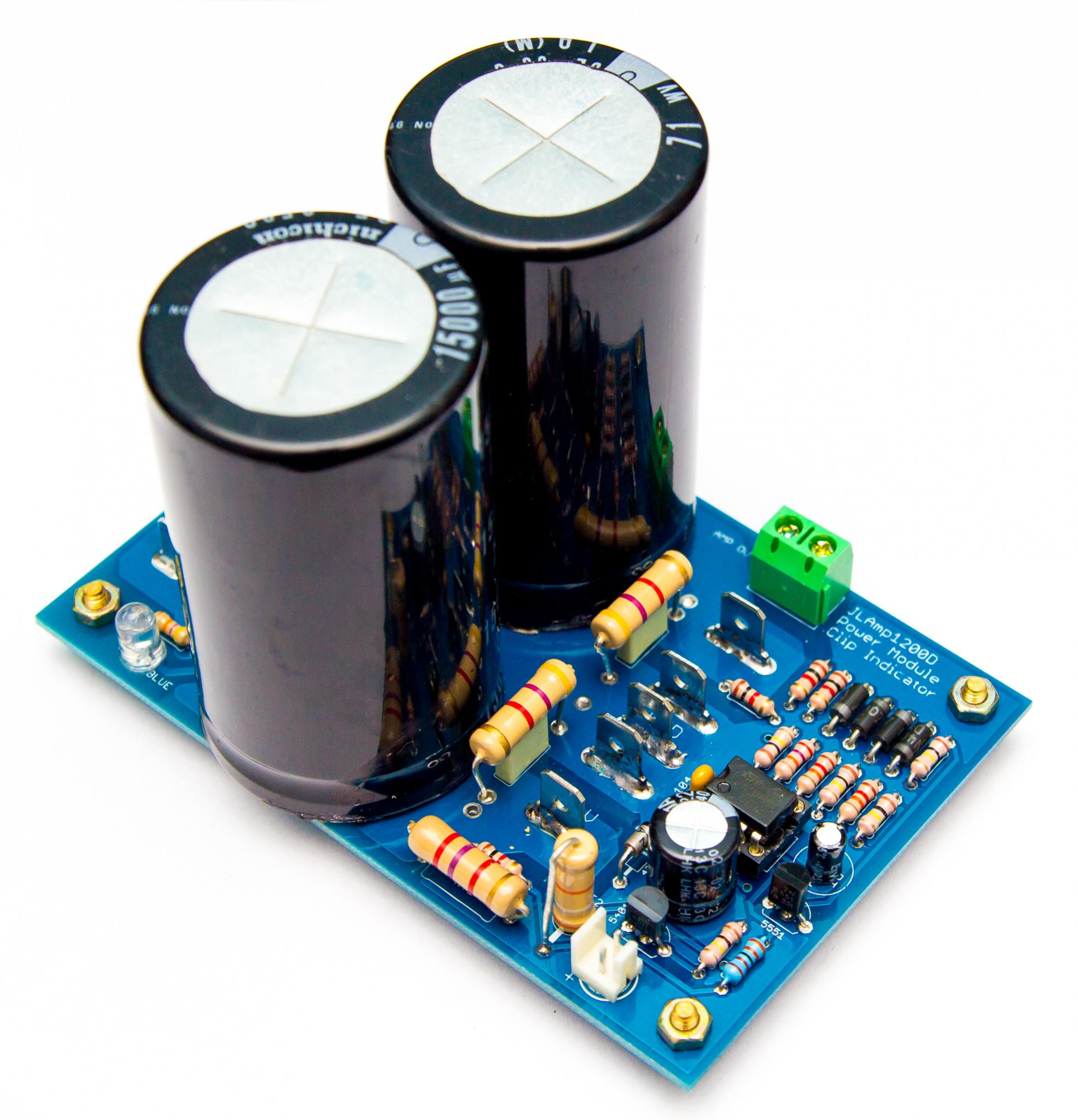

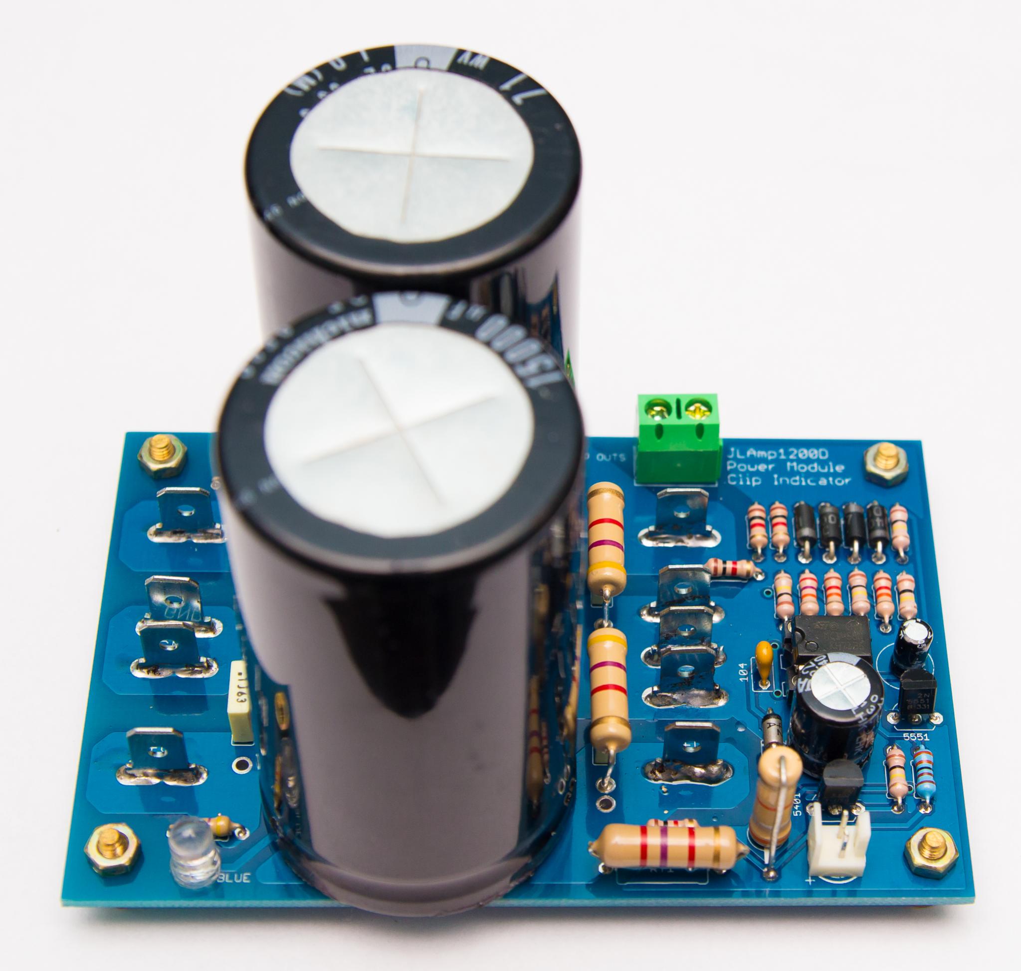

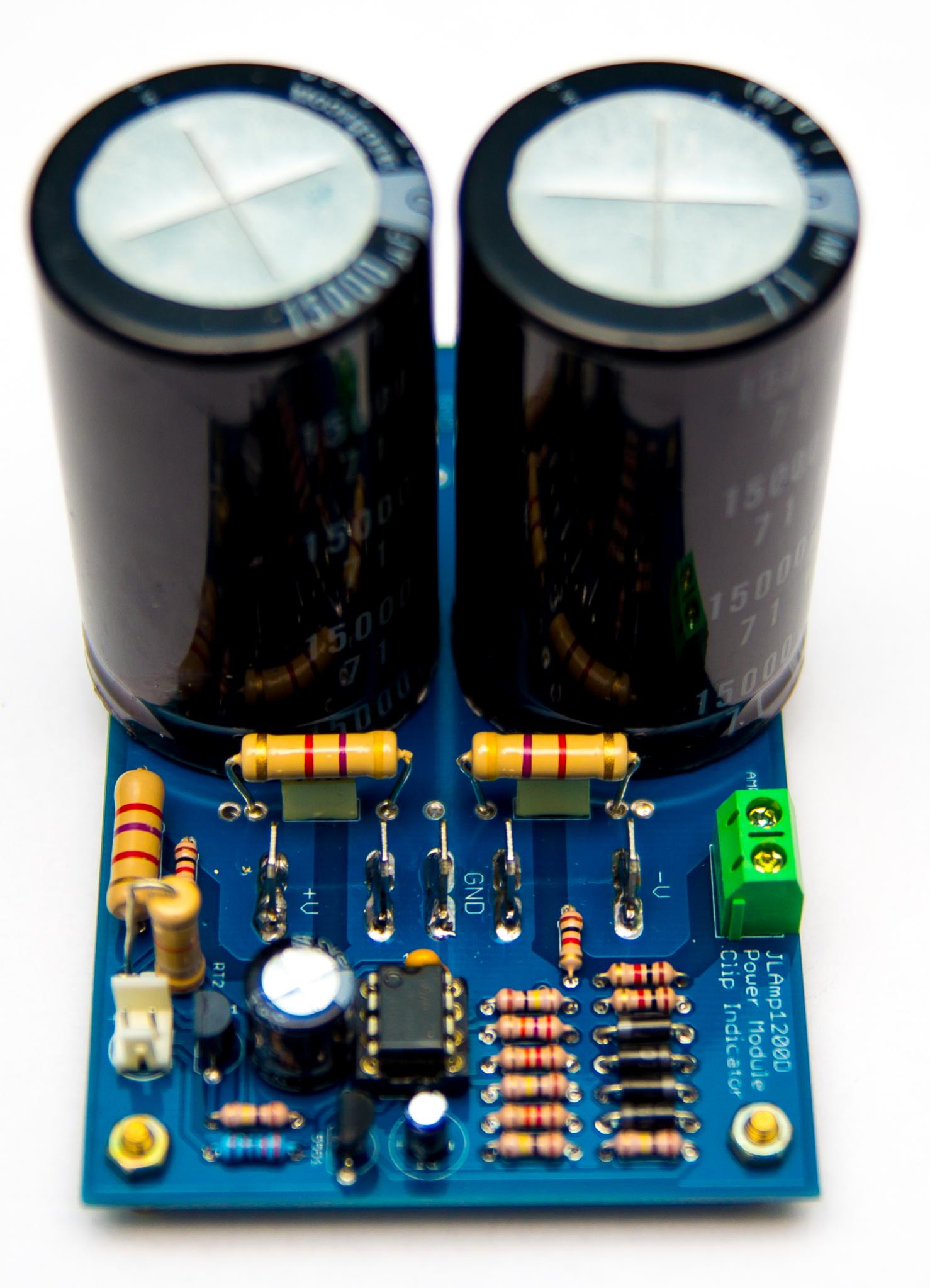

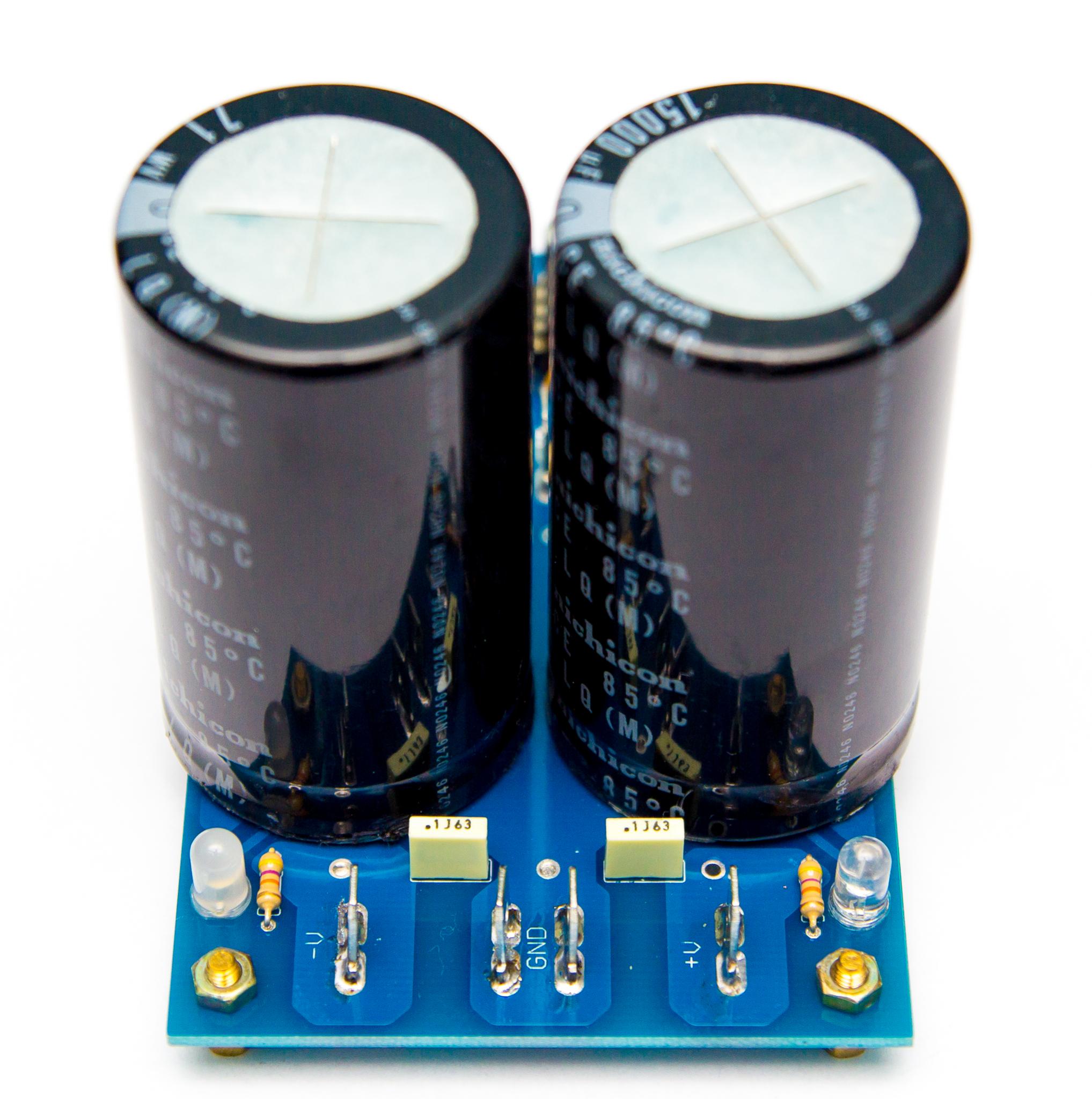

Linear Power Supply with Clipping indicator

Also, I already got my Linear Supply with Stereo Clipping Indicator, will be available soon on my eBay page.

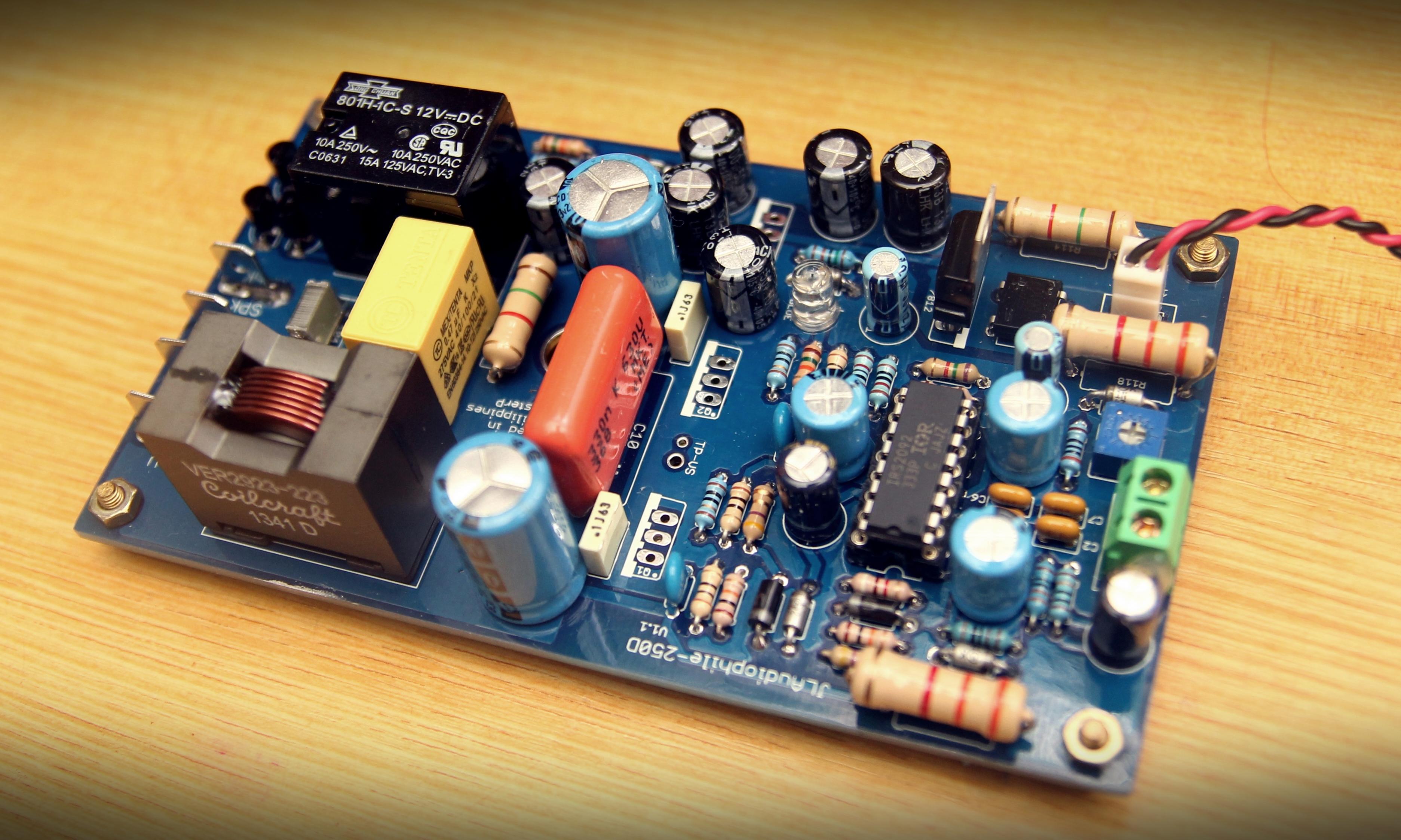

The PCB of my JLAudiophile-250D can be used with a pair of IRFB4227 with the right deadtime and gate resistor values.
Can provide clean 500W into 4 ohms (must use separate gate drive supply), and 500W into 2 ohms.

Assembled JLAudiophile-250 Specs
Voltage: +-40V DC Min to +-56V DC Max Rails
Aux Supply: 12V AC or 12V DC 250mA (For speaker protect)
Output Power: 140W @ 8ohms, 280W @ 4ohms, 400W @ 2ohms
Voltage gain: 36
Load impedance: 2 ohms to 8 ohms
Module dimensions: 2.8" x 4.7" x 1.7"
Parts Used:
IRFB5615 x 2
Coilcraft 22uh VER2923-223
22uf 63V Panasonic FC input cap and VBS
15A@120VAC Relay

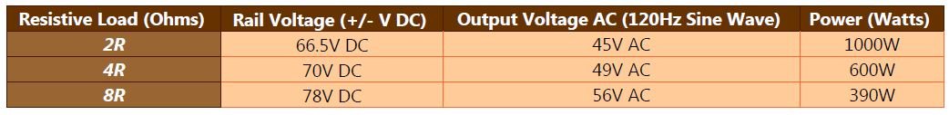

JLAmp1200D with +/- 85V DC rail voltage can do 450W RMS Power @ 8 ohms.How many watts can this do into 8 ohms?
Although in my actual power measurement, I only got 390W at clipping point due to voltage sagging of the power supply that I've used. Here's the latest measurement of my JLAmp1200D with a pair of IRFP90n20d mosfets. The nominal rail voltage is +/- 85V DC, the rail voltage in the table is the sagged voltage measured at clipping point.

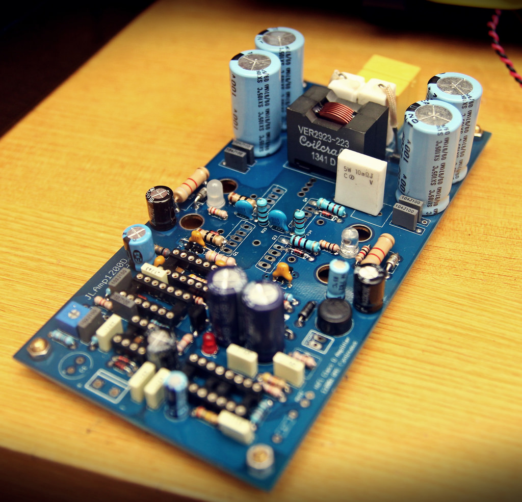

JLAmp1200D V1.2
Enhancements:
-Added IR2110 mute header
-Various component placement enhancements
-Added support for Coilcraft 2923 high current inductors
-Added SMD bypass capacitors
-To-247 Mosfet package support
Enhancements:

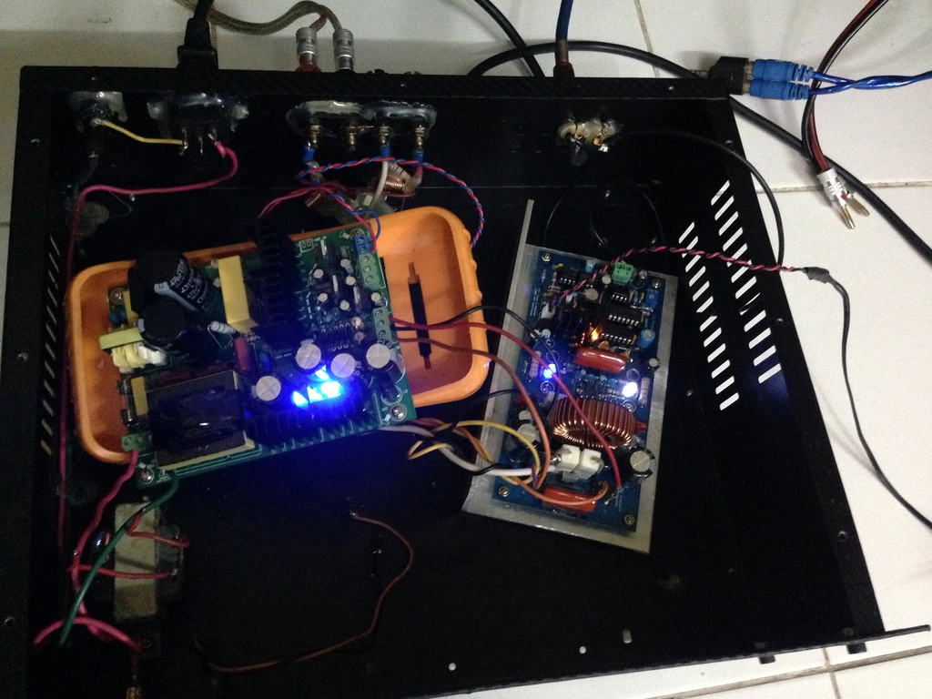

Complete stereo power amp setup: (no preamp)
2 x JLAudiophile-250D Modules with built in speaker protect
Stereo Automatic Fan control
Power Supply with Clip Indicator
CPU Fan
EI Core with KBPC3510 Bridge Rectifier.
...seems to still be missing a few connections!
Looks good so far. 🙂
