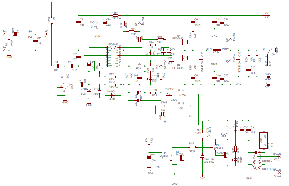

Yes you can, these are half-bridge designs. There's no onboard bridging circuit so you have to use an external one.
But do you think it still will be able to drive 2 ohms?
D
Deleted member 148505
No, minimum impedance should be 4 ohms if used in bridge mode.
D
Have you been able to finish any of the new boards and test?
Not yet finished, I was busy tweaking my modified BAKSA which I started assembling years ago.
For the JLAudiophile-250D, the speaker protection part is already tested. It's almost finished but I have some parts that did not arrive yet. I also have to go to aluminum shop first to have the heatsinks cut. I'll finish it within 2 weeks. 🙂
most people state not to bridge output into 4 ohms, only 8 ohms. Is this true in this case?
This is true when an amp is minimum 4 Ohms stable. This amp is 2 Ohms stable so two boards can safely bridge to 4 Ohms

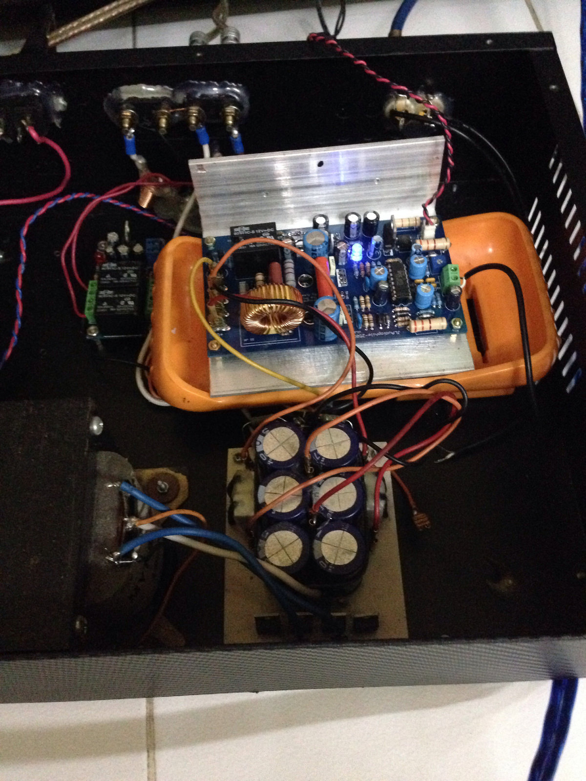

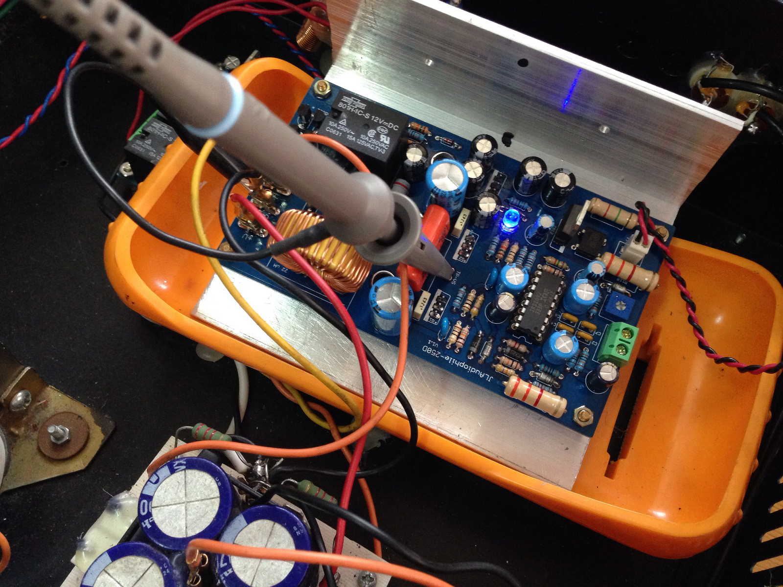

Done right the first time. 🙂
I just used components on my parts bin because the items I ordered from mouser was taxed almost the same price of the items I ordered. So I refused to receive my package. Our bureau of customs here sucks.
I used IRFB5615, 18uh T106-6 Inductor, +-35VDC rails. The osc. freq. is 365kHz when the trimmer is 0 ohm.
No hiss, tweeter is dead silent when connected (unlike other ebay irs2092 designs). As expected with IRS2092 based amps, it has a very good sound. 🙂
The heatspreader and the inductor don't even get warm after 30mins, but I'm using +-35VDC rails which explains why voltage regulator for mosfet driver emits minimum heat.
I'll replace the inductor later with Coilcraft AGP2923-223KL.

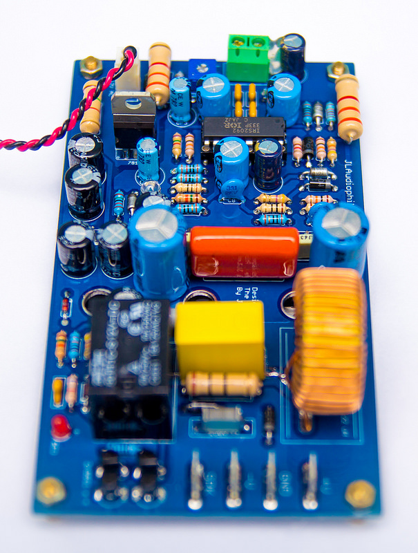

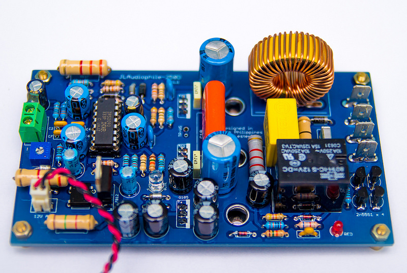

why do you think this design has very low noise?
The layout is an important consideration for noise, my layout looks simple but if you examine it closely, the parts are positioned carefully to minimize current loops. Bypass caps are very close to the supply pins of the IC and the mosfets, no compromises have been made 😉 . And I used different shielding planes for noise sensitive areas and noise generating areas which minimizes the noise coupling between them.
One thing you can experiment with is the input cap. I think there is no need for boutique components in other places because IRAUDAMP7 already uses mosfets with good key parameters, and has a good deadtime setting. The choice of low pass filter components also affects the THD. The filter cap should be of polypropylene type for low distortion. And use good inductor, like the Sagami 7G17A which uses OFC wires.do you think that using boutique components in certain places would improve the sound?

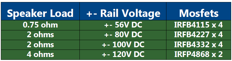

What is the maxium VDC The JLAudiophile-250D can be used with?
+-70VDC max.
I created BOM for +-56VDC max and +-70VDC max supplies.
You can use 80VDC max if you'll use a separate VCC supply for IRS2092 and use 100V ratings for bypass/decoupling caps, some resistors should also be adjusted accordingly.
